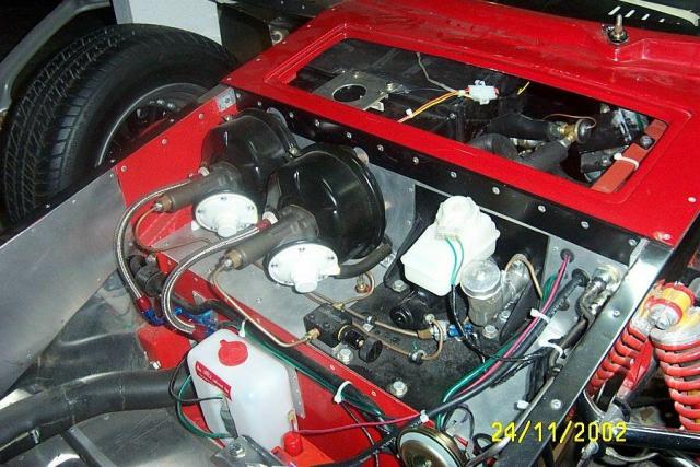

Getting to final stage of front suspension upgrades and can't seem to get the front brakes to bleed.
<?xml:namespace prefix = o ns = "urn:schemas-microsoft-com<img src=" /><o:p></o:p>

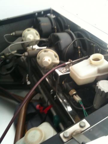

The m\c reservoir appears to have two compartments each feeding one booster which are dedicated to either the front or the rear brakes. The forward compartment, which directs fluid to the front booster, is empty and I can’t figure how to get it filled with fluid.<o:p></o:p>
<o:p></o:p>
Pumping the pedal, holding it down while opening a bleed screw – air comes out but no fluid or fluid level change in the reservoir. Any help?<o:p></o:p>

Before I disassemble the whole thing to figure it out maybe someone can instruct me on the mechanics of the master cylinder in terms of the reservoir(s).
P><P><FONT face=
I have never fully inspected a single master cylinder that feeds two separate lines. What I can’t comprehend is the two reservoir compartments mounted on top of the m\c that seem to be isolated from one another. Does one feed the other? If so, how?

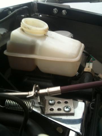

One concept eluding my simple mind right now is how does the forward (I assume the primary, front brake) reservoir fill with fluid? As in the pic above it was empty.
The 'Dam' between front/rear must be blocked or faulty to prevent you topping off the fluid.
Jac Mac, this might be the culprit. I have put my finger inside the reservoir to feel for any blockage. I can not find anyplace that remotely feels like a passage way to the front reservoir.
<o:p></o:p>
I removed the front brake pipe away from the m\c (leaving the rear brake pipe connected) and managed to ‘back door’ some fluid into the front reservoir. I feed a clear line from a full container of fluid and connected it at the m\c in place of the brake pipe then pumped the brake pedal quite a few times (oh yea, I am doing this solo, it’s 1 am right now!!). Slowly but surely fluid was sucked into the front reservoir. I stopped when the fluid reached about half full and essentially quit taking more. Unless I can figure how the fluid is replenished in the reservoir then bleeding the lines will be futile.
Tim, sometimes the "top" of the dam can be pretty high, meaning that you have to fill the darn thing almost right up to the level of the screw cap to get any brake fluid to flow over the dam and into the other resevoir. If, for some reason, you can't get the forward reservoir to fill at all, even with filling almost right up to the level of the screw cap then you could take the reservoir off the cylinder and drill a hole (perhaps 1/4") in the dam about 7/8th of the way up it (make sure you clean out all the plastic filings). Then re-install and fill and you should have fluid in the forward resevoir.

After a couple hours of sleep and further examination of the reservoir I find there are several tiny holes at the very rim where the screw cap goes on. As you suggest Cliff, I put fluid to the level of the rim and put the cap on, vacuumed from a bleed screw and voila, some fluid sucked right into the forward reservoir. But under continuous vacuum only the initial amount came forward and stopped.
Now that I see that the fluid has to enter the front reservoir via the holes in the rim at the screw cap, is it ‘vacuum’ that keeps drawing the fluid through?<o:p></o:p>
<o:p></o:p>
Still not sure how it is the fluid replenishes as I bleed the front lines. I am assuming it must need adequate vacuum, the cap screw tight, and somehow the fluid is pulled up through from the rear reservoir…….defying gravity?<o:p></o:p>
