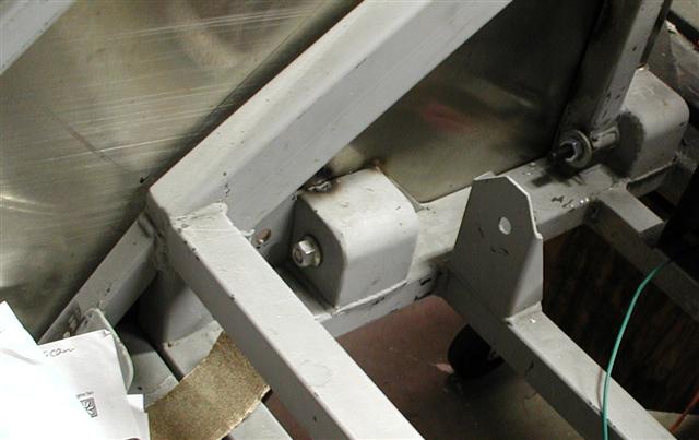

Since the indoard pivots are obviously going to be outboard of the sheet metal, why not make a "U" shaped jig that will run under the car with each upstand containing a pivot point at the width of the rack?
You may want to make up a dummy tierod also, using a heim joint on the inner end just to make life easier than trying to use the ball and socket that I presume your rack is fitted with. Set the jig up symetricalyy in relation to both side pickup points and move the jig up and down and back forwards until you find the optimum position. Then drill your holes from this info. I think a "U" shaped jig that you can locate from both sides would be easier to set up than a "L" shaped jig which would entail slightly more difficult measuring. I know it means going to the trouble of building a jig, but that's nothing to what you've done on the car so far. Keep up the good work.
Edit. Sorry Bill, Just saw your rackends are only 24" apart. I think that will put them inside the pivot points and sheet steel. Really they want to be inline with the inboard pivots as Richard posted earlier. Easy enough to machine up a clevis to screw onto each end of the rack and extend them to the right position and use a heim joint at the pivot. Sorry, gets more involved all the time. Maybe CAD is the way!

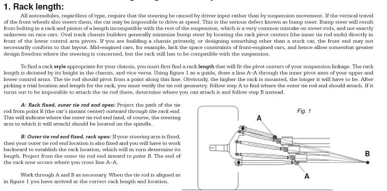

In Richard's post earlier he had part of an article about rack lenght. It mentioned finding the cars "instant center" in determining where the rack should be. I am curious as to how to go about finding that point. Is that a theoretical or real point?
Then in his article it said it was based on a line from the lower to upper pivot points. I was then concerned as to where that line is drawn as the suspension of the Corvette is not a box layout. The upper pivot points are in a different plane, and travel through a different arc. This is why i need a better idea of where the rack is placed. Not only up and down, but front and back. Onced located, it is a matter of shimming to get the system right. This is also why this is such a dark sicience to me. I am pretty good with math and geometry, but never having experienced the real world of "the science", is why I raised the question in the first place. I know from looking at the old RHD rack that came with the car, that the height of the new rack would be higher. The original rack pivot points are narrower than the Flaming River unit.
All these discussions are great, once I get the rack mounted, and I will surely pass them on to the people who are going to set up the front end once the rack is in place. The corvette guys won't be any help as their horizontal measurements will be different from mine, and their rack pivot points will also be different.
So as Richard and Jack point out, none of this will be relative til the rack is mounted. One hole (slightly enlarged) will be better than 2 far apart. I appreciate everyones help and info so far. Keep it comming, as it will be used later on by me, and I am sure some can use it now. I have supplied Jack with all of the measurements of the suspension and rack. He should have some "numbers" for me shortly which I will pass along for others in my predicament. I guess I could have avoided it all by contacting Peter and bought one of their reconditioned units and been done with it. Shipping and all would have probably cost about the same. I may be wrong, but I don't think the LHD units they furnish are quick ratios(which mine is). At any rate, I have the FR unit and I need to make it work. Had I thought bump steer would be a problem while the panels were off, it would have been a much simpler task. Thanks for the info guys, and keep it comming. Maybe I will pick up some points that will help in the future.

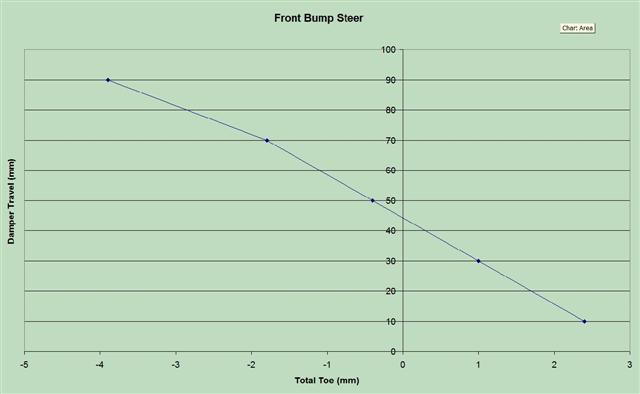

I mapped the front Bumpsteer on my DRB on the wheel aligner at work with unmodified DRB front end.
As you can see it is pretty terrible. We are looking at using a kit
from Ecklers which basically drops the outer tierod down 50mm or so as this
is what is required to fix this problem (instead of raising rack). This kit is designed to fix bumpsteer issues on C4's.

The front to back placement of the rack will not affect the bump steer. Bump steer is caused by the pivot points of the tie rod not being in line with the upper and lower a-arm pivots. It's hard to describe without a picture, so take a look at this thread. Post #13 has a great pic of a short-long arm suspension and how to find the instant center, and how to position your rack correctly.
My Rack Conversion - Corvette Forum
As you can see, you can adjust bump steer by moving the pivot points up and down, or by changing the length of the tie rod.

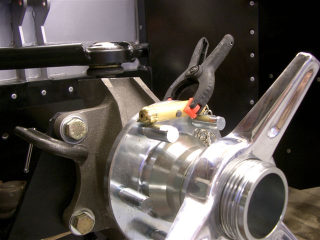

.. and just to add my 10 Rubles to the discussion. I used several methods of measuring bump steer after the design of my lambo chassis from scratch.
Everything that has been said above about the positioning right. I first read all the books I could on the subject and talked to everyone supposedly 'in the know' then drew my own conclusions after filtering out the crap!
Anyway, I used the laser pointer idea too. Except I put the pointer facing toward the 'side' of the car, instead of forward. This was projected onto a graphed peice of wood so I could see how the wheel was performing. I also used the dual dial-gauges method as well. I found both methods great when seeing the fruits of my handywork. I was able to determine that after my 2D paper design and string lines in my lounge, that my bump steer was almost non-existant with careful planning and setup. (and late nights, spoiled mounts and whining girlfriends)
RamboLambo,
An brilliant refinement of the laser application. I wil remember that.
Thanks.
Russ Noble said:
RamboLambo,
Thanks.
Agreed, in a 'zero bump steer' setup, if the laser was fixed as in my diagram, it would track a slight curve, due to the track change.
With the laser pointing outwards, it would track a perfectly straight line.
A brilliant idea indeed!

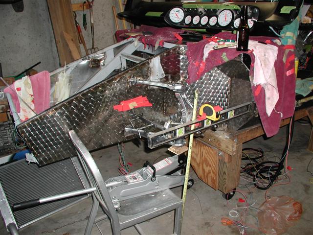

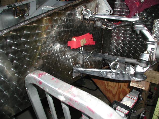

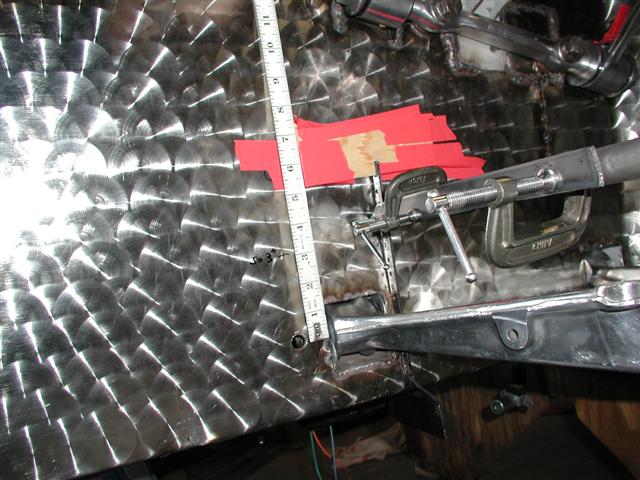

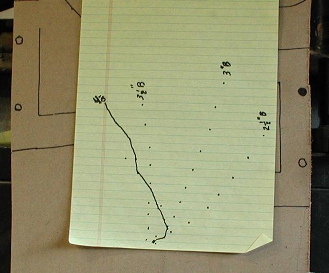

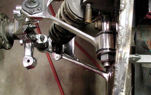

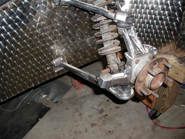

Well I have done the template(jig) method of measuring the amount of bump steer in my front end. I realise that this is only close, but that is all I wanted in the first place. I didn't want to cut a hole to far from the end point, and then have to cut again and attemp a repair. As it is, with the panelling in place, I will have to cut a bigger hole than I wanted because the entire rack is miles longer than the width of the panels. So the mounting part of the rack will have to be passed through the hole so that the other side can slide into its hole. So the right placement is even more important. I built a jig from flat stock and bent the outside piece so that it would line up with where the rack would wind up in the vertical plane. I then attempted to pop holes evey 1/2" and then put it through its paces to see where all the points ould line up on the horizontal laser method. As you can see I used my vewry best JERRYRIGGING to get as close to the actual movement as possible. Points to note. The 5th measurement is = to the lower A arm being in the horizontal plane. The measurement that best lined up for no bump steer was about 3.75" above the mounting bolt of the lower A arm.(remember I popped these holes with a plasma tourch and then drilled them out) This puts it at the top of the stock rack mount, which will now have to be altered. Its stock mounting hole was only 2" above that point. As you can see in the graph, that is horribly off. At seast with my rack that is. My rack has the fulcrum point 1 1/2" outside the lower A arm mounting bolts. So it was a guess as to where that magic line is that connects the tow pivot points. In the measurements that I supplied to Jack, I realized that they were way off when he sent me the solution to the bump steer. I knew I had measured wrong when he mentioned the upper A arm mounts were 3.75" further out from the lowers. I immediately knew that couldn't be and remeasured. Sure enough I was way off on my measurements. So I decided to go the manual route. I will use his formulas to see if they come out to the same numbers I got.
My laser pointer was actually a laser line level. Because they use a reflector to get the line, I blocked off a part of the beam and voila, you get a point. I then used a carpenters level to keep the wheel from rotating during the measurements(would throw off the points), and hold the laser. It took me most of the day to get these points as things would not reproduce. then I discovered that certain pieces would move. So they had to be secured.
I think what is gotten most out of this exercise is that, a small amount of change in the rack position really affects the bump steer. I am curious if there is anyone who has used one of the bump steer correction pieces that raises or lowers the steering arm alone. I don't see how this would really correct the situation. Maybe someone more engineered than myself could enlighten us.
