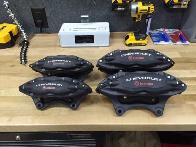

For those who've powdercoated their calipers, did you first strip the factory coating and if yes, how did you do it? I'm wondering if the black color is an anodize or paint.

Talk to your powder coater. Many have a chemical dip to cleanse the metal surface. They will probably clean it anyway to guarantee their product.

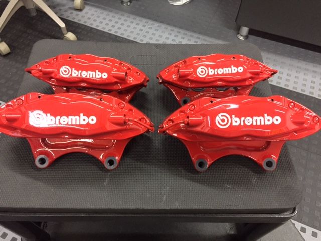

I had my calipers powder coated by Armor Tech, here in Florida, and they did not need me to do anything. They did not even have to disassemble the calipers. They block out all of the seals and threads. They came out as nice, if not nicer than my Ferrari Brembos or my Porsche Brembos.

Dan - I'll be my own powder coater on this job! I do plan to bake the parts and apply a cleaner before applying the powder however. I'll try a paint stripper the next opportunity I get to see if it does anything but figured I would ping the community.
Mark - in your second pic, I can't tell if the circles where the bolts go through are black or metal colored, can you check? Wondering if they removed the black coating before going to the powder.
I'm opting to remove all the seals before powdecoating. It's a bit of a pain in the butt but I'm trying to minimize my opportunity for screwing thkngs up ;)

Your post initiated a discussion with my powder coater, and he insisted that the calipers needed to be brought in gutted. My interpretation of this detailed discussion was that the out-gassing, and curing temperatures are on the margins of what the o-rings can handle, and perhaps for his liability concerns, he chooses not to coat fully assembled calipers.
I wonder if perhaps there is a lower temperature powder coating that is being used here.
Cam: I will look when I am at my shop to see if any coating was removed in the areas you mentioned.
As for removing the seals, I spoke with the owner of Armor Tech, who had a big shop up north, retired, and now has a rather "boutique" business in powder coating. He insists, having done jobs for clients around the country, that the temperatures required for the powder coat process are lower than the temperatures the seals are designed to undergo in function. He has photos of his work on cars in SEMA. I consider him an authority, but you can give him a call.
