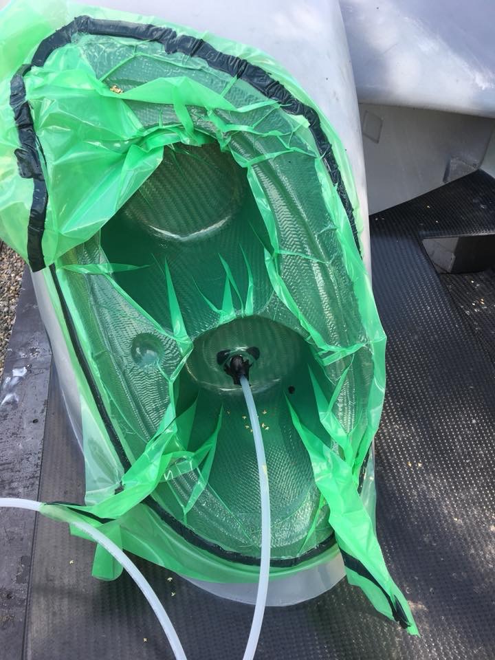

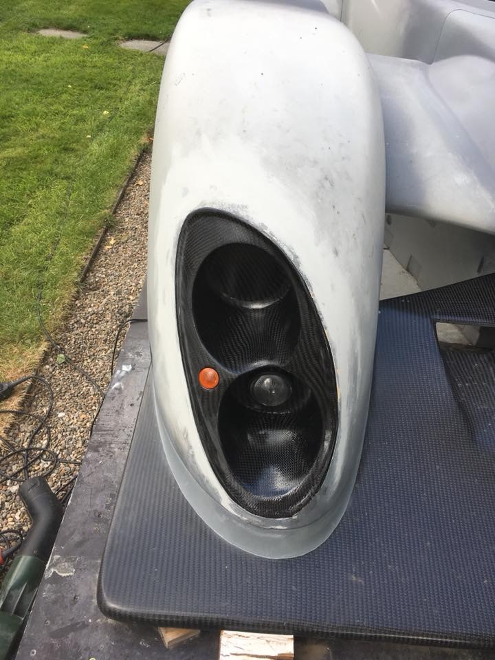

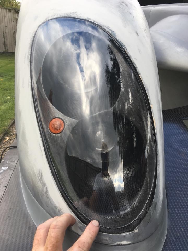

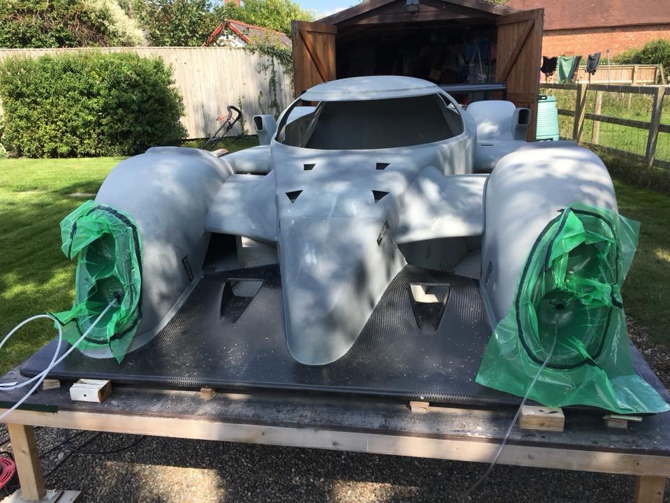

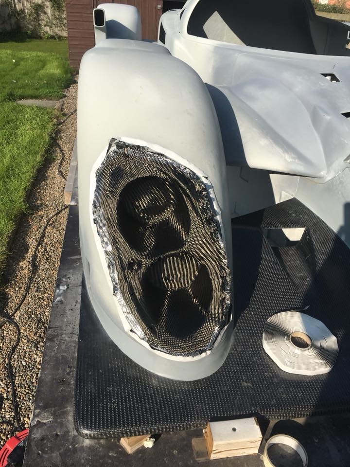

Cam, I know you love carbon, look at what this guy did to the headlight buckets on his Bentley Ex-Speed 8 replica....he uses vacuum to suck the cloth to the bucket...E3F5F7AF-40B0-43D0-A29A-1DF356660C05.jpegE7C9C4D4-626E-4387-A52E-32E87288BFA9.jpegC5B9709D-6888-4145-A2EB-AC13080EA031.jpeg7C6BDB24-5A1A-42B8-B8F9-95D3470D2DEC.jpeg58AAB2E4-EEB6-4002-B688-F9ABB456C25E.jpeg
That’s super sweet! I actually planned on using vacuum for all my carbon work but didn’t have the time to learn how to do it before going down the path of skinning. I have a vacuum and the associated bagging materials, just need to carve out some time to learn then do it.
Doing the buckets with carbon is on the to-do list once I get my pump and skills up to speed, I just couldn’t slow the build down to learn and practice.
Thanks for the pics, I think it looks great - hopefully my attempt will go as well and I don’t cave the whole bucket in ;)
Interesting, I wonder if he used the room temperature cure prepreg fiber? That's pretty tough to do with one piece, lots of different concave contours
Joel K
Here is his reply to that question on Facebook:
Using resin, you just would not be able to get that shape in one piece with prepreg
