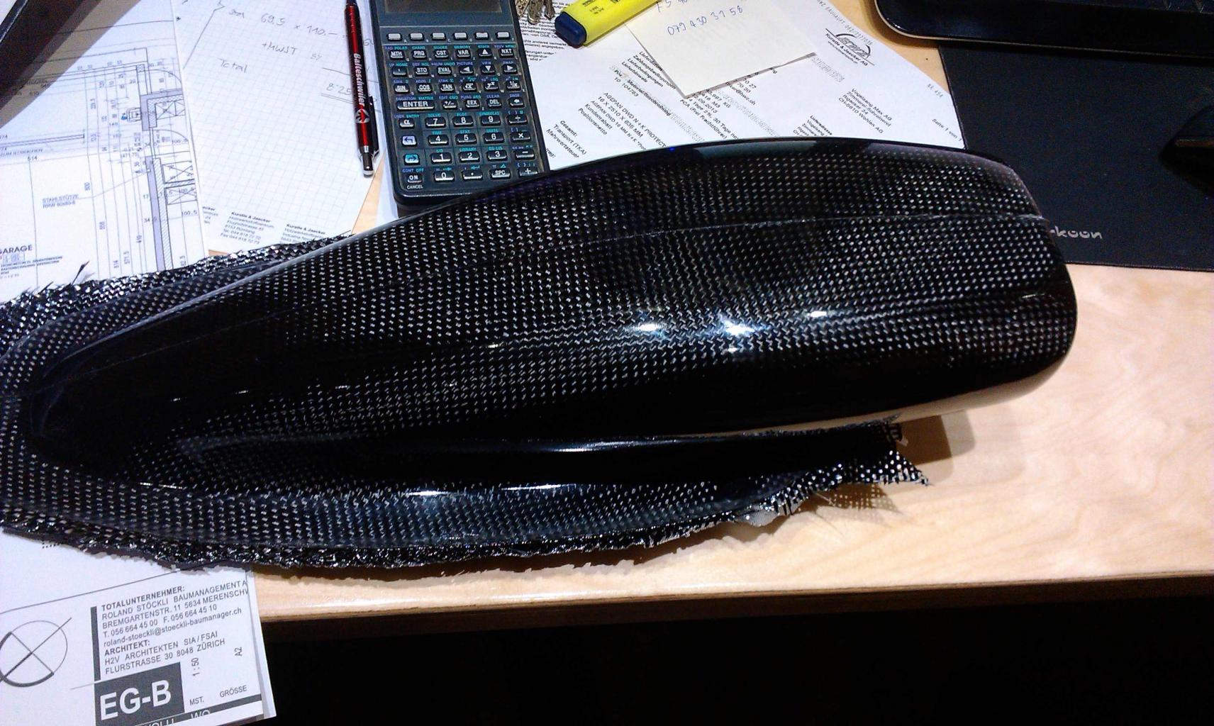

here a pic of the finished sidepart.
and now we all know´s why it means ---timeless design of gt-40---, because this car looks like designd in 2000??,....2010??,...i like this, it looks perfekt, it looks like the race-version gt-40, real good work,..

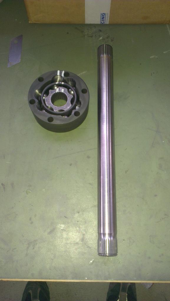

we also recieved the custom made driveshafts with bearings from Fredy Amweg in switzerland.
Also thanks to Fran for the fuel caps.

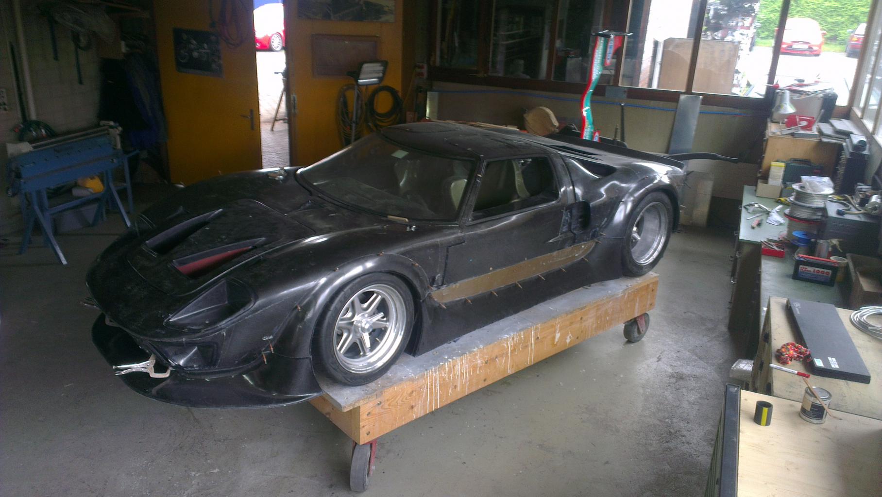

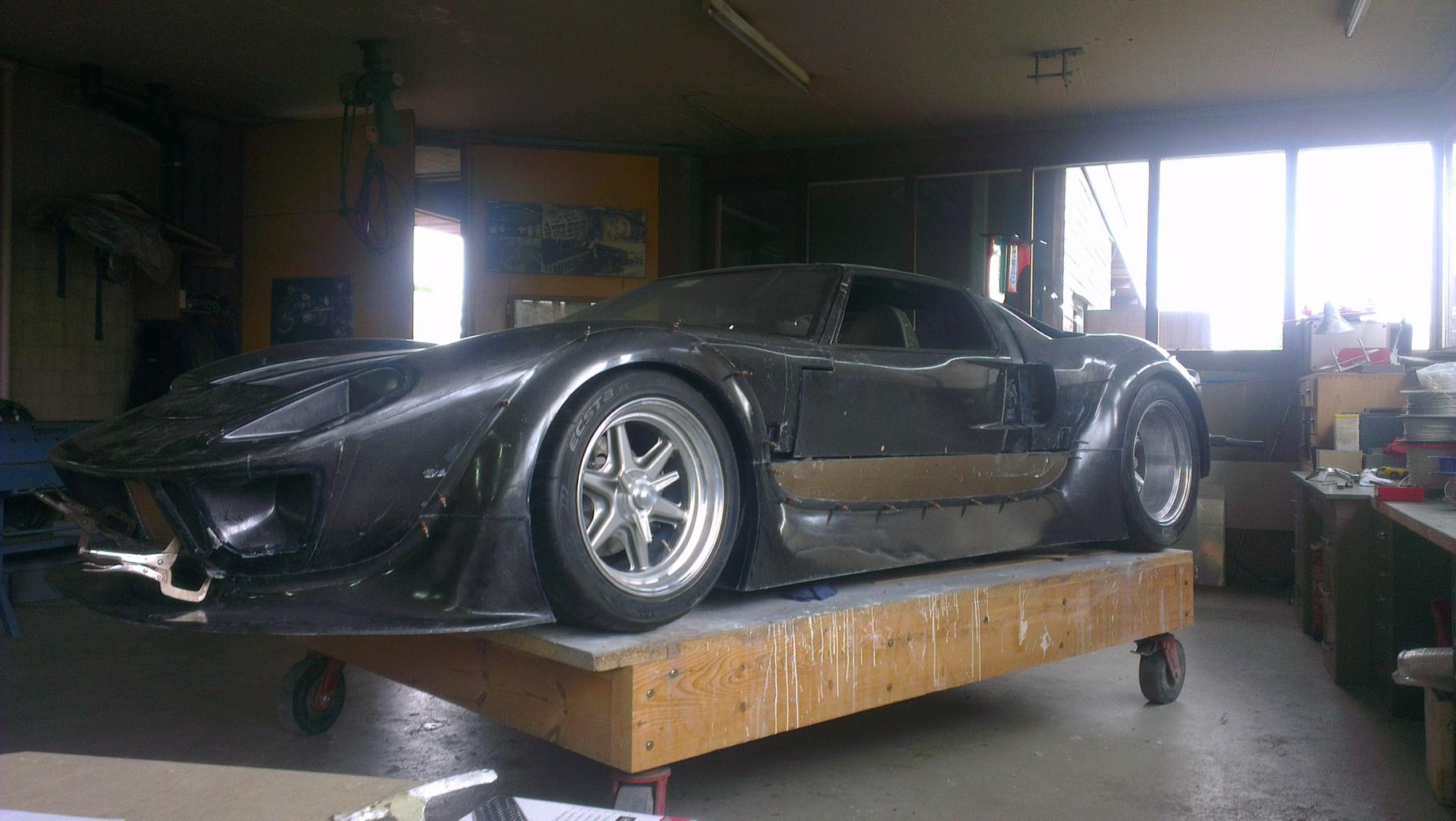

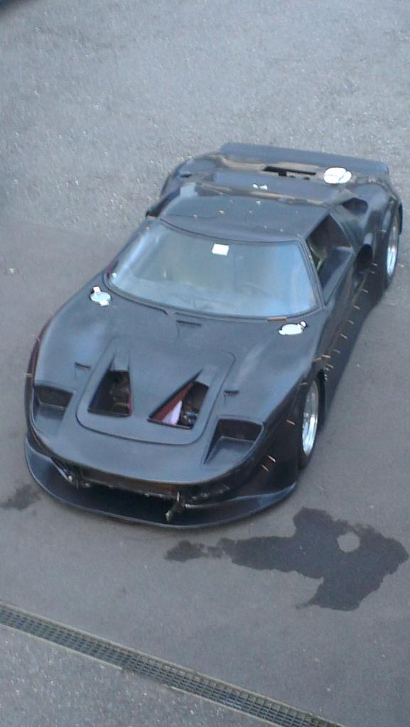

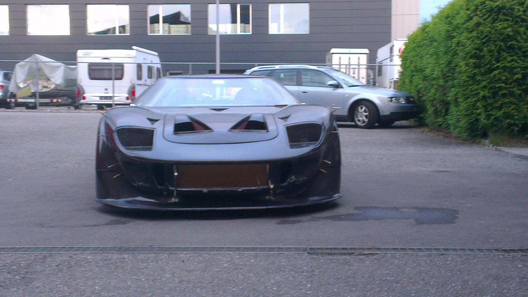

Yesterday we took the car from the platform and pushed it through the parking place it s really really a low car :)

That front splitter is mental - I love it! Well done Urs. If you ever feel the need to come and help my project, you are more than welcome :)

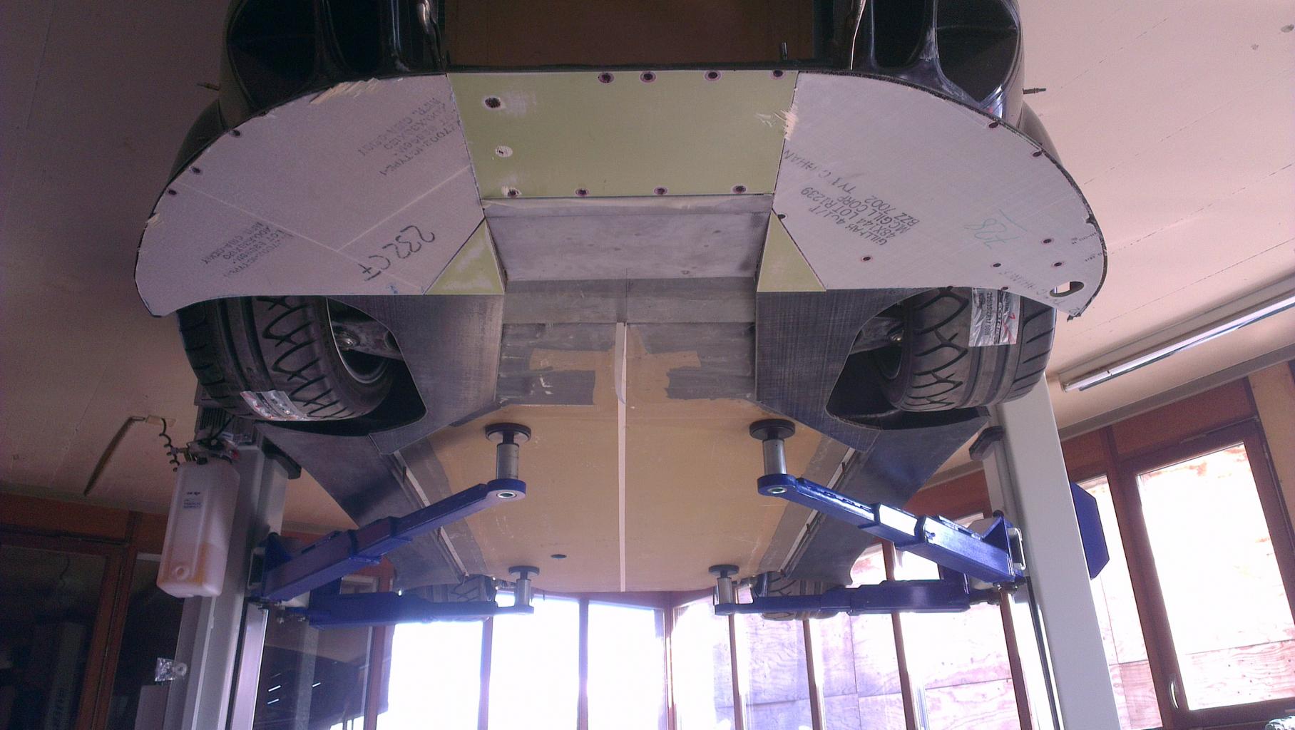

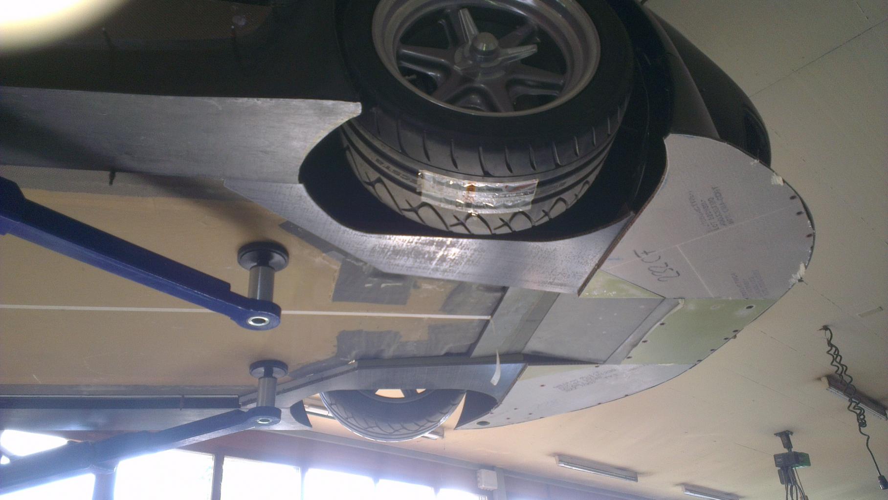

Now we got a car lift :) Really nice for work from the under side.
A lot of work on the front Spoiler ........

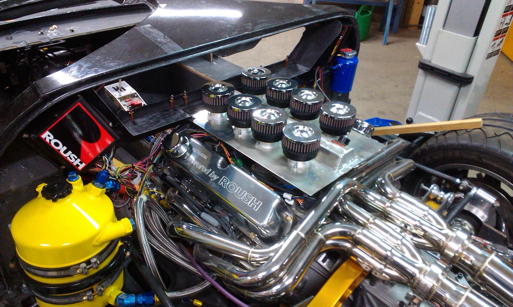

Hello Togethet
We started with placing the engine Control boxes. Is there someone who also has a roush 427IR who could give some help about the wiring of the engine? Are there some wiring shemes of the engine existing?
Thanks for all the help.
Greetings from switzerland

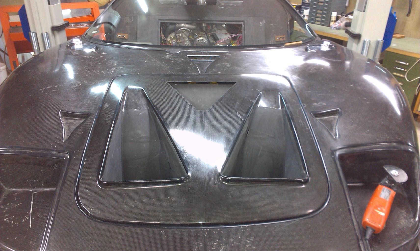

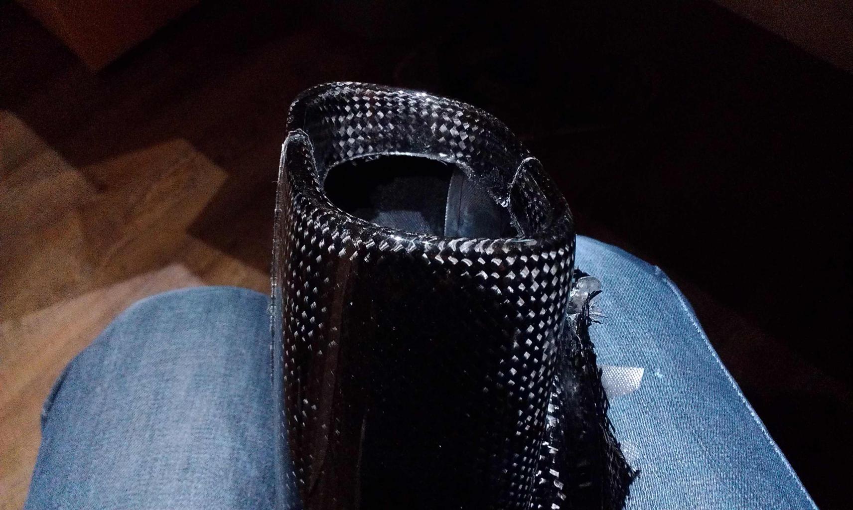

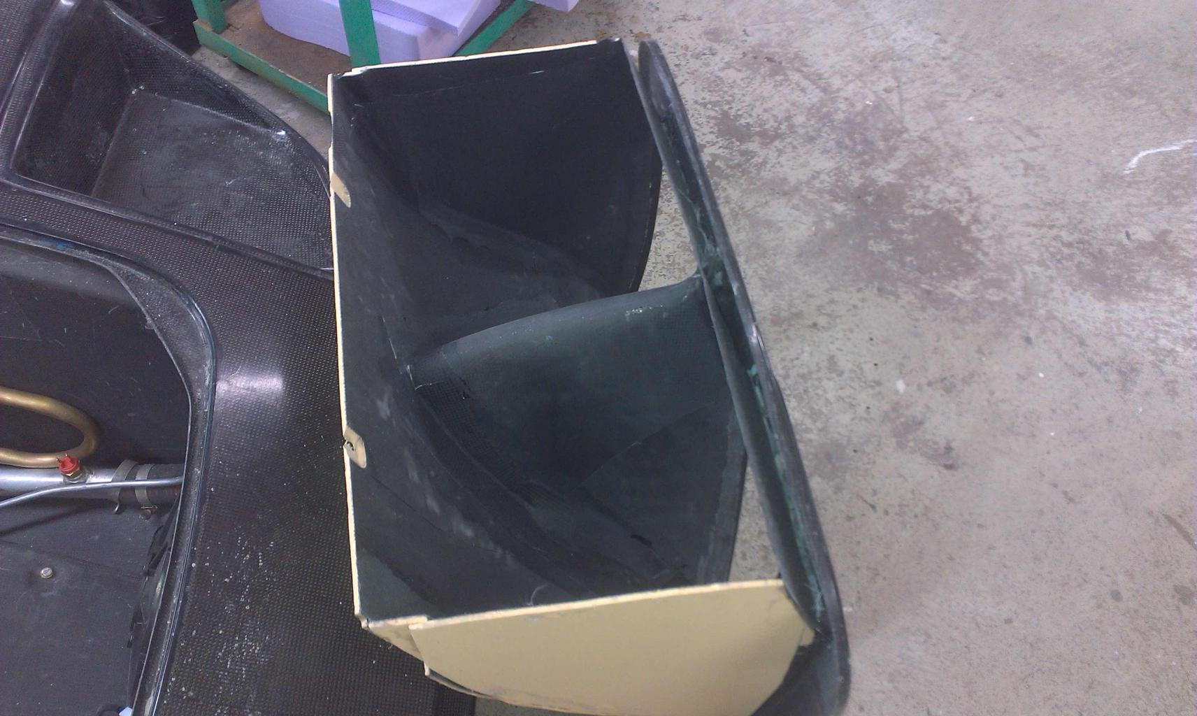

Here the Picture of the Periscopes , fresh out of the molds ;)
@Mick : Ill send you the first pair of them ;) They will be a Little lighter than the other one.

Urs, Your car keeps getting better.
Good work. I am looking forward to seeing it when it's finished.

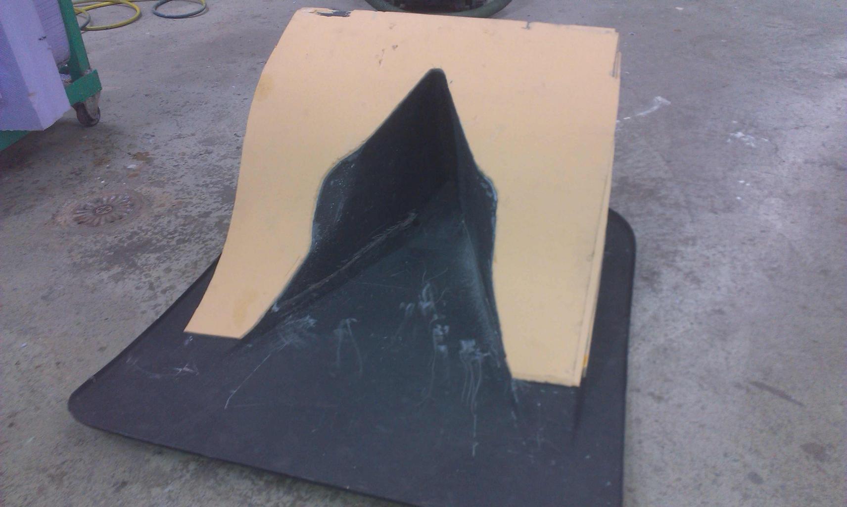

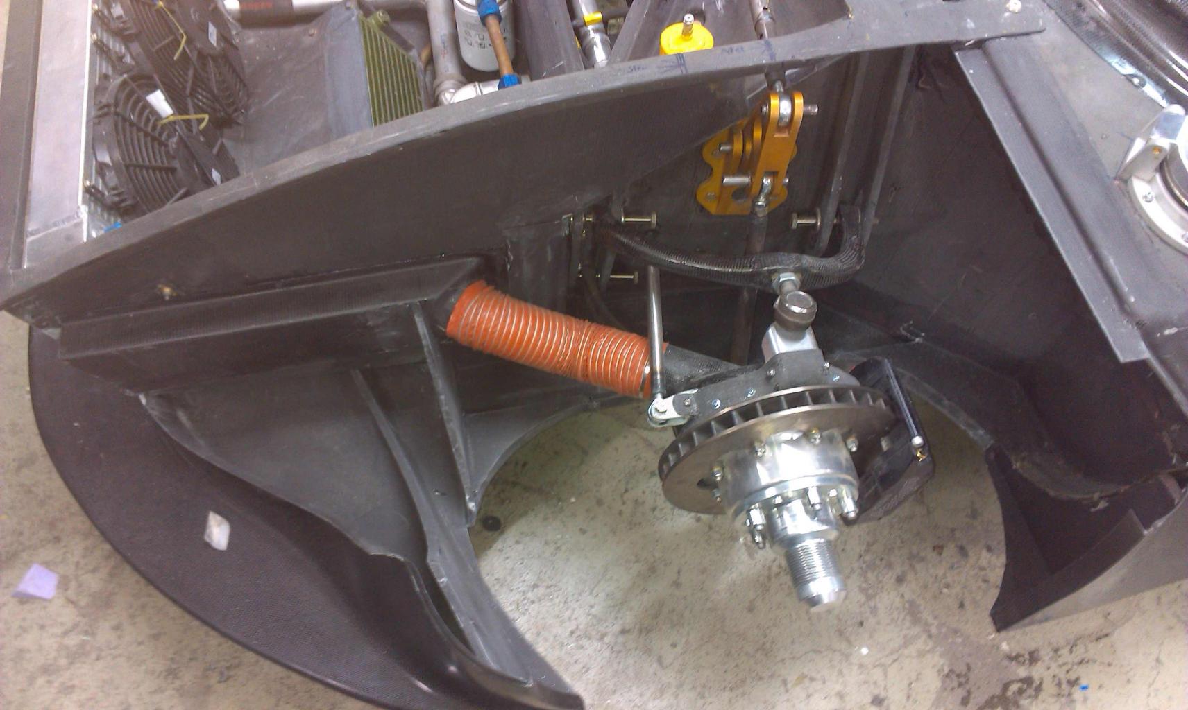

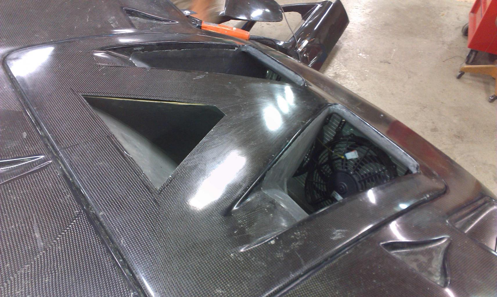

Here some Pictures of water cooler and oil cooler outlet.

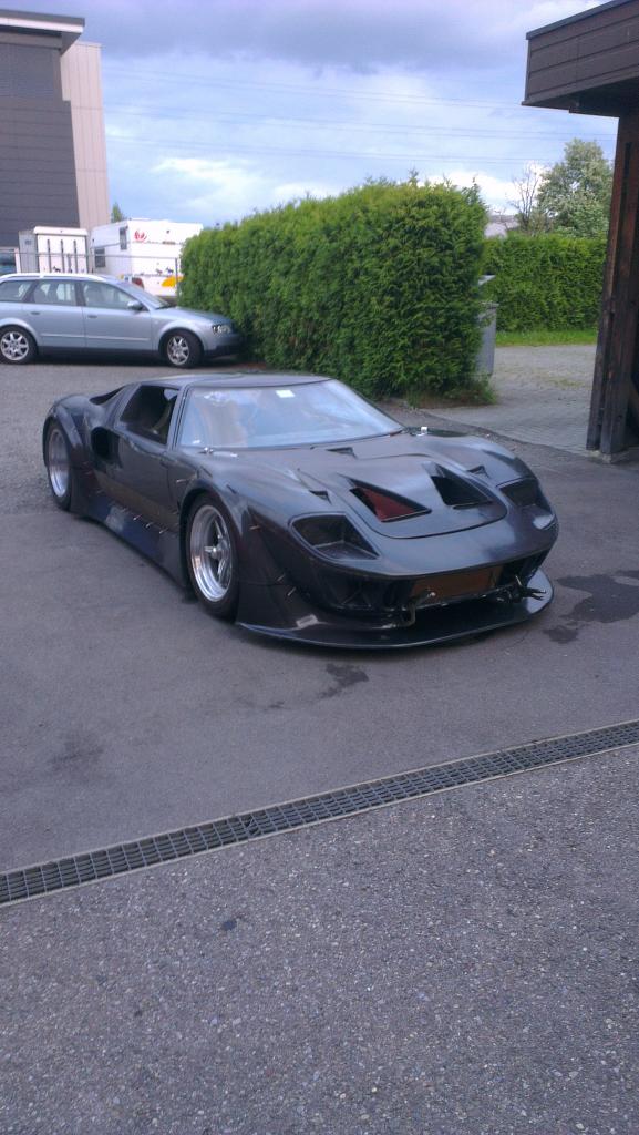

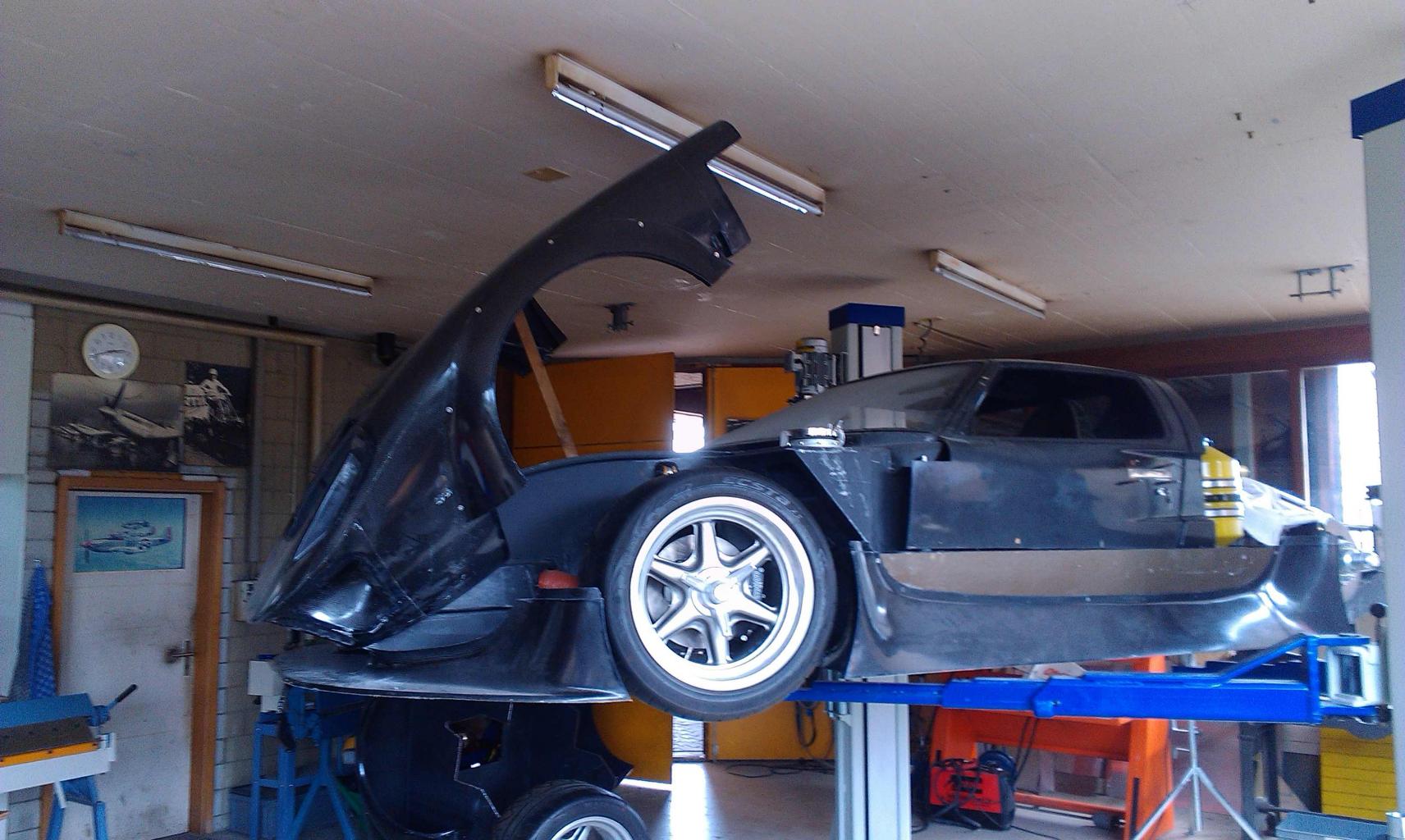

Here some Pictures of the front Clip, which we can open without movement of the splitter. But the opening is limited until a Point.
