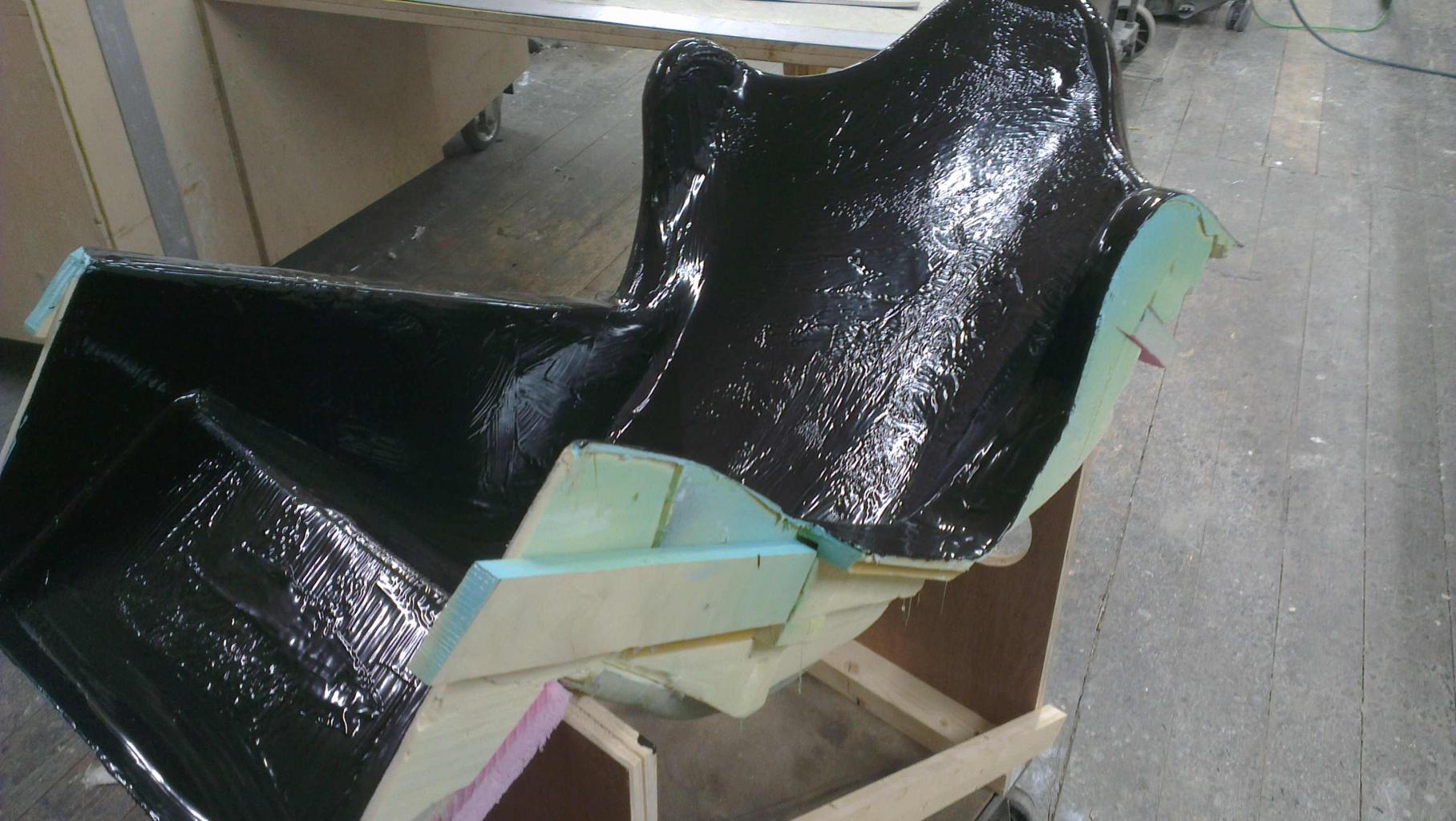

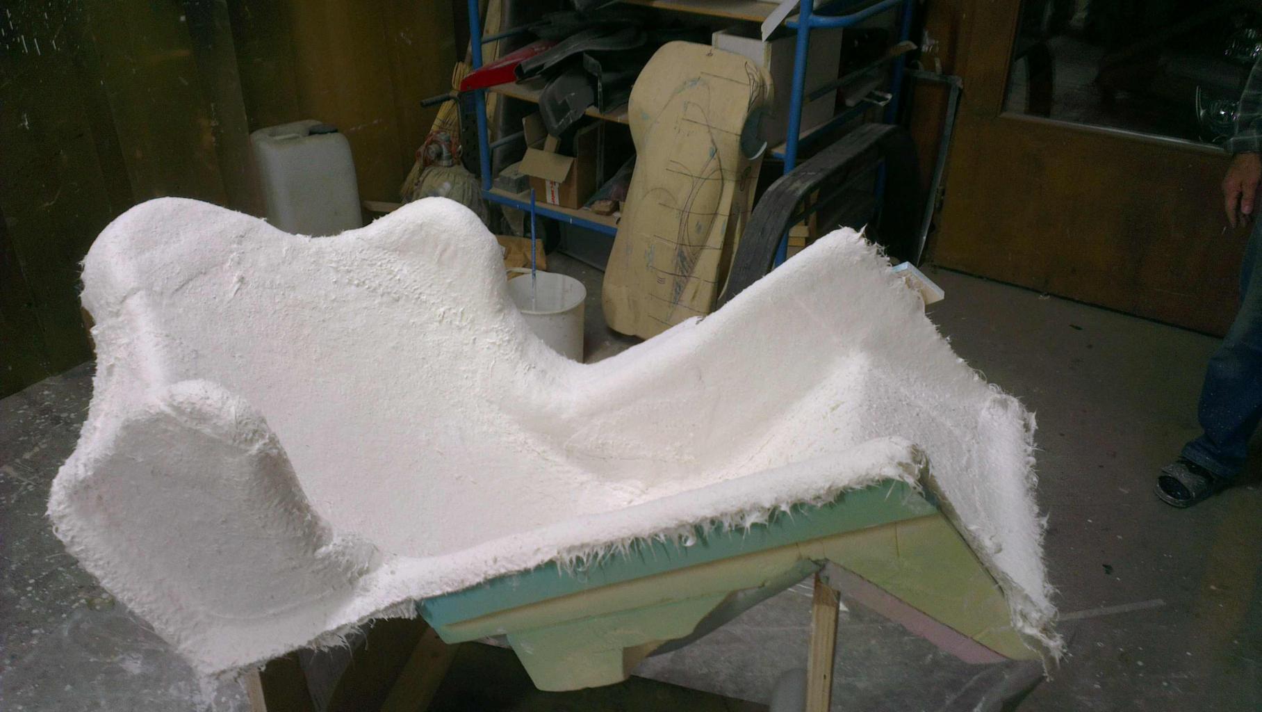

Yesterday we did the negativs for the seats with laminating ceramics.

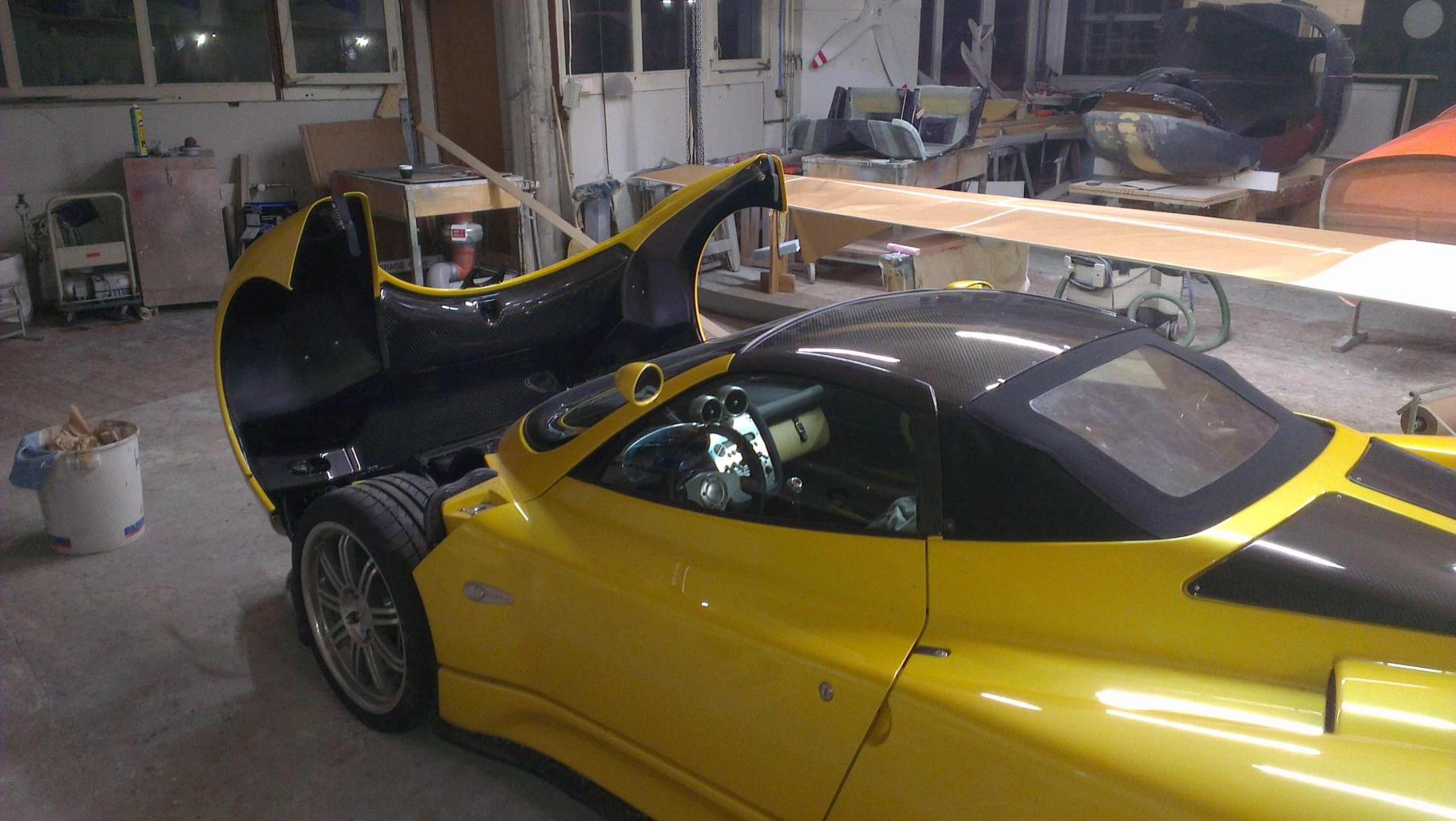

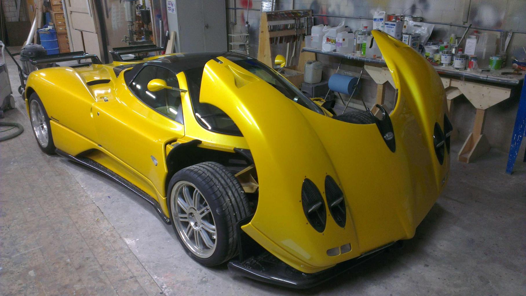

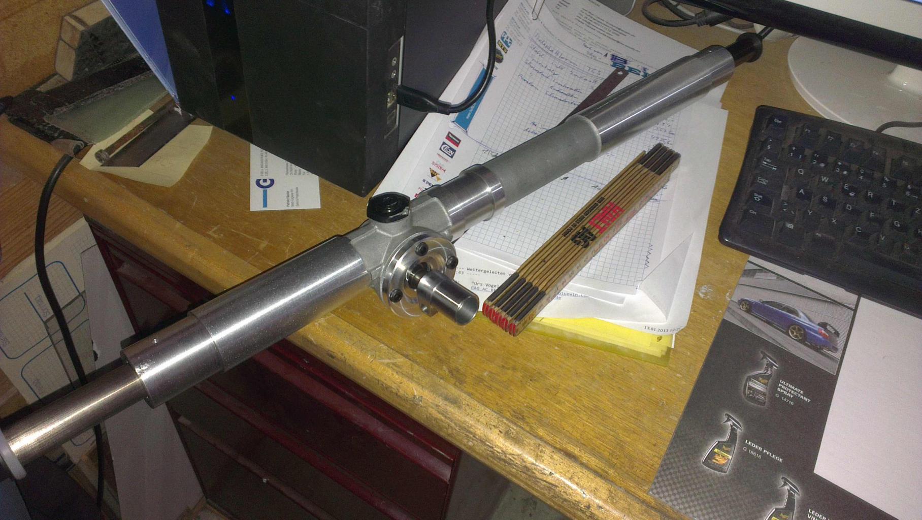

We also get the steering rack , and we had a Zonda in our workshop for a little carbon repair. Also a nice car :)

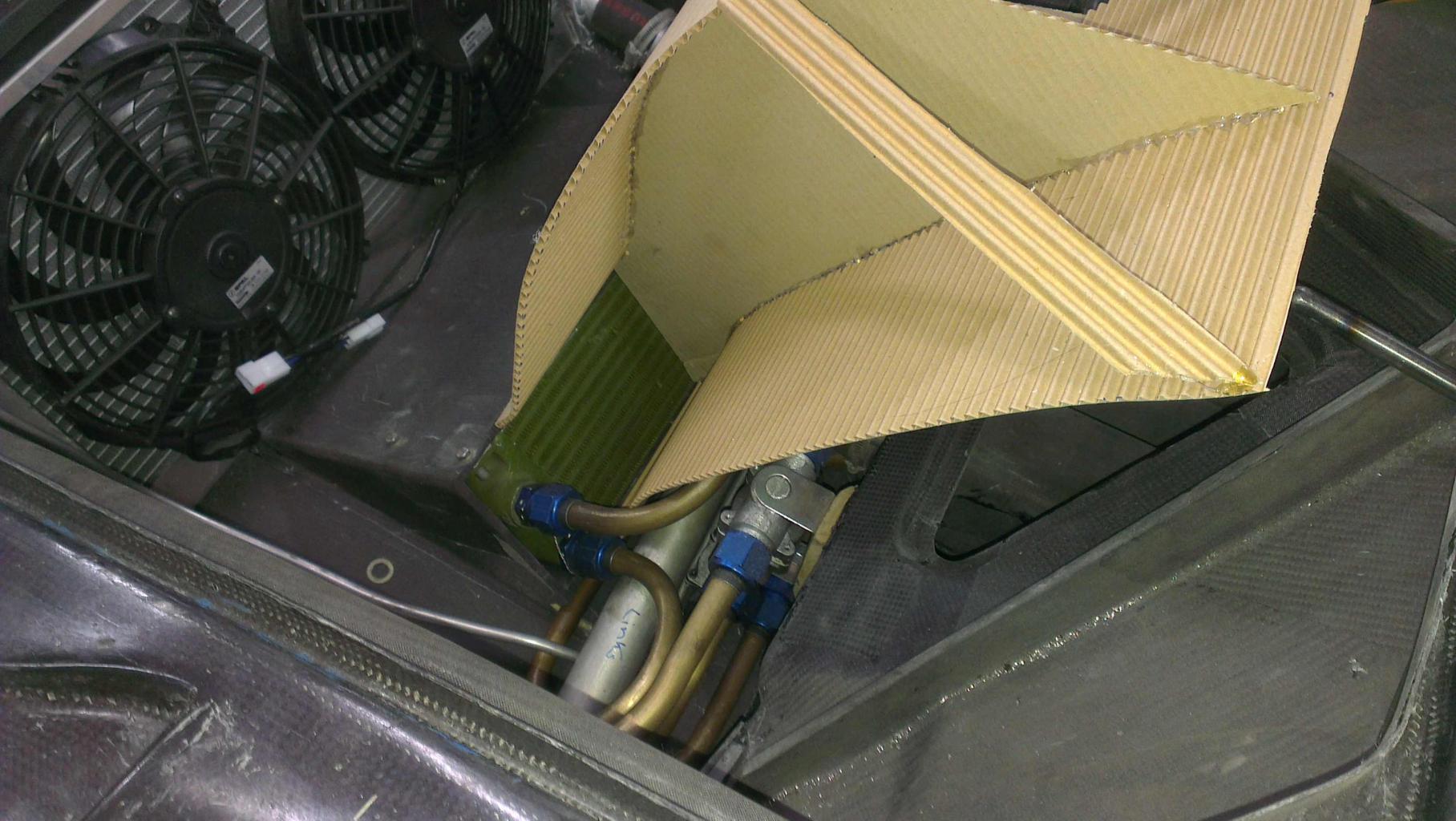

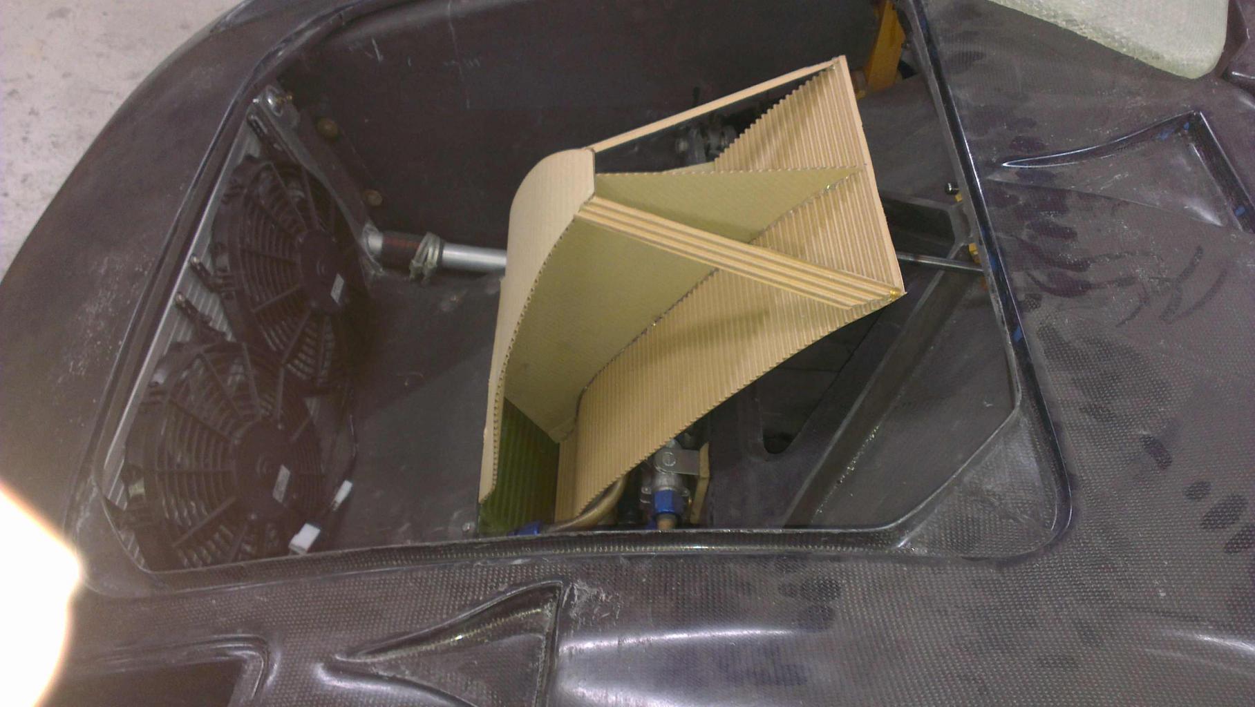

I also did a paper model for the oilcooler outlet.

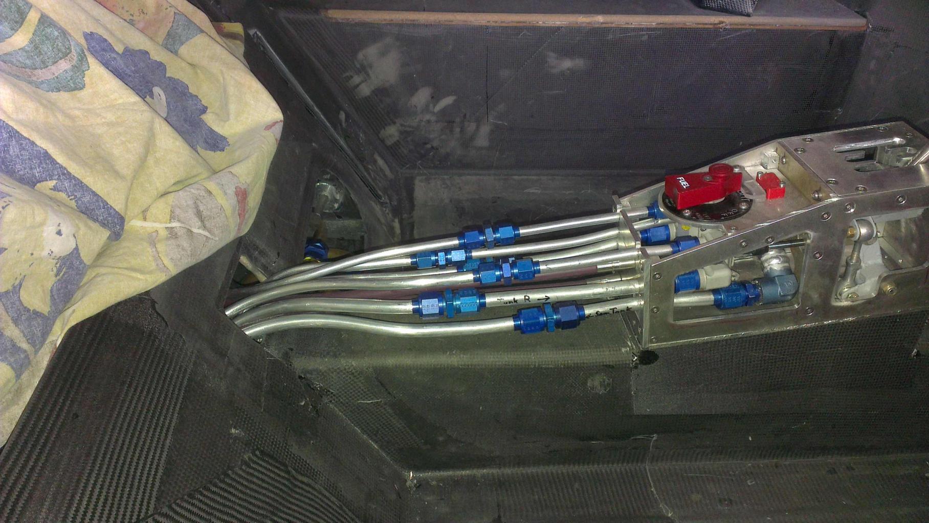

My father did some fuel linings in the car, and fitted the pumps.

Is it a Titan made steering?
seems you are working also on an 2 seats heli ? LOL !!
No Its alu.

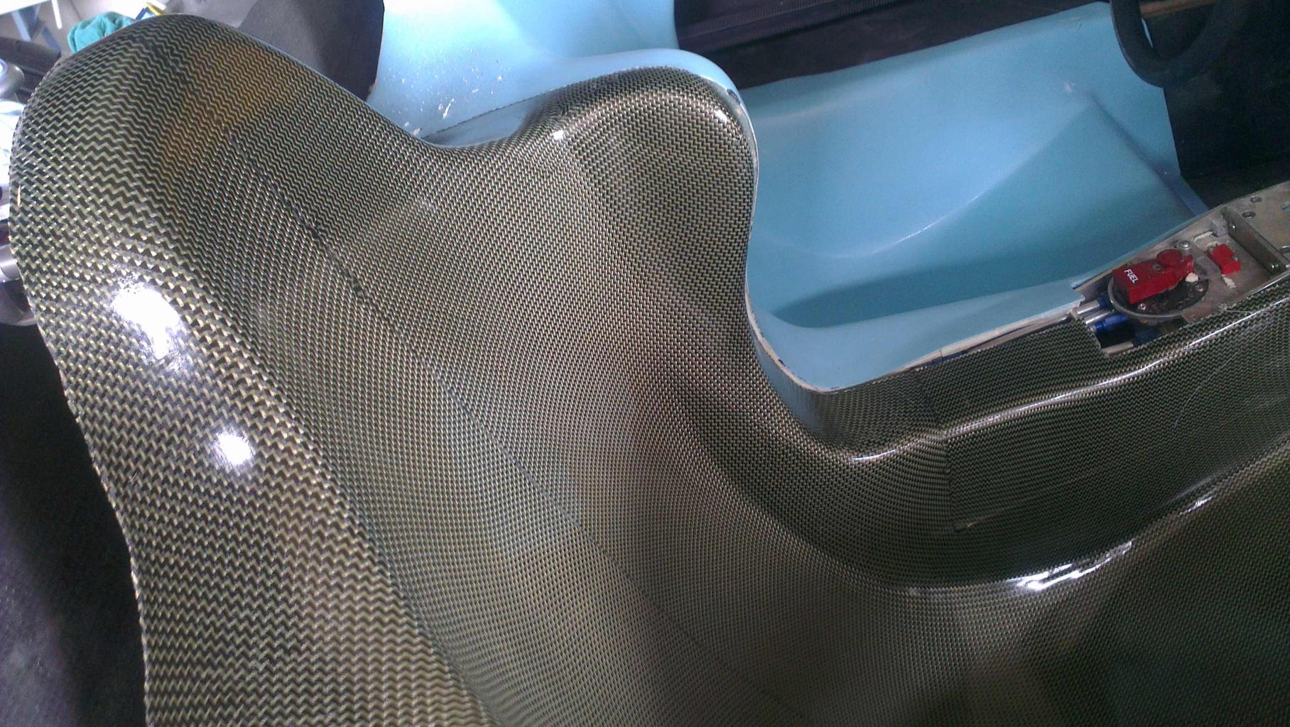

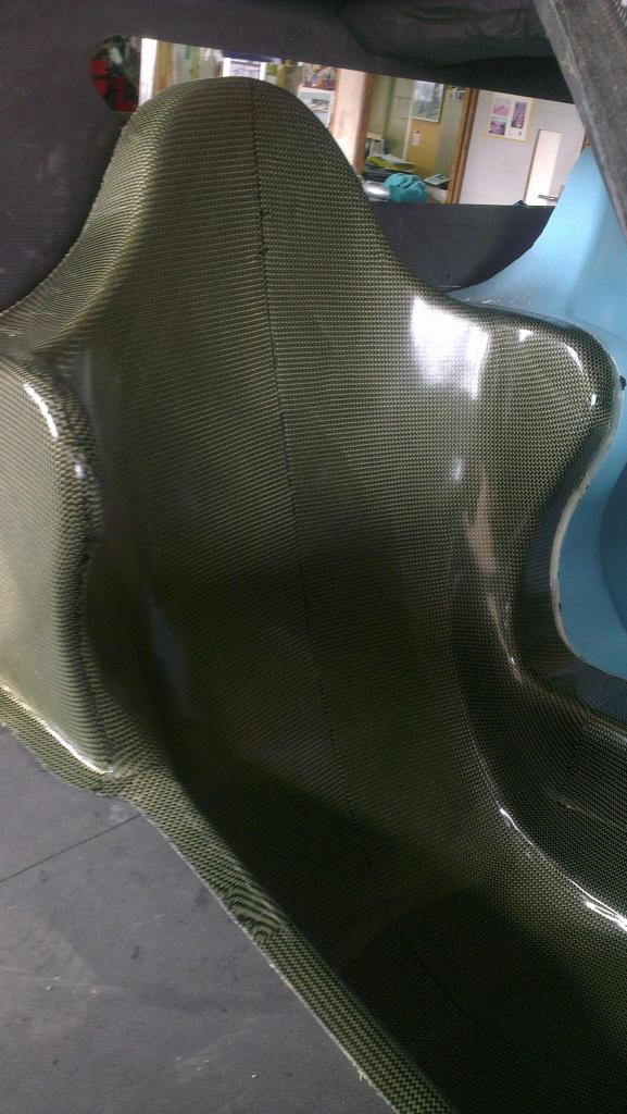

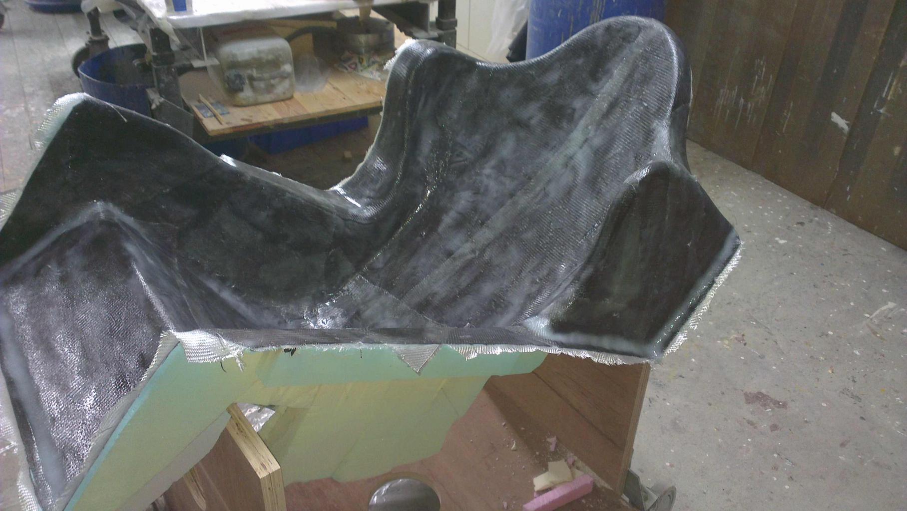

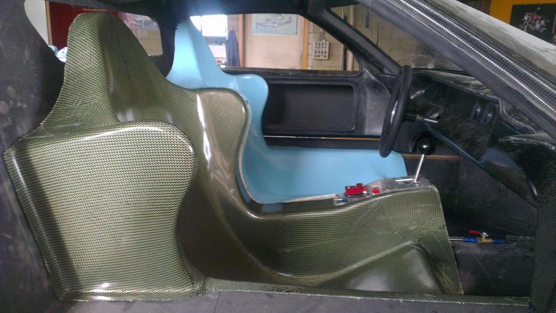

Hello again.
Yesterdey we took the first seat out of the molds, was a little bit hard but it looks good. Tonight we will laminate the second one.

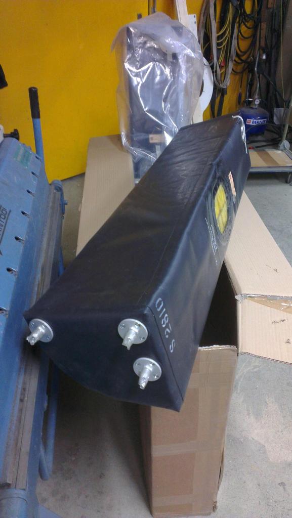

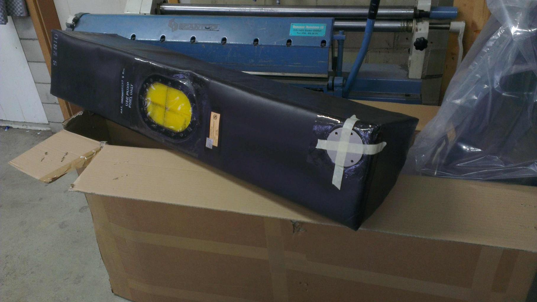

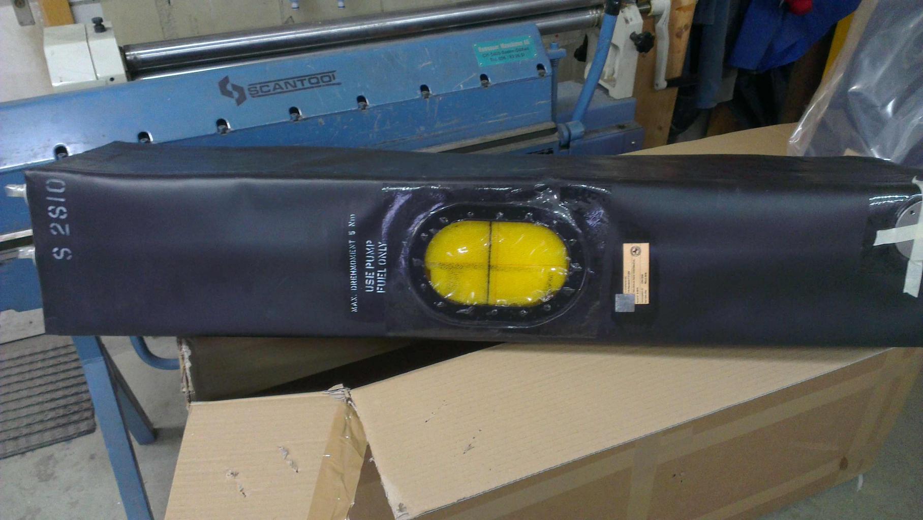

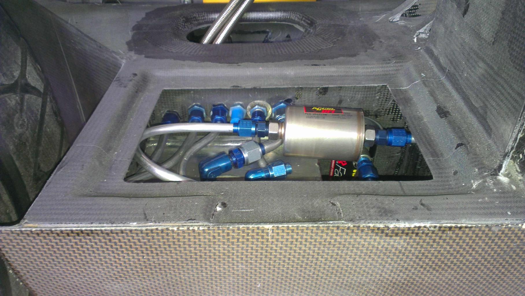

We also get the fuel cells from continental delivered.
Also the brake lines are done and the clutch cylinder line.
Here some pictures of the right seat.

Here some pictures of the fuel tanks.

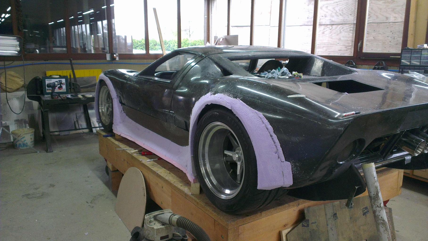

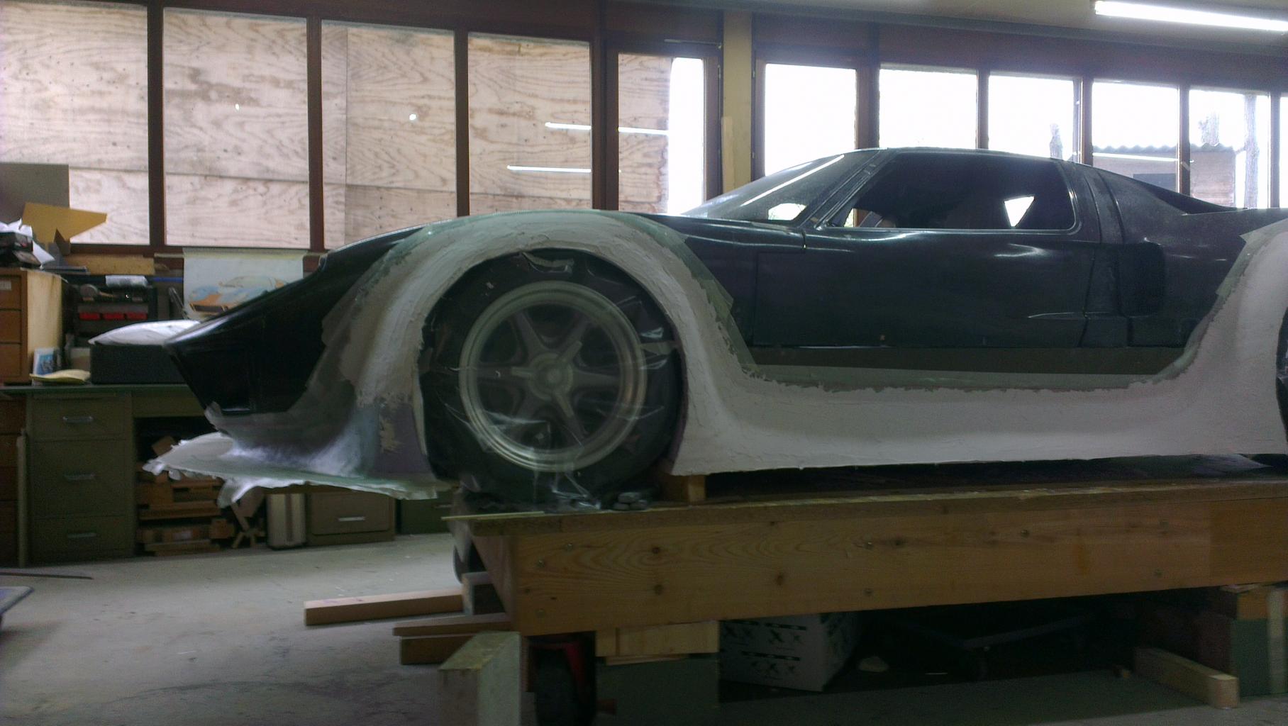

Now we are doing some bolt on body parts.

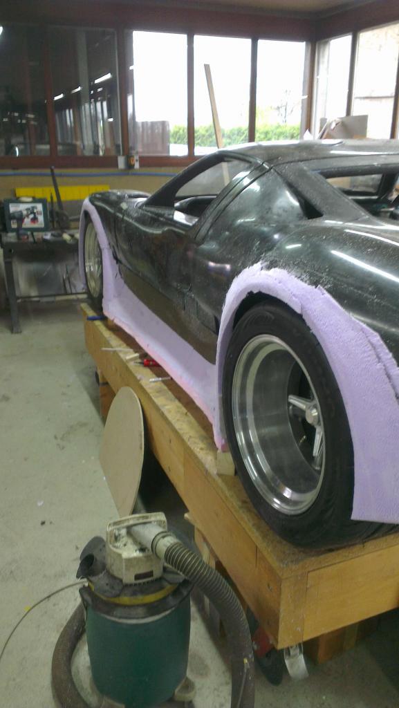

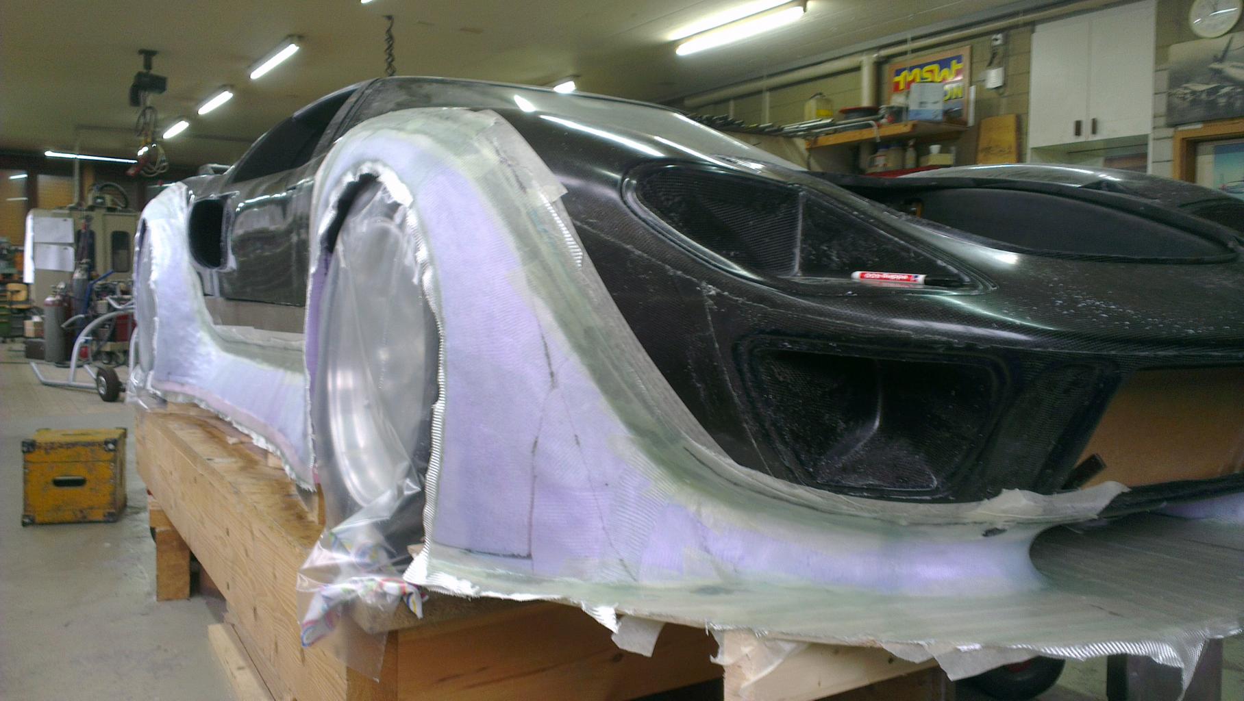

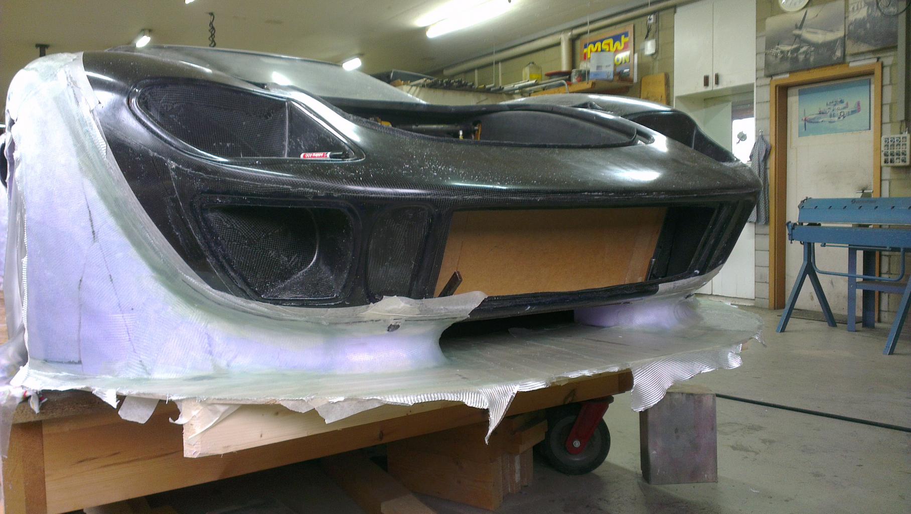

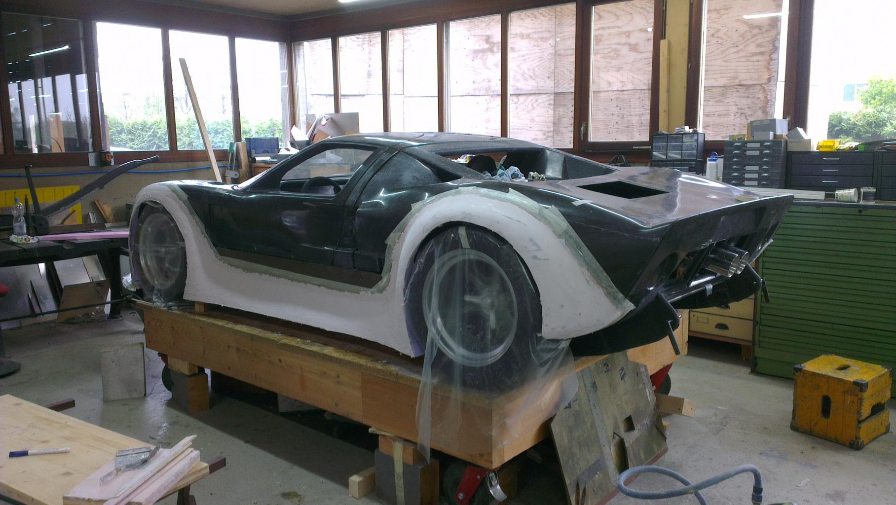

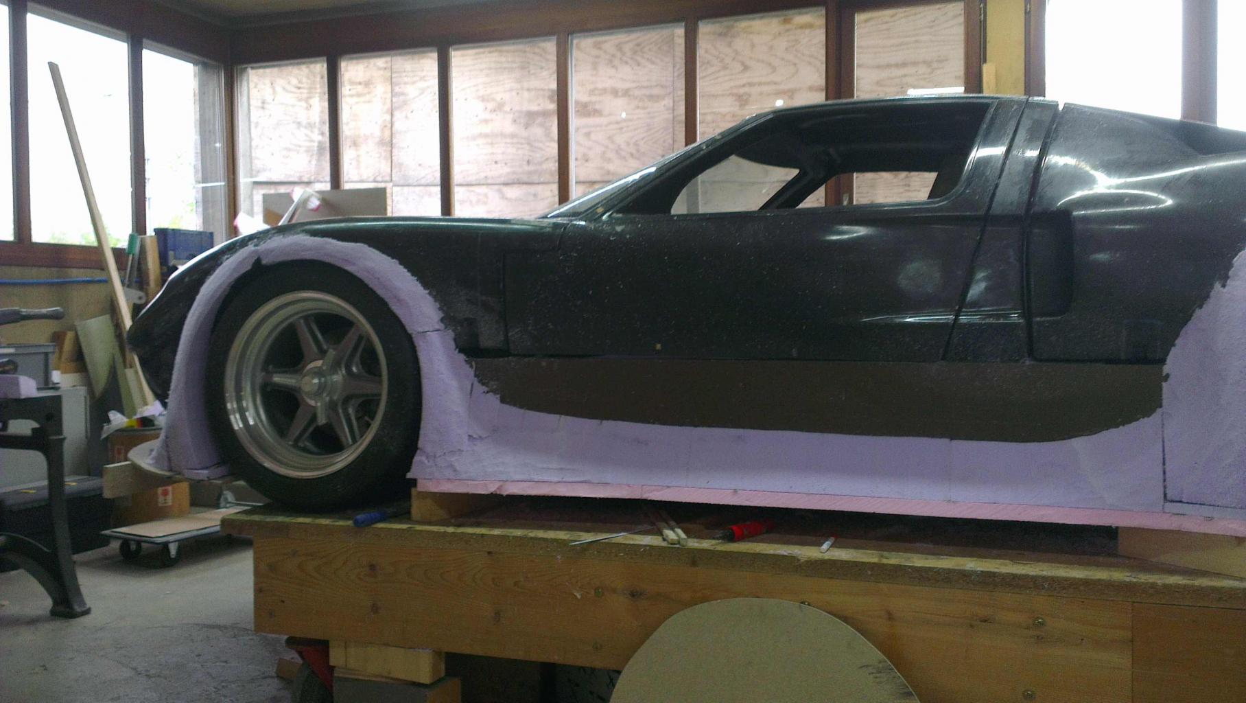

Here the newest shaping pics.
The foam is sanded now it s covered with glass and the surfacer was brought on the first side.

Hello David.
Yes we do some negativs for the extensions and make them in cf.

Urs why doing such alteration ? just for fun ot because of wheels arches too small for biggers wheels ?
it's really a shame to add carbon fiber into carbon fiber !!!! You did an excellent work and now seems to deviate to something so ....... apologise I can not write due to your so big expertise and amount of good work !!
But as usual it's your project and your own dream so respect !!
