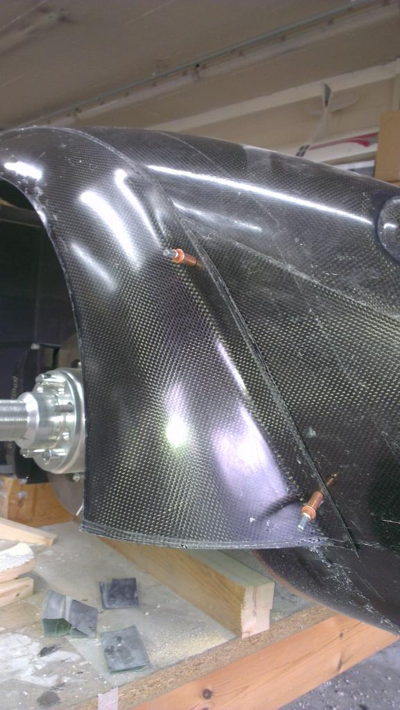

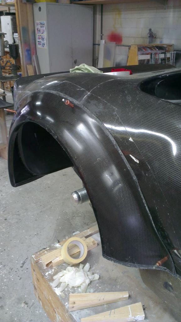

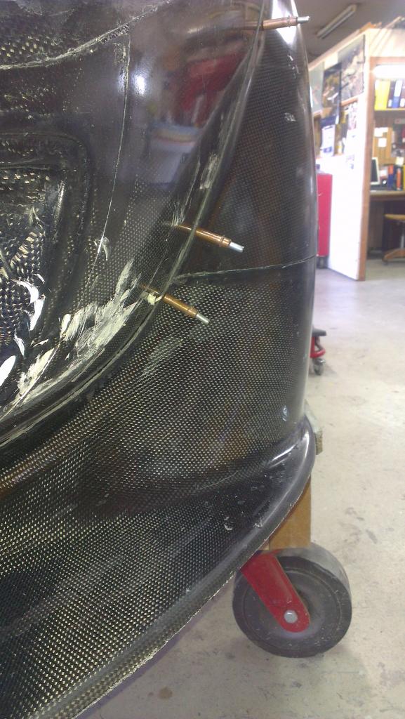

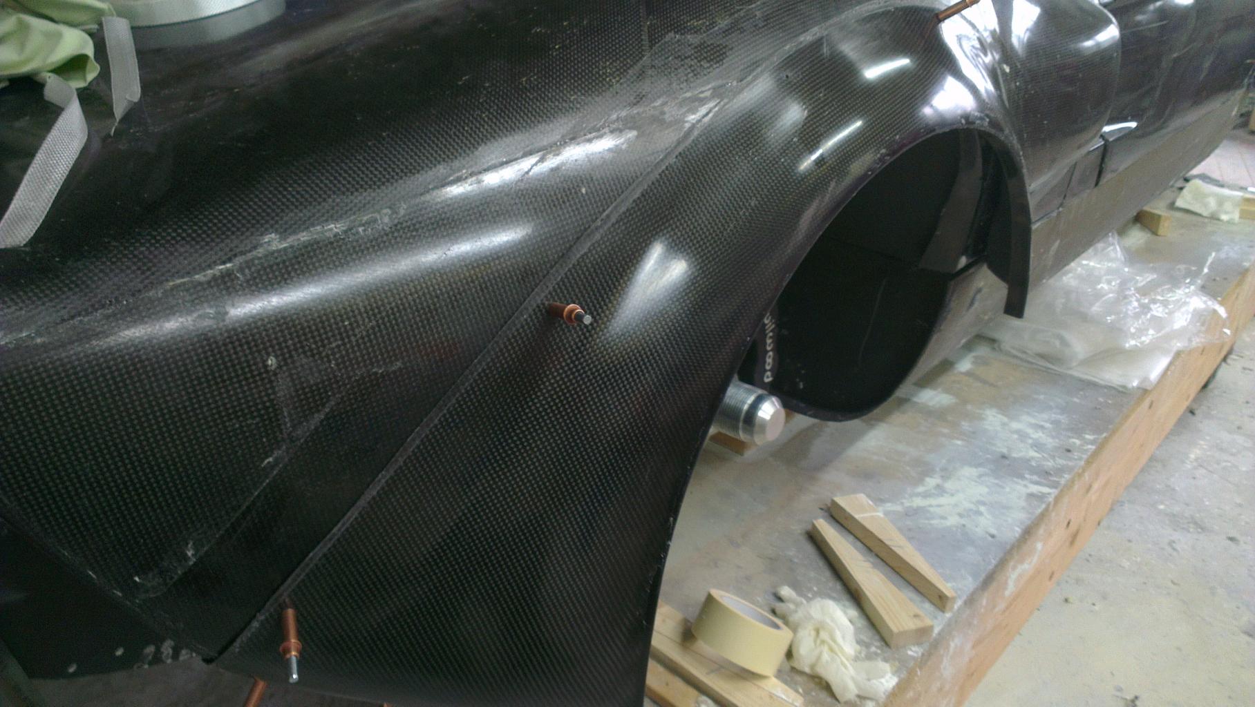

Hello together .
For the old Style gt40 Lovers please Close your eyes now ;)
We took the first Body parts out of the molds.
Here some Pictures.
We have to cut the edges properly.

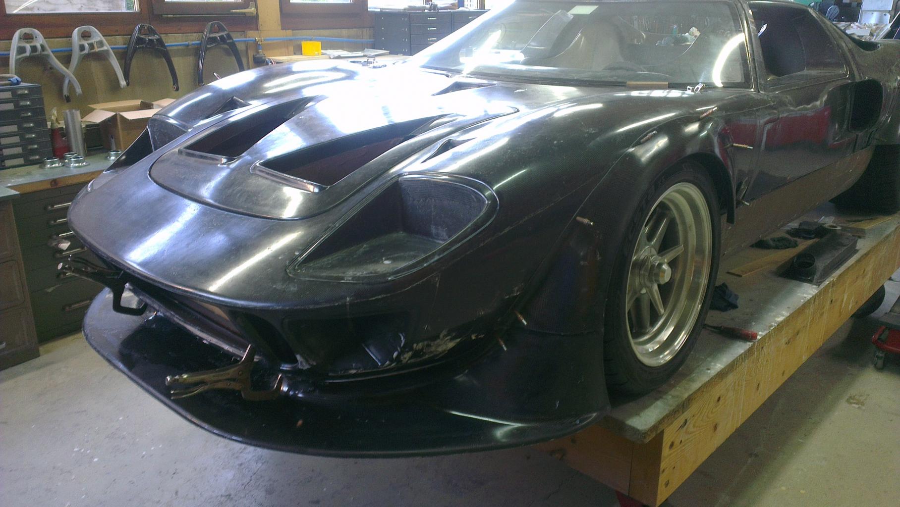

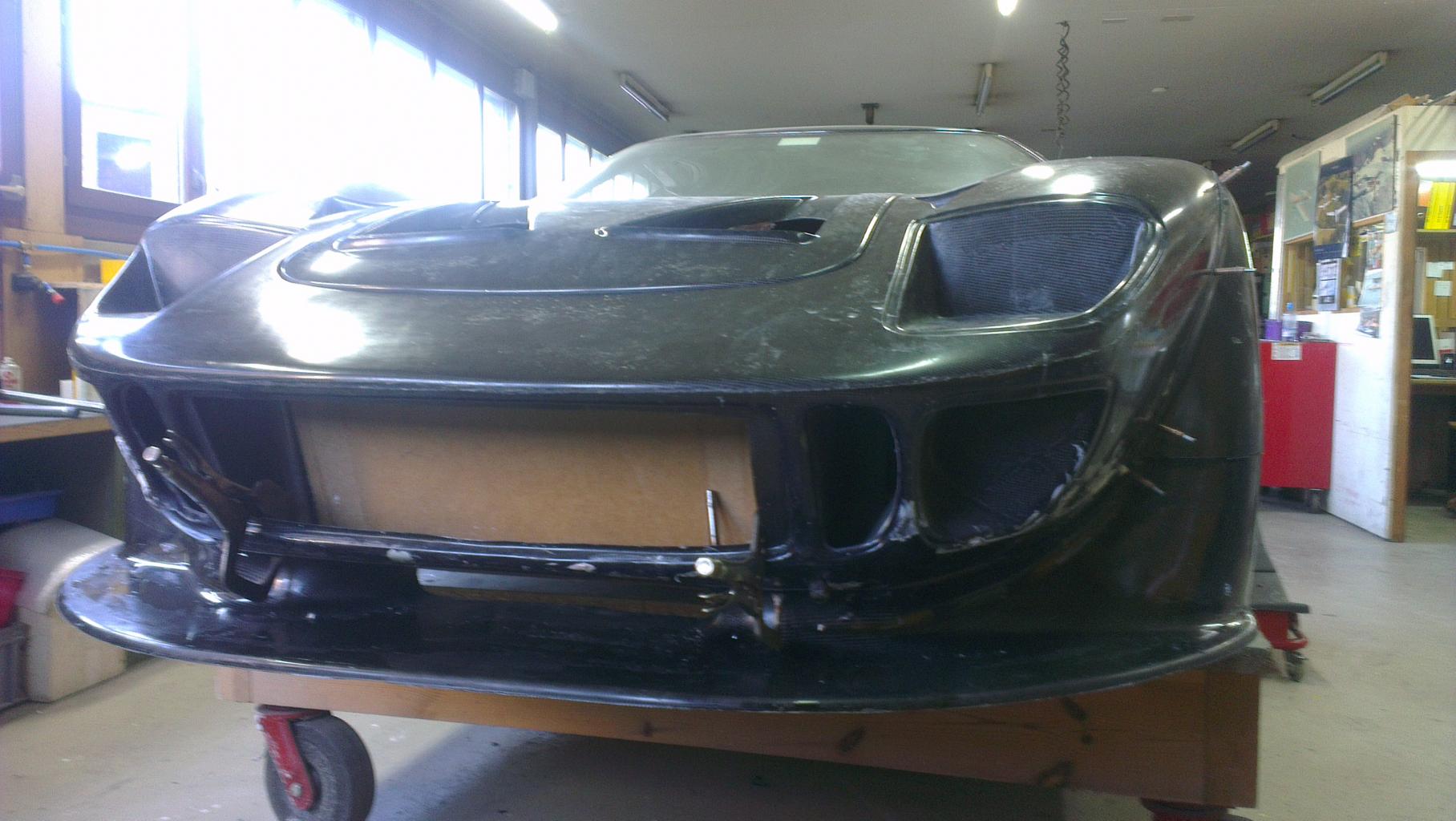

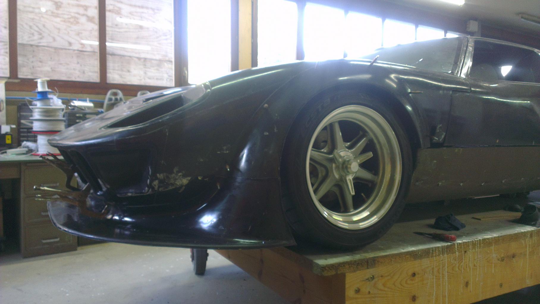

Now we took the front out of teh molds.
It fits not bad. :)
Greetings from switzerland

URS, that car is going to look wicked when seen coming down the road. CAV had a similar design front end to their GTR verison. You're also going to scrape gum off the road with that nose as ground clearance is going to be minimal. Do you have plans for raising and lowering the front of the car? Very nice.
Urs
Hello
@ JimmyP
The front is fitted to the bottom of the car and the wheel arch part will go upwards when you rise the front.
