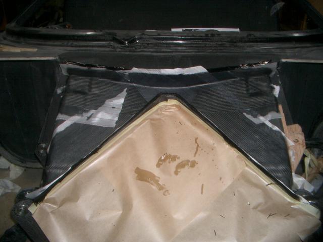

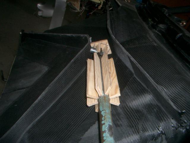

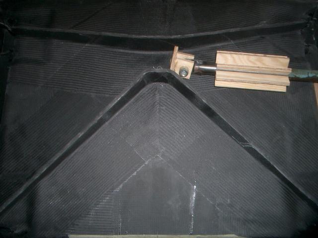

Here some pictures from the first side of the rib ,now the same on the inner side to do .

Urs

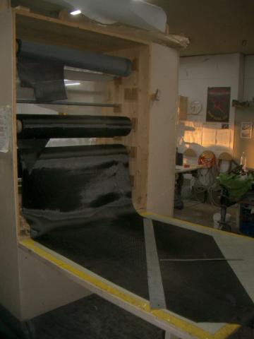

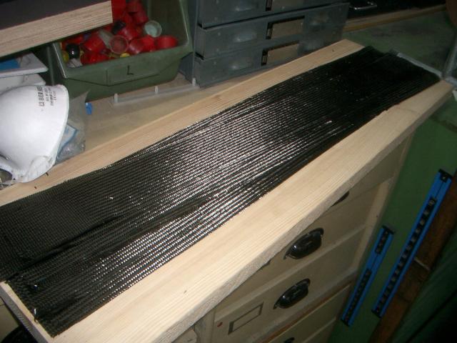

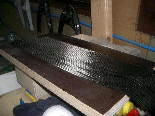

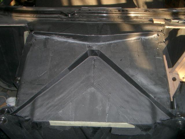

here some pictures from laminating the second side of the ribs.
You see the pre cutted layers,then the laminating is finished and it s covered with, i think in english peel ply , i hope it s the right word.
and another picture shows how it looks after remove the peel ply.

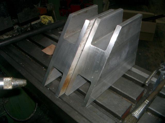

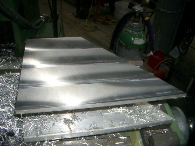

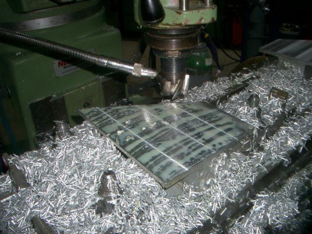

Now i started with machining the sockets for the bell crank.
On the first pictures you see the blank. Cutted of Mirage spar .
Then the first machining.
