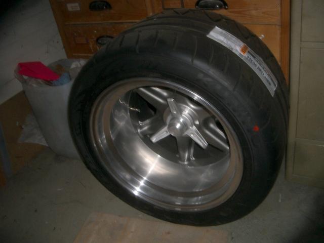

That photo has been around for about a year. The full cf wheel looks great, but is not an engineered product. Those are still way off in the future, at least for street use.
The full carbons may not be ready, but the Dymags have been around a few years. There was a set on an Audi R8 at the track earlier this year. Would definitely go nicely with this project here. But they are mucho dinero!

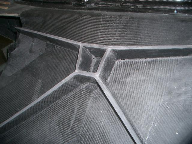

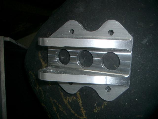

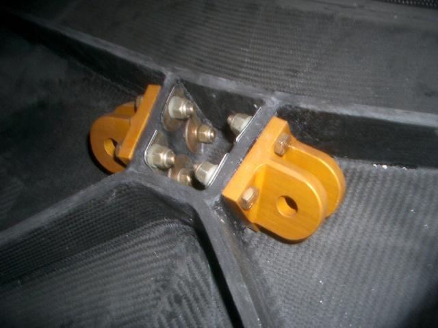

Here another picture from the cutted ribs on the nose.

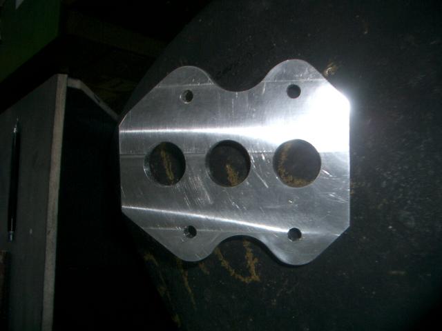

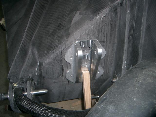

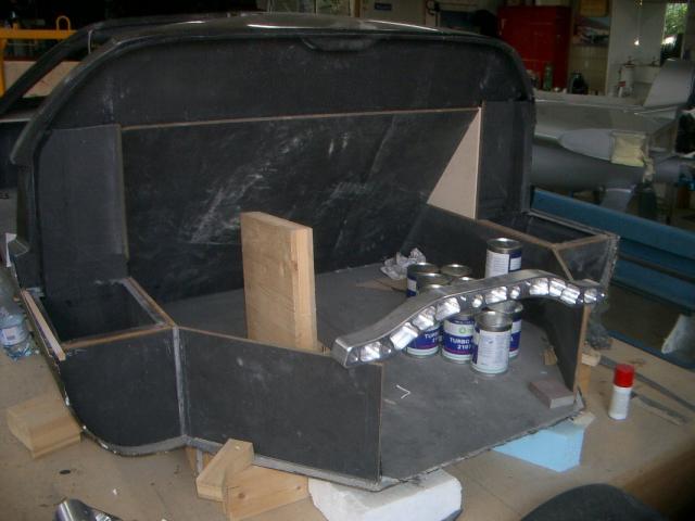

And a picture of Fran s Alu bridge, where it should be later
Are those ribbs solid carbon fiber or is there some core material in there? If so what do you use as a core?
I assume the wood patterns were not left in as the core.
Urs

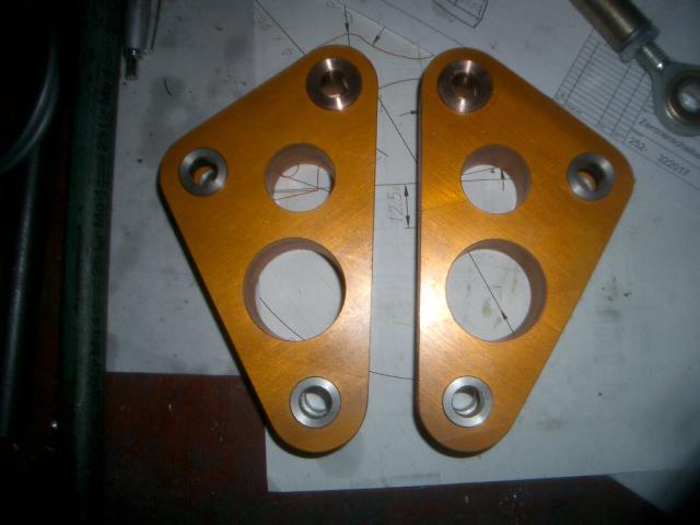

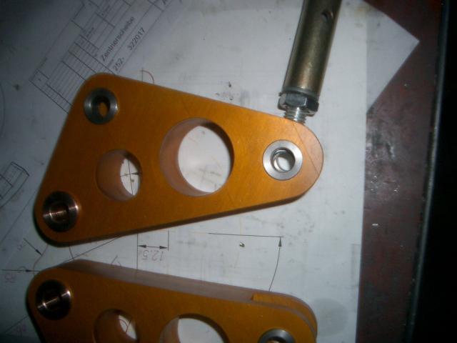

Here some pictures from the almost finished sockets for the bell crank.
Urs

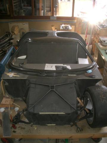

Some new pictures
Urs

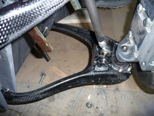

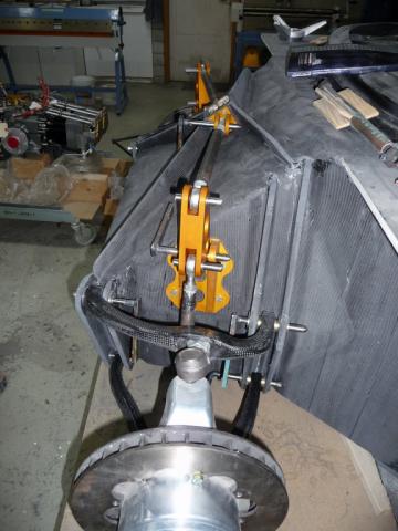

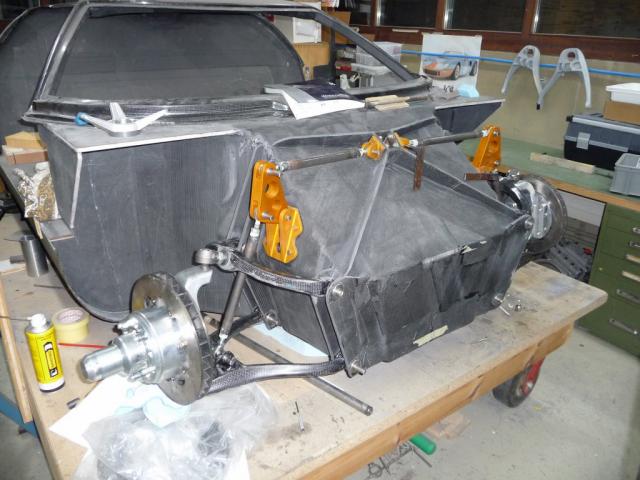

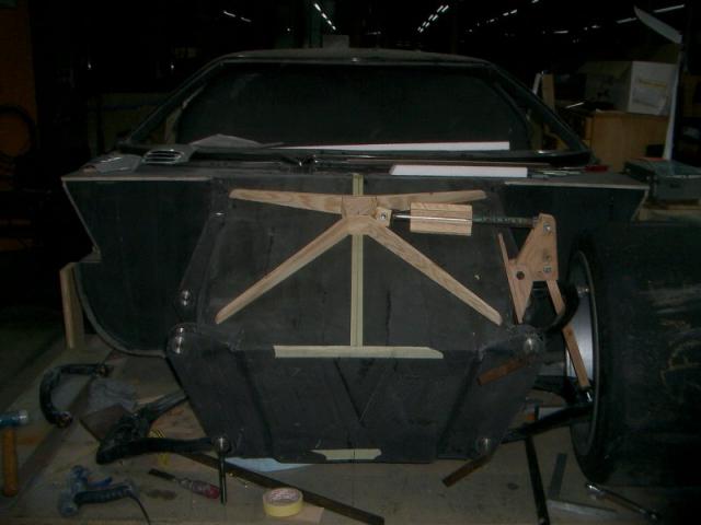

Now the front suspensiont fitted together with the temporary pushrods.
now we start with engine mount and rear suspension.
Simply beautiful wokmanship!! Absolutely gorgeous !!!
It's still difficult, being of "old school" thought, that carbon fiber can be strong enough for suspensions(yet we all know it is)!! Maybe my feelings are rooted in how the stuff comes to me as raw materials- rolls of cloth and some liquid resin to replace nice,strong(and heavy) steel. Working with composites, to me is almost like getting something from nothing(think of it, the body of your car or suspension came to you in a can and roll of cloth!!)
I know we don't think of the worst during a build, but how repairable is the chassis( in particular the chassis pick-up points) after a shunt? How does carbon and epoxy take to secondary bonds after the initial cure? Would it involve any type of heated post curing? On that note do you have to perform an elevated temp cure to this chassis when it's all finished??
Jim Rosenthal
Urs, what sort of brakes do you plan to use? The Wilwood calipers I got are very light, but maybe you plan something more exotic? Of course, we haven't seen how well they stop the car, but Superformance use them, and they weigh quite a bit more than your car is going to.
I may have asked this, but do you have an estimated weight for the assembled car, total?
