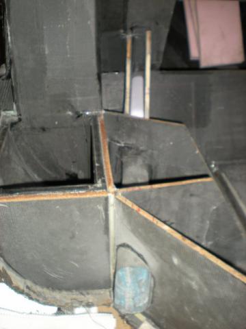

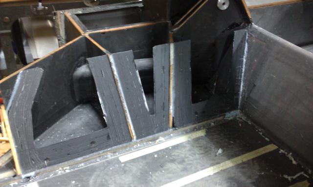

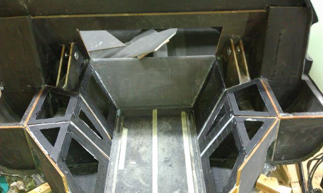

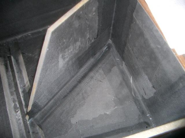

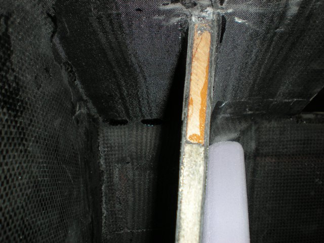

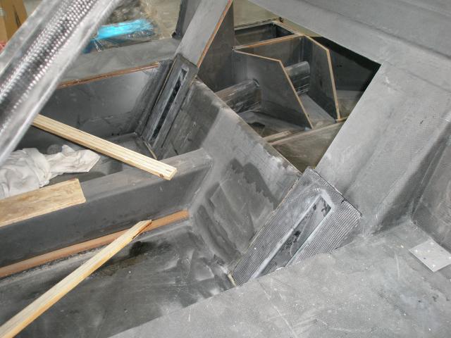

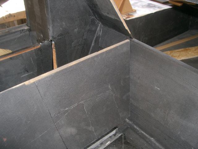

Hello together

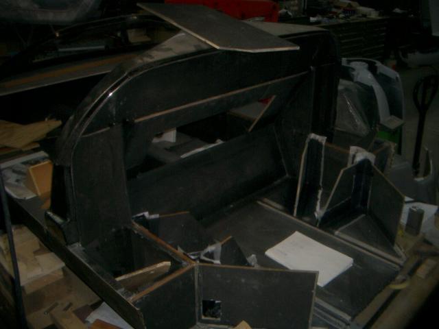

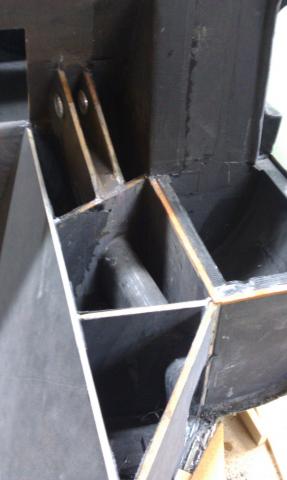

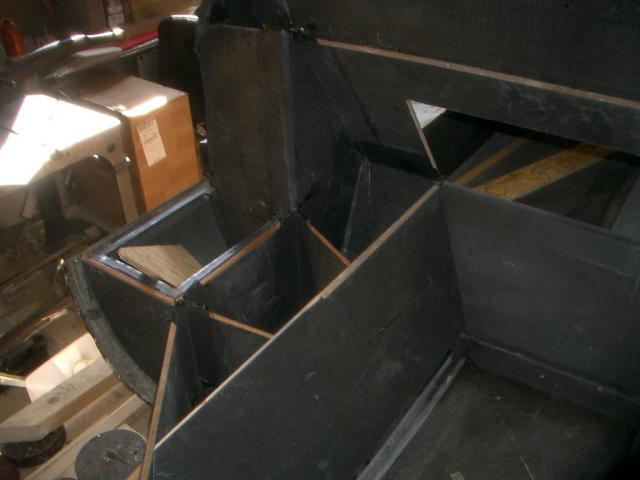

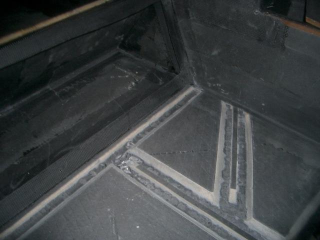

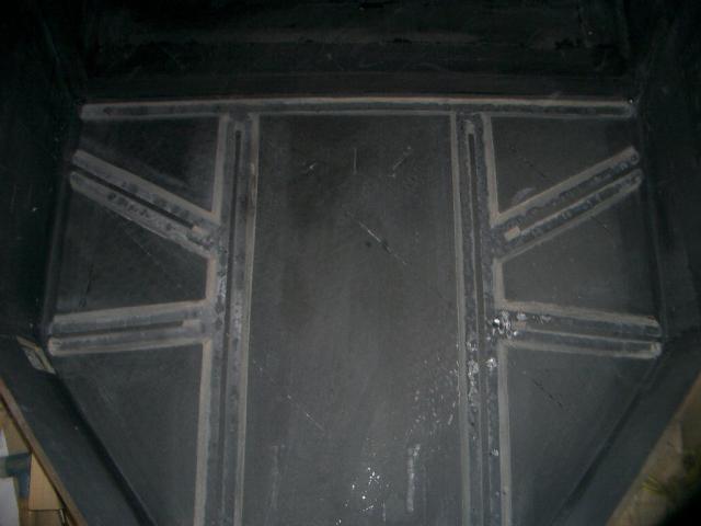

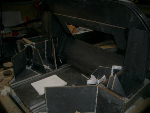

here some new pictures from the engine part of the chassis.
Urs, may i add a couple of questions to the above?
*generally, i believe you are making the flat panels individually, then putting them in position, and joining them with carbon strips, as David W is also asking about. is that right?
*are you using the plywood as the core in the engine bay area? it looks like it, and i am guessing that is for added strength?
*i realise you use vacuum bagging for the floor pan only. is there any structural advantage to vacuum bagging, or is it only about finish and ease?
*lastly, if this car is one day crashed, what sort of repair techniques would you use?
thank you in advance. your work is very impressive. i realise you said it is for a customer, but in any case i hope you see all your good work on the road asap!
alexander.
Urs
Hello together

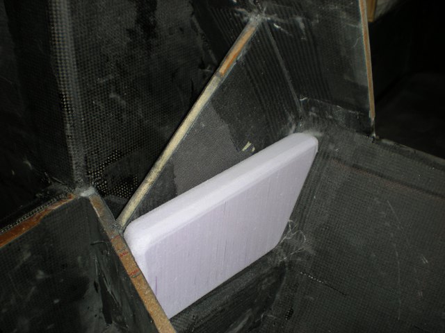

I build panels at first with hard foam core.Where it s necessary i cut out the foam core to get directly to the bottom with the carbon sandwich board.After that it will be strengthened with layers of carbon stripes.
To the second question.I dont use plywood as core, i put in, where it s necessary, a special hard plywood for some suspensions or so.
The normal carbon sandwich panels i dont vacume.
To the last point :) i hope there will never be a crash. ;)we will see.
At first i hope i get the car so far that it could be possible to do a crash with it .

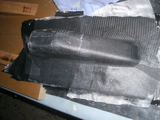

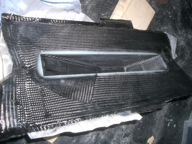

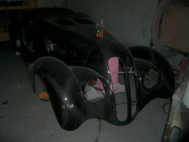

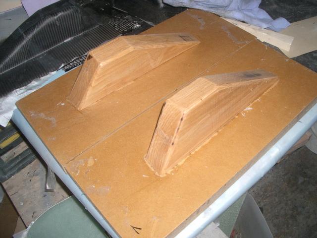

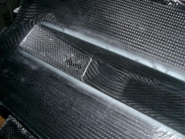

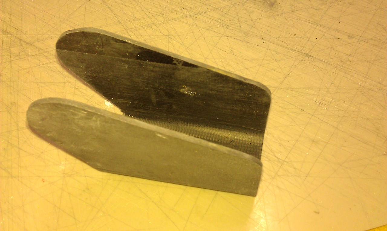

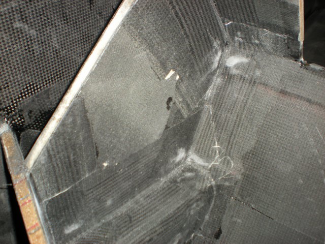

I have some picture from the lower trailing arm suspension. First the negative ,and after the part fresh from the mold. And at last another project a carbon fibre BMW 328.

ah, i just realised something... i thought you were using plywood as a core in the engine bay area, due to the light coloured edges of the panels, but i see that is actually the colour of the foam core.

Alexander, just to comment on one of your questions - yes, there is indeed a very large structural advantage to using vacuum bagging. Why? Well, the carbon is much stronger than the bonding agent, so, the higher the ratio of carbon to bonding agent, the better (assuming there's sufficient bonding agent to bond the carbon fully). Vacuum bagging tends to squeeze the bonding agent more uniformly around the carbon, and also to squeeze out any air pockets. A properly vacuum bagged carbon panel is much stronger in all respects. The downside is that it's not easy to vacuum bag all panels so, understandably, it's not always done.

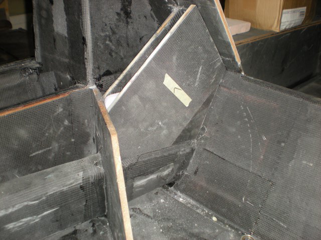

Urs

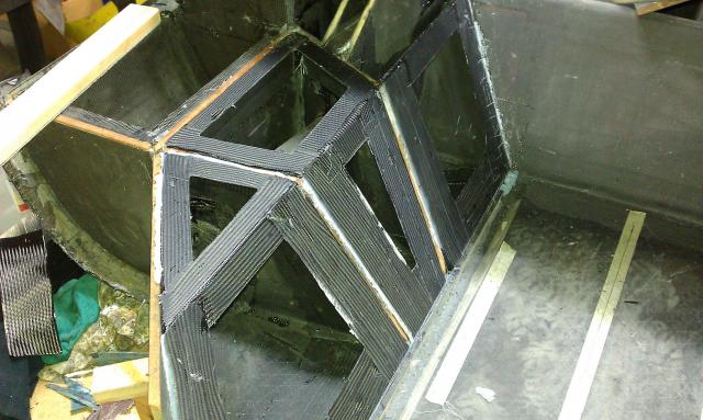

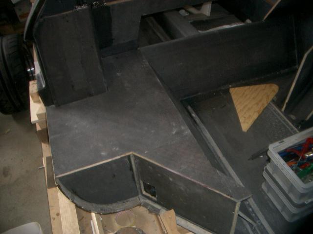

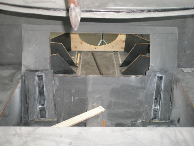

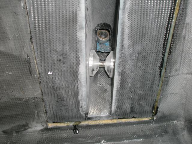

Now i m fitting in the upper hinge points .
After fitting them, i have to put in the bearings for the pushrods.
here some pictures.
A lot of work and nothing to see!!
For strengthening i put in the bearing are a special hard pressed plywood, you see it on the third picture.

Urs
The light brown material on picture 3 is PVC foam.
The Dark brown material is Delignit Panzer Holz.
Greetings from switzerland

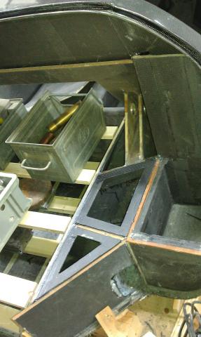

Urs

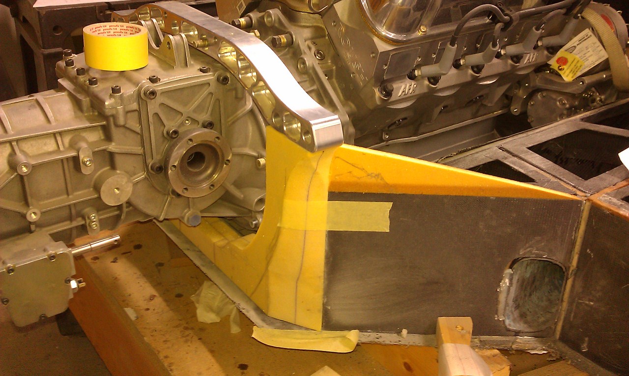

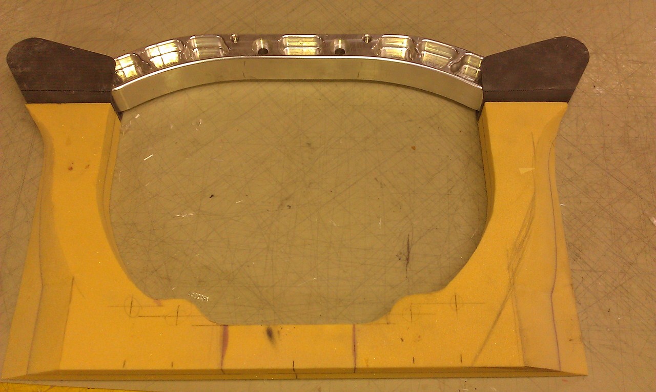

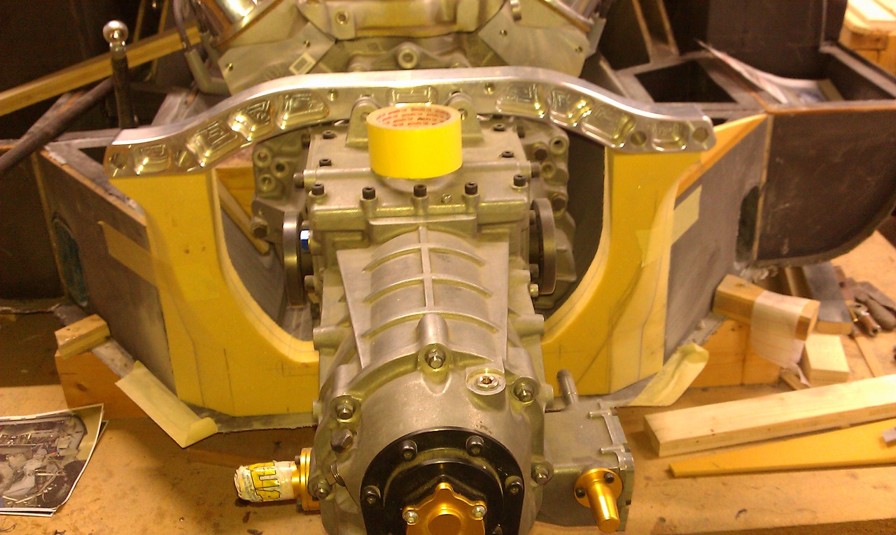

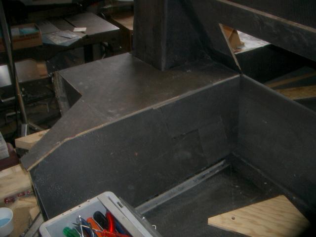

Here some new pictures.
Building up the engine mounting.

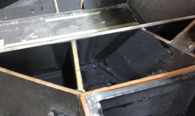

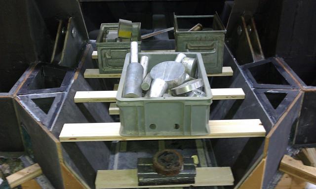

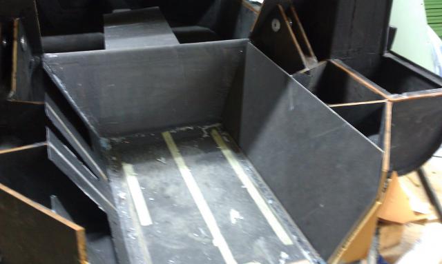

Urs

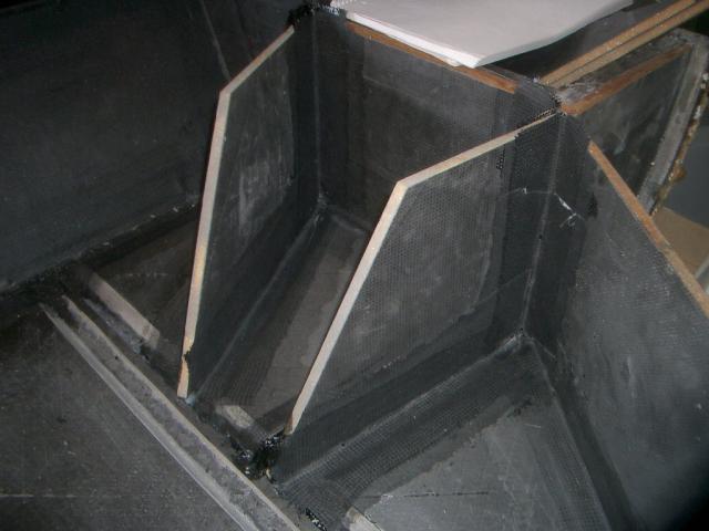

here some new pictures of the engine bay. This evening i fitted in the side walls.
