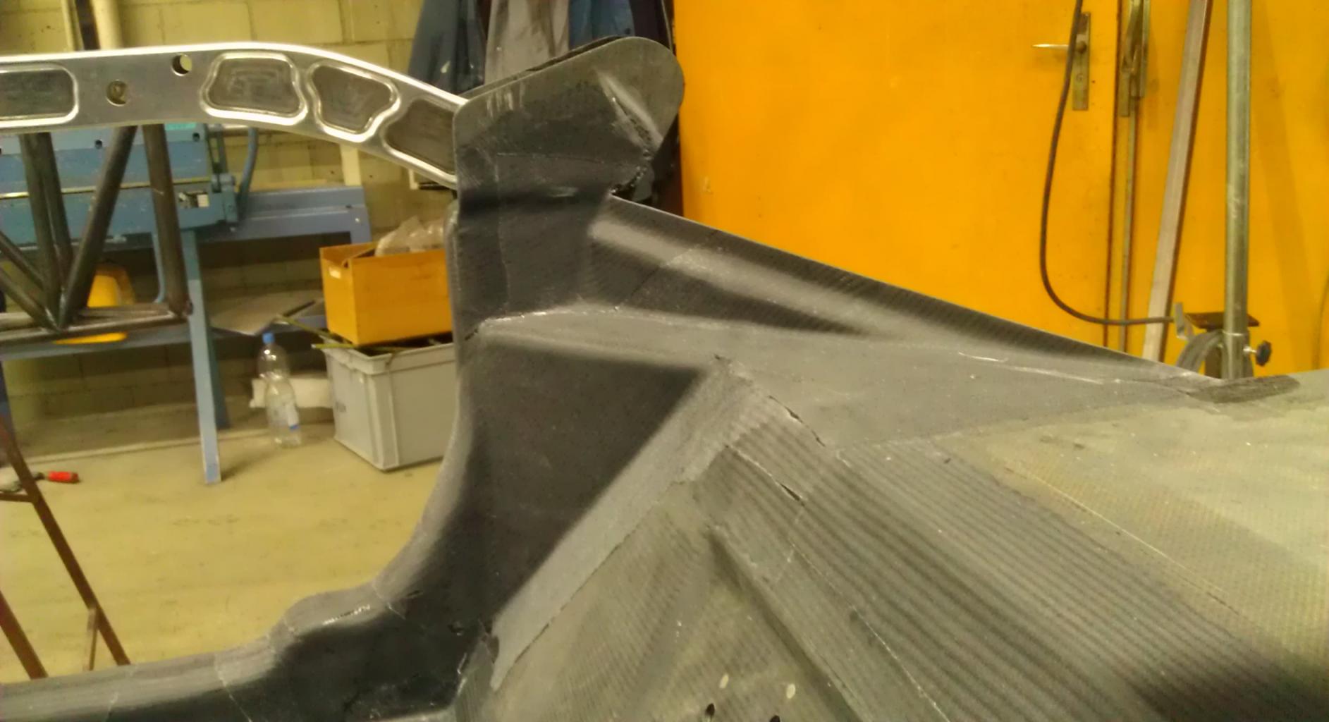

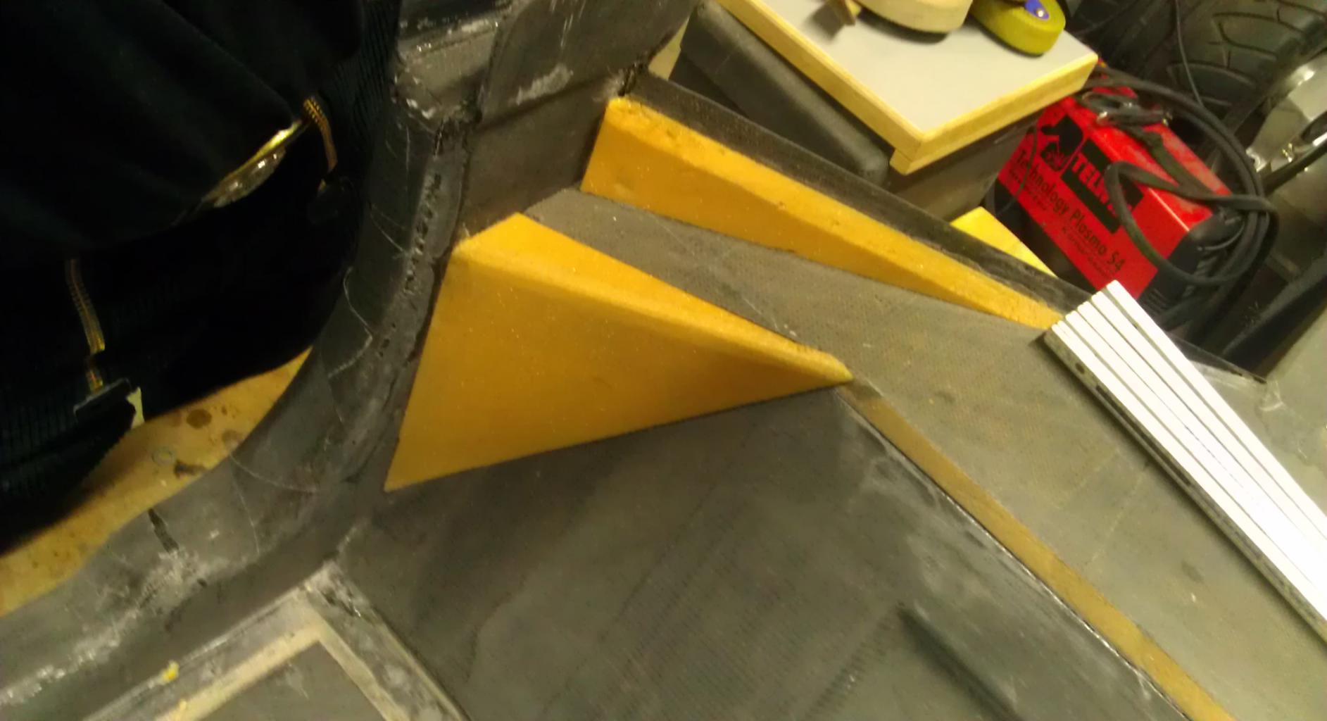

Here some new pics from the engine mount hinge points.
@ captain ahab jr
You are a F1 engineer?

Urs, do you think that the handling will be like a modern supercar? Or more like a modernised one. The suspension geometry you have changed right? And how about the positioning of the fueltanks? Will they be like in the original, in the sills? Or do you have a different idea in mind the increase the safety for sideimpact crashes etc? New supercars normally position the between the ingine and drive/passenger, right?
Urs
I hope the handling would be more like a modern car , But we will see!! I dont thinkt that everything will work optimal for the first time.
I also studied abot the tanks, but it s not really easy to bring them as low as they are in the original at another point in the chassis , but thats something that i also have to look for. , like many other things as a car build beginner. :)
Yesterday i closed the top of of the engine mount rooms.
Greetings from switzerland.

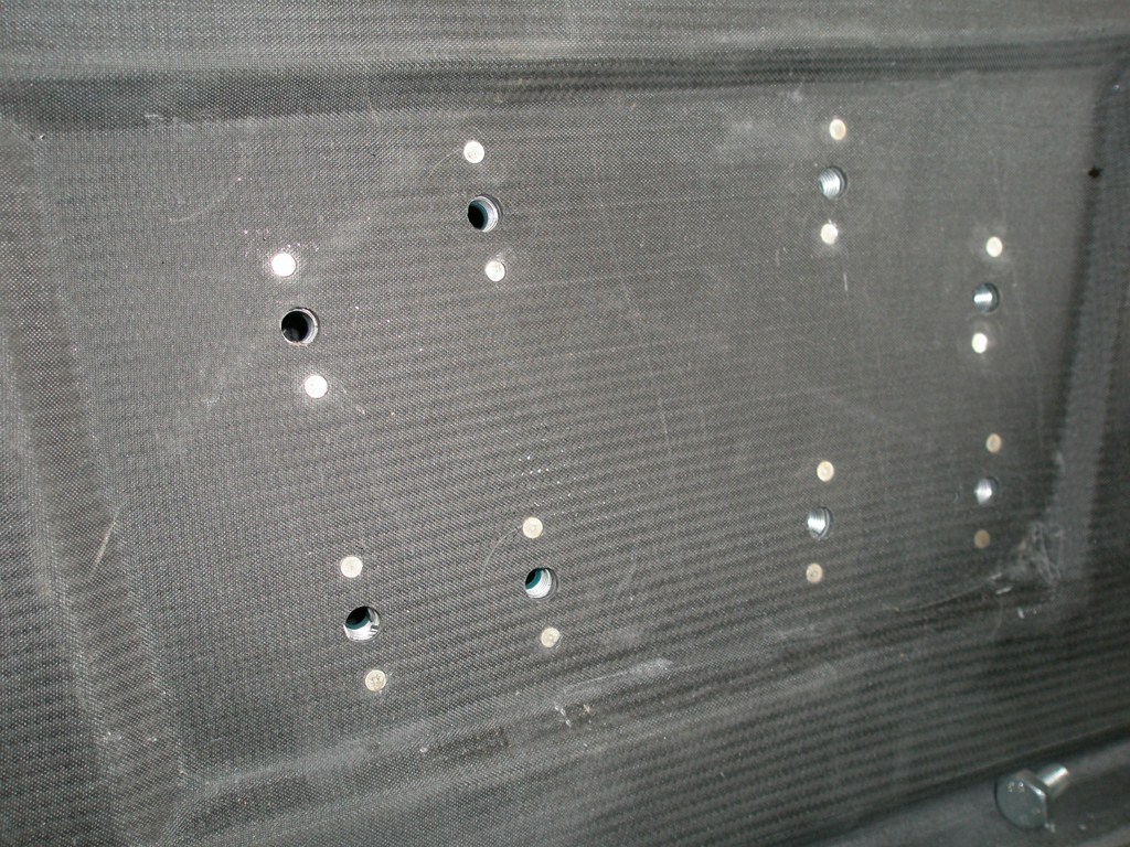

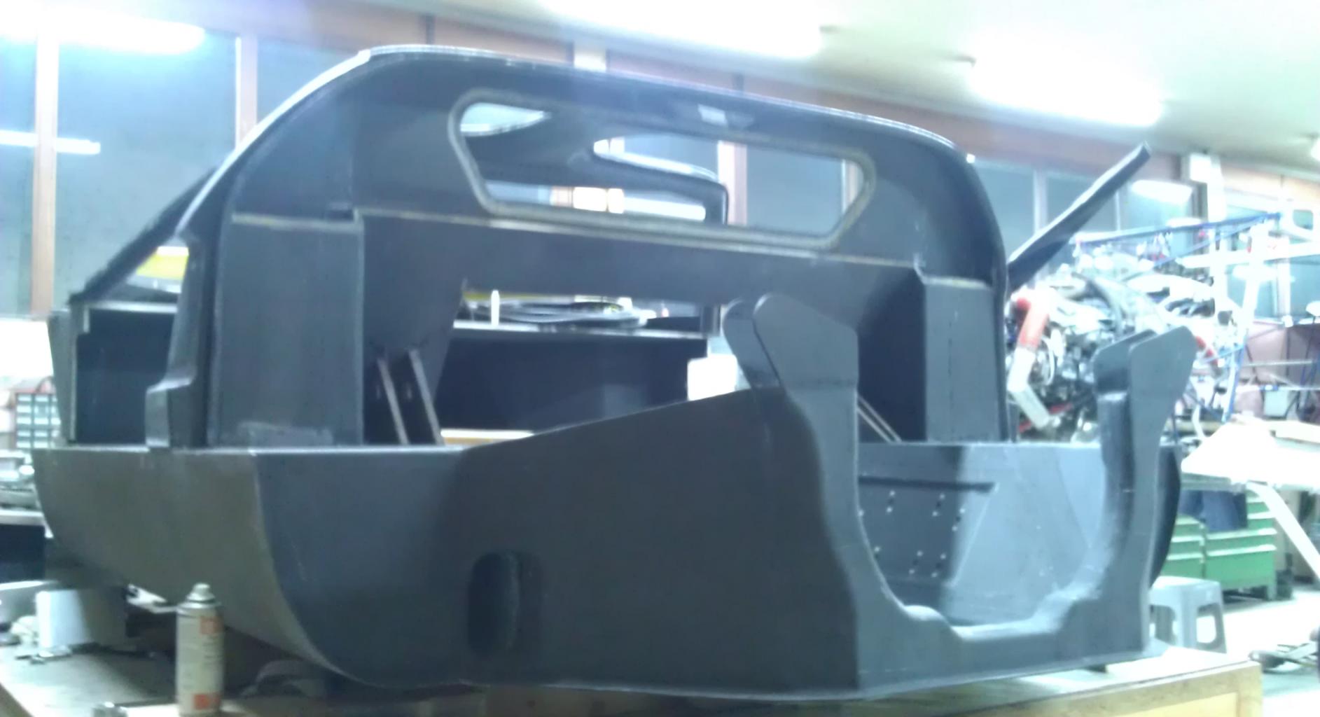

hello together :)

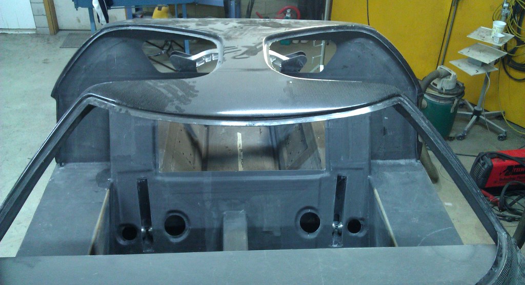

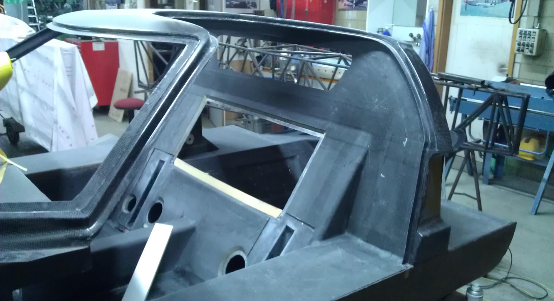

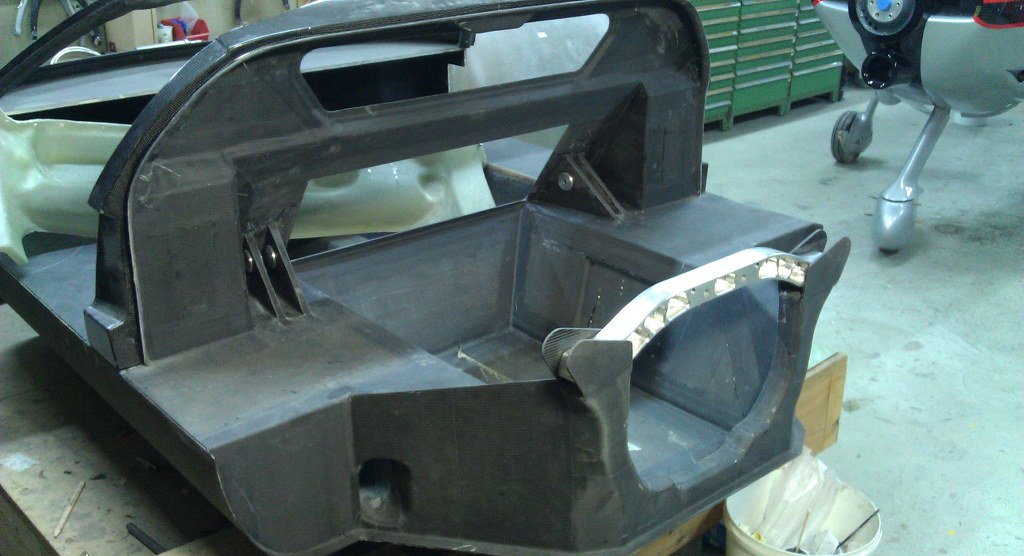

Here some picture of the latest work.

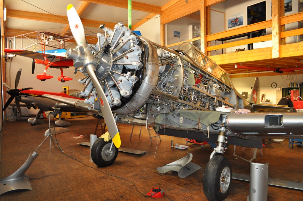

My father is also restoring a T6 with some friends. Look at the pic.

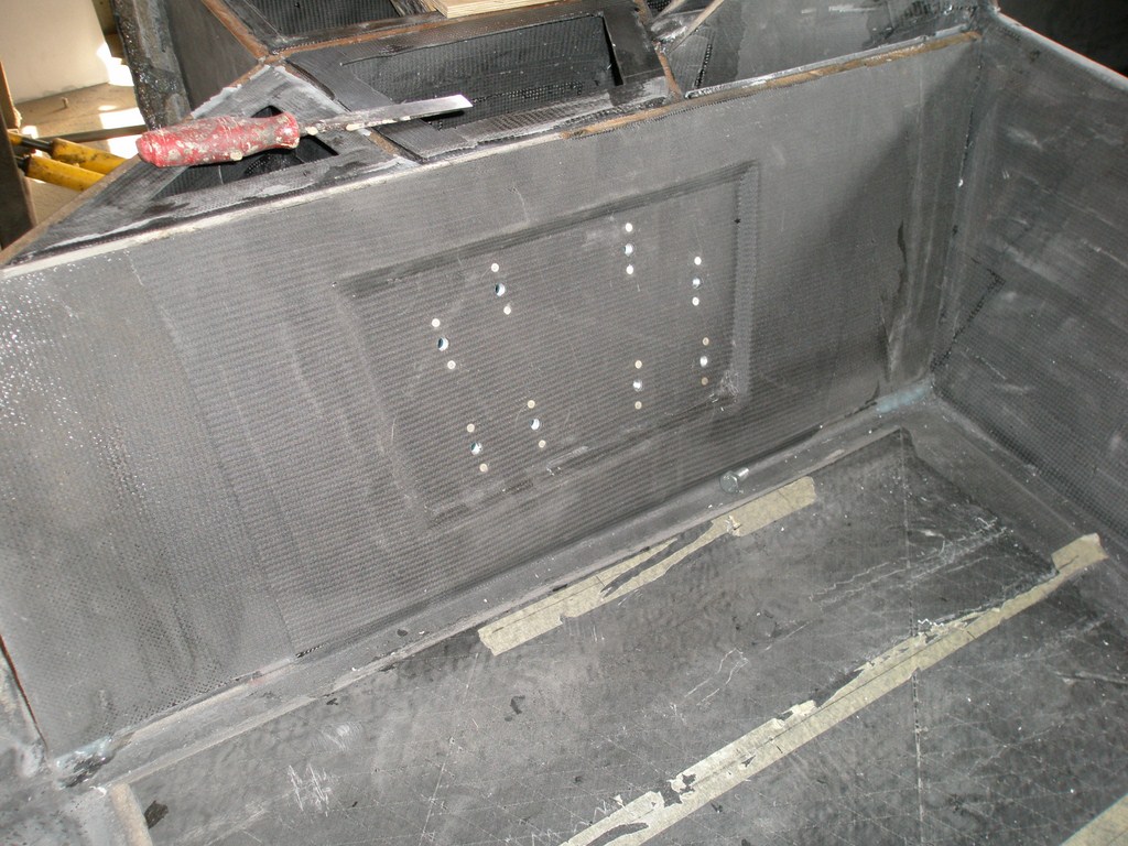

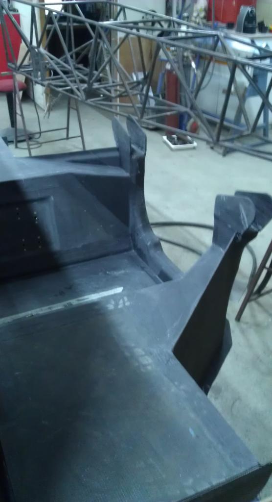

Most of the strengthenings in the backroom are done.
I have to do now some small cutouts for some tubes and cables.
And i also have to drill the holes for the rear suspension.
Now someone has a good idea for cable shifting kit? And i also search a good pedal system and a watercooler.
Thank you
