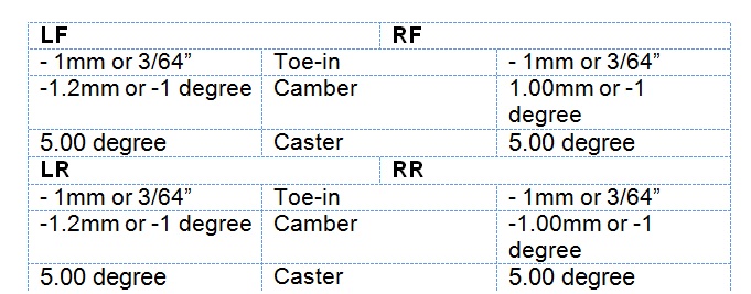

Also, anybody know what the caster/camber/toe should be for front and rear??
Here you go:
