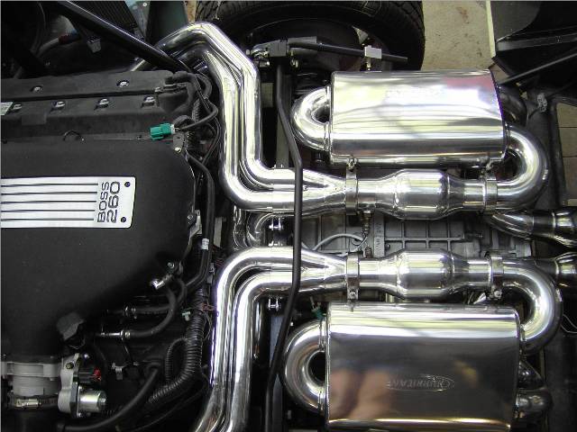

Martin,
Australia requires cats (I believe) on the cars registered within the last few years. I have seen several photos of these Aussie cars fitted with cats. While I can't direct you to a specific example, they are here on the forum. I'd suggest looking through the Builder Log Forum for Aussie built cars and I'm sure you'll find what you are looking for.
Lynn

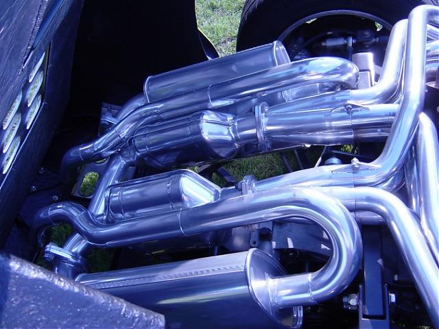

Hi Martin
In Australia we have to fit cats but the dont need to look ugly if they are done the right way.
I have attached a photo of my system.
If you need to see more check my build thread.
Dimi

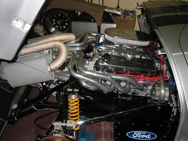

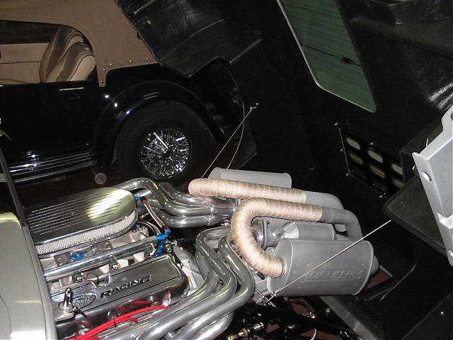

for what it's worth here is a photo of my 347 windsor with cats installed (prior to the "race only" system)
Like you 'race only' system much better Rick! Got my replacement clutch from KEP, so will get car registered soonish I hope.
