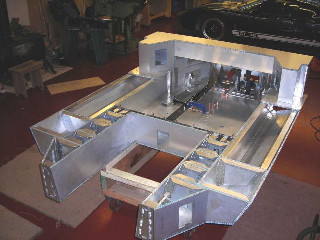

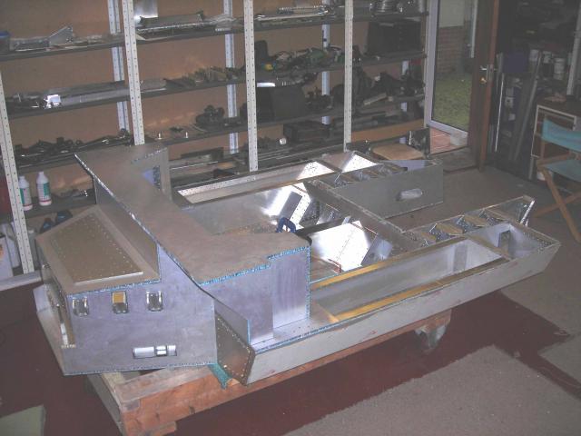

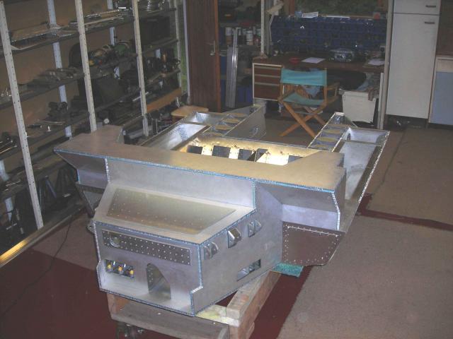

Hi Scott,
Estimating the final weight of my chassis has proved problematical. The weight of the Mk4 chassis has been quoted as 85 lbs, but what does this include? I think this is the weight of the base honeycomb shell and does not include any of the mountings required to feed the loads into honeycomb. Also I do not think it include the front and rear sub frames, the rear cradle or the A and B pillar assembles. If you add all these bits I suspect the weight will be considerably more than 85lbs If anybody has any information about this I would be very interested to hear it.
Certainly my chassis will weigh more than 85lbs, but the weight will include the considerable additional weight of all the various mounting brackets for suspension etc. The weight of the honeycomb itself will be about 80lbs, but added to that is the aluminium filets used to hold it all together. I have erred on the side of safety with the suspensions brackets, so these are probably weightier than is necessary, as is the rear cradle. I will attempt to weigh what I have built so far which should give a fair idea (when I can work out how to do it). From all this you can deduce that I am not too sure what it will come out to weigh, but it will not be that light!
