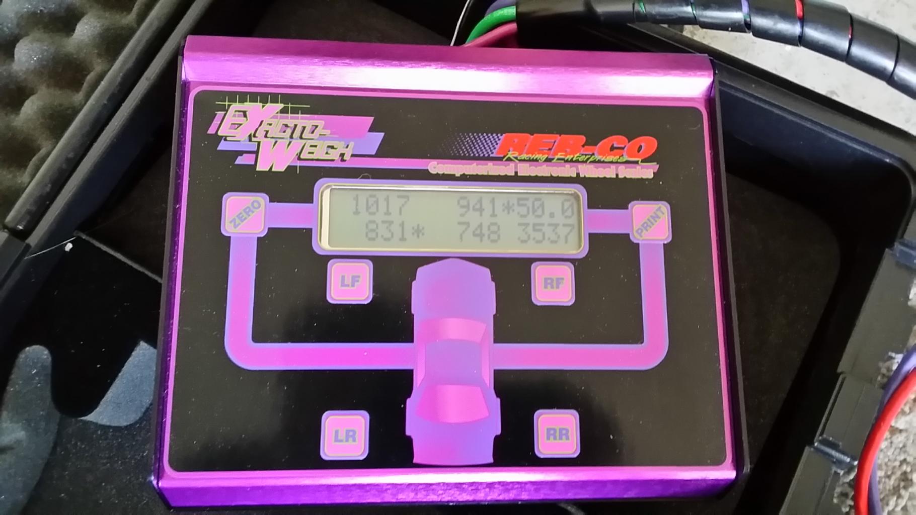

The car is an old f-body and will be impossible to achieve a perfect 50-50 side to side weight distribution because if the drivers position. But, i can achieve a 50-50 crossweight - though, this means that either one of the front tires or rear tires is going to have to carry more weight.
If i have more weight on the rear left tire, the car should tend to have more oversteer in right hand turns due to overloading that tire first. But, will this also exacerbate spinning the inner tire when exiting the corner?

50-50 cross weight is what I have always aimed for with corner weights when not a single seater but perhaps checking to see if you have an LSD might help more?
I have the cross weights to 50-50 now, but I was a little worried about the amount of weight on the left rear. I guess I'll take it like this and see how it goes.

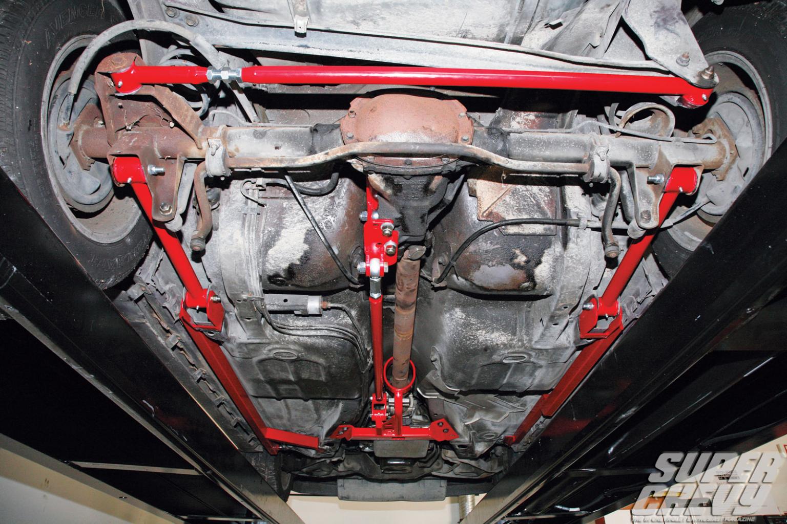

Gen 3 isn't it? IIRC those things have the long torque arm off the diff. It is offset toward the LR wheel so transfers more weight to the LR, as per this pic notice the aftermart bracket on the housing can be shifted toward the centre, this should help in your case. Also have you shifted other items like driver set toward centre & battery to try and achieve more equal weight distribution.

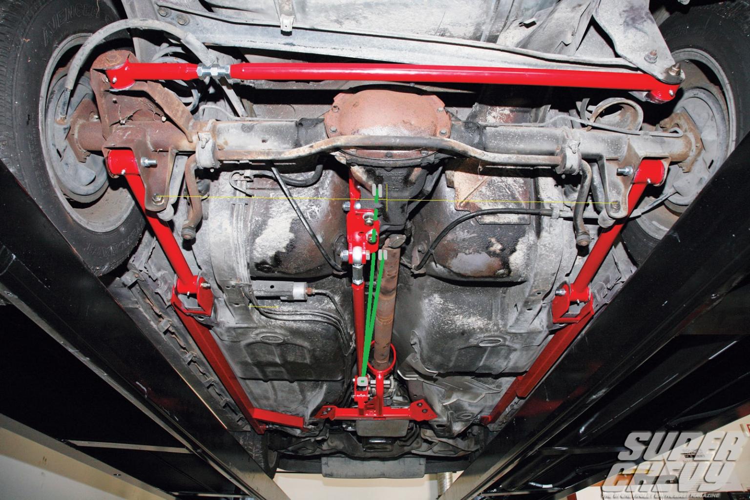

You need to fabricate a new bracket for the torque arm so that its attachment points are closer to the center of the rear axle housing( Green & Silver), also the forward attachment point to the chassis should perhaps be closer to the longtitudinal centreline of the car, but you will have to factor in any offset weight & engine torque for that as well ( It might help to make the chassis & housing brackets wider with spacing washers to allow fine tuning, redesign of the torque arm to ensure driveshaft clearance a must do!).
That stout axle bracket on LR for panhard will also be adding a few pounds of unsprung weight to the left rear.
Still concerned about your LS unit, would prefer to see a type that locks rather than just applies resistance under power application
