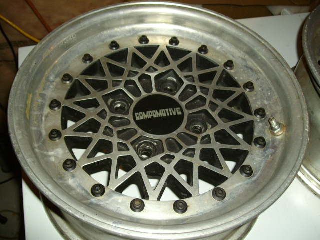

Cory and I went over the CAD drawings yesterday.(8Hrs) They are just about done. We will finish them up this Saturday. I will try and post a small 3D picture in the future. They are done in Solid Works 2008 not Pro Engineer. We have incorperated a few engineering changes to make it stronger and safer as per input of some of you guys on the site in contact with me and changes we found done on the B19 chassis pictures. Right now I am going to assemble the two front uprights and get the them ready to mount. I am also getting my wheels in order. Media blasting wheel centers, new seals and I have to get one more Compomotive 3" outer for the rear so I can maintain the proper backspacing for the wheels all the way round. The new chassis should go pretty quick now that I have solved many of the problems with the old drawings.

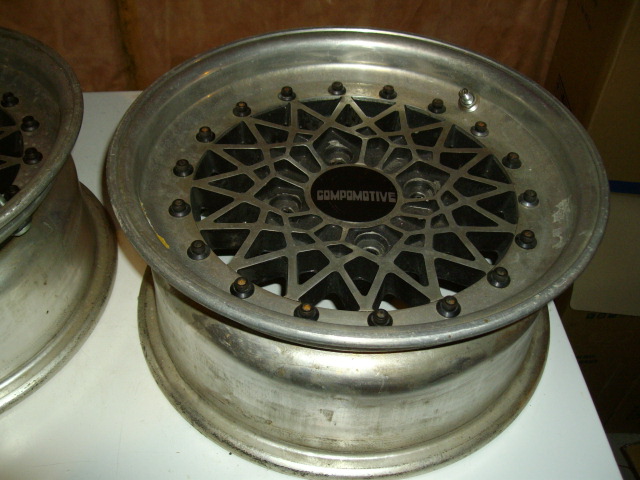

Just a few wheel pics. I have been working on the rear centers and may media blast tomorrow. Here are the fronts. I picked up some older compomtive wheel centers for these wheels of ebay a while back.
Dave
