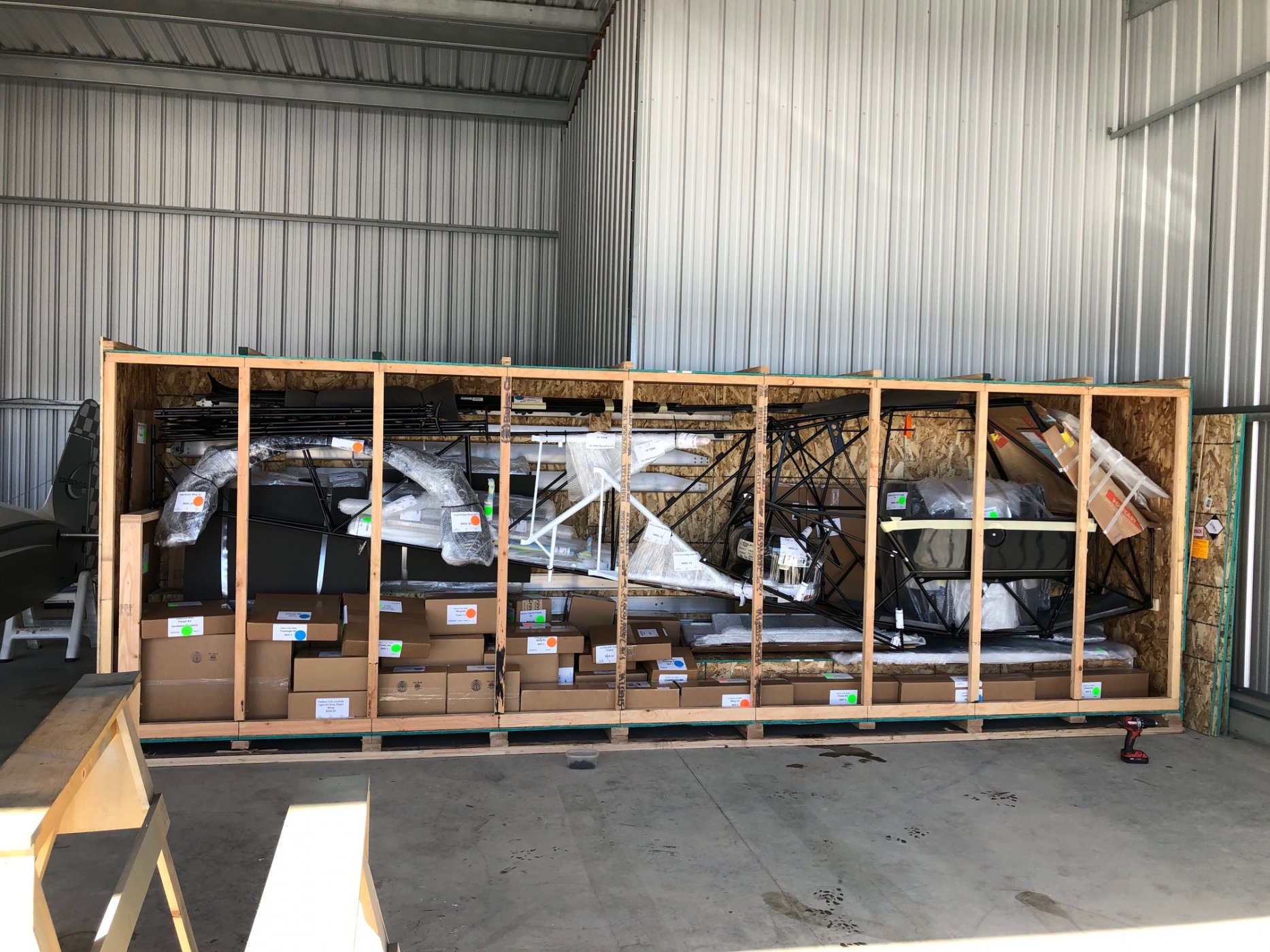

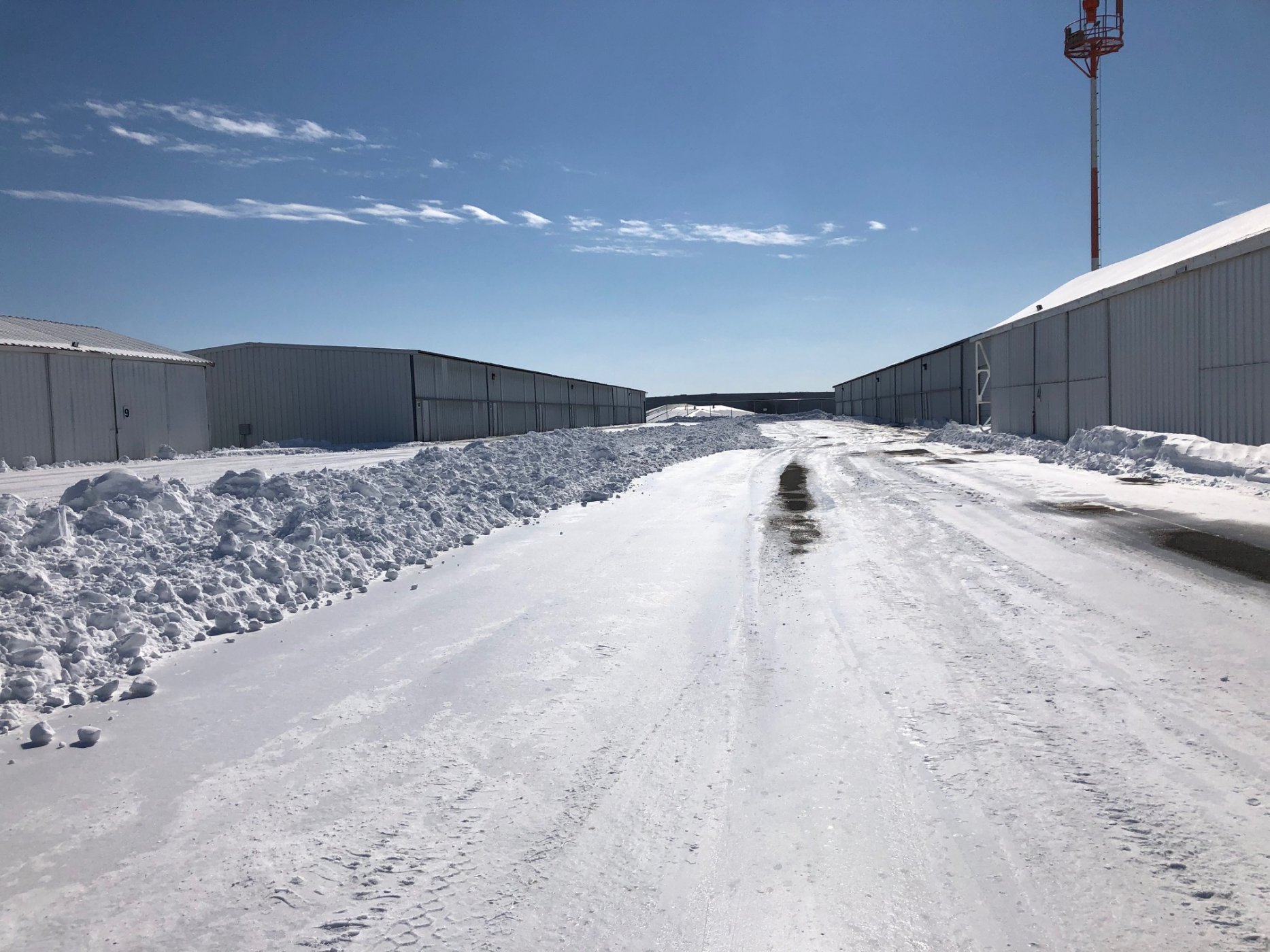

On the worst weather day of the year in mid-February, a Carbon Cub EX2 kit was delivered to the airport where my hanger is located. How bad you ask? Due to ice, wind and snow, KMWA was shut down to air traffic about the time the truck pulled up. But we were able to get the 18 foot long, 1600-pound box unloaded in a large hanger where it sat for a week before the ice and snow had cleared enough to move it to my hanger.
Once in the hanger the box was opened, parts removed, and box torn down. Parts needed to build the wings were moved to my home shop where construction has now begun.
I will post occasional updates here, but much more detail can be found at the Cubcrafter’s forum.

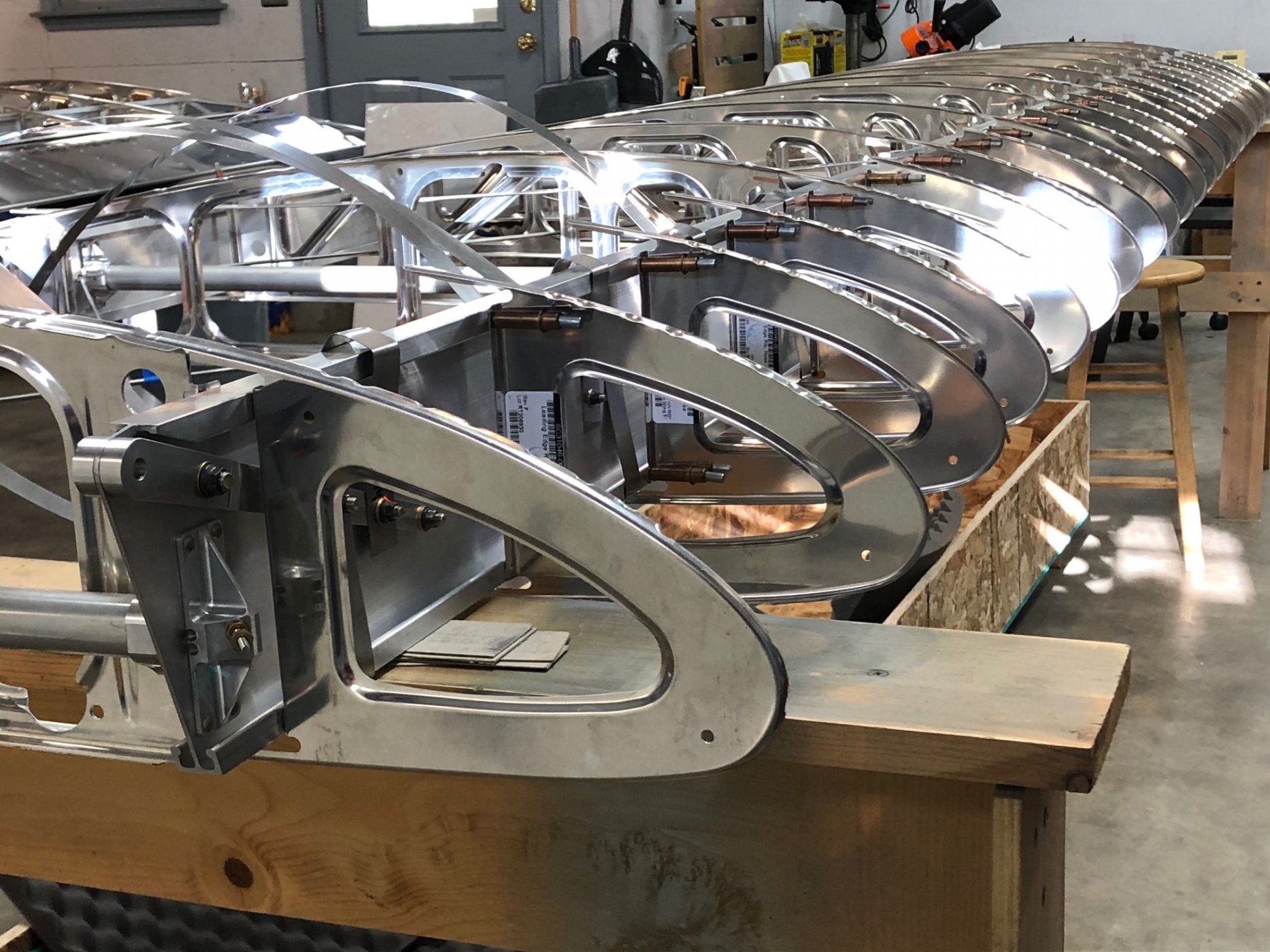

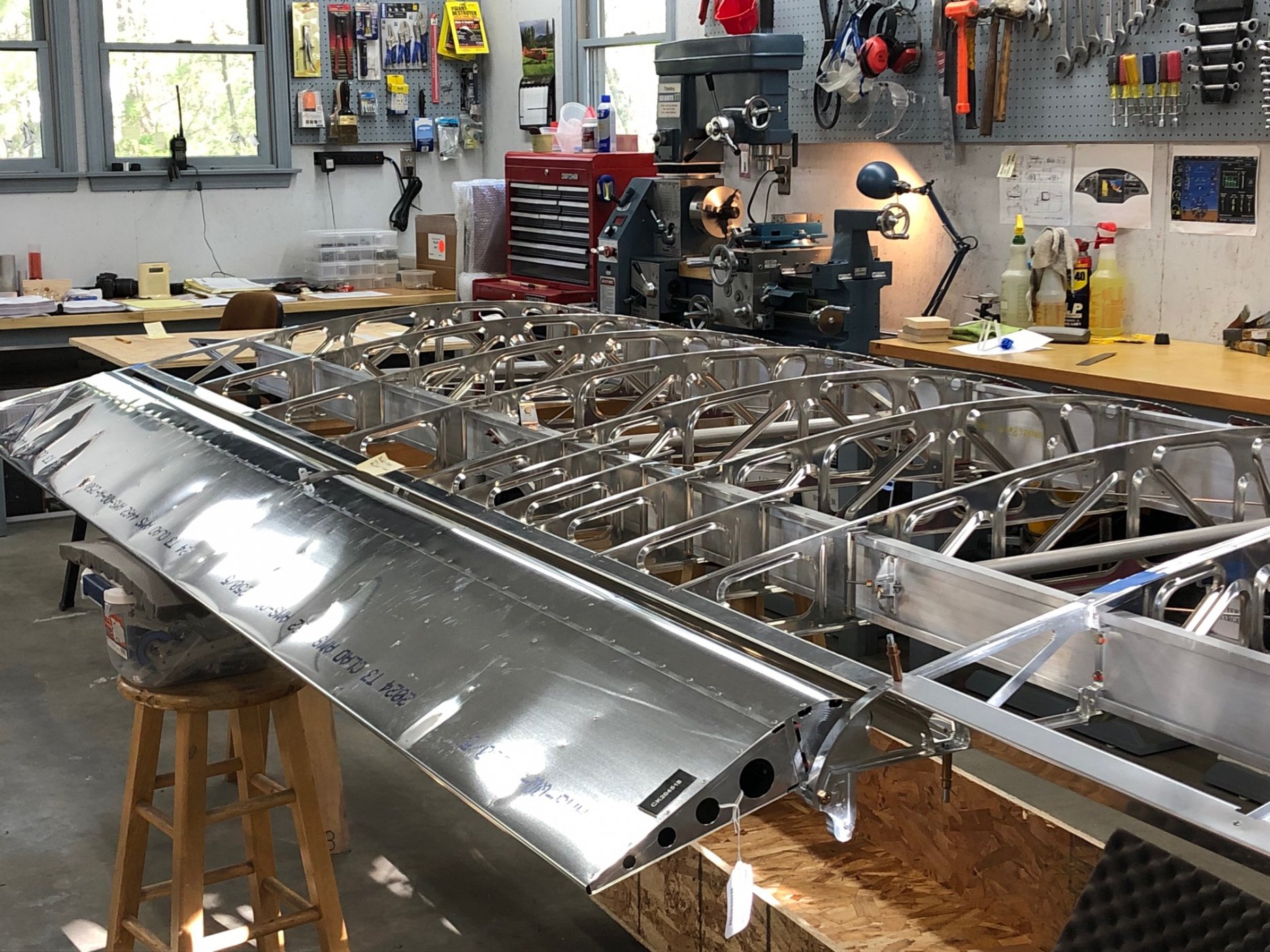

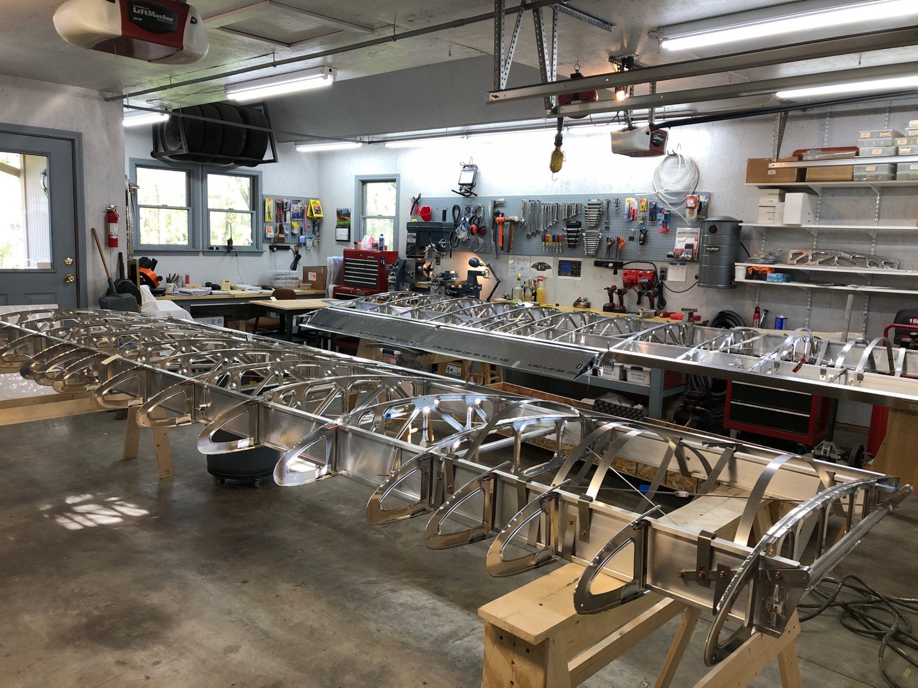

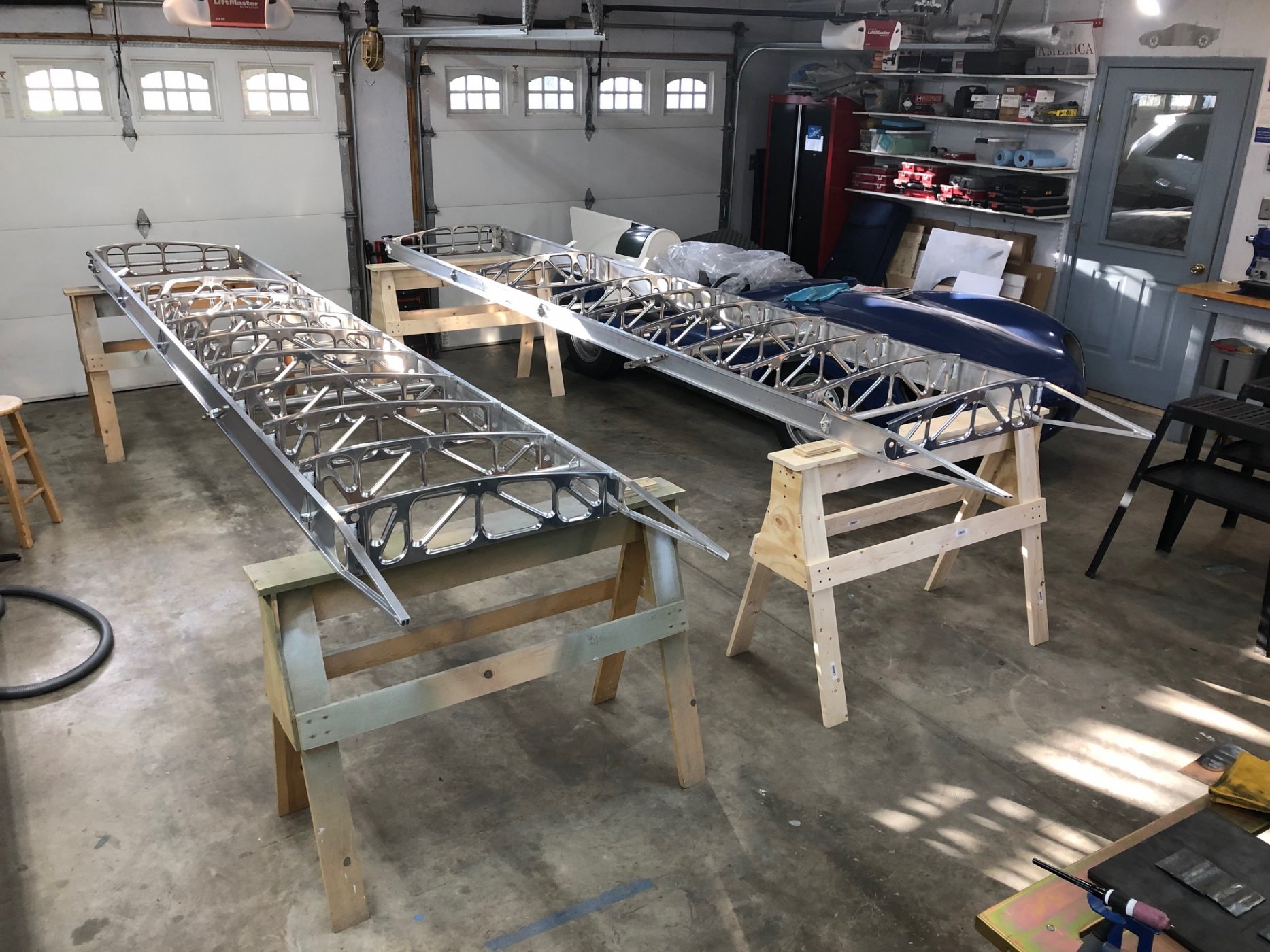

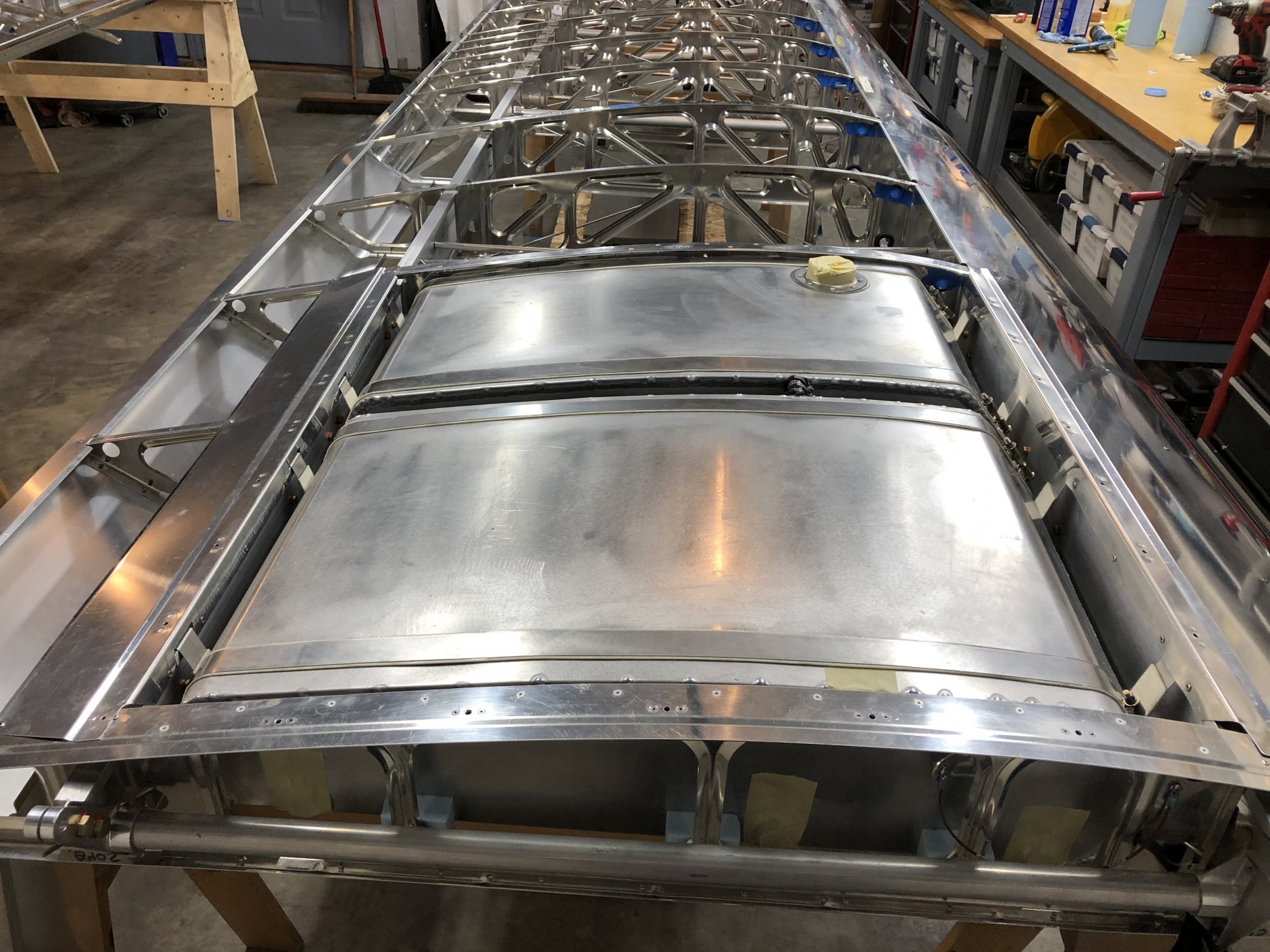

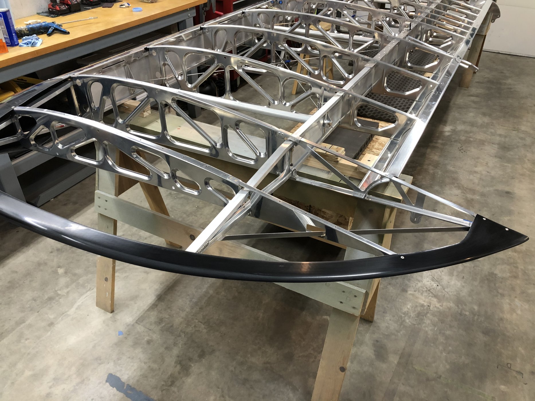

April 11, 2021 Progress Report
The Carbon Cub EX2 is coming along nicely. Substantial work has been completed on the wings. I would be very pleased if the wing frames were completed by the end of the month.
Once the wing frames are completed they will go on a storage rack and work on the fuselage begins. Fun stuff.
Many more details over at the Cubcrafters forum.
http://forum.cubcrafters.com/showth...yan-s-Build-Tips?p=26732&viewfull=1#post26732

I am keeping a build log, but not with EAA.
Rans makes a nice kit. Regarding a Cub, the Javron is an excellent option. True to the original. Check out Bill Rusk build blog over at Supercub.org. I would say do it, don't wait. Obviously I really enjoy the build process - and building an airplane does not typically require designing and re engineering stuff.
I have 195 hours in the two wings - ironically took me longer this time than last.
