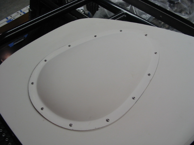

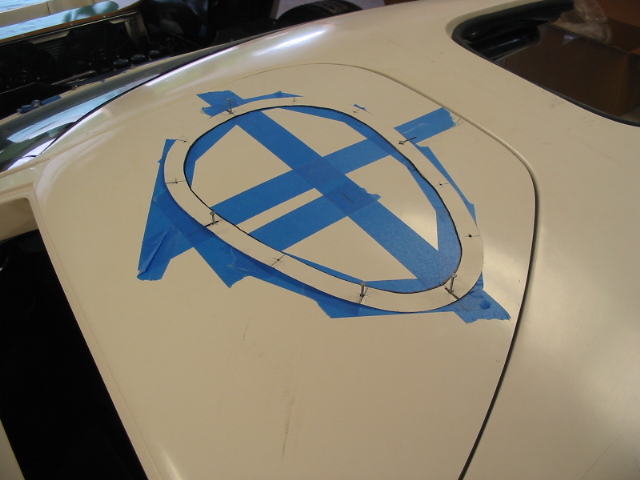

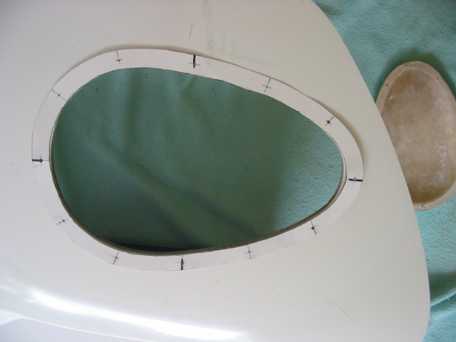

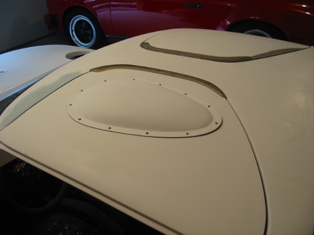

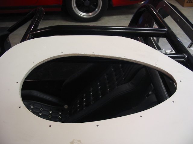

Gurney Bubble Installation
After some debate the “race car” look was decided upon. We liked the idea of the stainless steel button head screws, which look like rivets, holding down the bubble. It would add another focal area of interest.
1. The lip around the bubble was uniformly trimmed to ¾ inch. Then a pattern was made so that the screw holes could be located evenly around the perimeter approximately two inches apart.
2. A chalk line was snapped down the center of the car to provide a point of reference. The bubble was located so that it was exactly parallel to the chalk line.
3. Holes were drilled in the bubble for 6-32 button head stainless screws.
4. A pattern was made for the hole. Two of the holes were drilled through the roof and small screws temporarily placed to secure the bubble and make sure the location was right before we cut the big hole. The opening was then cut exactly ¾” inside the outer lip of the bubble using our pattern..
5. The roof of the door has an inner liner. There is a gap between the liner and the roof which needed to be filled. Two screws were placed to secure the bubble, one on the forward and one on the aft end. This flexed the roof slightly to assure a snug, even fit around the entire perimeter of the bubble. Epoxy was then used to fill the gap between the liner and the roof, making sure to avoid any on the two temporary screws. (A piece of wax paper between the bubble and the roof prevent the bubble from inadvertently being glued in place).
6. A coat of body filler was applied around the opening between the inner and outer panel which was then sanded to provide a smooth transition between the outer panel and the inner liner when viewed from the inside.
7. Nutserts were placed in the door to secure the 6-32 button head screws. The button head screws were temporarily placed, pending final painting and finishing.
A thin rubber or foam gasket will be placed between the bubble and the door when it is installed after the car is painted. The bubble will remain removable, although I don’t anticipate ever removing it, unless Ryan grows another inch or two!

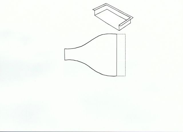

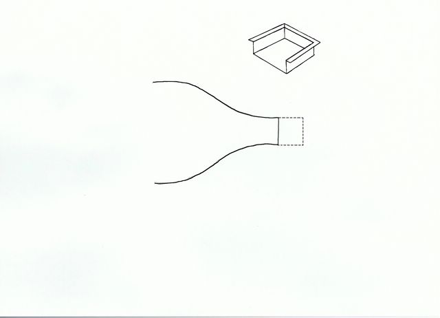

Hi Chuck,
My Idea was to extend the duct back a little to create the look of an open vent without actually opening it up fully. I intend to make a piece that can be attached to the front clip, then blend in the vent opening so that to the casual observer it looks open. It's only if you examine the hole closer that you will see that it's closed further in.

I meant this drawing...!
Doing too many things at one time. Should have known I can't multi task..

Martin:
Good idea. Would you fab it out of aluminum? Seal it to make it water tight?
May give this a bit more thought. Looks like with a bit of effort a good solution could be found.

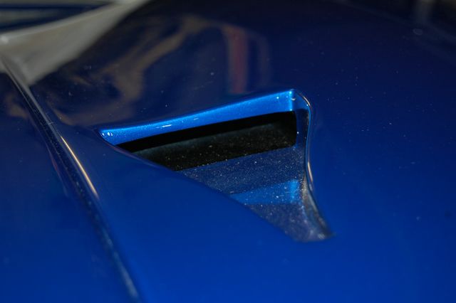

This pic just arrived from friend Alan Snelson. Interesting touch...

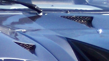

I've opened up and boxed in the ducts before. The centre duct only had a box that was only a couple of inches long due to space restrictions. The side ducts box was around 200mm(8") long.
Inside of the box section was painted black, with just a slight groove put between it and the original body.
In my opinion opening up the ducts give the front clip a lot more depth and detail. The cheap alternative is to paint the faces black and stick some mesh on the front.

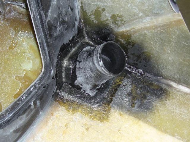

Chuck,
I cut mine open, for the fenders ....glassed in hose mounts from a pair of ducts, and left the center one open to the back lip of the front clip, which I painted black. Turned out nicely and will do it this way again.

I opened all three of mine and glassed in ductwork for the two smaller ones. At some point I may run them into the car for ventilation, but to Jonathan's point, that is a B list item.

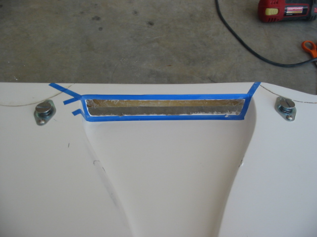

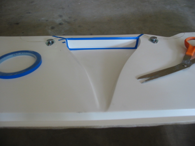

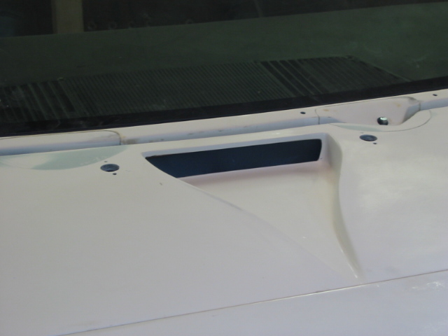

In retrospect, I don't know why opening that vent was even an issue. No reason not to open it up. As noted, it is a wet location regardless. Thanks for the wake up call.
Got home. Removed the front clip. Taped off the opening. Cut it out. Sanded the edges. Put the clip back on with a piece of black paper behind to see how it will look when we later paint the back syrface flat black. Job done.
Hope to get all the body prep done this weekend so we can take it to the painter next week.
