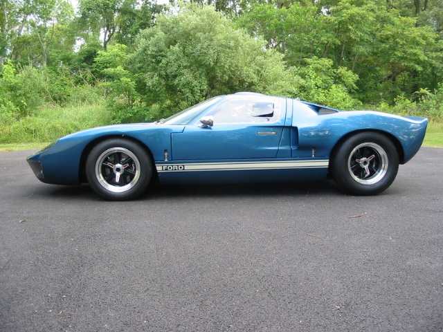

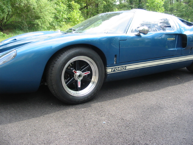

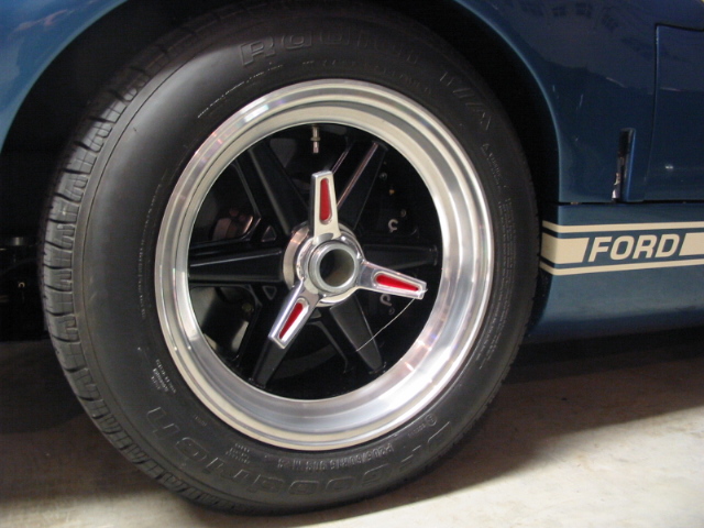

Painted Wheels
We decided to change the color of the wheels. The area that was gray is now matte black. Ray Maserang, Walnut Park Autobody, Crestwood, MO, did a super job. (He also painted our car). We added the red on the spinners on the port side to prevent confusion when changing tires in a hurry. (Yes, there are prototypes for this detail).
Just about ready for Road America next week . . . .

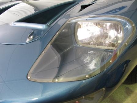

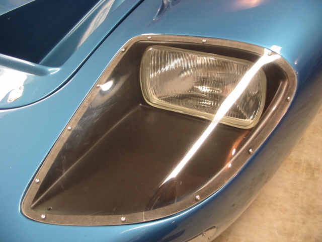

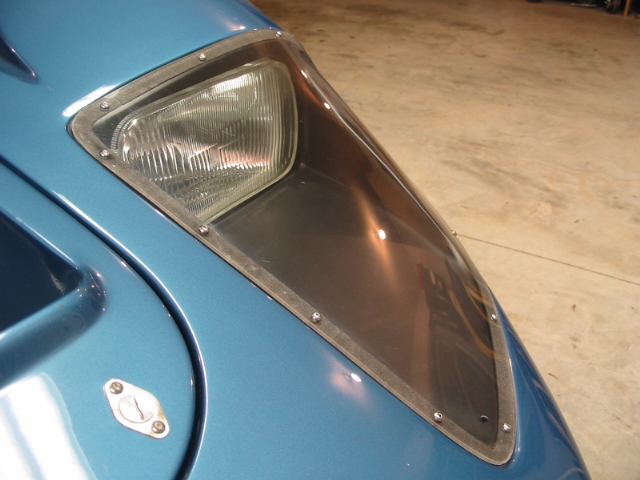

Headlight Seal
Dust and dirt has a way of getting under the headlight covers. Taking off the covers to clean it is a hastle. So a neat way of sealing it was sought.
McMaster-Carr (www.mcmaster.com) makes a neoprene foam rubber strip 1/16” thick and a half inch wide. Part number 8694K11. We ran it around the inside edge of the headlight. Work slowly and carefully – once this stuff touches it is in place for good. Work slowly going around sharp turns to avoid kinks.
Within a short time it will take on a nice solid black appearing strip, looking as if it were painted. It provides a good seal. We drove it in light rain following the Saturday evening Concourse at Road America last Saturday and no water whatsoever intruded. (But a couple of gnats did!!)
By the way there is a prototype for this. An original GT on display at Road America used the same technique. The first two picture are ours, the last is a restored original.
We used the same material around the rear clip window. We have not yet decided whether to use it on the side windows.

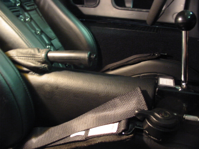

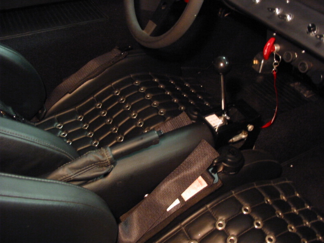

Parking Brake Handle Boot
The insulation placed on the tunnel, described in prior posts, is effective. There is no discernable heat coming through the tunnel. With one exception. The emergency brake handle bracket, which is securely bolted adjacent to the tunnel, conducts heat. Adding a boot to the handle is an easy way to stop that source of heat intrusion.
What we used is the standard Lokar floor mounted brake boot. Part number Lokar 70-EHBF. This was purchased some time ago when they were made from leather. Now they are naugahyde, which may fit bit better since it would be more flexible than the leather. Regardless, it slid right over the brake handle supplied by RCR.

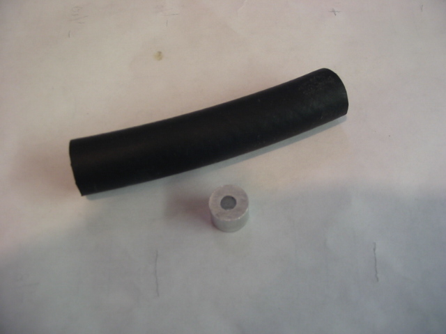

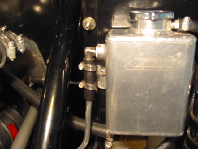

Coolant Vent Line Restrictor
Recall that the cooling system includes a vent line which runs from one side of the radiator to the top of the expansion tank to vent air out of the radiator. We used a 3/8” OD aluminum tube. Although the inside diameter is obviously smaller, it proved to be too big. Typically it would take about ten miles of driving for the engine to reach operating temperature. I suspect that the line was permitting coolant to effectively bypass the thermostat in greater volume than was desirable.
We use short lengths of rubber hose to connect the coolant lines. It was a simple matter to force a restrictor into the connecting hose on the expansion tank. We used an aluminum cable stop with 3/16 inch diameter hole. The OD is a bit larger than 3/8, so it fit snugly into the hose. And with the aluminum line on one side and the fitting on the other, it won’t be moving anywhere.
Next time I would probably use a quarter inch OD aluminum tube for the vent line.

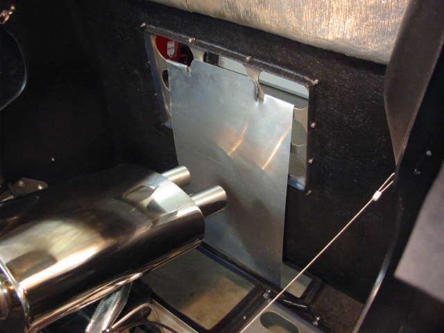

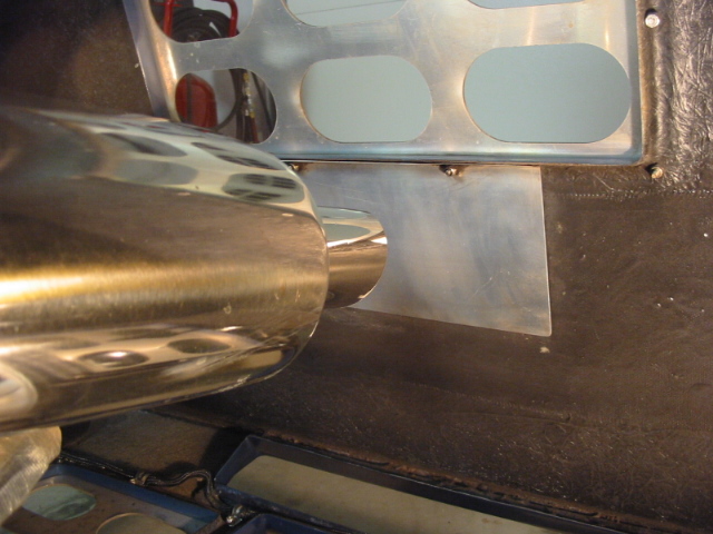

Exhaust Heat Shield
Another tiny detail.
With the rear clip open the tail pipes blow hot gasses directly on the inside of the fiberglass clip. To prevent damage while making engine adjustments a simple heat shield was fashioned from a piece of aluminum 6” x 12”. A quarter inch lip was folded over at a 90 degree angle along the long edge, which fit nicely against the rear edge of the vent opening. The screws that secure the vent cover also hold this shield in place.
This small shield provides pretty good protection for brief tuning sessions. But if a long session is planned, a larger temporary shield is used. A 24” x 12” piece of aluminum was trimmed so it would hang on the vent when the clip was opened. This provides more than adequate protection for a long Weber – tuning session.

My comment is concerning your temporary heat and exhaust shields. You smaller one won't do much to keep the clip clean looking, especially with webbers. You will get a lot of soot on the clip. If this is just on a rare occasion that you will crank it up, it might be O K. But I know from experience with my friends 66 Road Car with webbers and no shield, it builds up fast. Your bigger one will probably work better as most is deflected. A better alternative is to use the flexible tubing that the auto repair guys use in their garages during the winter to duct the exhaust out of the enclosed space. You need only a short piece to vent downward and away from the clip itself. Even though it is deflected as your shield shows, that stuff settles and it will build up on other areas of the clip like in the recesses of the lights and spoiler area. Eventually it will be over the entire clip. Not fun to clean.

3. The exhaust deflectors noted above actually work very well. I have spent many hours tuning the Webers and the small permanent plate did get a bit sooty, but was easily cleaned. Soot on the vent opening and around the shield was minimal. If we had a bigger fire breathing power plant it might be an issue, but with our modest 375 HP it is a simple solution that really works well. Indeed the larger, temporary shield is used only if we know we will be spending a long time tuning. And with the Webers pretty well tuned, it should not be much of an issue any more (I hope).
