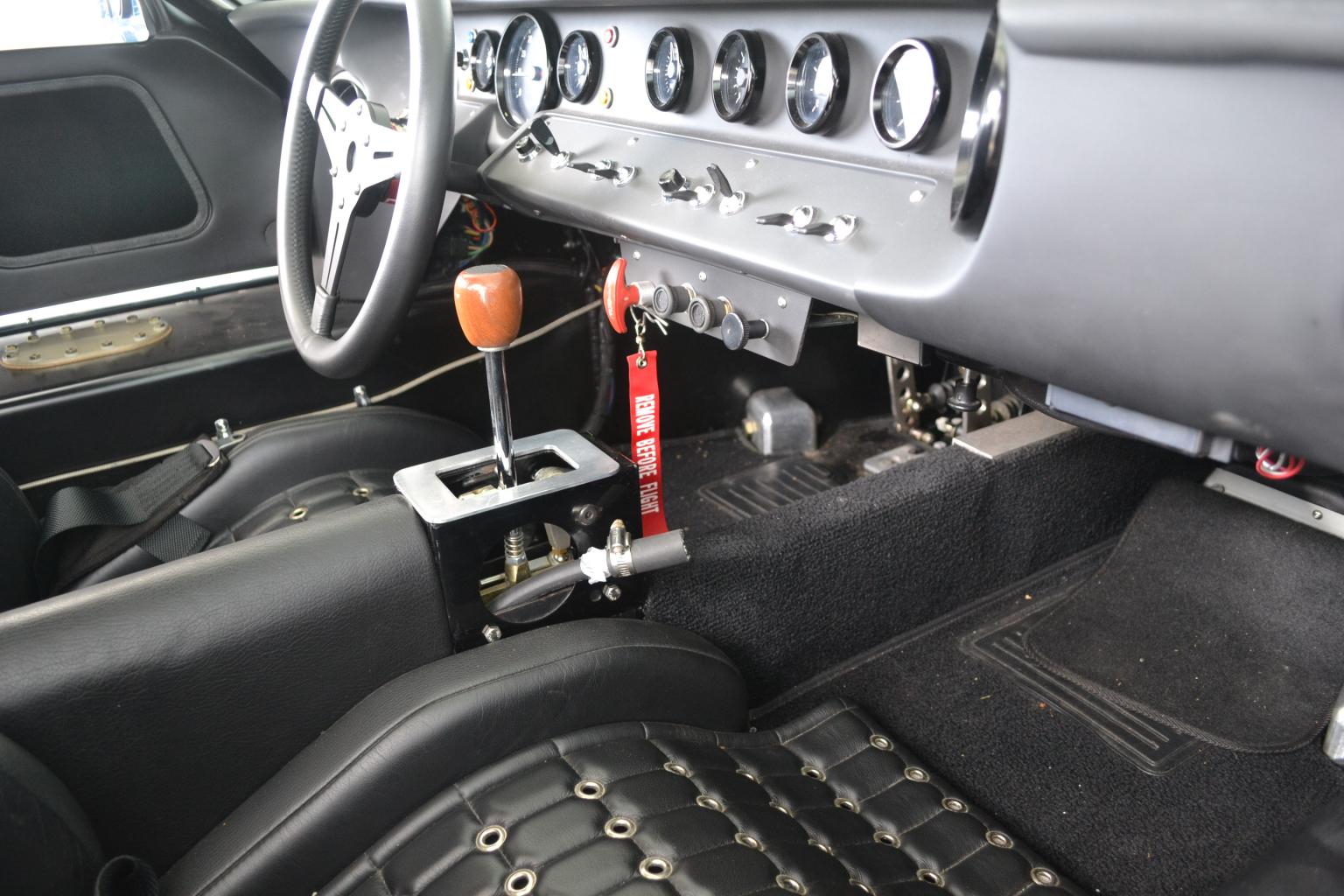

Sound Enhancement
Several current performance vehicles enhance the driver’s experience by piping sound from the engine compartment to the passenger compartment, as we noted on Ryan’s 2016 Mustang GT. It may be accomplished electronically or passively, typically by tapping into the intake manifold.
The GT 40 is not typically described as a ‘quiet’ car with 500 HP exhausting through straight pipes out the rear, but because it is directed out the rear and with side glass in place some drivers will actually operate the car without ear plugs. Ryan and I wanted to explore a way to enhance the aural experience.

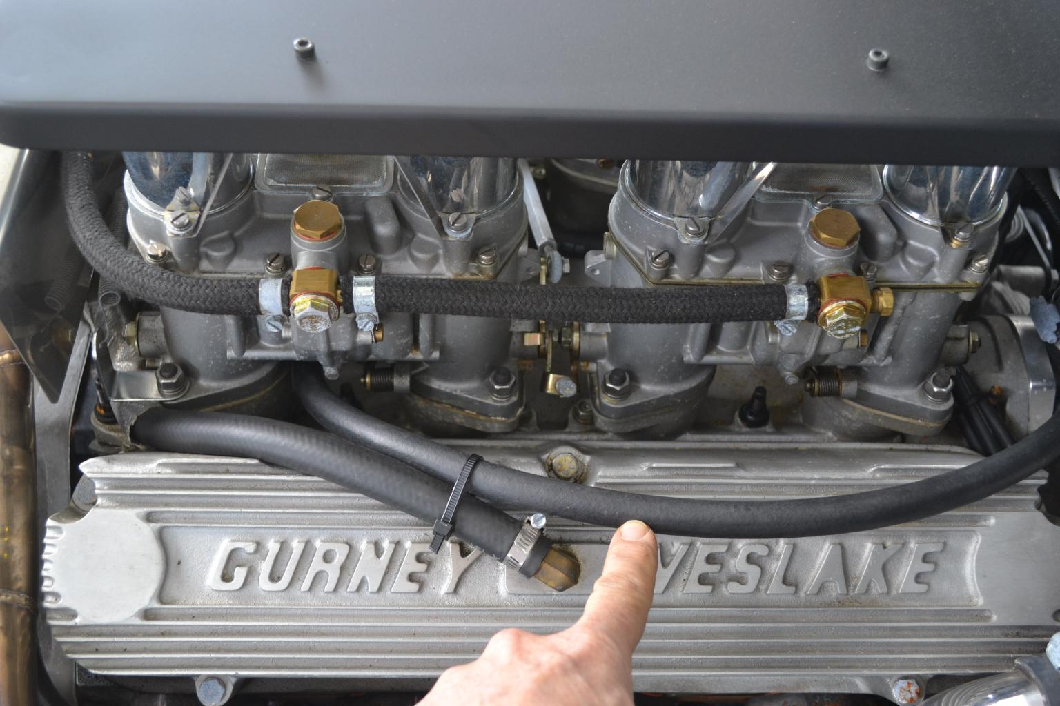

The passive route was selected. A hose was connected to one of the Weber carbs at the intake manifold below the right rear carb. Ideally a separate hose would be connected to each and then connected together, but we were concerned this could adversely affect the performance of the carbs. It would be much easier with a single carburetor, and would undoubtedly produce a better sound effect. The hose was then run into the cabin along the shifter cables to the forward end of the shift mechanism.

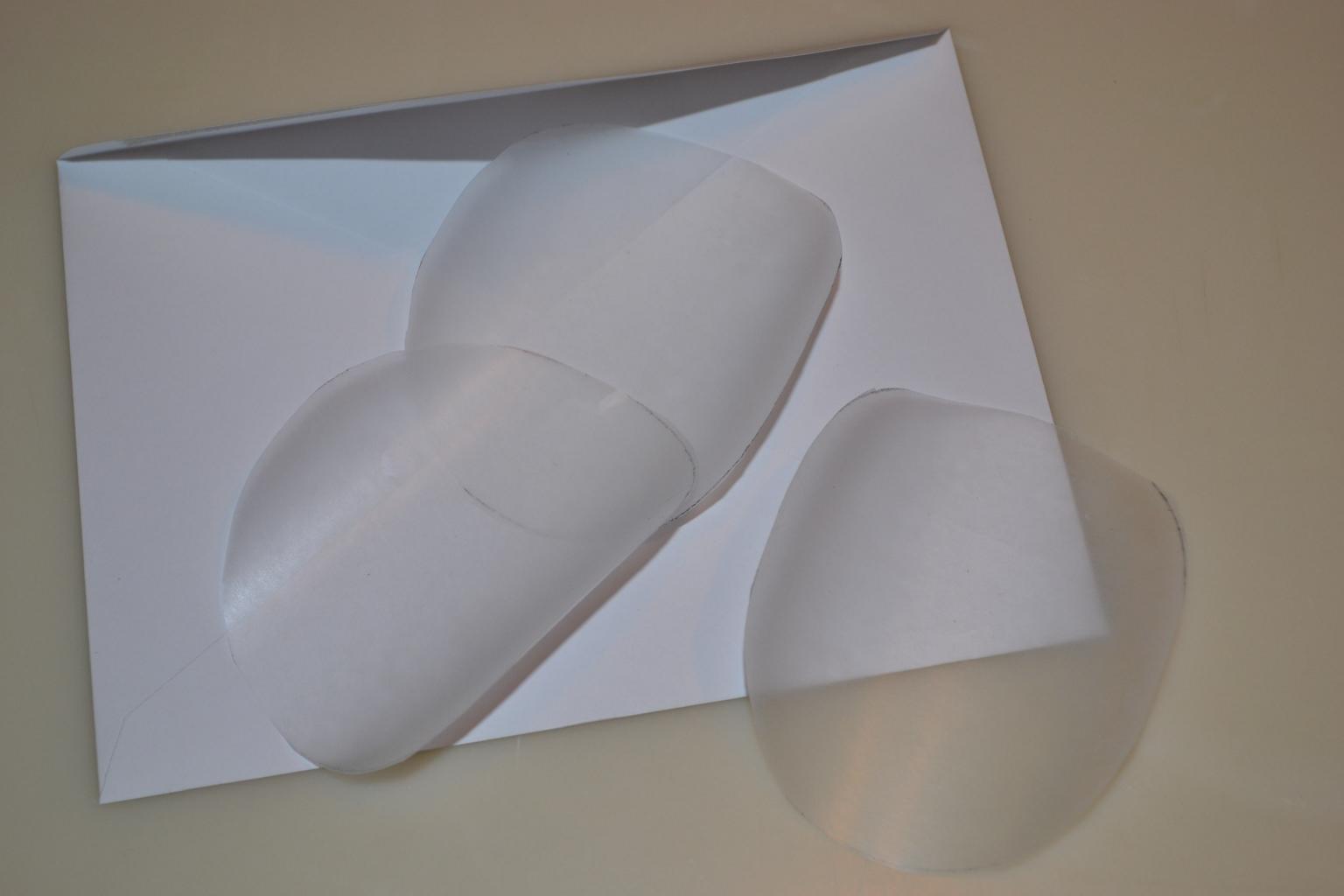

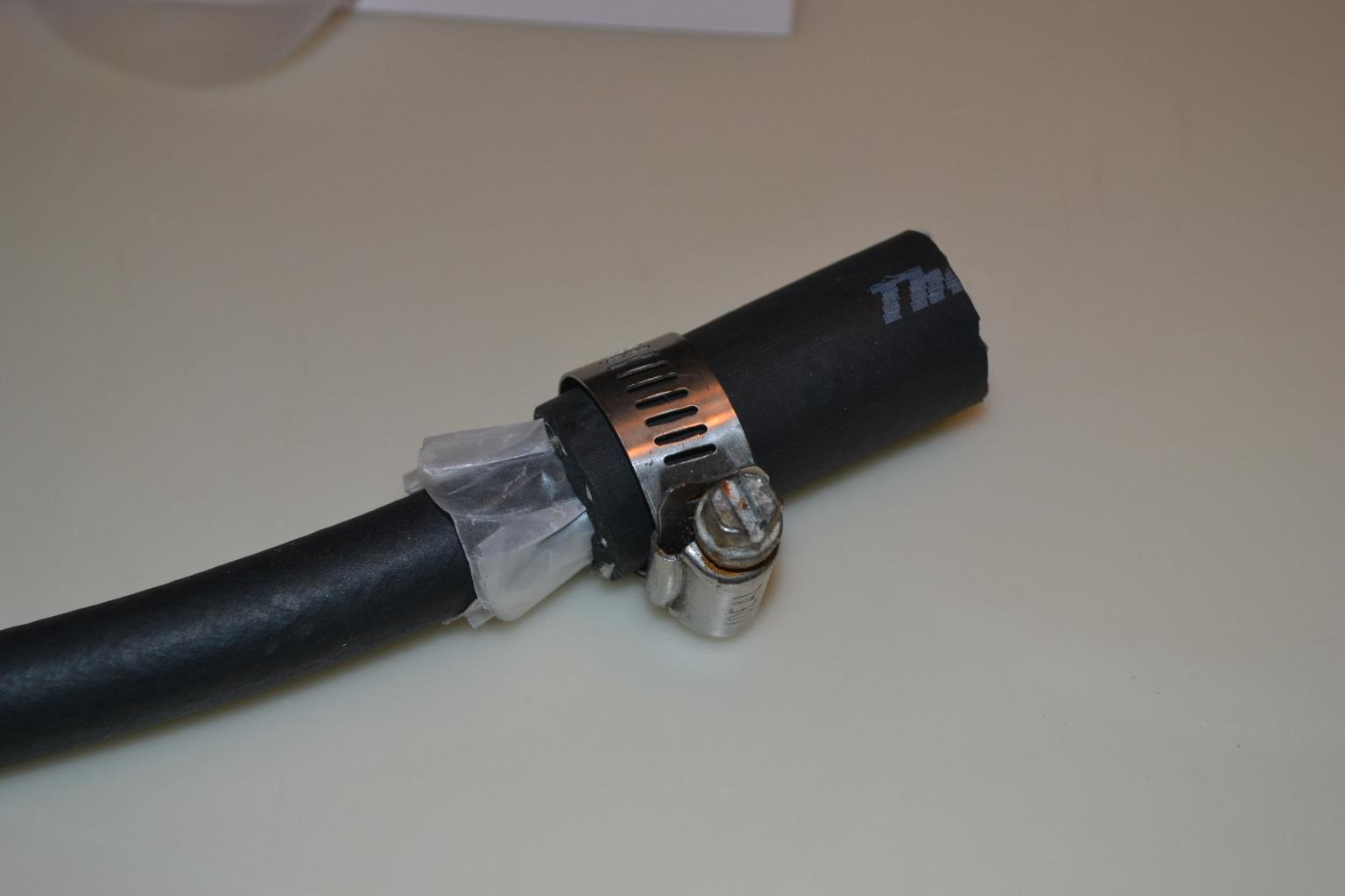

The hose must be sealed, but yet sound needs to pass through, so a diaphragm was added using wax paper. The wax paper was placed over the end of the 3/8” ID hose and a piece of 5/8” ID hose slid over, after which a clamp was placed to hold it in place. A small envelope with extra sections of 3” diameter wax paper is carried along in case of a failure on the road, which would obviously have an adverse effect on the engine’s performance.
To keep it simple the ‘output’ side was simply left extending from the forward end of the shifter on the passenger side. We plan to modify the arrangement and move the hose so it will be less conspicuous. Since these are low frequency sounds they are non-directional so a better location will be found.

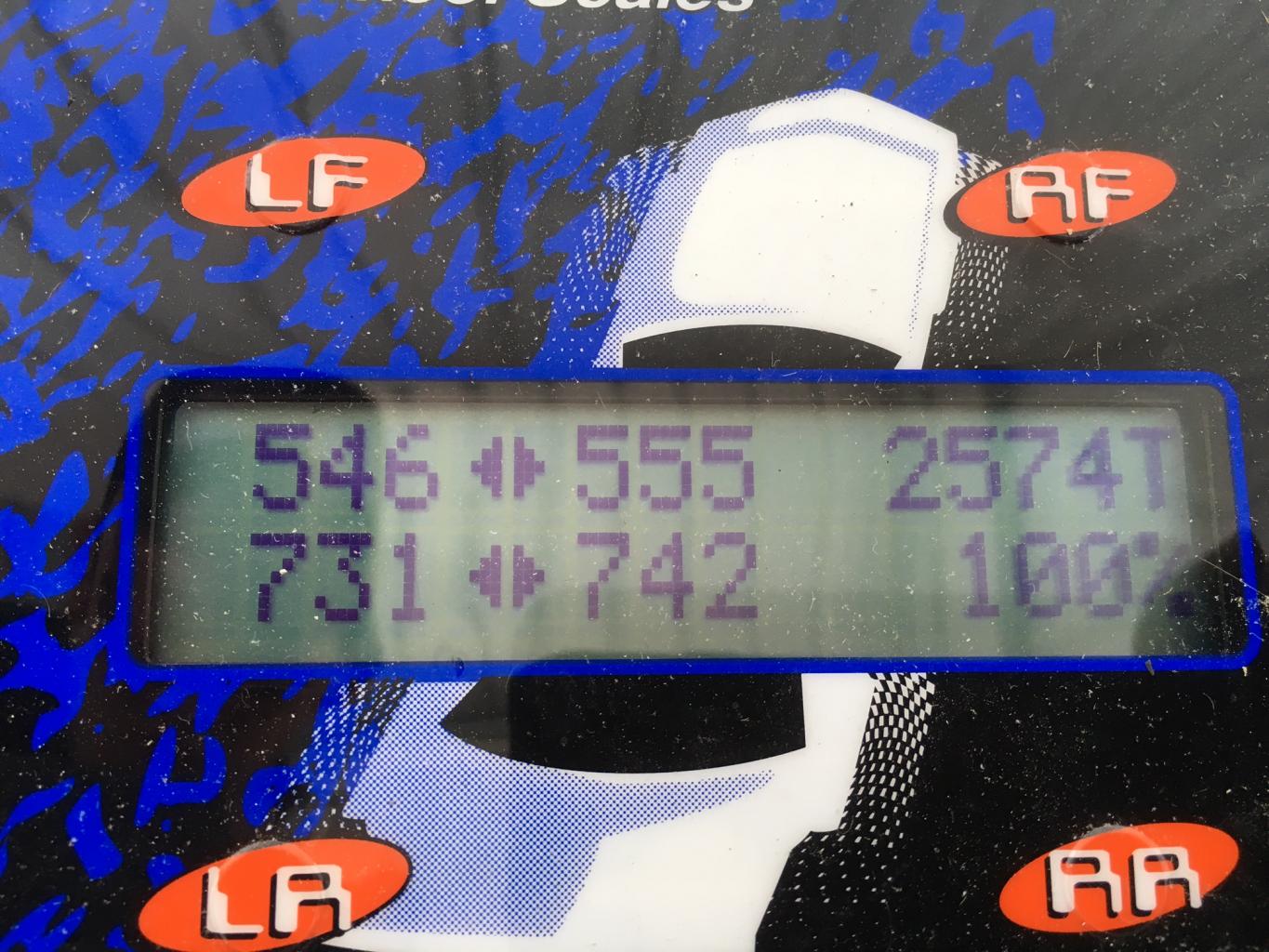

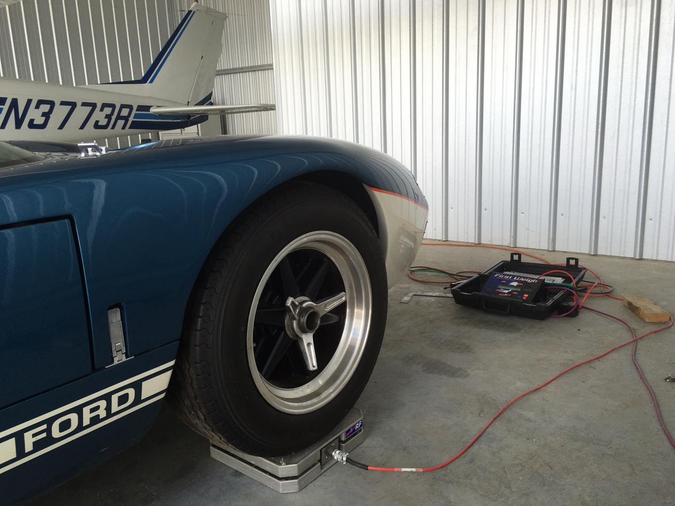

Weight and Balance
With the Carbon Cub nearing completion we barrowed a set of auto racing scales to complete the weight and balance calculation. With the scales in hand Ryan suggested we weigh the GT. Well, you can’t just weigh it. If you are going to weigh it you might just as well make some adjustments.
First the good news. The GT weighed in at 2450 pounds empty (we subtracted the weight of the full tanks of fuel).
Next we discovered the left front wheel was nearly 100 pounds heavier than the right. The left rear wheel was more than 150 pounds lighter than the right. Time for some adjusting
We adjusted the spring height in eighth inch increments. A small change makes a big difference. When finished the left and right weights were within about ten pounds of each other.
We then checked ride height. The front was exactly equal. The left rear was about 1/8” higher.
At this point we called it quits.

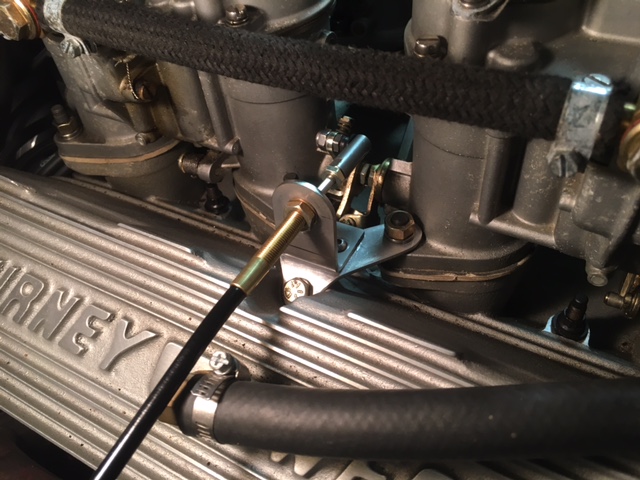

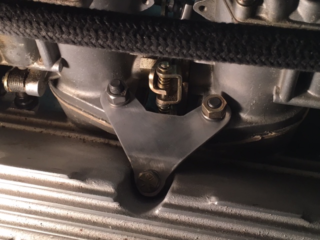

Throttle Cable
While Ryan was driving the GT in August on a visit home, the throttle cable snapped at the pedal end. Actually the tiny crimped fitting came off.
When the car was built originally we used a nine foot long Lokar throttle cable. It worked well with a Holly style carburetor, but it was never happy with the four Weber carbs. The Webers have a total of five return springs working against the pedal and the resistance made for a less than satisfactory feel. So we decided to explore alternatives.

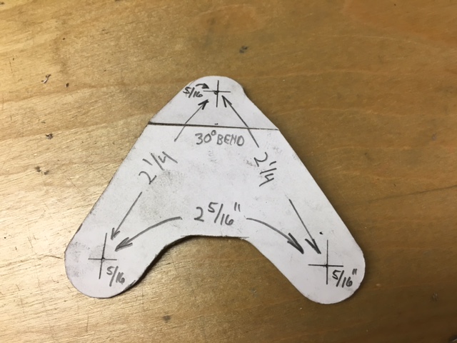

Pegasus Auto Racing Supplies sells custom length cables. After lots of measuring we ordered a cable with 10/32 stud ends. Jacket length was 108 inches and cable length was 112.5 inches. Shortened stud ends were ordered. The length of travel, which is the most critical dimension was 2.1 inches. The have a nice web page that makes determining the correct dimensions straightforward. These dimensions were dictated by the new bracket we fabricated and will obviously vary depending on the specific set up used.
The cable bracket that came with the Webers was a forward pull design that used a bell crank to make the 90 degree turn to the carb linkage connection. We wanted a bracket that would pull directly on the linkage, which meant a side pull. This is the same arrangement used on the original Mark I GT 40. A pattern was made and the bracket cut from a piece of aluminum. The stainless steel upright was taken from the existing bracket.
The end fittings for the cable were ordered from McMaster Carr. At the throttle end part number 2447K11, clevis rod end, 10-32 female, 13/16” length, was a direct replacement for the original fitting. At the carb end part number 6058K35, ball joint linkage, shielded stainless, 10-32, right hand thread, is used.
This upgrade works splendidly. The Pegasus cable is beefier than the Lokar, has a Teflon lining and hence is very smooth, and the threaded ends have a much larger crimp area and thus should not fail. Eliminating the bell crank also improved the throttle feel.

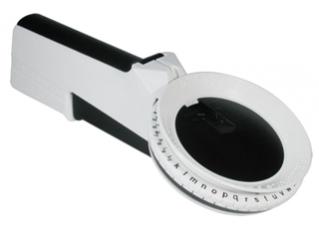

There is a company that manufacturers an inexpensive braille ribbon printer. The Reizen RL-350 Braille Labeler can be purchased on line for around $25.
Labels were made to identify the primary switches on the GT. A single letter was used to keep it simple except where two letters were needed to prevent confusion. The following are the braille abbreviations we used:

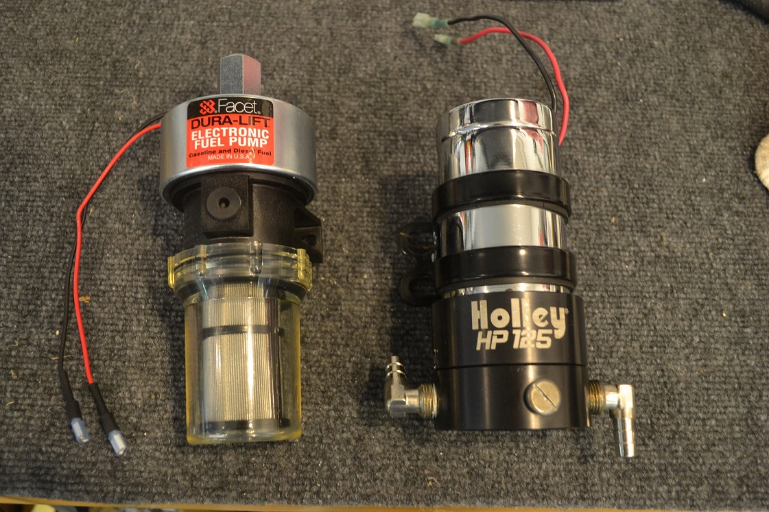

The Holly fuel pumps were installed with the input about six to twelve inches above the level of the fuel, depending upon how full the tanks were. With no resistance on the output side this was not a problem. But with a regulator set at less than three pounds pressure the pumps often have a hard time priming. Holly specifically states that the pump should be installed at or below the pickup level, so it is not a fault of the pumps, per se. With a regular set at seven pounds pressure for a four barrel carburetor they worked fine. But with the Weber IDAs set at two pounds this was a problem.
Facet makes a pump specifically designed to pull from a fuel tank well below the level of the pump. One specific model is rated at 50 GPM and will pull from 50 inches. (Pegasus part number FAC-40290). It comes with an integrated fuel filter on the input side and a check valve. Output pressure is more than adequate. It is approximately the same size as the Holley pumps.
We did a test installation and immediately discovered two things. First, they are LOUD. But with straight exhausts should not be an issue. Second, the pressure immediately came up to 3 pounds without fanfare, and stayed there several minutes even when the pump was off, confirming that the check valve worked. So on to the final installation.

Hi Chuck, I've used the Facet Dura-Lift pump for years now and it has been great. The pressure output is too high for a Holley 4 barrel at I believe nine pounds pressure so a regulator is needed to lower that some. It is loud but I like the plastic filter housing, which looks to me like the vintage glass ones.

Glad to hear a good report on the Facet pumps. It is my first experience with them. Ryan insisted I pull the label off, after which it did indeed have a more vintage look.

I have a couple of these pumps. One I just designated as a fluid transfer pump - works great for sucking all the ATF out of an automatic transmission before pulling the pan.
The other I installed in my street rod.
Yes they do make a little noise if you mount them solidly. I tend to make isolation mounts - the one in the street rod I used rubber washers under the two mounting points which is to a bracket that is then isolated by 1/8" thick EPDM rubber between the bracket and the frame of the car. I can only hear it when the engine is not running.
Oh - and these pumps will build ~11 PSI so you need a regulator (I use a deadhead - Aeromotive)..
