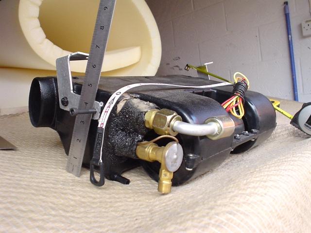

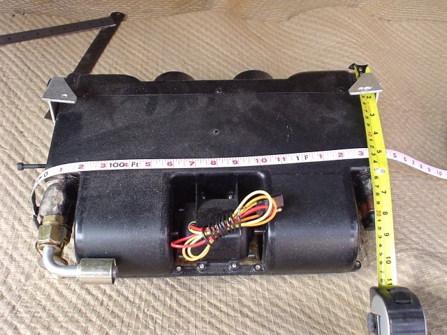

Looking at the NF Auto kit, it appears the same as the one I got from Nostalgic. Apart from the Nostalgic is a Vacuum unit not manual switch, as I have seen in the past from NF. Also, with current exchange it costs a lot less. I'll try and take some pics later.
Brett
Here you go. The size is 16"x10.5"x5" (approx). If you go to Nostalgic, phone Jon up to speak to him, he will give you abetter shipping quote personally than the website will give you.
Bret
