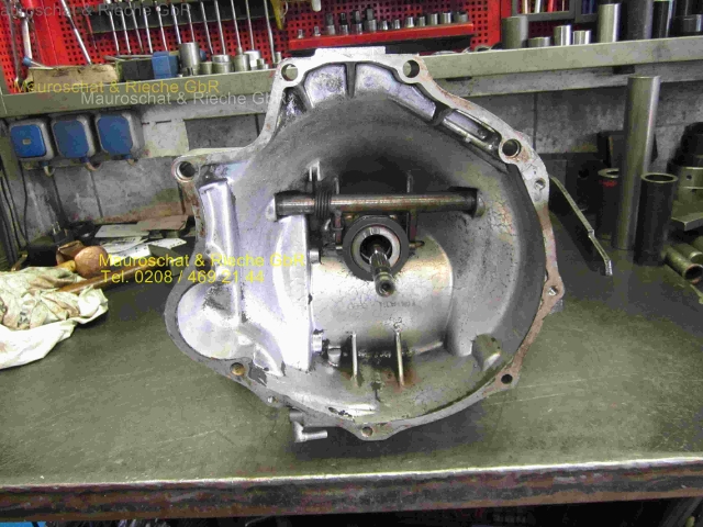

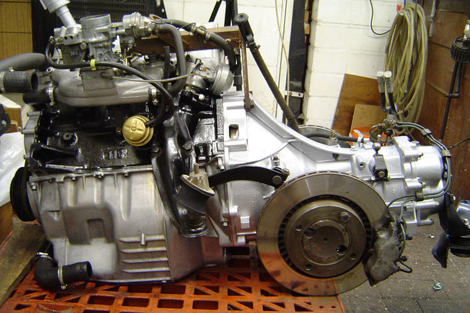

there are old Audi 100 C1 gearboxes around with inboard brakes, built in 1970-1974, before they switched to outboard brakes.
There is a guy selling a refurbished one for about 600$ including new brakes, he is also including an Audi 1900cc 4cyl engine with 115 hp, but the engine is useless for me. I wonder if the tranny will be strong enough for about 200 horses...yes, I think about installing inboard brakes!

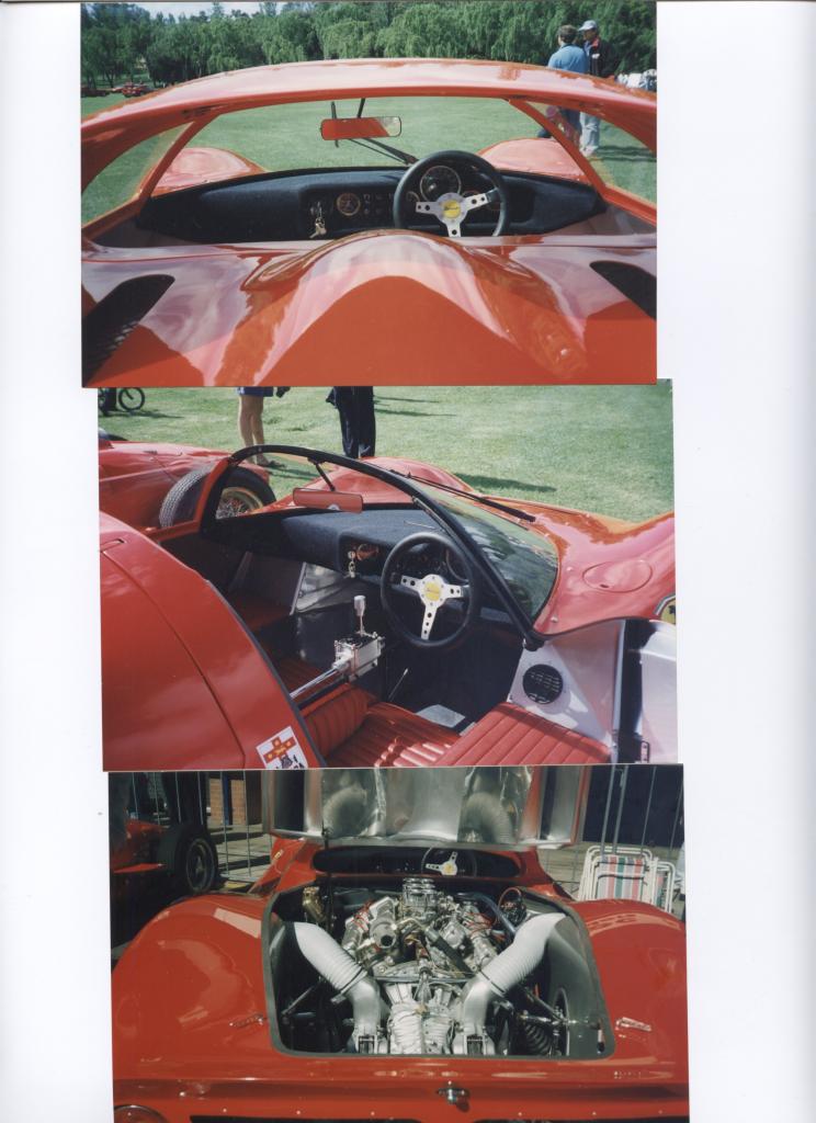

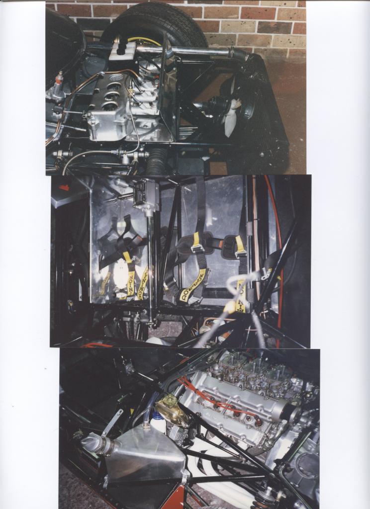

Post 93 I think is this car It was built down the road from me.
He used an original engine and a UN1 trans.
If its not it looks like it,I have other pics but cant post them.
Also fiat do a saloon with a very similar v6, you could buy the hole car, pull the motor and push the rest of the cliff.
Same family it would be a more original choice
Cant get the link to work but goggle fiat v6 engines.
This engine is a Ferrari design from memory.

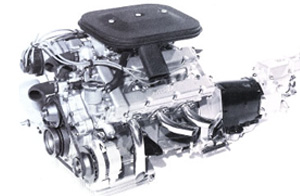

Yes, there is a Fiat Dino with a Ferrari 2400 V6 around, a spyder and a coupe, but they are also quite pricy, and a single engine you won't find... :-(

I have met the man who built the car I posted.
He said the Ferrari eng cost him 25k OZ with a freshen up, most expensive item on the project.
What do you call expensive Axel, I don't know what they are worth (fiat eng).
If you want reference photos I would be happy to email to you, I don't want to post his work up all over the net.
Jim

Wow, these Fiat coupés or Spyders are very nice vintage cars :heart:! This would be a crime to scrap one...:shocked2: A tired Fiat coupé with Dino Ferrari 2,4L V6 (180HP) worths around €20-25K, here in France. Could be cheaper in Italy, maybe.
Same engine as the one you would find in the Ferrari Dino 246 GT...
Engines alone are findable, with a little patience and search (check italian websites, or italian vintage car magazines, Ferrari specialized parts dealers and so on).
I've seen one for sale last year in France, advertised at €12K, running but needing refreshening ... This engine, mated to a UN1 gearbox with an adaptator, could add a fantastic value to your project (not to talk about the added fun, when behind the Wheel) !

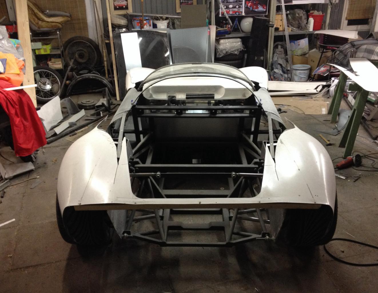

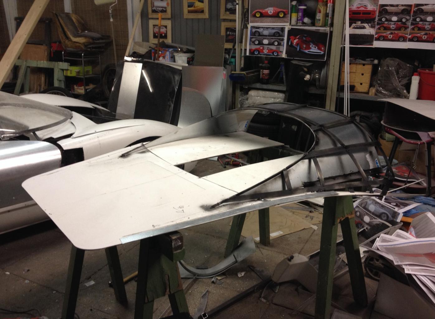

I cut the hood today and finished the inner panels from the rollbar, cylindrical surfaces, easy to do. The outer panels are spherical, much more difficult...

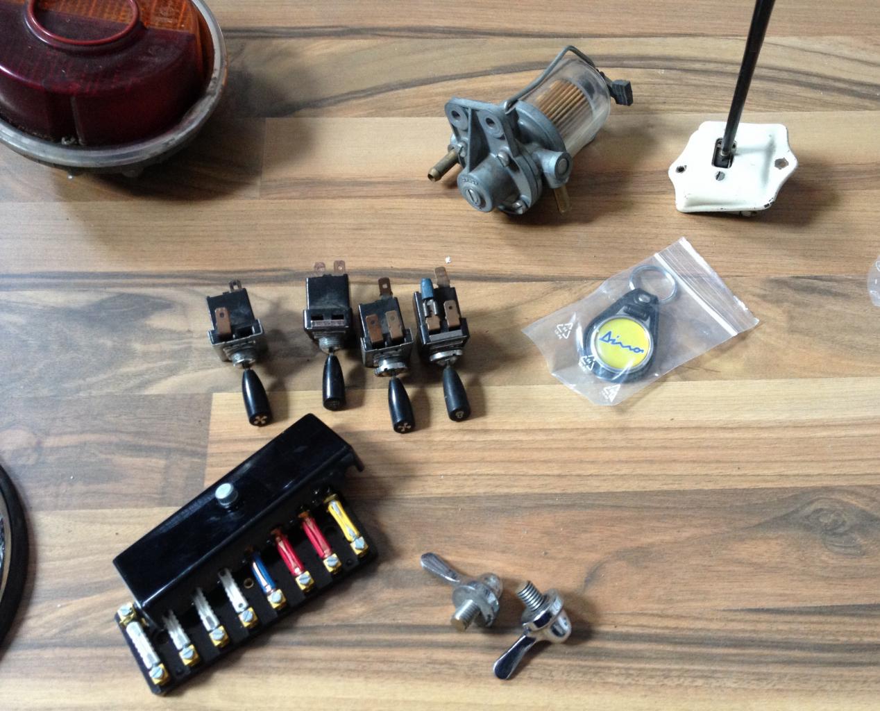

Some goodies I have found at a Classic Car Show last weekend, there was a great fleamarket!
