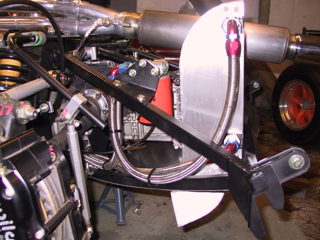

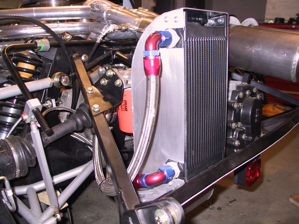

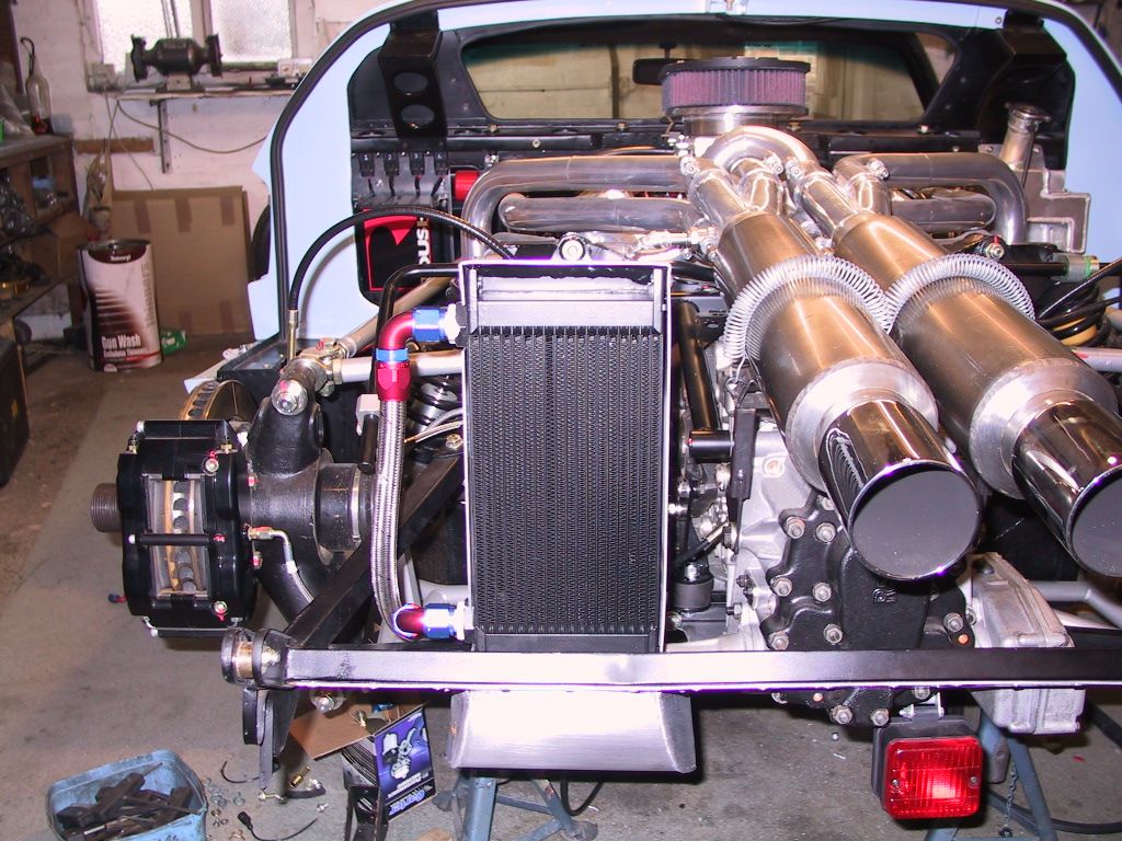

KEITH, ONE WE KNOCKED UP EARLIER ! Frank

Tidy and out the way Frank, I have a clear space on the passenger side , come on you must have some pictures of one there, you have zillions on pictures.
