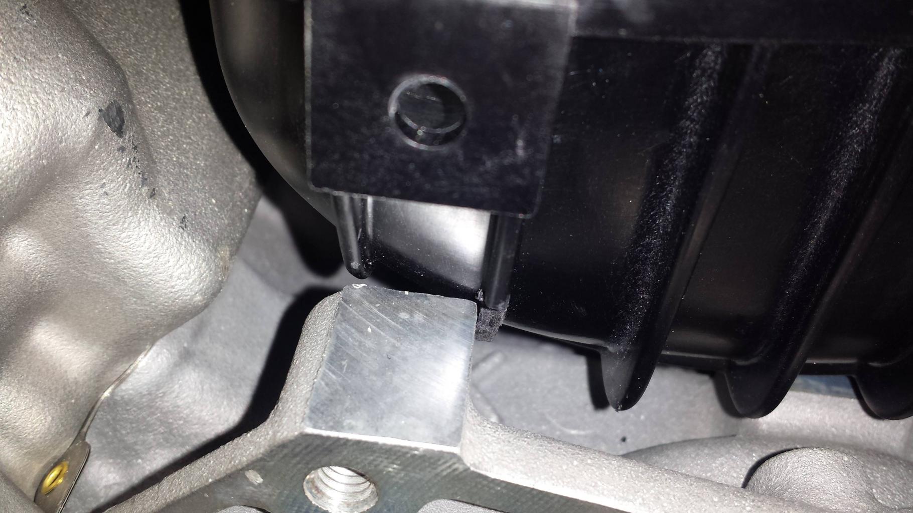

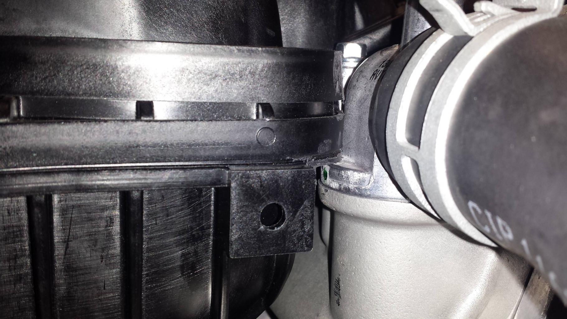

As far as the actual Coyote install- I modified my Tornado frame for the Coyote while it was a bare chassis, so it was very simple for me.
Attached are some rough pictures of the modifications from when I was fitting. I also forgot to mention that there's an ear on the rear driver's side of the intake that you'll have to grind off. It is previously used to clip the wiring harness to in the rear.
