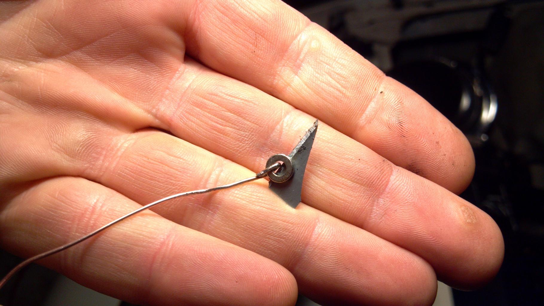

I just took the intake off again and I'm thinking there's some sealing issue. I did notice some oil on gasket at the bottom of the port, but I'm not totally sure. I had the intake off before and didn't notice this. I think if there is a leak is must be minor. Then, stupid me, as i was scraping the old gasket off, i slipped and broke the razor blade i was using. It snapped off and shot down one of the intake ports and is now in the cylinder!! :(
I ordered some tiny magnets to try to fish it out, but I think i will have to take the head off now... DAMN IT!

I would just not rotate the engine, pull out the spark plug and use a small magnet on the end of a flexible wand down that hole.. You will be able to fish it out easily that way. If you are worried about any other potential debris or dirt, you can get a short length of tubing that will fit into the plug hole and duct tape the other end to a shop vac and then move it around to vacuum the top of the piston.
Anything else will blow out the exhaust port the instant it is started..
got it!
