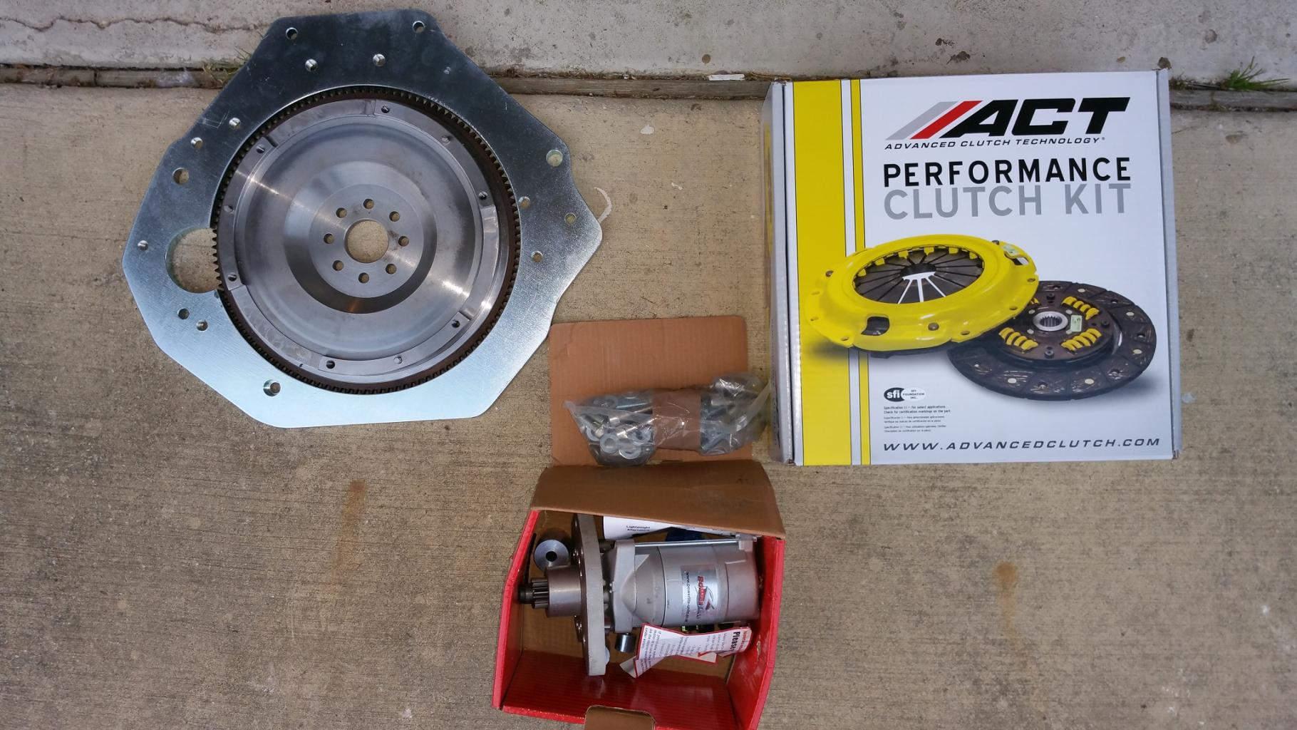

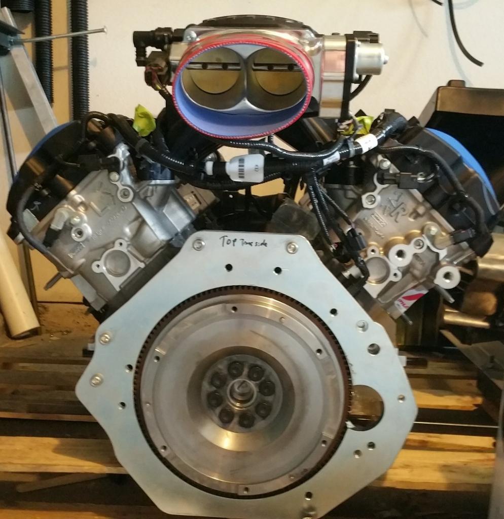

The remaining parts to the adapter set made it in last night. The entire kit consists of the adapter plate (15mm thick steel...needed to be very thin on my setup), the flywheel, starter, clutch assembly, and all of the nuts/bolts/etc. to get the job done save the flywheel bolts which I ordered from ARP. Haven't set it up yet so this could change but it sure does pass the eye test on the components. The clutch assembly is American (Advanced Clutch Technology) and good for about 650 pounds of torque. The rest is British and was made by GT Racing in the UK.

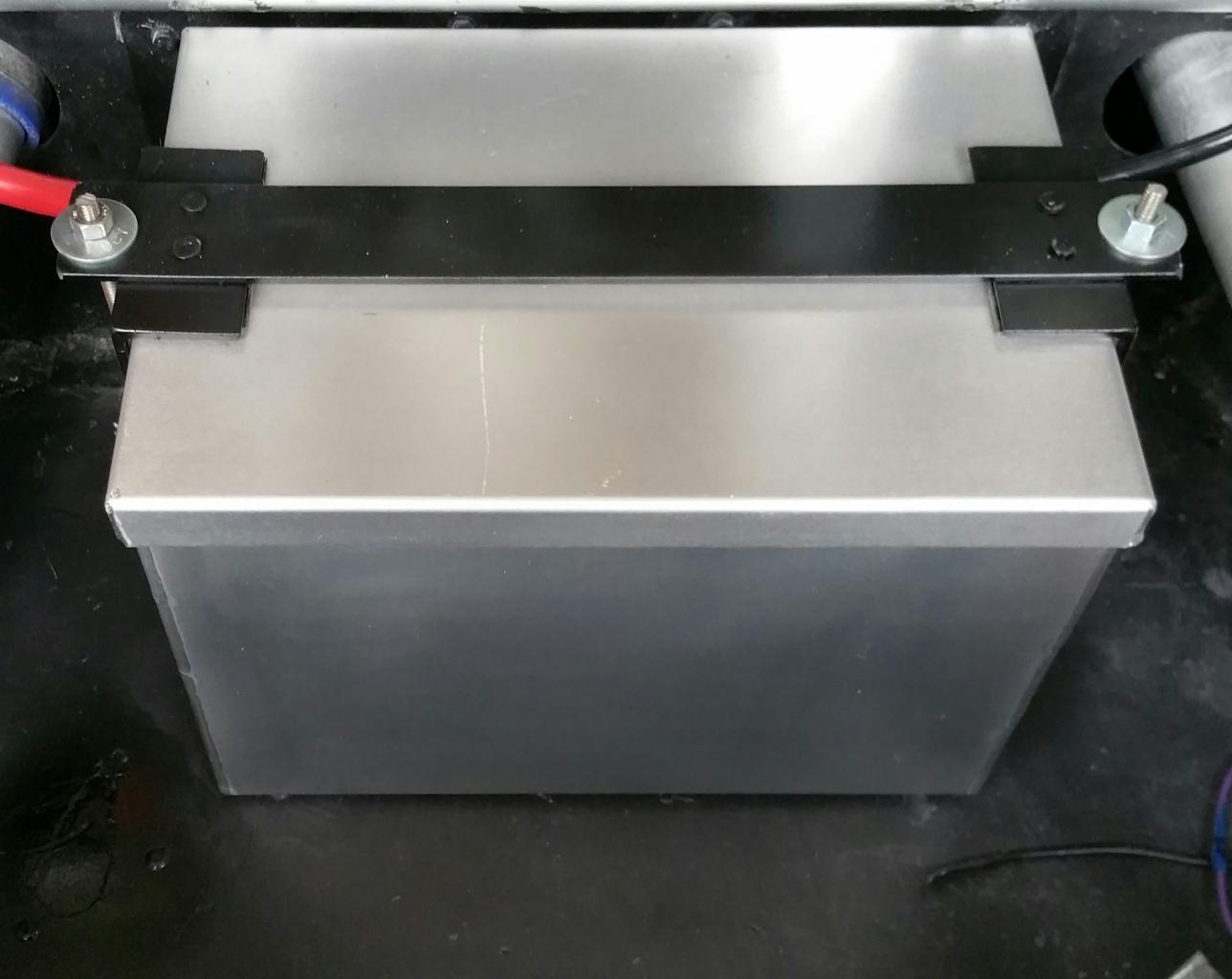

Small update. Battery box complete and fitted. I started to make my own and didn't like it. Then I ordered one in custom and still didn't like it. So, I used the one I ordered as a base and made some tweaks and custom made the brackets. Ended up with about 8 hours of work in the thing but it fits under the expanded nostrils and holds the thing in place. The wires are just sitting inside loosely and aren't hooked up yet. I'll route them to the side better eventually.

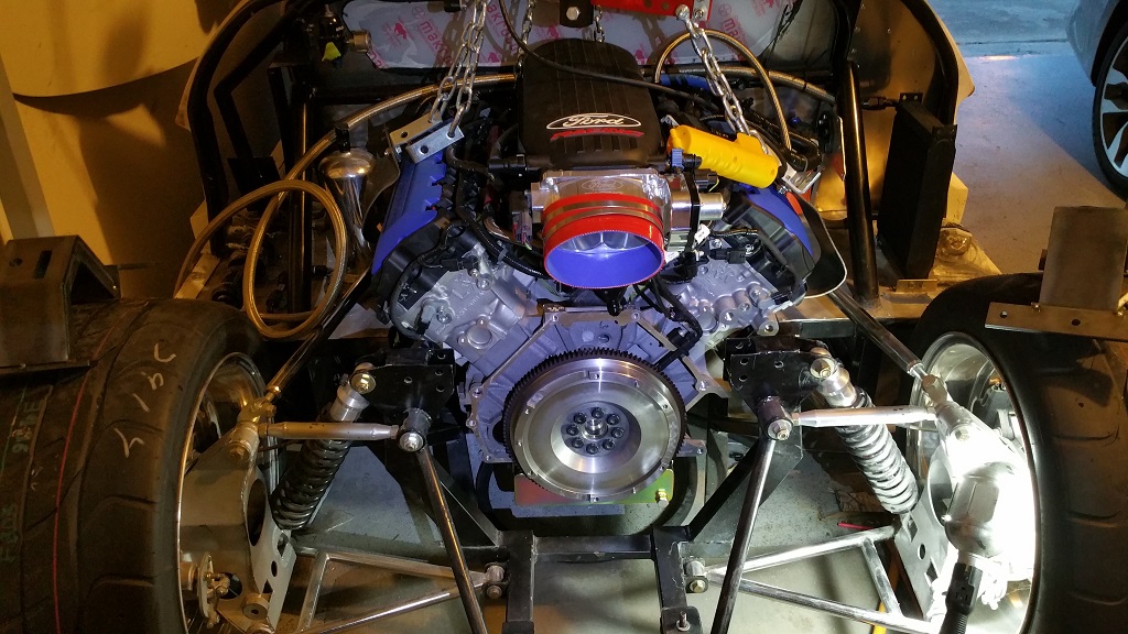

First test fitting of the engine. Looks like the BOSS/Coyote really does fit with a super thin adapter plate (just a little over 1/2" at about 15mm).
I ended up going with a custom oil pan from Canton that is a good bit shorter allowing me to lower the engine. The only tweak I think I'll need to make is adjusting the engine mounts a bit unless I raise it up a bit. Right now the bottom of the pan is flush with the bottom of the chassis (the lowest part being the lowered seating area).

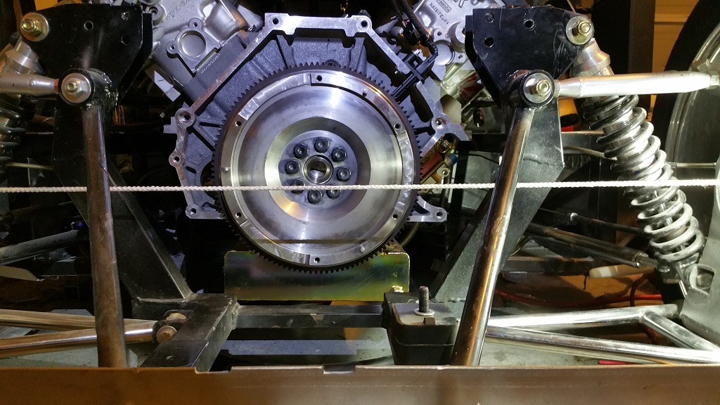

The axles made it in last week. The last tweak to the chassis mounts is being done now (I have over $500 in them...part of the reason I was losing interest...this thing is massively over budget) and the engine should be able to be semi-permanently affixed in a week (have to pull it out to do some more wiring to the fuel pumps and such).
