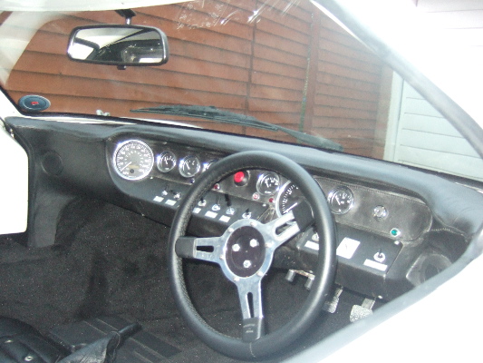

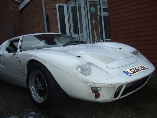

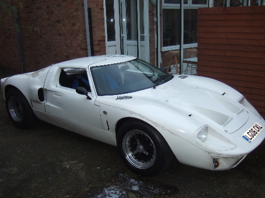

So now about 250 miles on the clock - need to reset the suspension as it has settled slightly. Also have to iron out a few bugs in the electrics (left tank fuel gauge on the cross over switch not working) Also had bad contacts on rear lights but sorted out a couple of weeks ago.
For anyone interested the electric heaters were enough to get through the SVA test but are not really man enough to clear the screen on a cool evening.
The brakes Princess 4 pot on the front and SAAB on the rear are good and progressive - right there too when you stomp hard - just like a large hand grabbing the car to stop it!

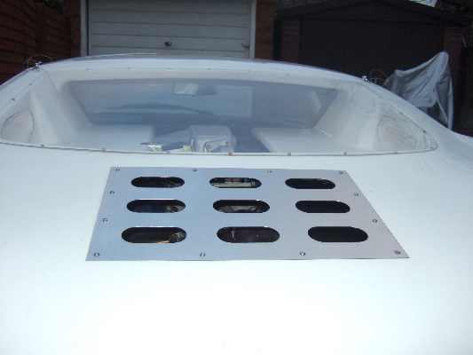

Still need to get the door handles fitted on the outside and the a paint job - White all over (Except matt black in headlight recesses and under rear glass) then a trip to Brian Magee for stripes on the sills and roof in stickers. Probably black for the stripes.

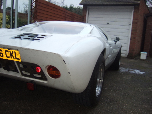

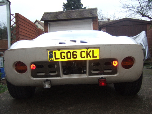

Oh yes and Xmas surfing the net has probably turned up a big fault on the way the car is set up. In the second last photo above the rear clip can be seen really close to the plemum inlet on the left hand side. On the Rande Rover unit the vacuum advance unit comes out at the butterfly and goes straight up about an inch - OK on a 4x4 but not on a 40. So we took a vac of the plenum. It thus means that it has full suck on the distributor all the time.
Call me crazy but this will probably help get the idle sorted and hopefully assist in stopping the kangaroo as the pulses in the plenum feed to the vac advance unit. See always something else to play with on a car like this! So now to decide if it's better to trim out the rear clip and refit a Range Rover part or lock the distributor with no Vac movement. Probably also give better consumption - about 140 litres so far on less than 250 miles (I make that about 9mpg)- not good!

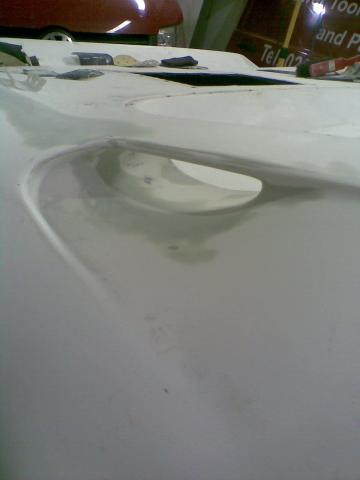

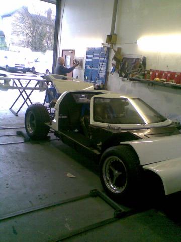

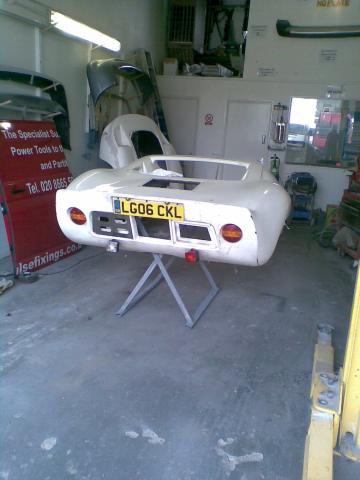

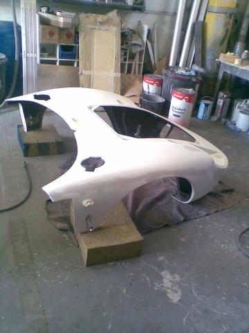

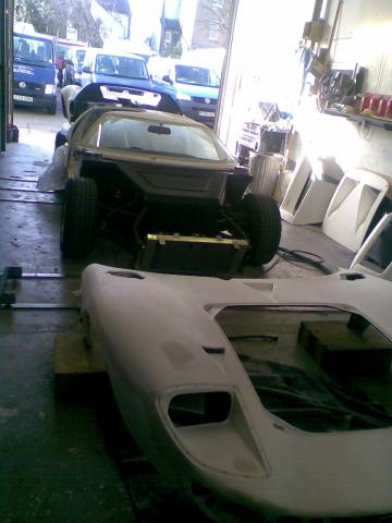

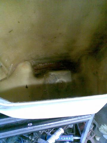

Dropped the car off on Tuesday 18 March
Today is 28 March and we had Easter weekend in the middle

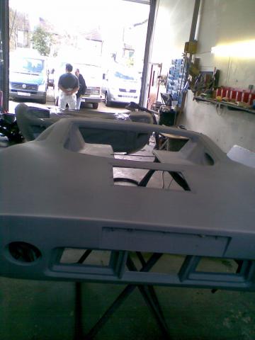

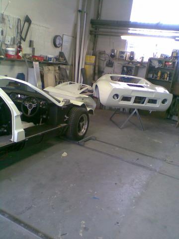

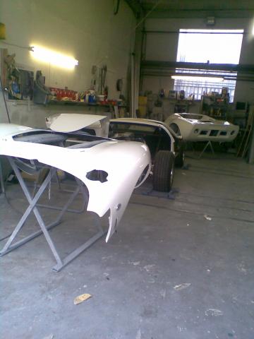

Herewith pictures received today
1) As she arrived at the paint shop
2)- 4) Shots of the work on the rear clip
Front has already been prepared and is ready for paint
Fuel tank covers have also been prepared.
Drivers door had a lose hinge and this too has been repared
Both doors are off the car and ready for paint.
Also advised he expects it to be in the oven overnight on Tuesday 1 April
I think this must be a record from no body prep to spraying!
Thanks again to Tim Martin who supplied the contact!

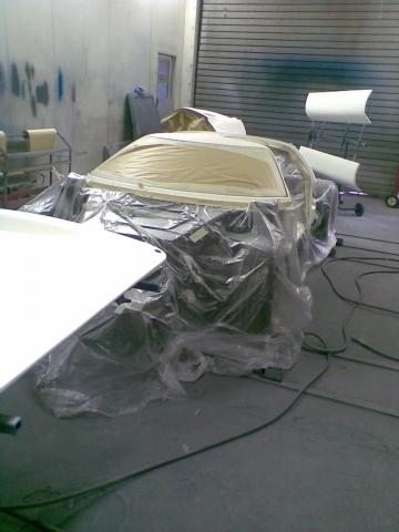

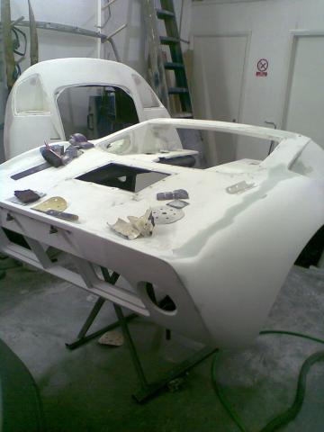

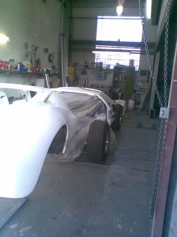

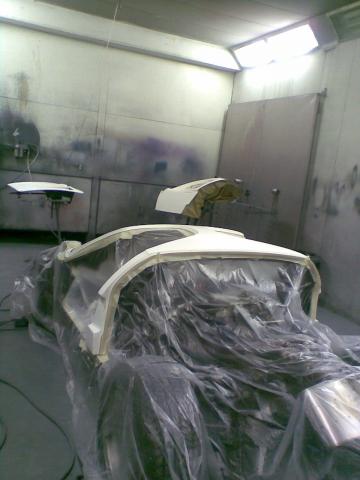

Clive, the painter has had an urgent job come in so he never got to the oven stage today Primer tomorrow morning and - thinks the white will be sprayed tomorrow afternoon
Some pictures from today

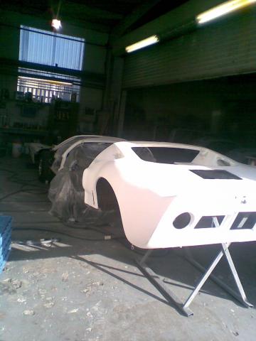

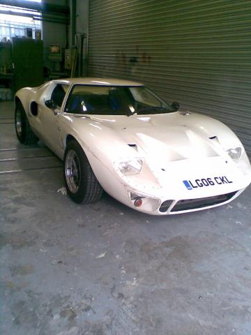

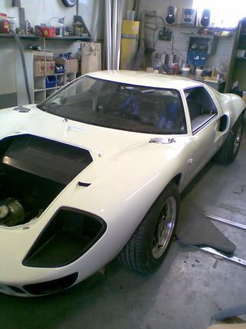

More pictures
White sprayed and looking good, black in lights etc (under perspex) should be on tomorrow along with reassembly. Nothing been polished yet.
I can't wait to pick it up and get on the road again!

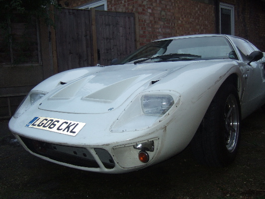

Got a picture of the "Evil Eye"
Pick up day is set for Thursday afternoon
