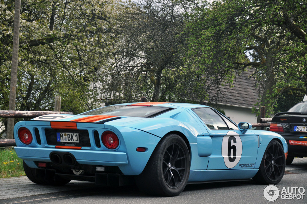

Mark, I thought about something like that. I even ordered a case of Orange plastidip to do the stripe. In the end I think I'll just paint every thing and clear coat it all. It's just the right way to do it. This is what it should look like.
Ron McCall
Here you go Dean!
The body lines on my car are better than that! I also didn't realize the exhaust came out so low. I was going to run my pipes out were the plate is.
