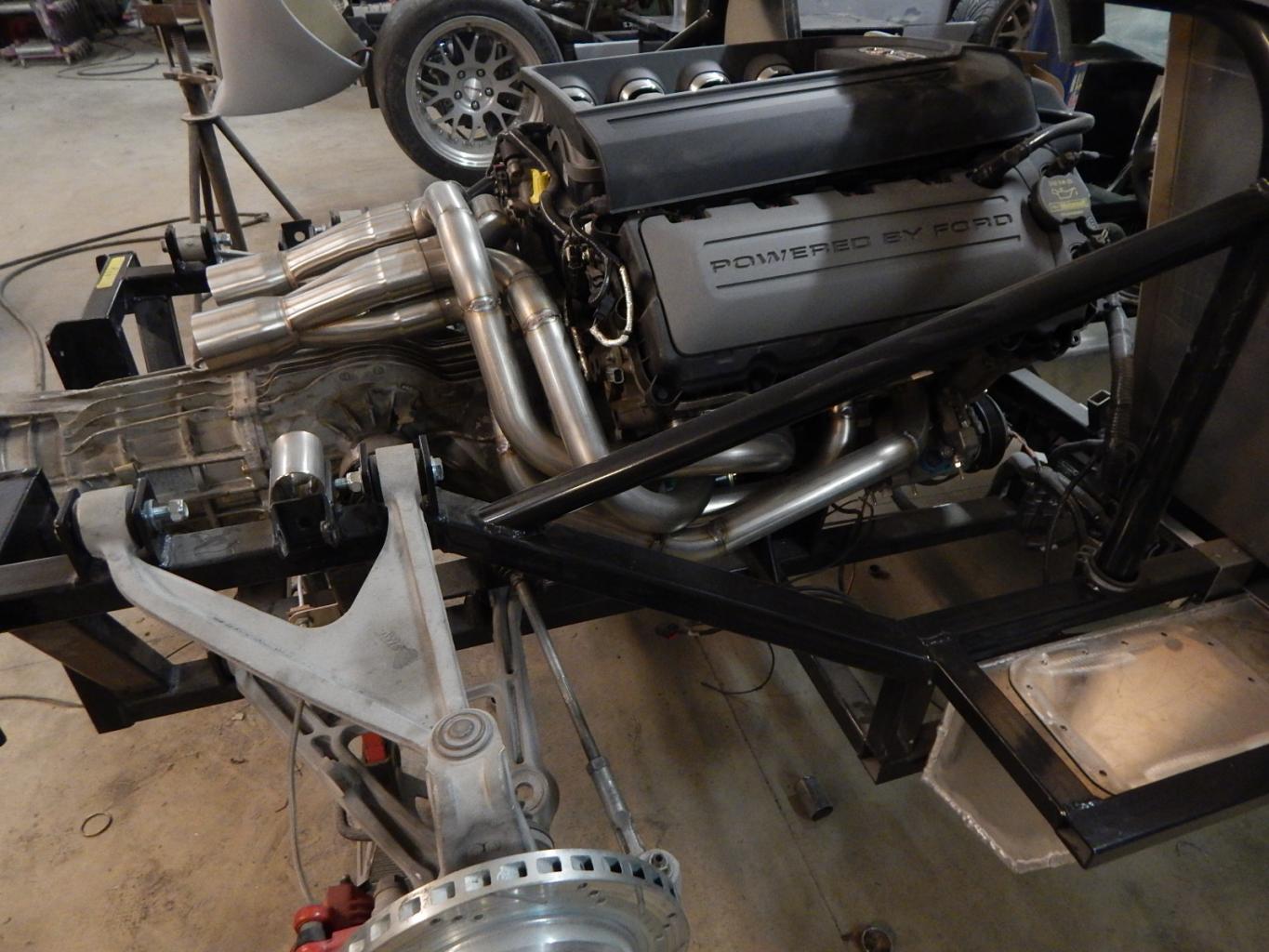

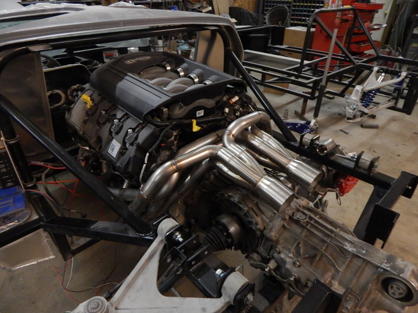

I think I have the gold foil finished up. I'm not going to do the whole rear half of the car but I think I have enough done to do the job.
I also started laying out the fuel system. I still have some work to do there but at least I'm moving forward!
I bought 5 24 x 24 inch pieces and 2 30 ft rolls of 2 inch. I have a full sheet of 24 x 24 left and some sizable scrap pieces plus about 10 ft of the last roll left. I'm sure I'll use it somewhere but I need to get the engine in and the exhaust sorted out to see where it might be needed.
LOOK WHAT THE FRIENDLY UPS DRIVER BROUGHT!!!!!!!!!!
(yes I'm screaming)
This is the new Borla 8 stack for the Coyote. Do you see the Dr. Pepper can? Look at the size of the horns compared to the can! This thing is AWESOME!!rockonsmilerockonsmilerockonsmilerockonsmile

Dean, also curious about ECU. I believe Jason is controlling ITB's with Haltech.
Loving watching your car develop.
No worries Alex! I'm a weber guy. This is just a natural evolution. But in the end, I know your right. I will probably sell them. They will cost someone $150k+ but the good news is I will through in the rest of the car! :thumbsup:
Paul and Mike, You really don't have much of a choice for an ECU if you want the Variable Valve timing system on the coyote to work. The Infiniy system by AEM is the only way to go. There are a few other Coyote engines with this system and the Borla 8 stack that have already got it figured out. AEM and Borla have been great to work with and they are pretty fired up about this project.
Dean, does AEM offer a "canned" timing profile to suit the motor? I would think finding the optimal can timing profile in addition to spark and fuel maps would be a helluva lot of dyno work.
I've never mucked with ITBs, but my '92 M5 seems to make them work ok. I gather the shafting has a big effect, compensating for geometry changes from temperature.
That's a pretty big number. Now throw in some Boss heads, more cam lift, Gen 2 stacks and the AEM VVT system then through away the mufflers and you really have something!:thumbsup:
Spud, I'll talk to the owners over at AEM and get an answer for you.
