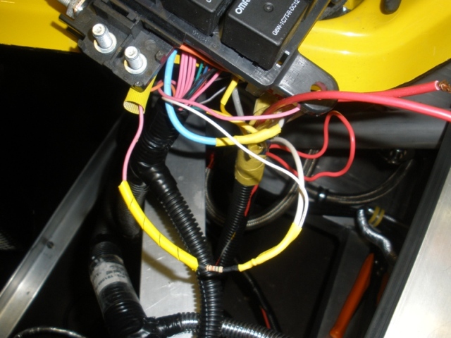

I will have three systems - the Digidash harness, the GM harness and the E-Z wire harness. I have it pretty well sorted out but I have a few questions before i post up a bunch of pictures.
In the GM harness, there is a fuse box with two 3/8 post marked A and B. It looks like one is pos and one is neg. Can someone confirm that for me? Then in the GM harness next to this fuse box is the bulkhead connection. I need to run my tach through that plug. Is there a male plug available or should I wire around that plug with the tach? This plug comes with another plug that can be removed but they look like 2 female ends. I'm not describing that too well but maybe you guys will understand.
hmmm, Im trying to think back. i didnt add this to my build log. i did add the resistor in-line that the ls376 maual mentioned. i think i split that line to digidash and heads up display. the manual said you might have to try a few k-ohm resistance but gm's recommendation was spot on 1st time.
Cant remember if a/b is +/-. maybe check with an ohm-meter? i know there are a few relays that are left open in that fuse box that were handy...
