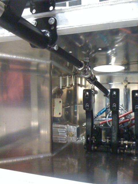

I had been waiting on a few steering column parts and now that I have them, I was able to finish the steering column.
The one piece of advice I would give is that with the race column, the universal at the rack had to be shaved down to keep from rubbing on the bulkhead. Other than that, it went together pretty easy.
