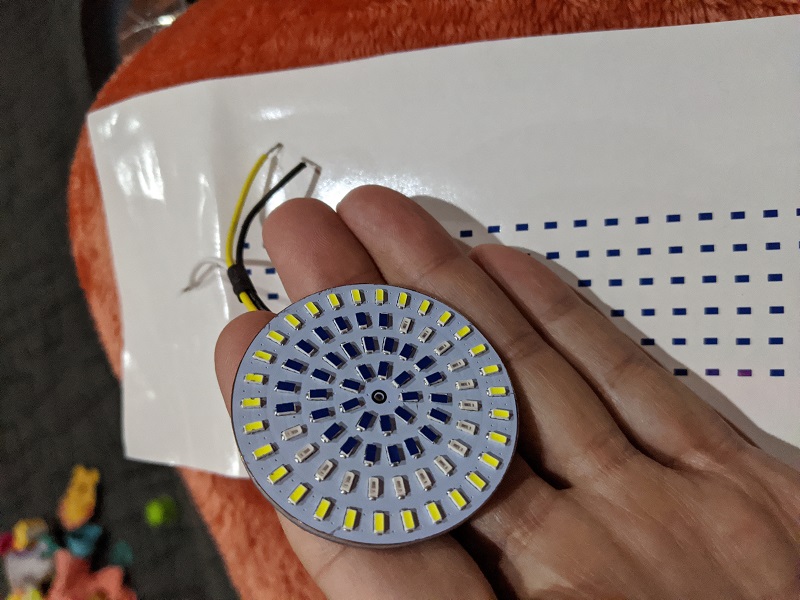

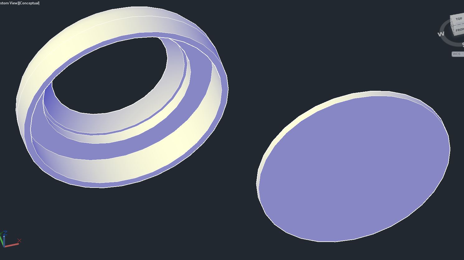

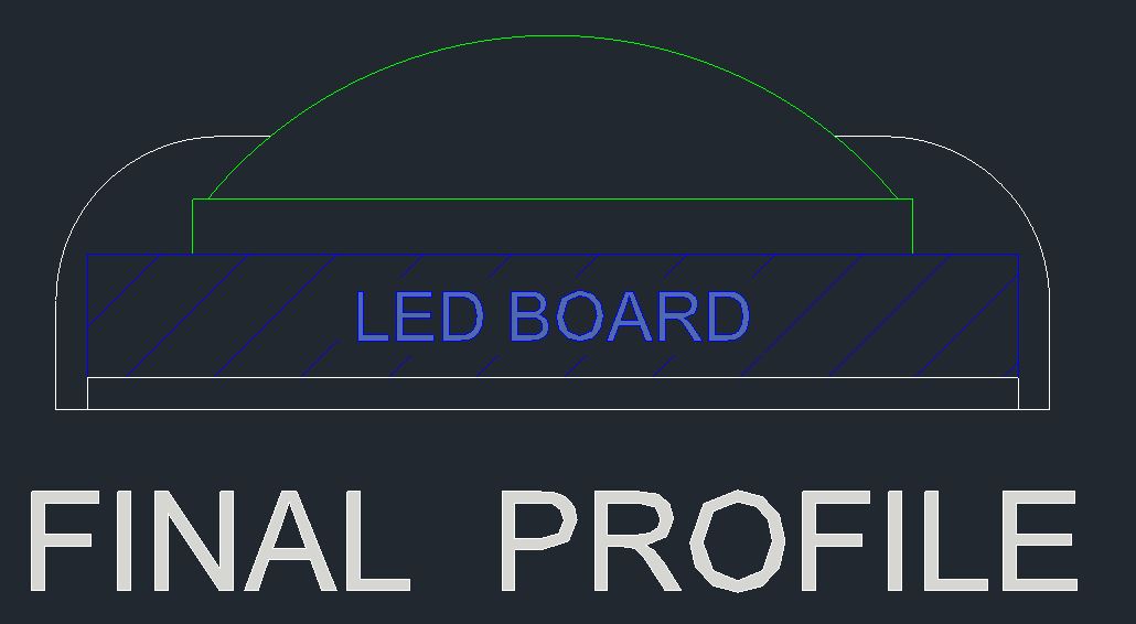

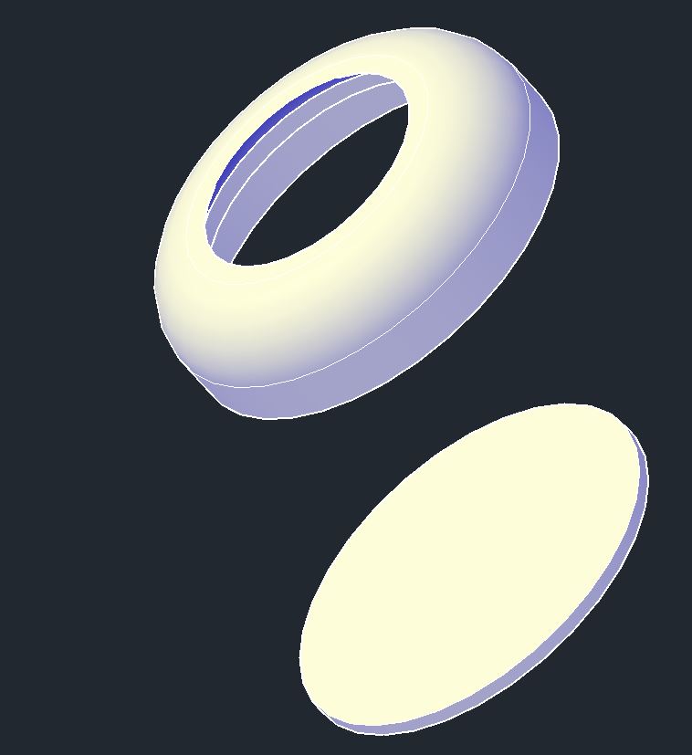

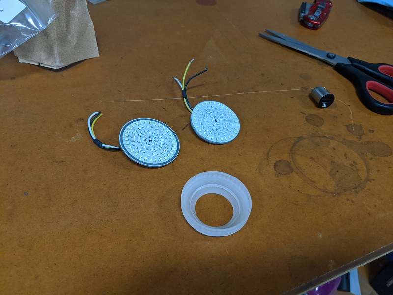

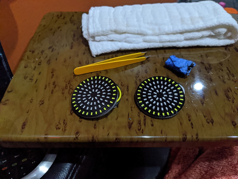

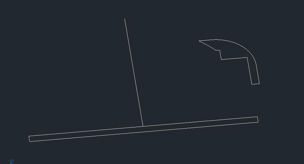

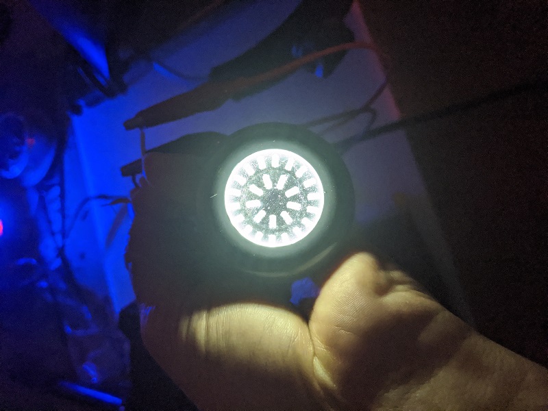

Boards finally arrived so was able to get the depth needed and finish up the drawing to send to ShapeWays. I really need to consider getting a 3D resin printer in the future.
Some of the white LEDs will be covered by the shroud, I thought about adding a provision in it so they wouldn't be. Decided to leave as is to see how it looks, may end up sanding that part down if it looks funky as the running light.

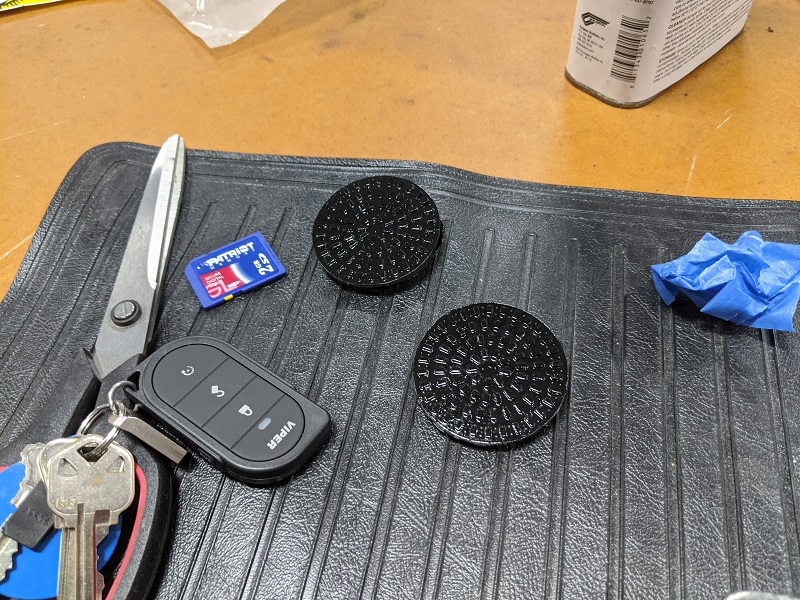

3D resin printed shrouds should show up Friday so I can verify fitment, prep and spray Grigio Telesto.

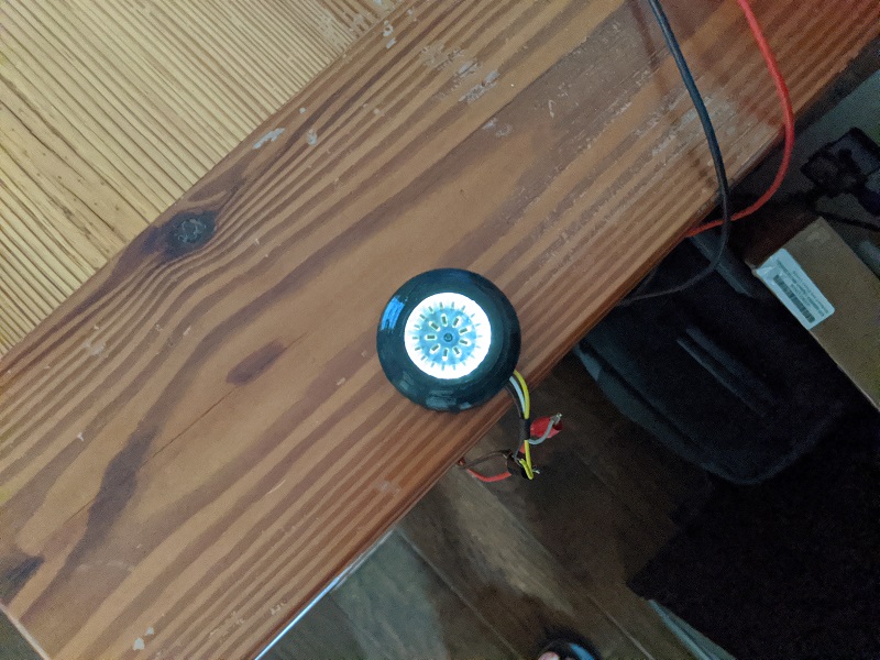

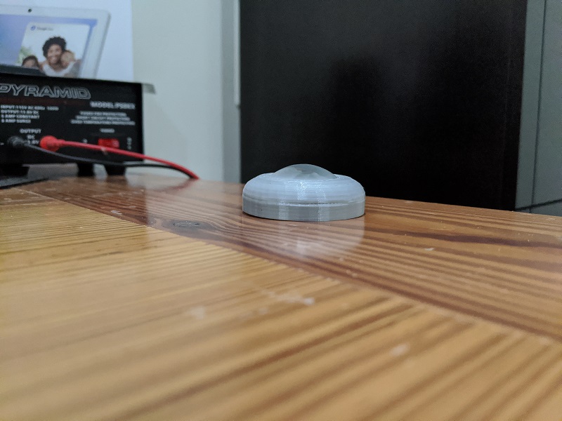

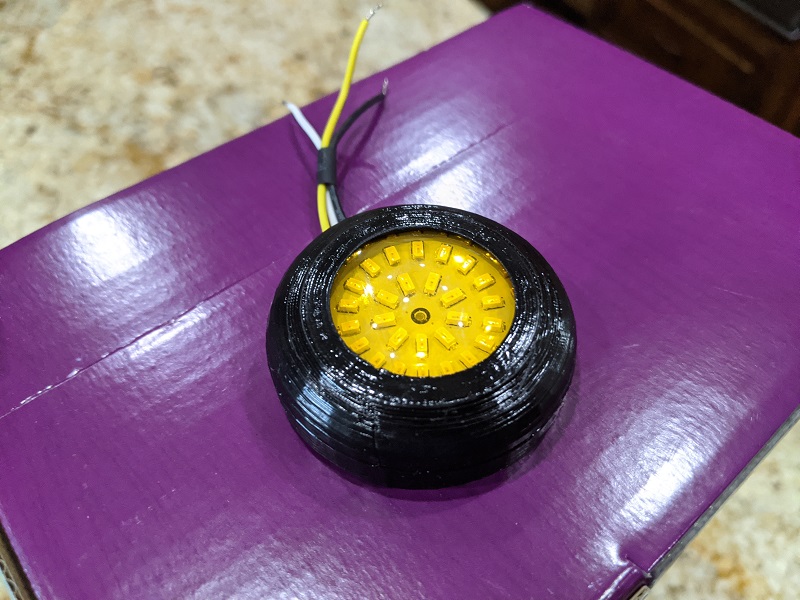

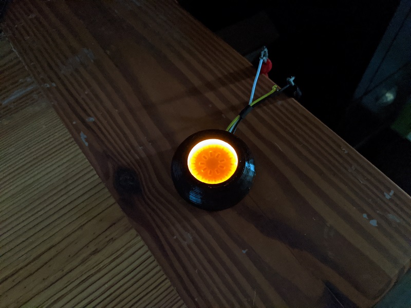

Over the weekend, I printed it out on mine in PLA since I was curious how it'd look lit up. Silver PLA is translucent so ended up spraying it black. I wasn't thinking and made the mistake and painted inside shroud black as well, on the real ones I'll spray chrome or something shiny to reflect the parking light better instead of absorbing alot of the light.
I didn't like how the white boards and LEDs could be seen so tinted the lens which looked better. Also tried translucent and transparent orange vinyl I had laying around, but made it look cheesy. Probably will end up masking the LEDs and spraying the board black, maybe adding tint to the lens, will see how it turns out.

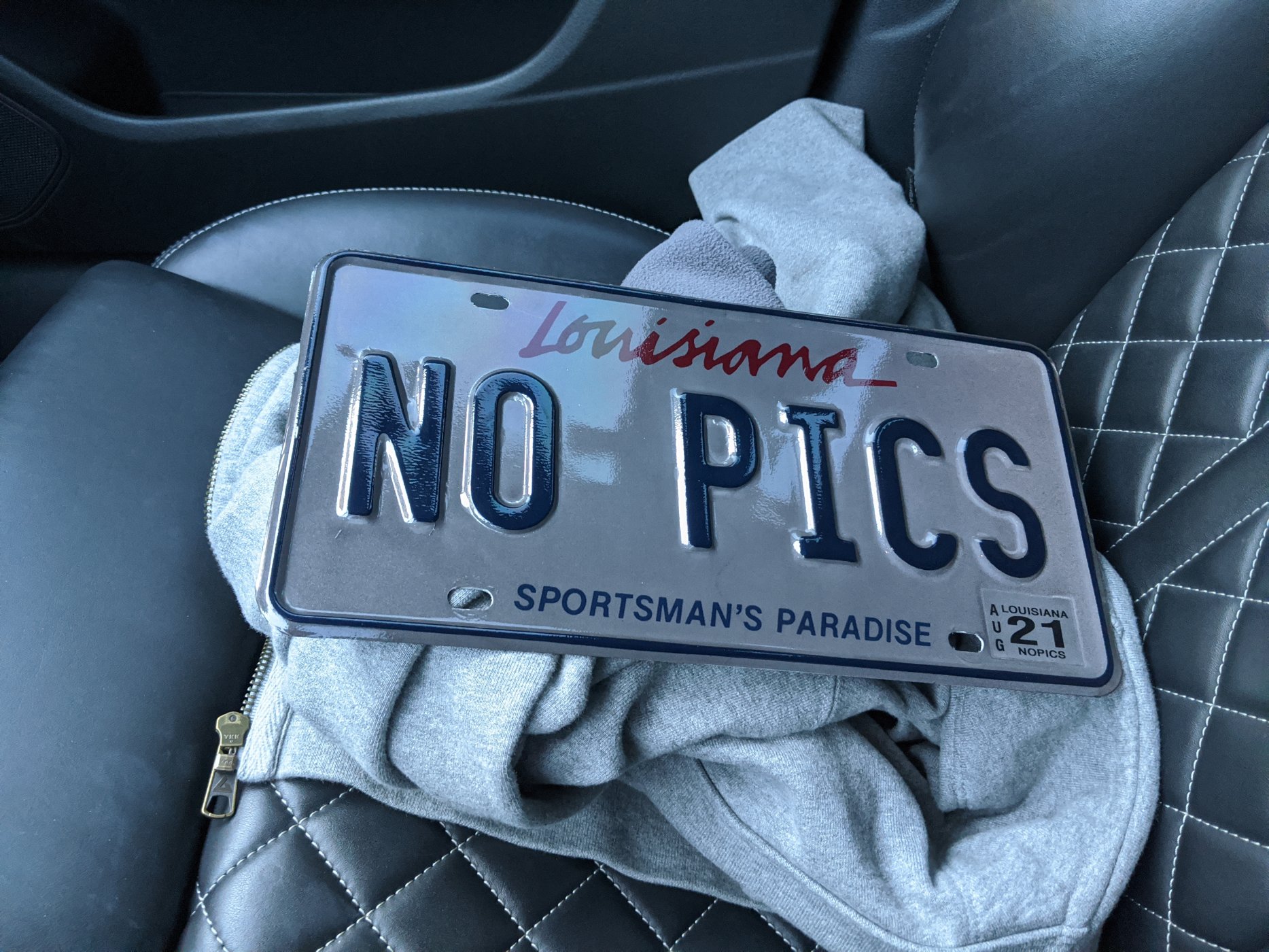

The license plate cover is something I really liked how it looked, but never really happy with the constant glare it produces when trying to take a picture. In Louisiana, we don't get the option of cool plates like Texas has so I'm stuck with a bright white plate against the gray so it stands out. I attempted to tint it myself with Vivvid air-release light smoke vinyl, but failed miserably.....way more complex to wrap than I expected. Hit up a local guy to see if he was willing to tint it, experience pays off for sure.

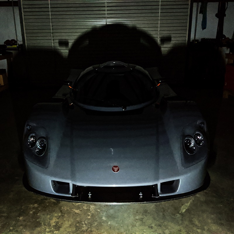

Random idea to tint the license plate since we don't get cool options like Texas, not to mention the personalized plates have no background like the regular plates so they're just ridiculously bright white (especially against the gray paint). Never was crazy about the light smoke plate cover, always a glare when snapping pictures. I also had to trim the bottom since there is only room for a bare plate. I attempted to tint it myself with Vivvid air-release vinyl, but it is deceiving and way more difficult than I expected so I had it wrapped for $35. Of course it still retains it's reflective appearance at night.
When I went to go put on the plate last night, had a random idea to snap some pictures. Turned all the lights off, put a flood light on my work bench or in front of the car and got these pretty decent pics. They do have a filter on them from my phone, but I really want to toss originals into Photoshop and see how they turn out. This really makes me want to learn how to properly shoot and edit vehicle pics.
With all this darkening of things on the car from headlights, tails, signals and now plate, I think it may be time to dip wheels a shade darker or suck it up and get them powdercoated.

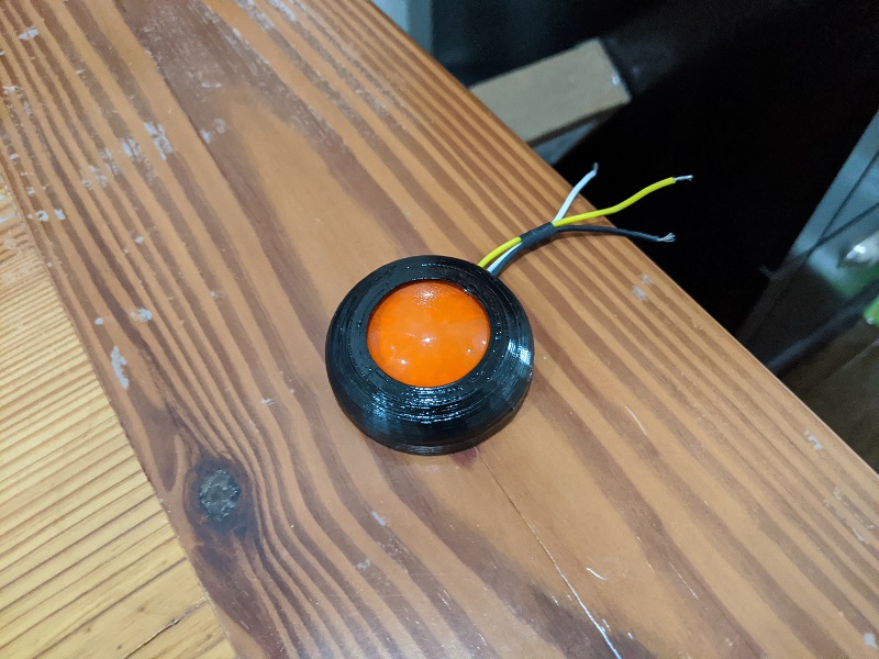

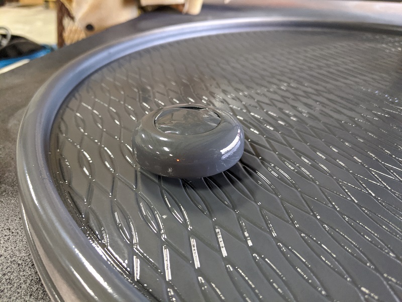

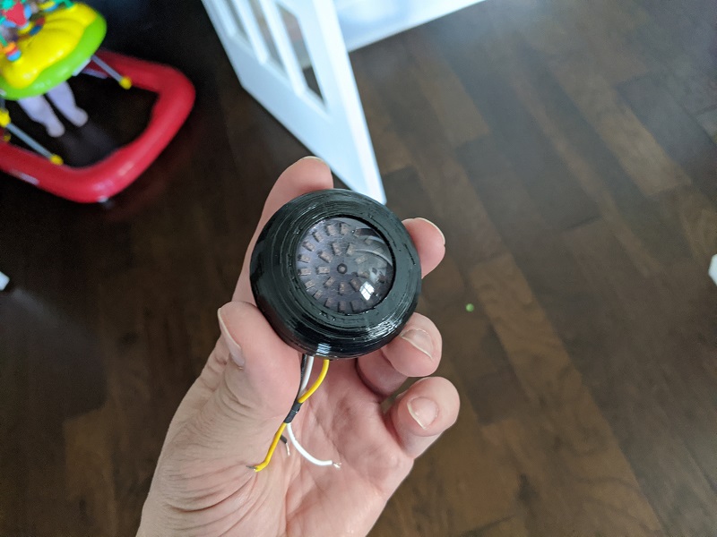

Got my resin printed signal shrouds in the mail and mocked them up to make sure everything fit as intended. Had some rattle can chrome so I sprayed the insides, then outside in Grigio Telesto and cleared. Also wasted an hour masking and unmasking all 76 LEDs (per board) so I could spray the background black. Hope to assemble them soon, curious to see how they look together and on the car.

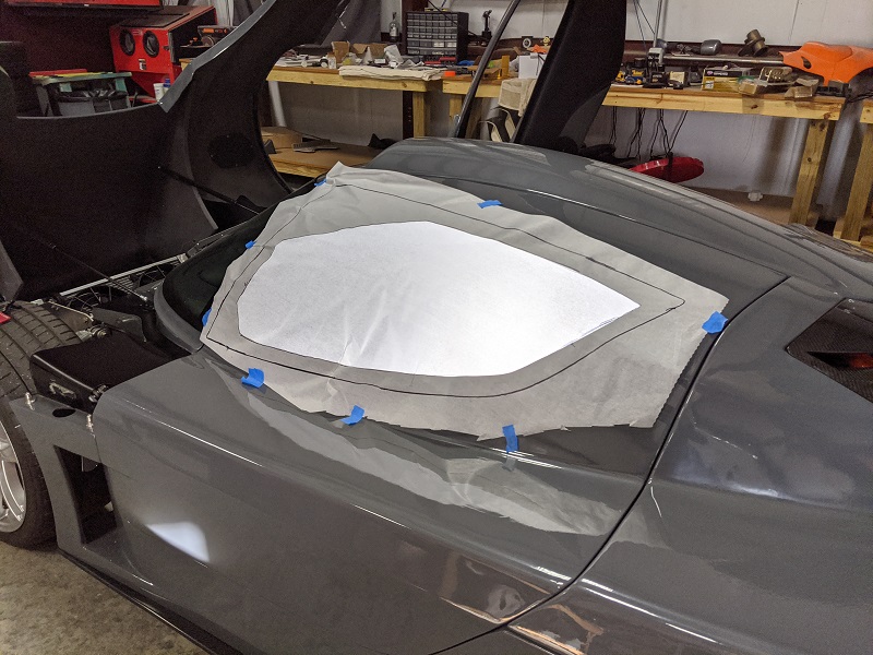

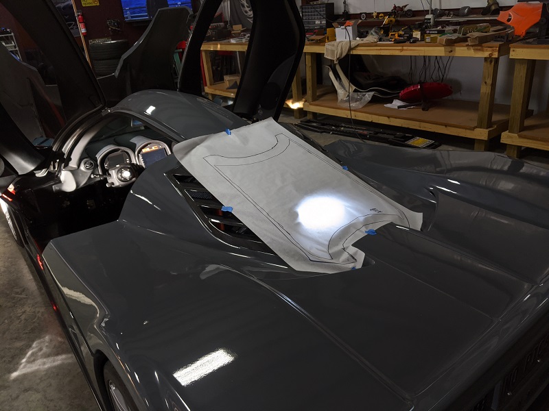

Traced my windows. I'll scan them in this week and trace in CAD so I can get a vinyl frit cutout and apply after they get tinted. Planning to get side windows in 35% and I think I may go ahead and let them do the rear window in 50%. Only reason for tinting the rear window is so the window matches the body color and blends in a bit.

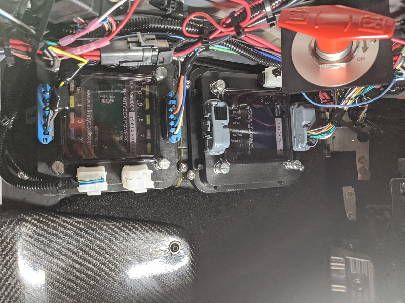

Tinted the covers for the InfinityBox cells. While I haven't driven in complete darkness, figured the passenger side cell may get annoying to see it flashing out of the corner of my eye.

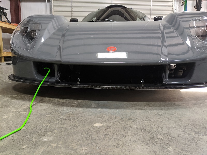

Been wanting to hide the AC line in front of the radiator so covered it with some split braided loom. I didn't notice the other line in the corner, will have to do it another day.

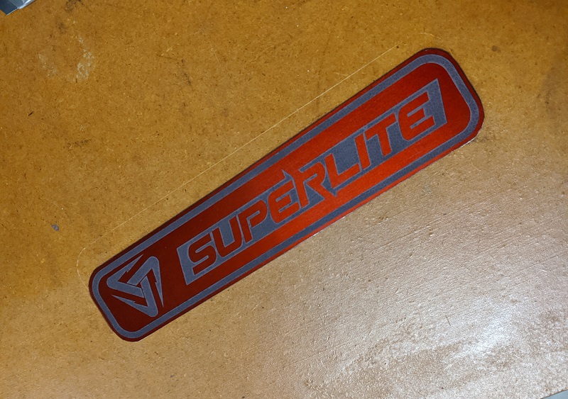

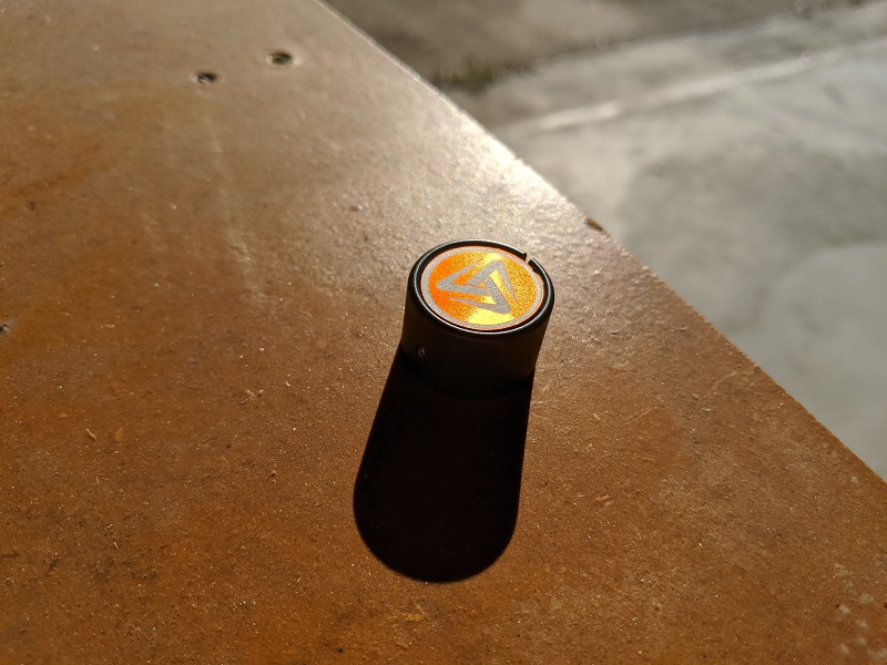

When my buddy sent me the orange anodized VIN tags, he made a few extra things for me (like hood emblem). I wasn't sure what to do with the little emblems, but was curious how they fit on the HVAC knobs so had to see. I won't use them, don't need anymore logos in the car but are cool looking nonetheless. The picture with 2 emblems, top is in generic light smoke, bottom is Vivvid air release light smoke. I like how the Vivvid makes the lasered part more gray so will retint nose emblem at some point.

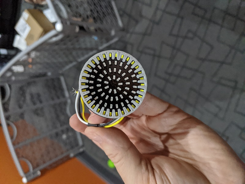

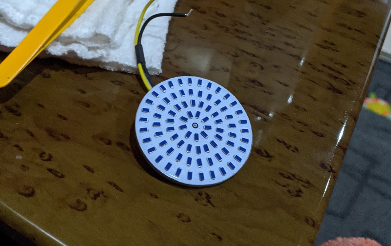

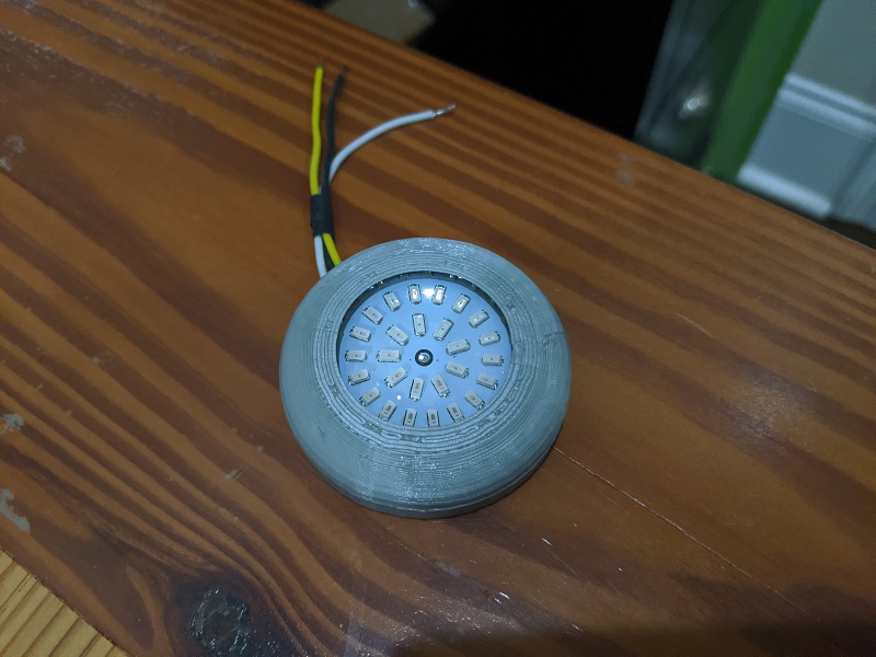

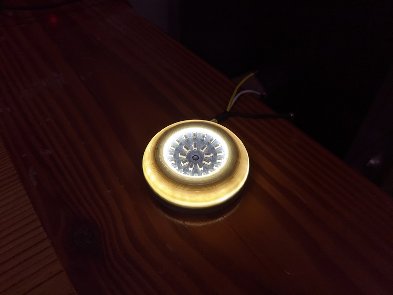

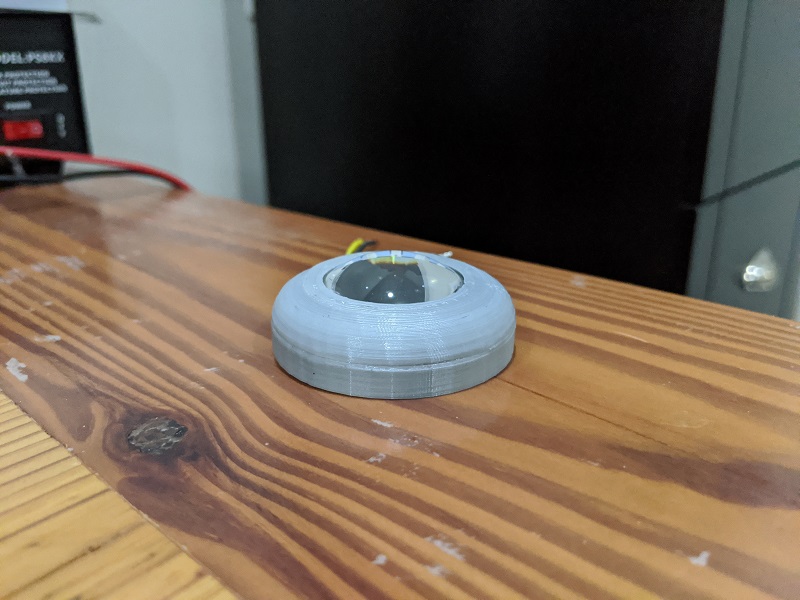

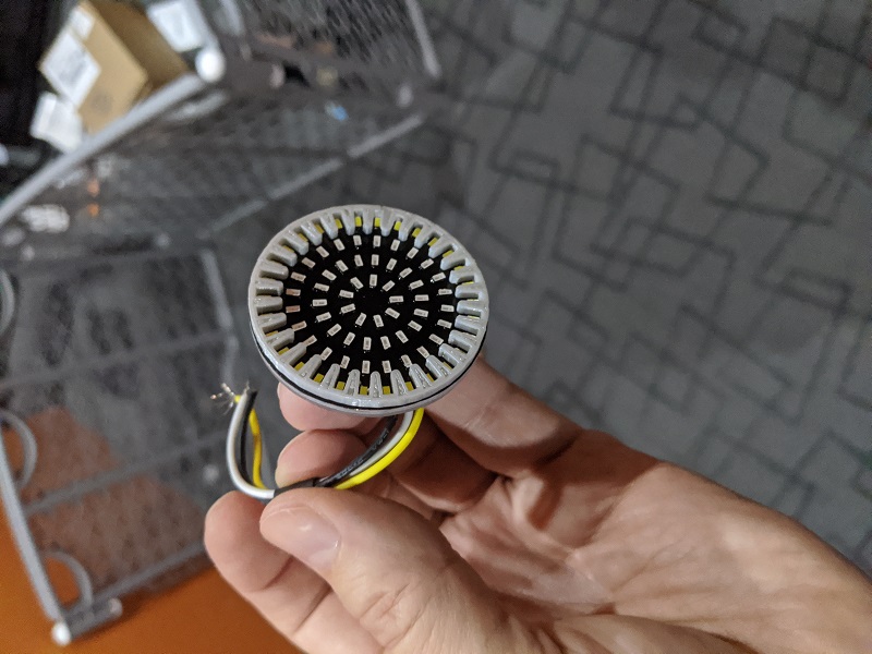

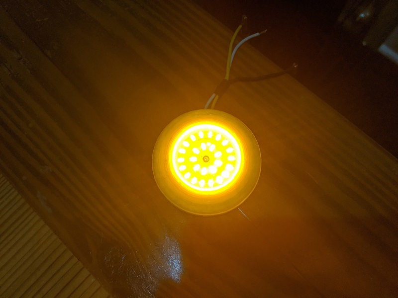

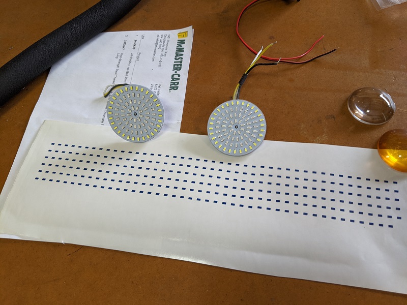

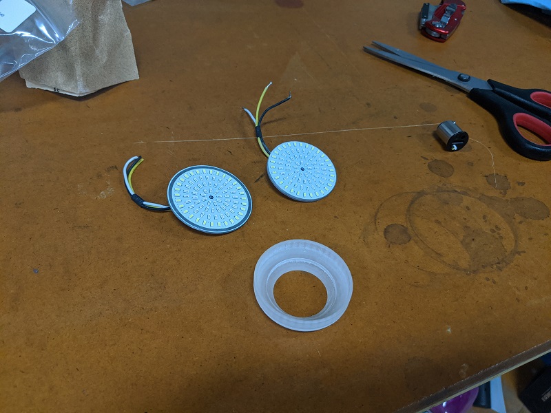

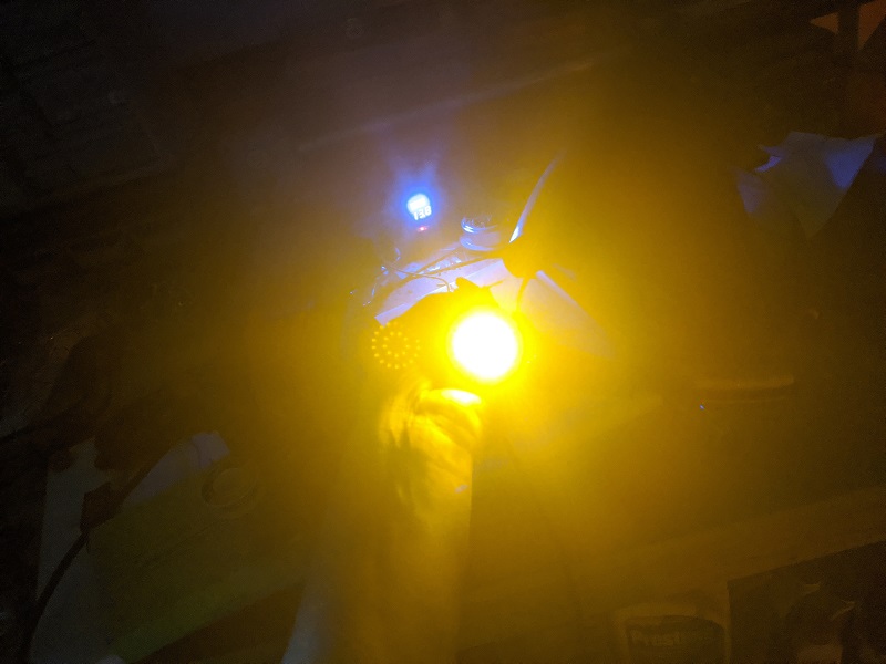

Had to print a spacer out to put between the LED board and lens so it could distribute the parking light ring. Ignore the dirt and finger prints on the lens, just a test fit.
Seems I'm trying to see how many components I have to make a stupid turn signal, lol. In my defense while my wife is finishing up her semester I don't get much shop time since I have the kid, so with something like this I can do little here and there.... Just it gives me way too much time to think. Class ends Friday so next week I'll be able to get back on the SLC and install these, new android headunit and few other things I have been wanting to do.

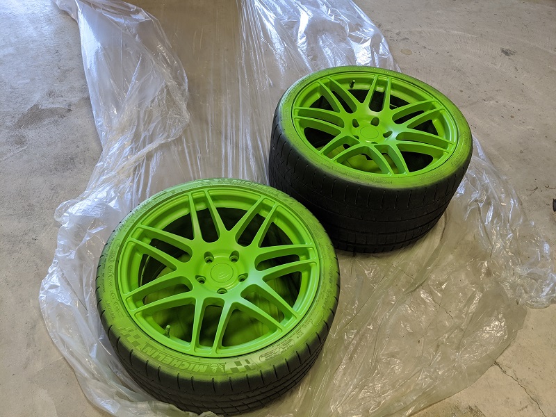

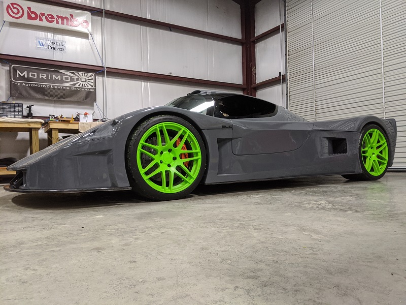

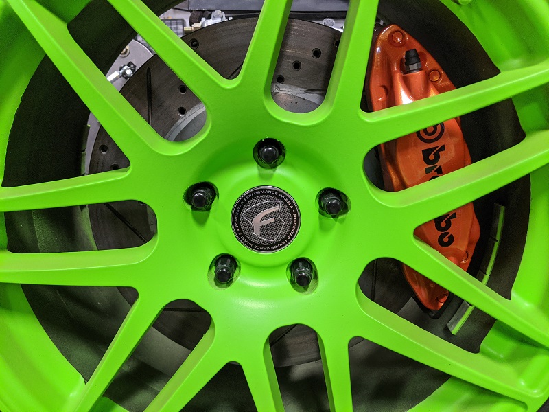

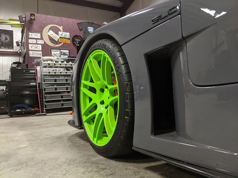

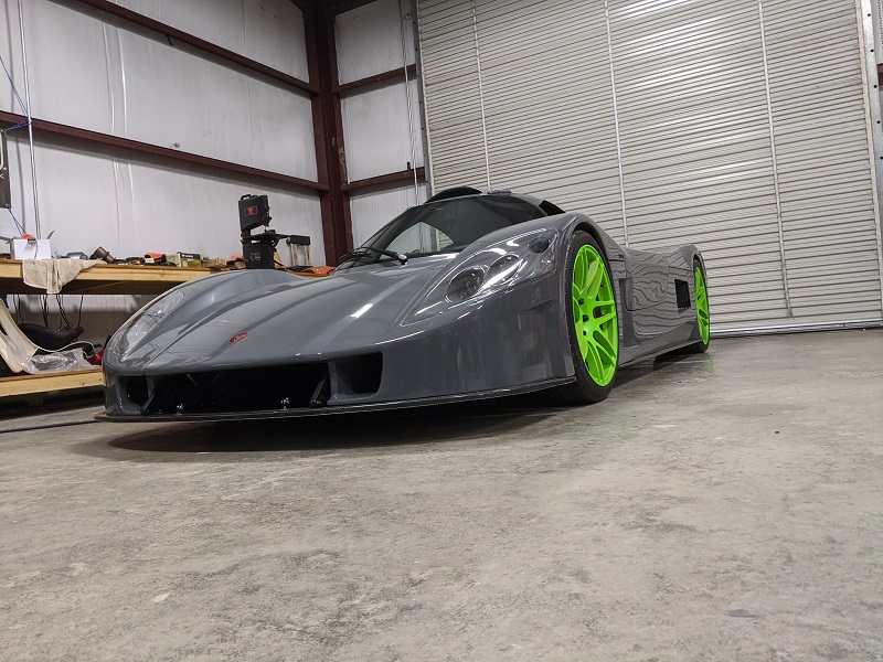

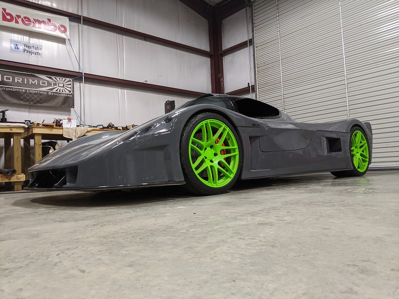

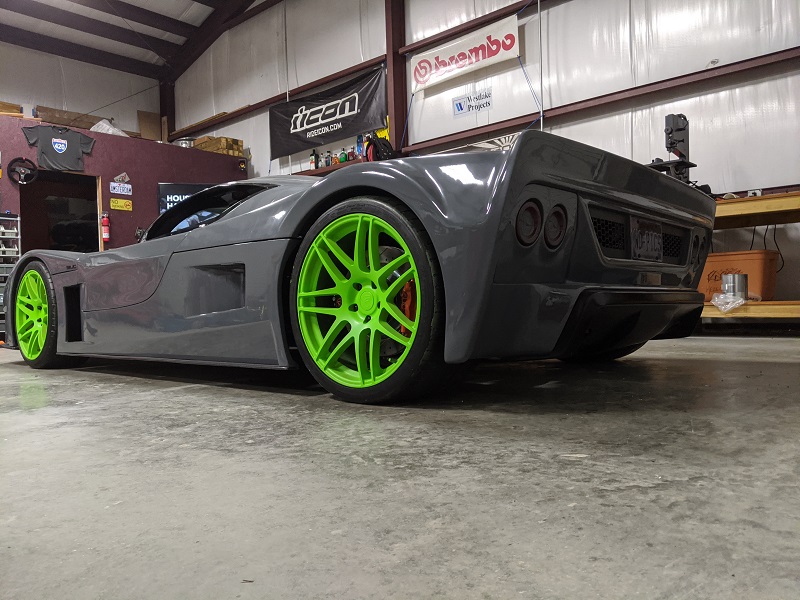

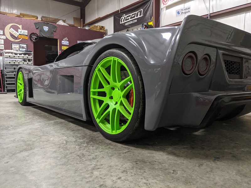

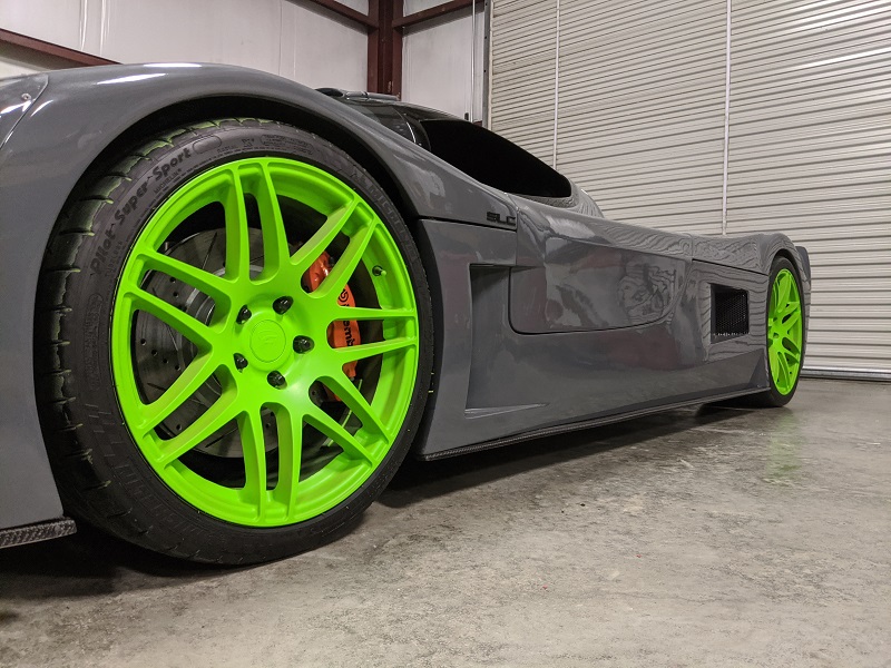

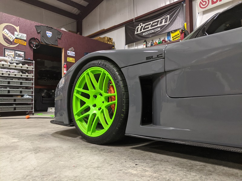

Fixing to peel the silver dip off the wheels to get them powdercoated a more normal color. I had a few cans of lime green dip sitting on the shelf and the idea to see how it looks on the SLC wheels became too much to resist....

I like the look. Reminds me of the Mazda 787b le mans car, orange + green.
I'm kind of digging the look. Don't know if I could do it permanently, but is cool. The orange and green doesn't clash as much as I expected.
Uploaded a quick video of silver vs green
I like it.
Did you prep the tires or did the dip just peel off??
I did put the stuff on that makes it peel off the tires easier. I didn't clean or prep the silver dip when I sprayed them green, just quickly wiped it down and went to town spraying. Didn't really care about the quality since it was just for fun. I did peel a center cap just to see how easy it would be when I peel it all off, surprisingly the colors didn't come off together.
Not really looking forward to peeling all the dip off, seems like it'll be a pain. Pressure washer and GooGone will be waiting to help.
