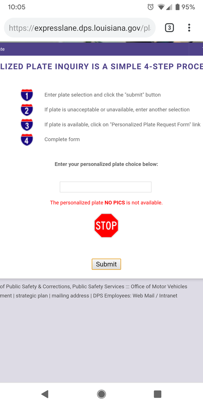

While there I also reserved my personal plate. I'm not confident people will find the humor in it, it's meant to be funny.....especially after my first gas station stop and everything I've read about owning a SLC. Confirmed today it was indeed reserved.
