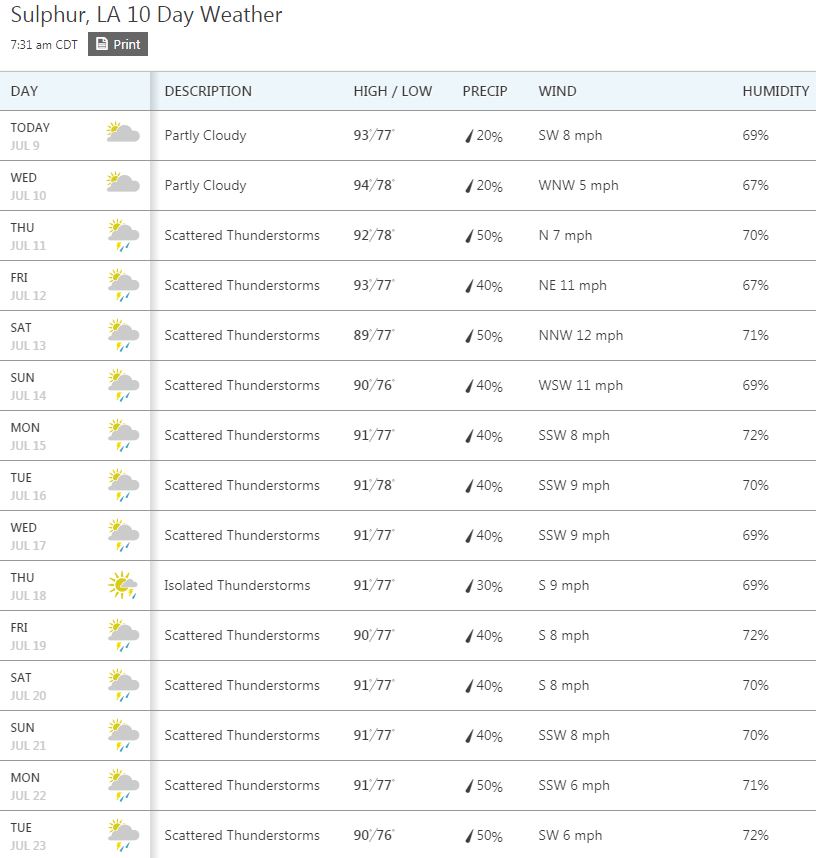

Never fails, trying my best to break in engine/clutch and get this forcast for next 10 days. Hopefully will have some dry spots and time to get car out for some miles.

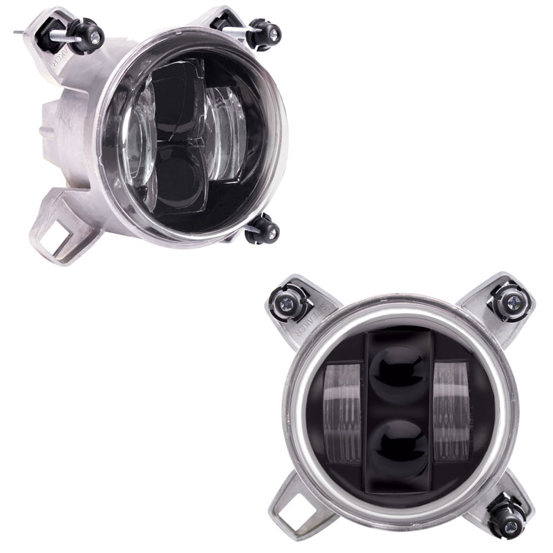

I forgot to share that while Allan was building the car, I was digging around for alternative headlights to use in lieu of the Hellas while keeping with similar dimensions due to space requirements with the inner fenders. I found JW Speaker makes some very nice LED replacements and while I REALLY wanted to use them, the $216/light made me shy away. Nonetheless, it's an option for anyone looking to go with a legit LED sealed headlights.
JW are 90mm lights, 85mm mounting tabs & 90.3mm depth. Same dimensions for the Hella projectors, other than Hella has a 165mm depth

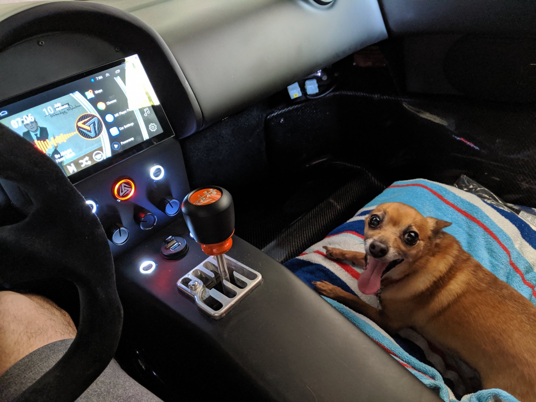

While browsing to see if they had any alternatives for the android headunit, I don't think I shared the headunit I went with. While it works perfectly fine (thanks again Scott for wiper stalk delete!), I do wish I had a volume knob instead of using buttons to make life a little easier. The current unit is probably as deep as you'd want to go for a stock dash, but will keep an eye open for another with a volume knob.
FYI I'm running WebCarGuru launcher on mine, perfect for the SLC with everything easily seen and accessed.
Current android screen:
I've been pondering infotainment systems recently ... thank you!
Welcome! This is my 3rd android headunit and less than half price of the other 2. I can't tell any performance difference using it compared to the others, but 95% of the time it's on the launcher you see playing music.
My only regret is a volume knob, but that's just personal preference. With CarWebGuru launcher you can customize themes, I bet I could add bigger on screen volume buttons that would be easier to use. I'll have to give that a shot now.
