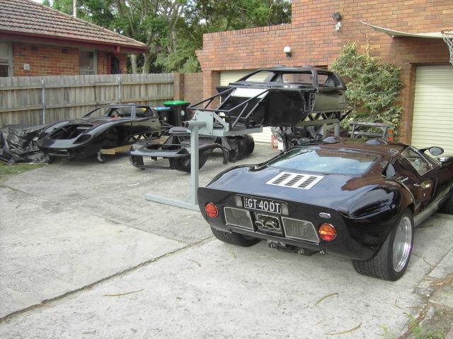

This was as much a surprise to me as it may be to some of you.

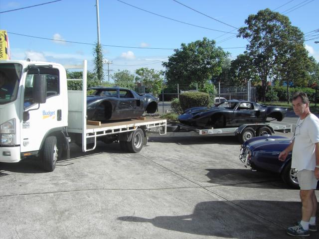

After I finished Chassis 68 my lady, Simone, and I have enjoyed some great times driving this car.
On one trip to Wakefield Park Raceway for a bit of fun we were leaving to go south and I let my lady drive one of the road sections that I knew she would enjoy.
Unfortunately she enjoyed it too much and has been at me ever since to build her her own GT40.
I finally relented and at the same time my older son David also expressed a long term desire for a GT40.
I agreed to build one for Simone but told David that if he wanted one he would have to build it himself although with my guidance if required.
As a result the following photos show the outcome.

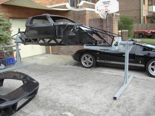

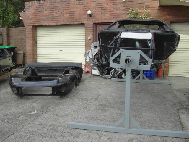

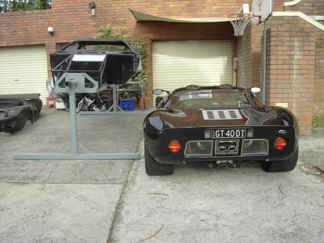

We are now underway and because we are building two GT40's I decided that a Chassis Rotisserie would make life easier for the under car work in the earlier stages so I have just finished building one and have 109 on it.
These 2 new 40's will be identical to my 40 with the possible exception of power steering for Simone's car as she finds the steering a little heavy at slow or parking speed.
Progress photos will come as the builds continue.
Dimi

Love the rotisserie - it would have made my build a whole lot easier !

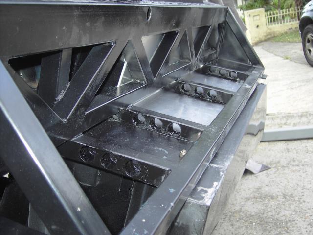

Dimi Terleckyj
Hi all

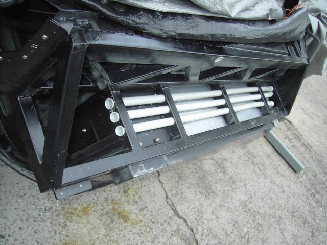

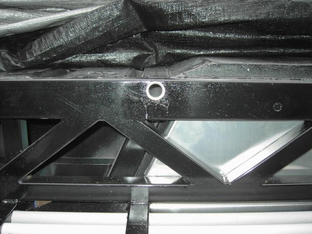

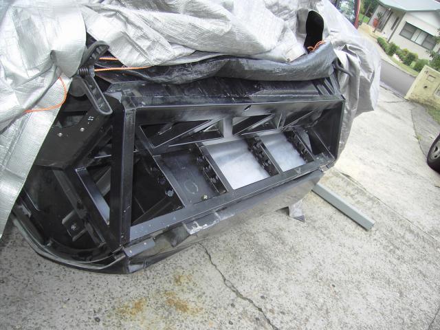

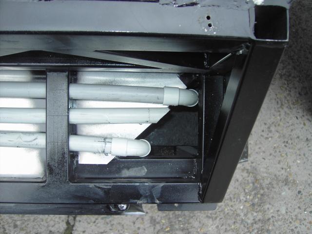

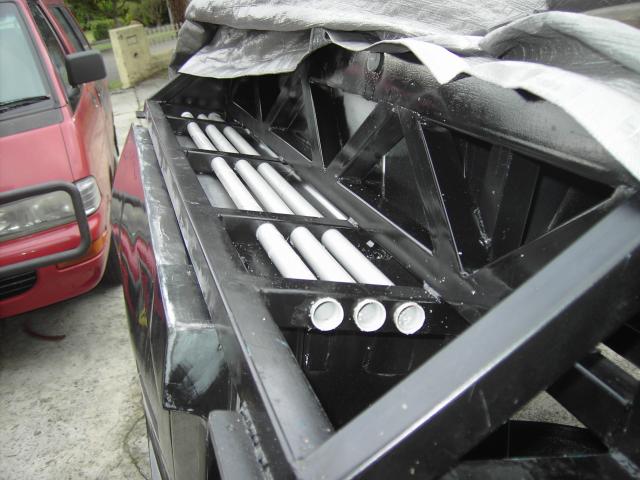

One of the problems with a GT40 is in trying to find ways to get wiring and other things from front to rear of the car both during construction and especially after the car is finished without having to pull things apart.
As with #68 I have installed 3 one inch conduits on both sides through the chassis which allow cabling and permanent access from front to rear which is easily accessible any time.
I have also fitted a one inch conduit across through the chassis for the fuel pipe which will provide the cross feed between the fuel tanks.
These conduits can be used for anything needed front to rear and don't interfere or reduce space for fuel tanks or using space in the transmission tunnel that is needed for other things.
Also a photo of young David who will be building 108 as I build 109.
Since we picked up the new chassis I can't get the smile off his face.
It will be a good learning curve for him.
Dimi

Dimi,
Very smart the idea of the conduit. I accomplished the same idea when I ran the vent lines for the fuel tanks. I put one at each end of the tanks and wanted only one outlet, so they are linked. Wish I had thought of it when I first started my build.
I'm doing the same on the SL-C. Don't forget to place an extra "pull" wire in the conduit to pull extra wire through if needed or for repair.

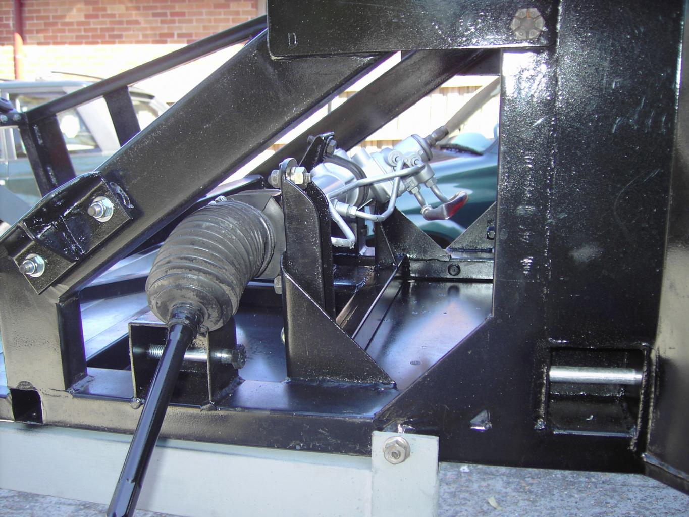

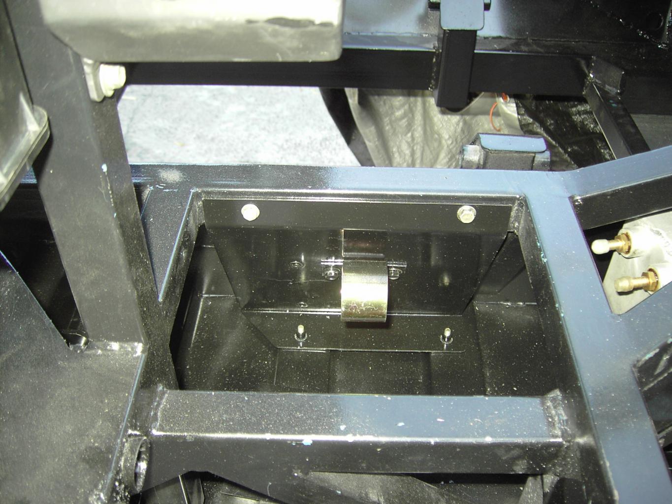

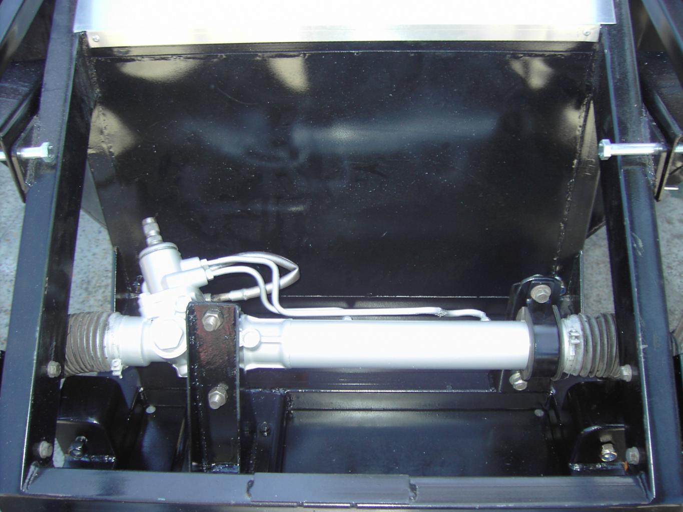

As previously mentioned 108 is being built primarily for my lady, Simone, to drive and as such one of the requirements was for power steering.
After some research a power steering rack out of a 96 Toyota van was chosen as this is a very rugged rack and the track width is perfectly suited to the DRB with Corvette suspension and as I am using the steering column out of the same van all will mate together nicely.
The only thing required to make this fit was a couple of simple brackets to fit the Toyota mounting rubber in the stock method.

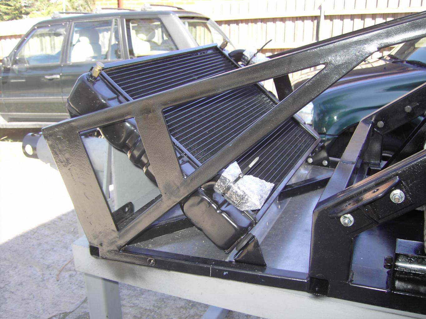

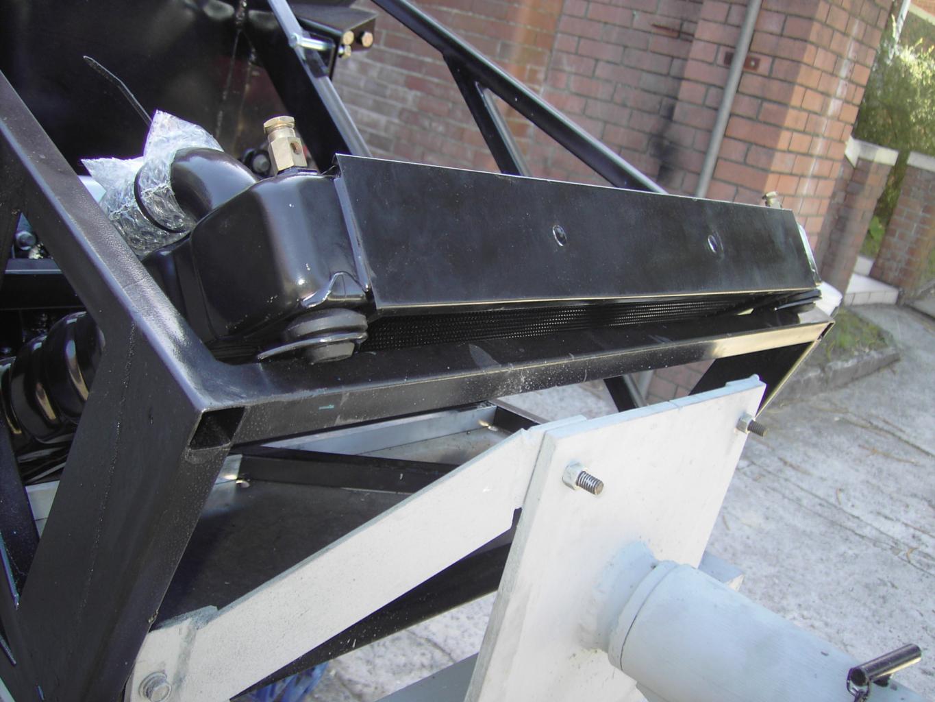

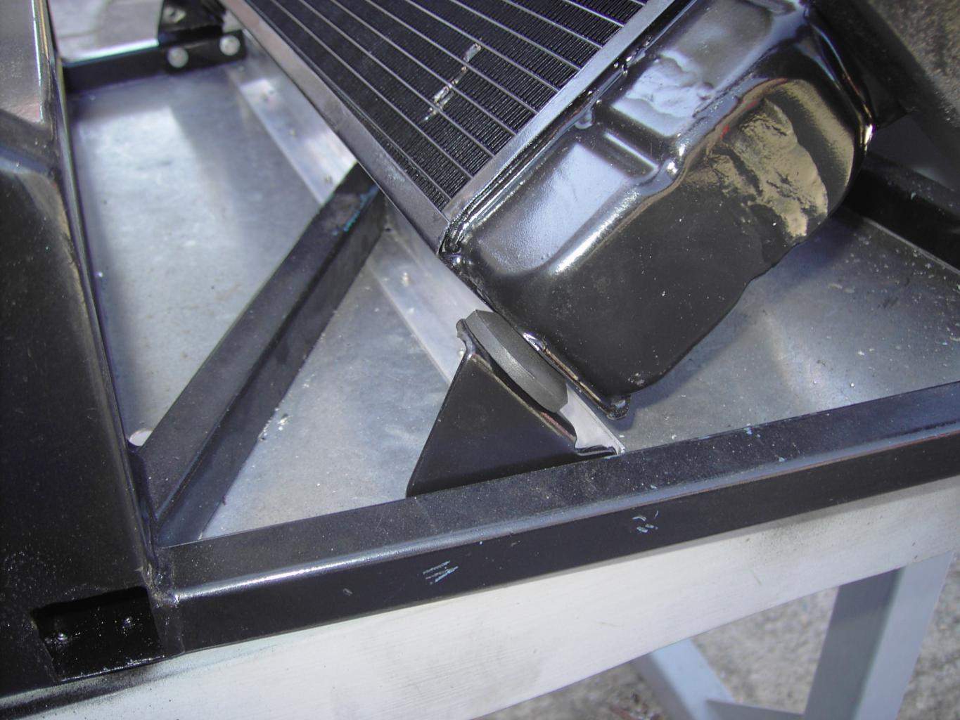

The next thing was to fabricate some mounting brackets for the radiator to allow the use of GM soft mount rubber donuts to avoid any stress to the radiator due to vibration or chassis flex.
I had a friend of mine build the radiator out of brass and copper to enable it to be repaired easily should it be required, unlike alloy radiators which are difficult if not impossible to repair.

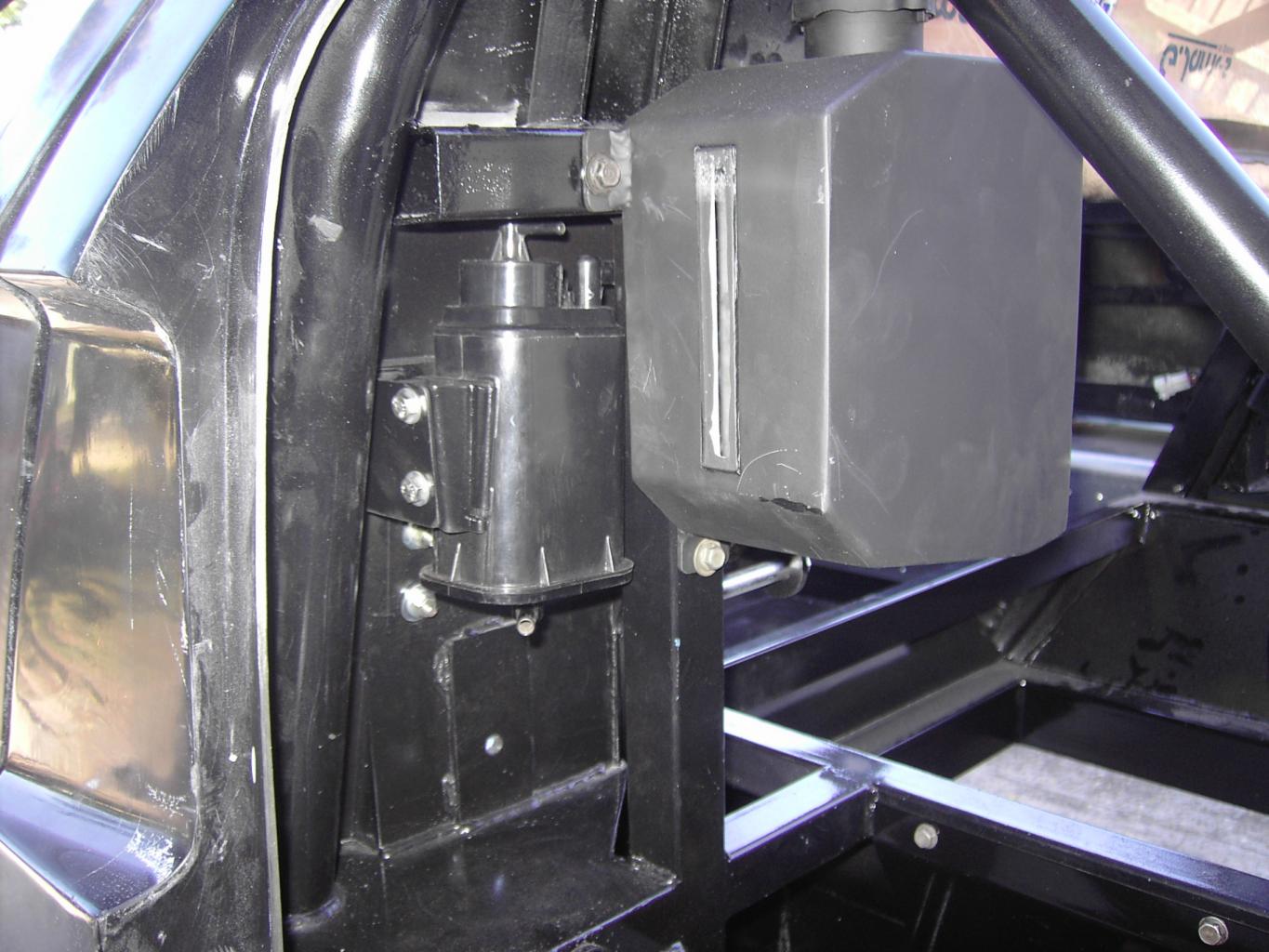

I fabricated an alloy coolant overflow tank with the addition of a sight glass in the side to allow easy checking of coolant level.

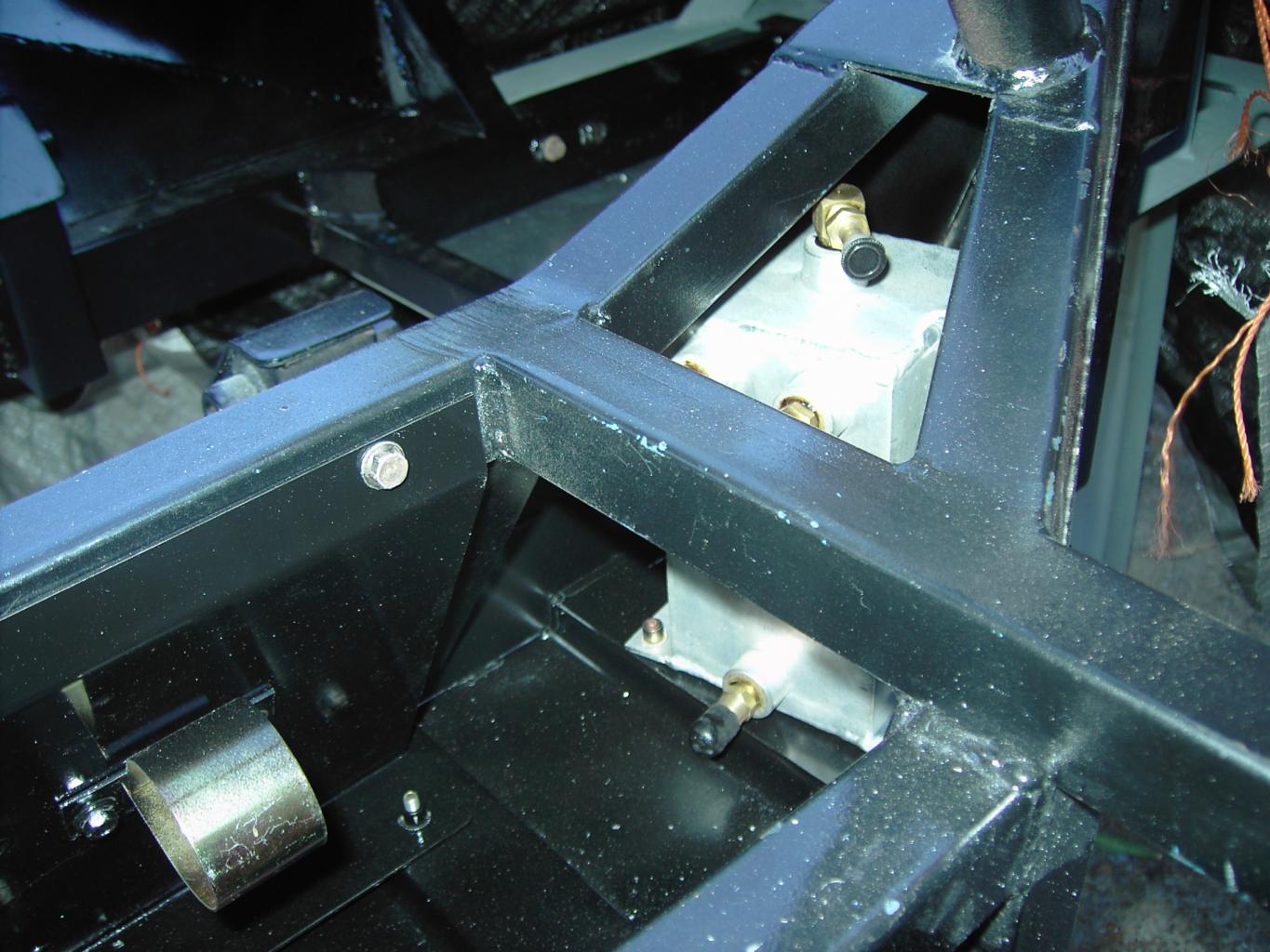

Beside that is mounted the charcoal cannister for the fuel tank breather system.
In the rear chassis suspension void is the fuel surge tank along with the mounting plate for the high and low pressure fuel pumps.
The photos below detail the above progress.
Dimi

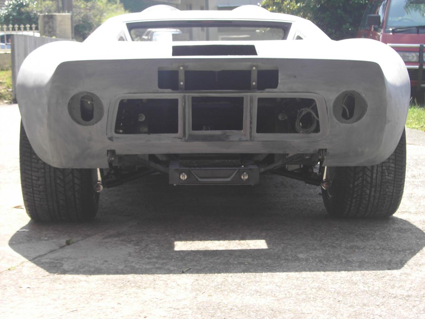

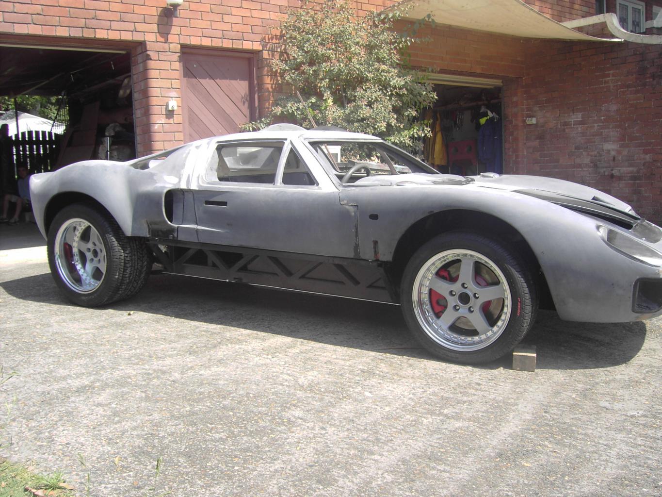

Hi All

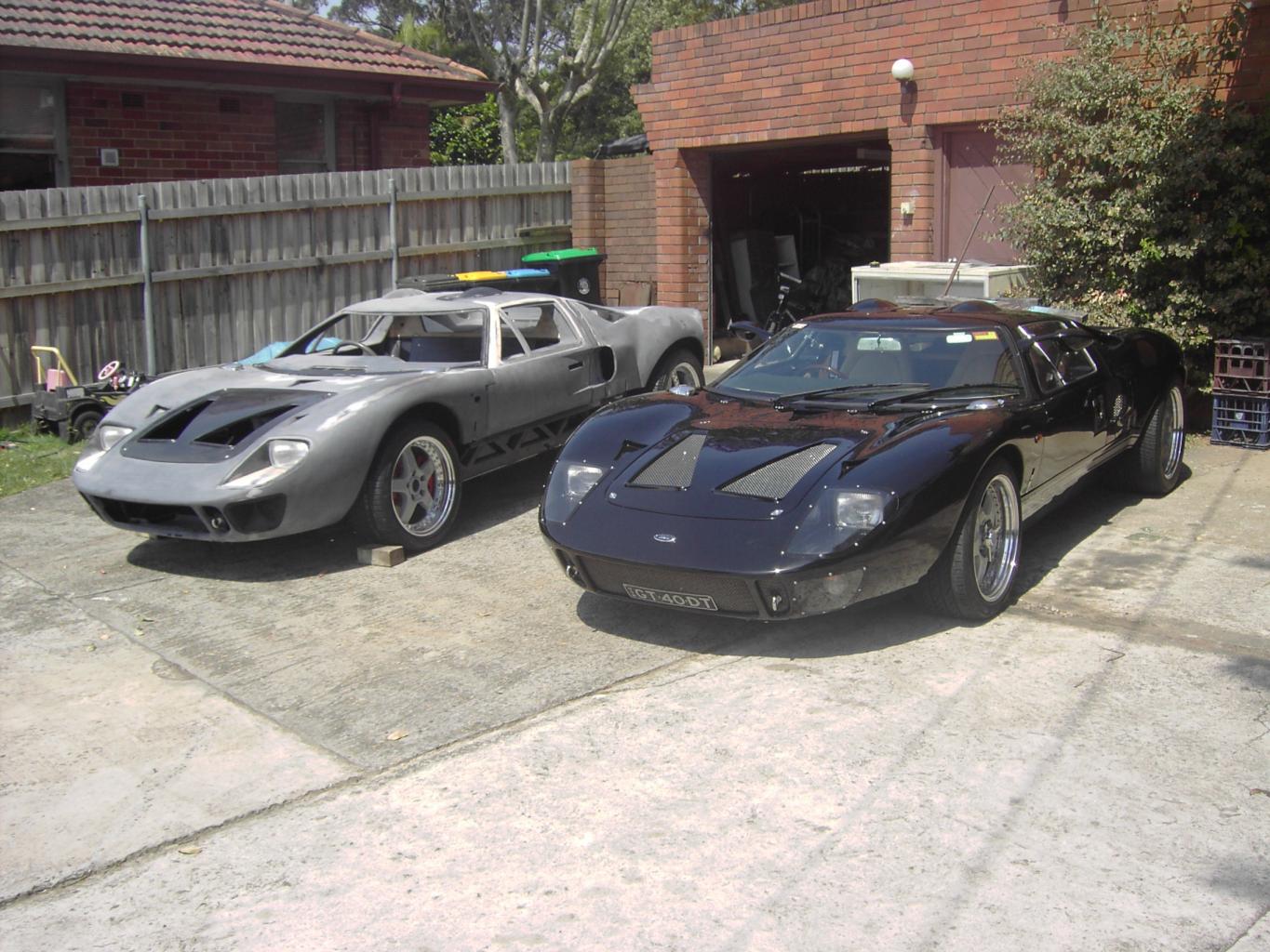

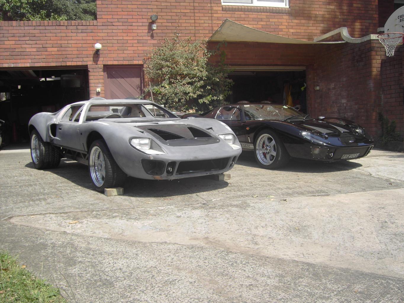

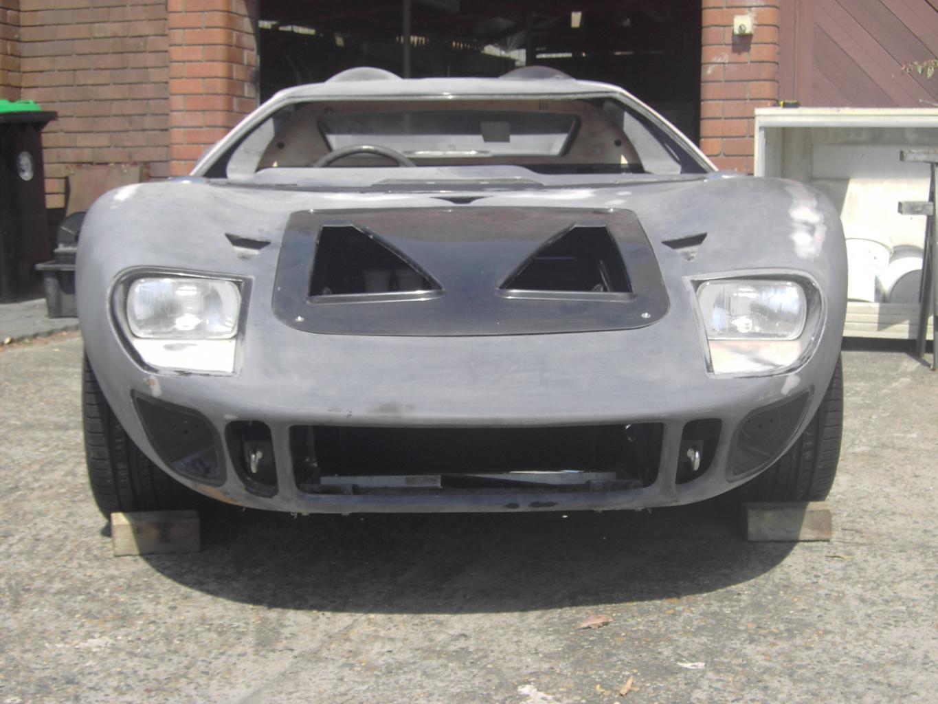

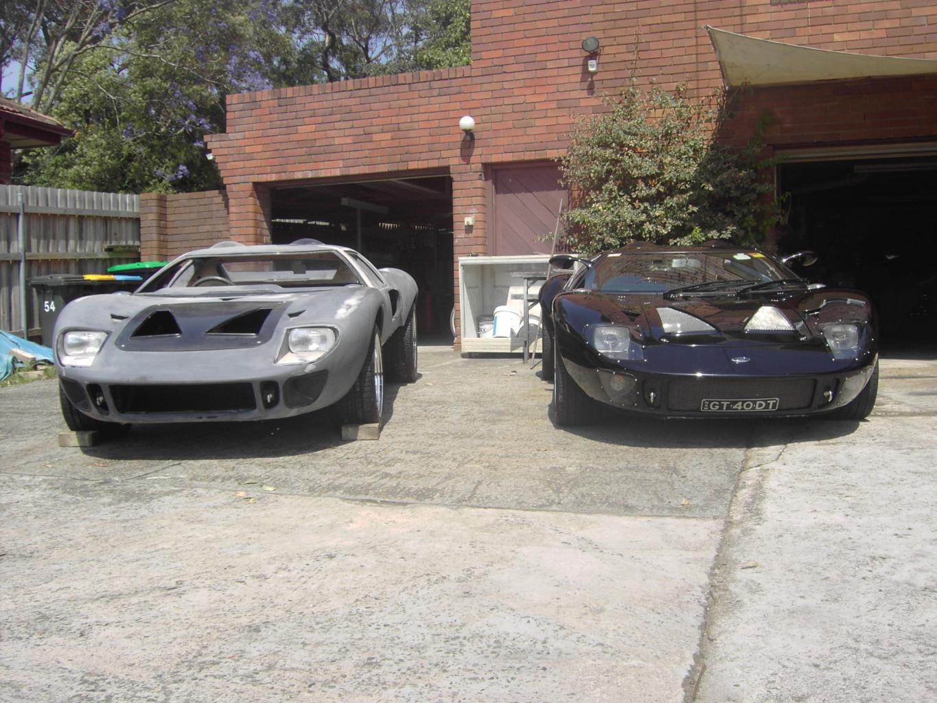

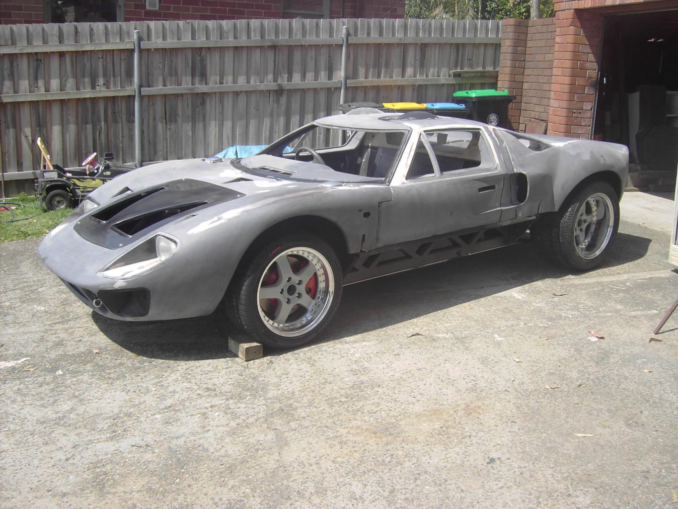

Time to update some more progress.
Life has been getting in the way of our builds, as usual, but things are progressing.

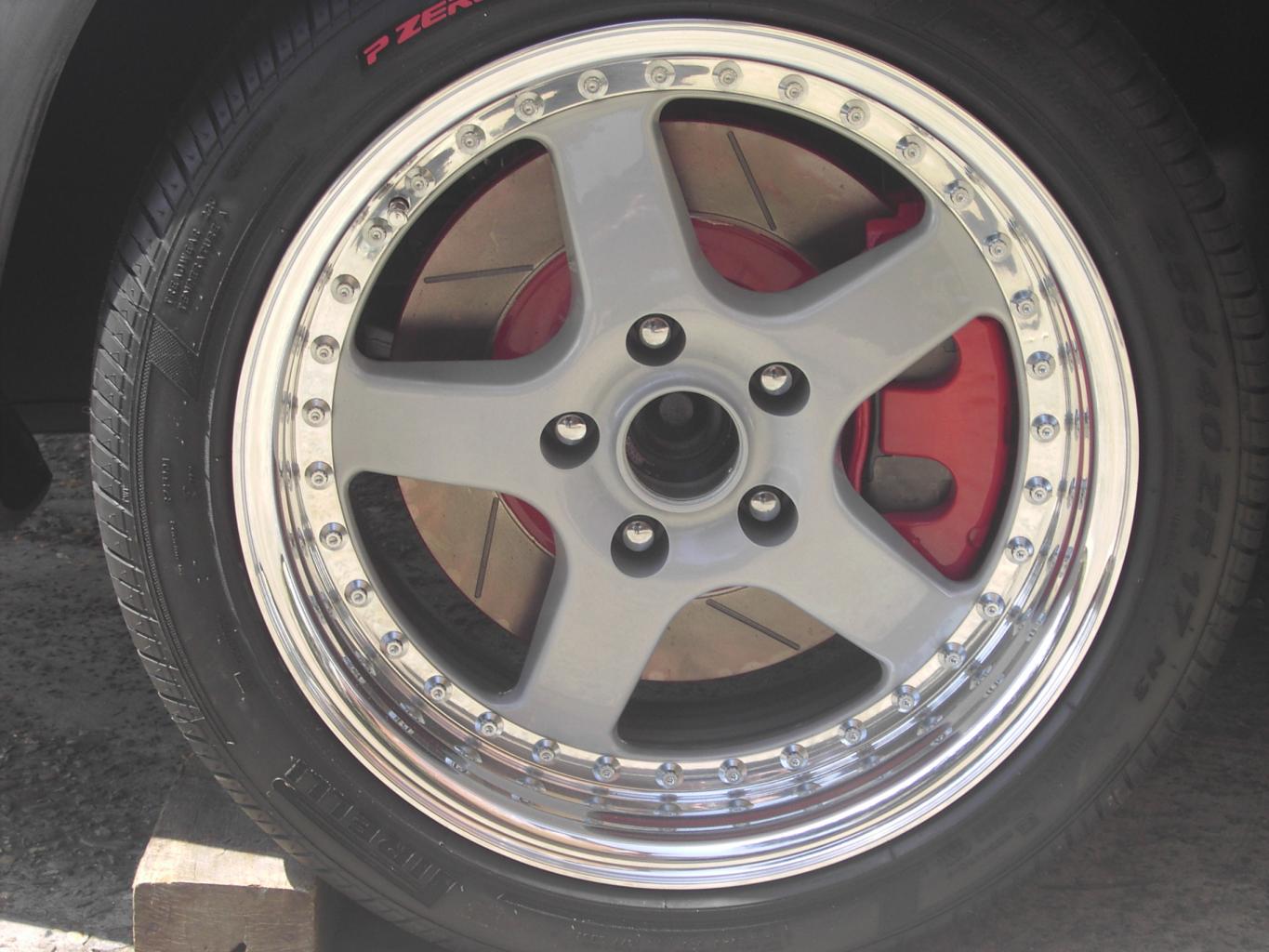

When having 109 and 68 standing side by side it almost looks like 109 is a GT due to lack of motor and transaxle which makes it look higher and bigger than 68, although they will be totally identical when finished including colour.

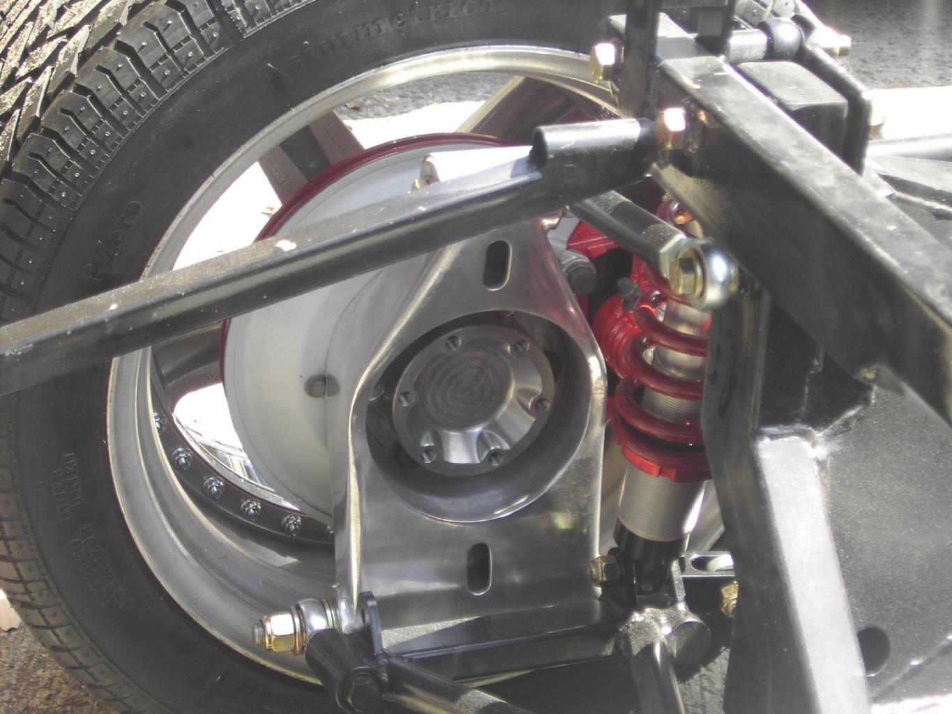

The wheels are 17 inch with Corvette C5 brakes which really fill the wheels out.
Front wheels are 9 inch and the rears are 12 inch with Pirelli rubber.
Wheels are Simmons as per 68.
The DRB alloy upright was polished and all the suspension and brakes are finished.
The axles in the rear upright were custom made to suit Commodore CV axles which are the same bolt pattern as as a G50.
Headlights are in and the steering is all finished.
Some of the wiring has begun.
Radiator, cooling pipes, shroud and fan are in.
Body work has begun.
Internal door panels are made and fitted.
Dash has been cut for all the instruments.
Dimi

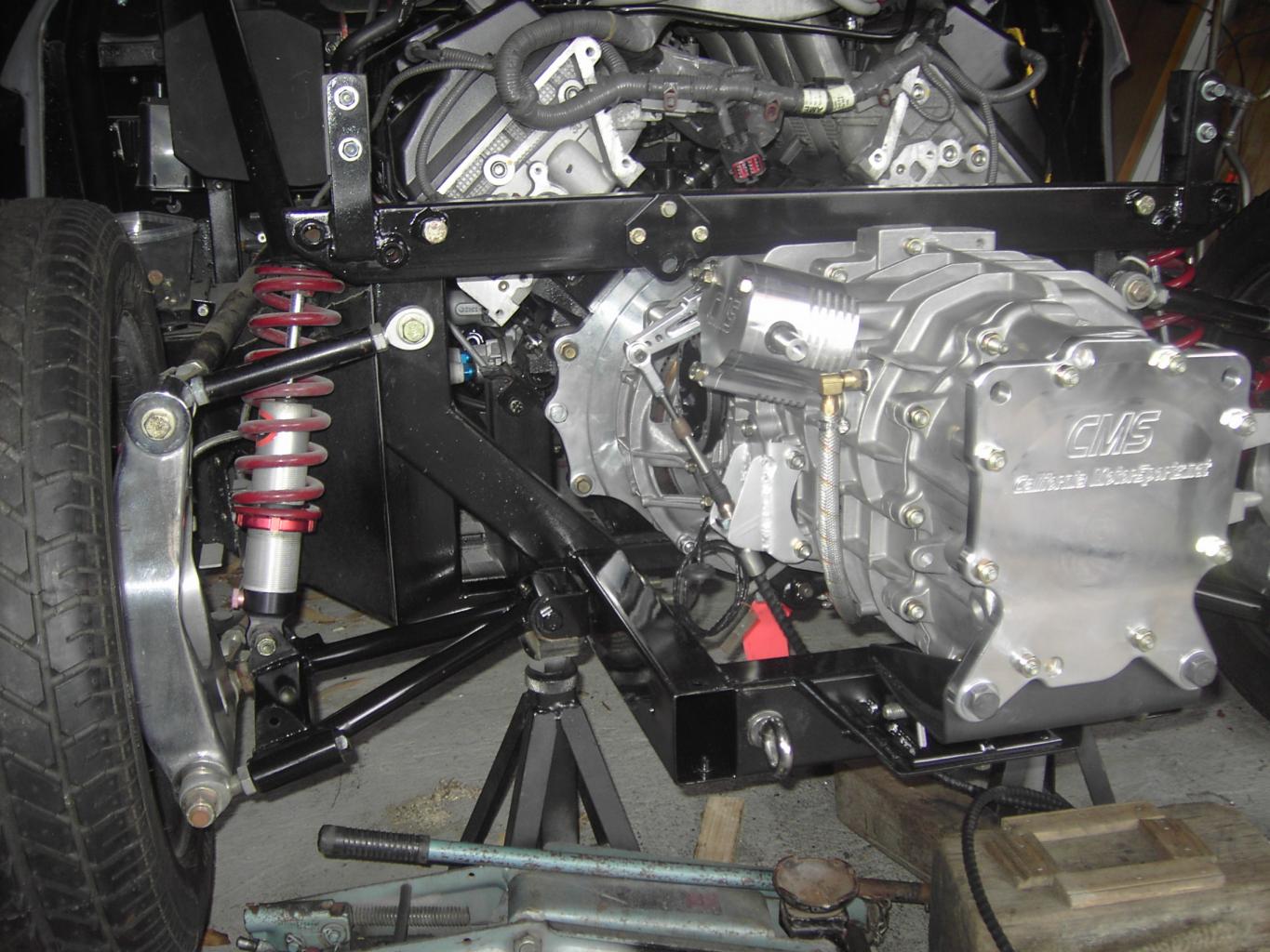

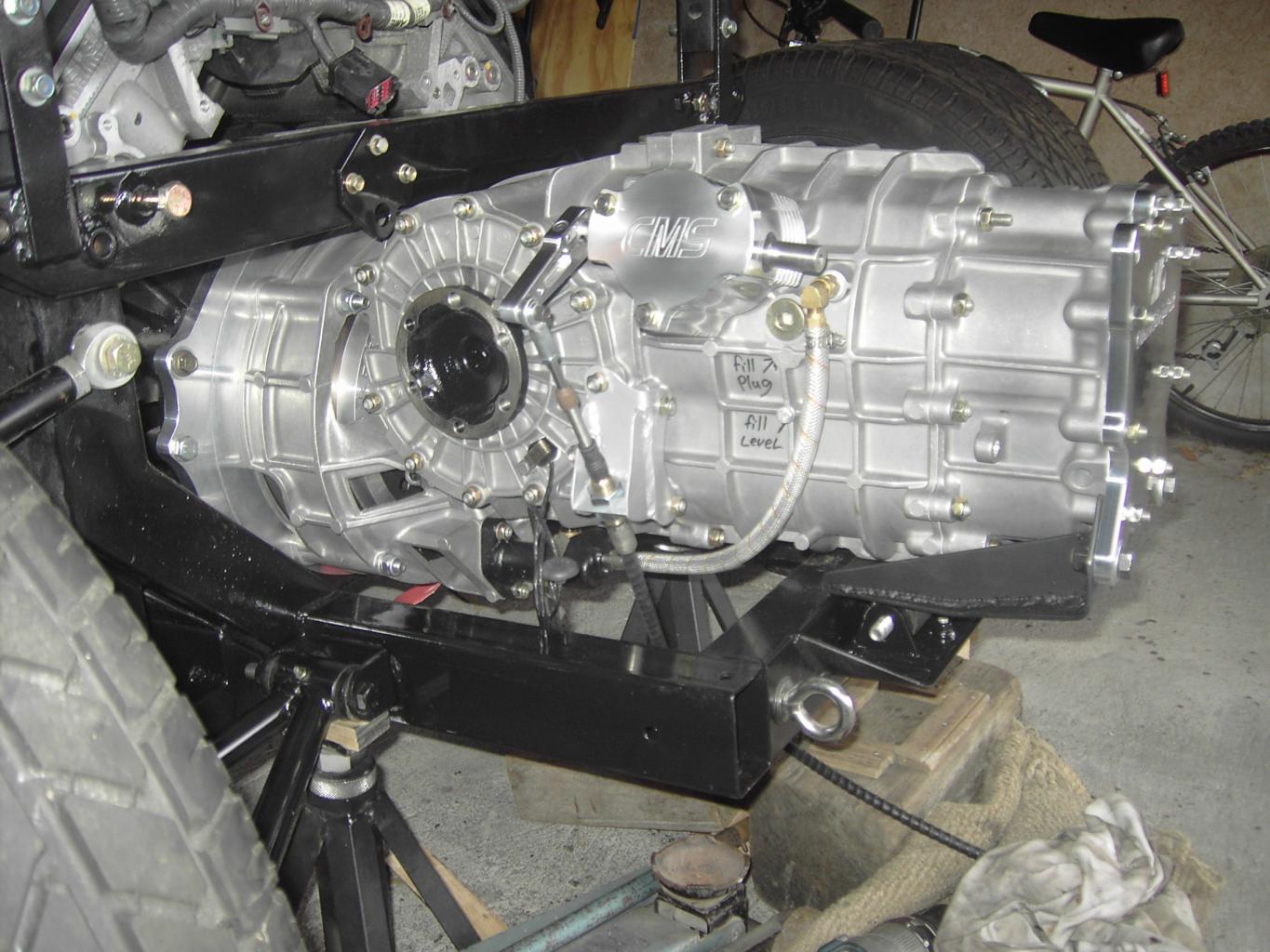

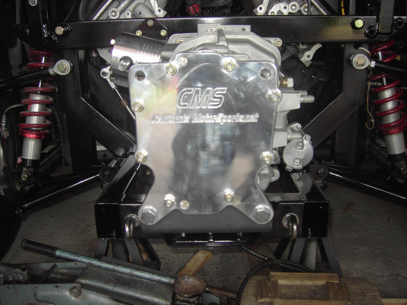

Hi all

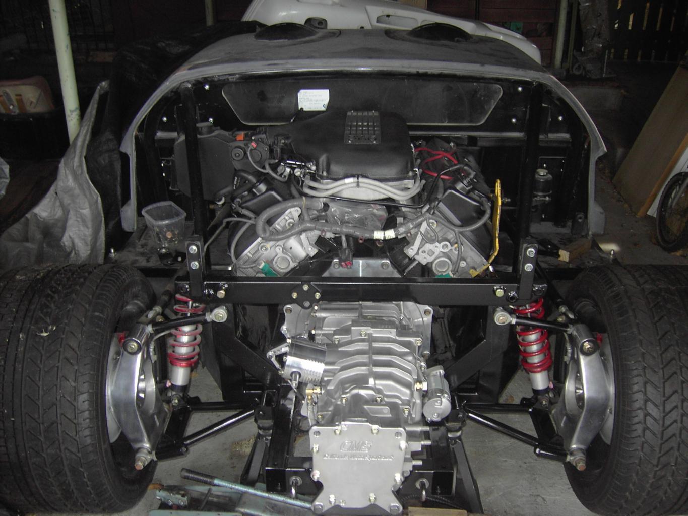

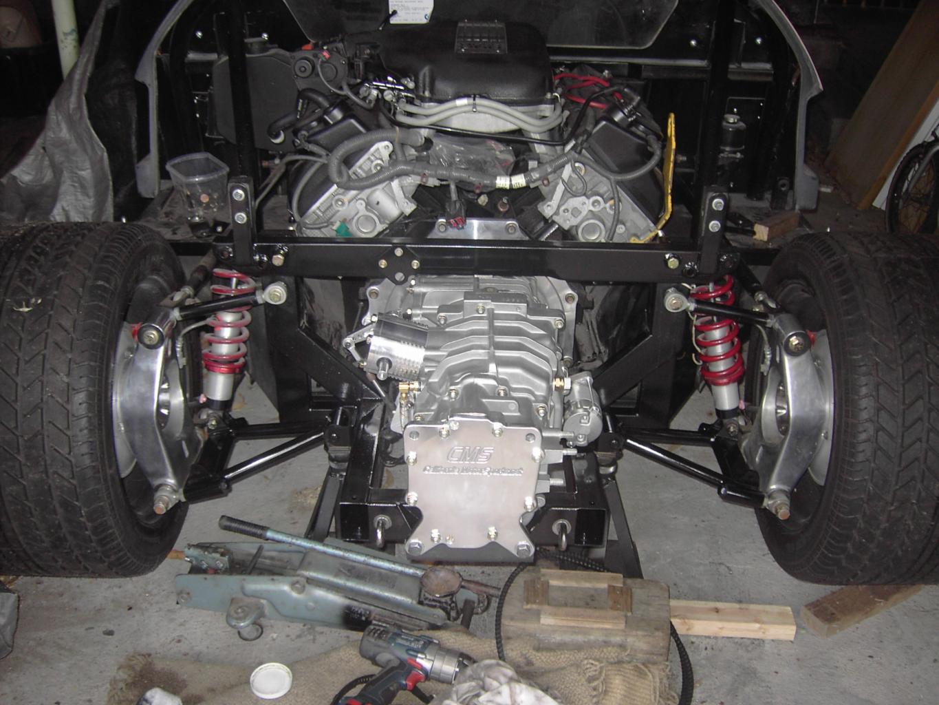

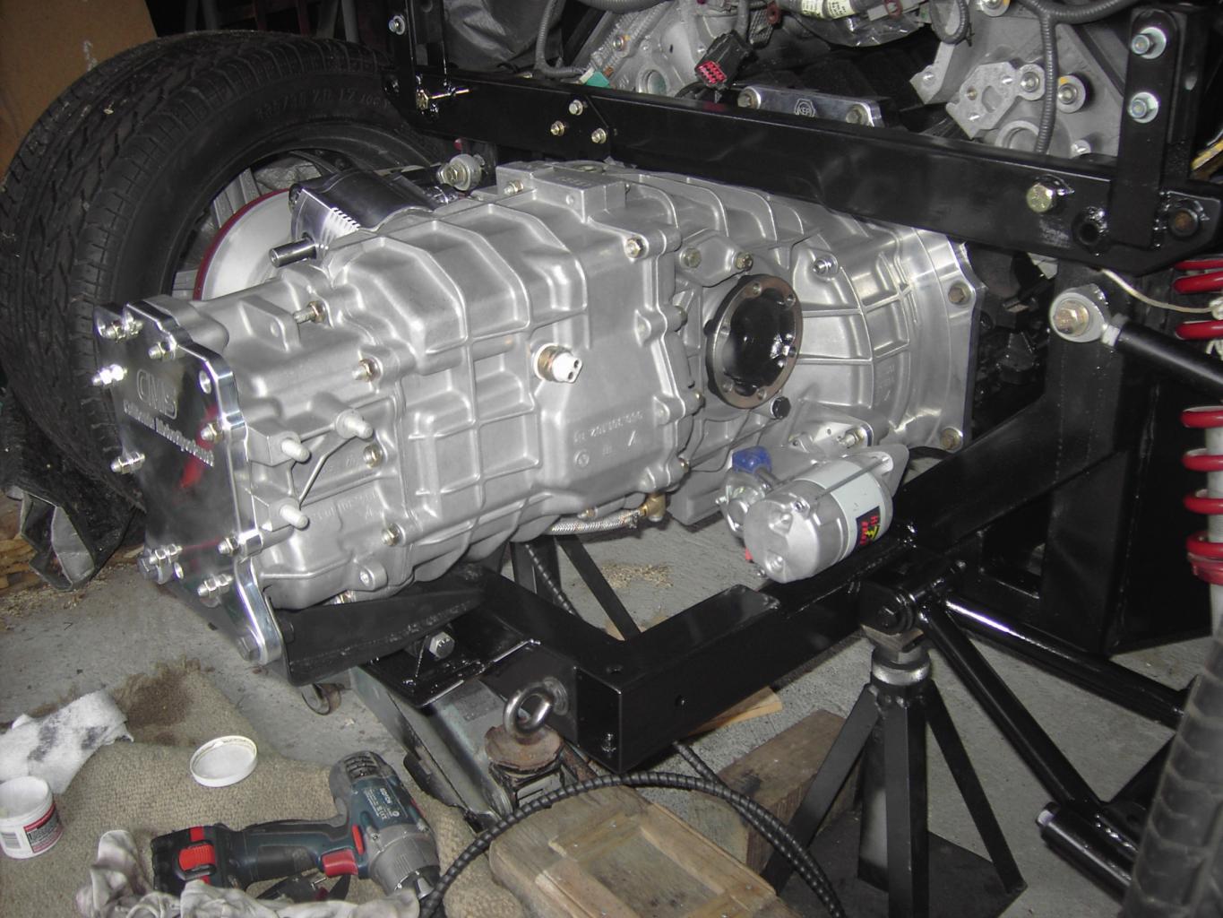

Things have been a little slow while waiting for our transaxle to be made but as the enclosed pic's show things are finally moving.
I had California Motor Sports prepare the transaxle by converting for inverted running, total recondition, shortening the G50 rear housing, adding a cable side shift, taller 4th and 5th, installing LSD, adding KEP adapter plate, clutch, flywheel, and gear reduction starter motor.
All of this arrived last week and now allows me to continue with the build as I have been under pressure from the other half as she wants her 40 finished.
She has even been sitting in her's and making brooom brooom noises,
and can't wait till she can fire up the motor.
I knew I shouldn't have let her drive mine the first time.
Dimi
