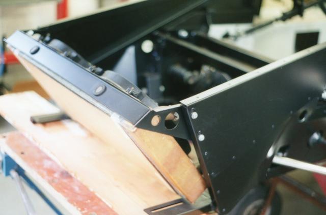

This is the only picture I could find that shows how my radiator is mounted as it now has ducting around it. The radiator has posts welded to the top and bottom which fit into the Ford Fiesta radiator mounting grommets. The picture shows the original copper radiator but I now have a Docking fitted. There has been a slight weep in one place, more an antifreeze stain.
Brian.

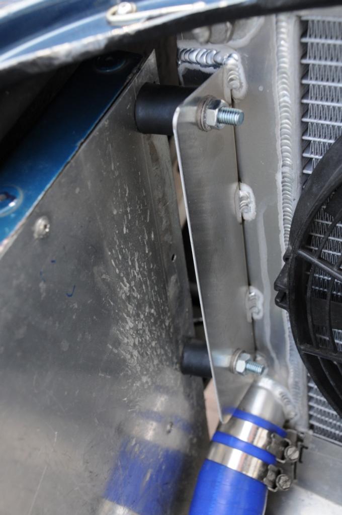

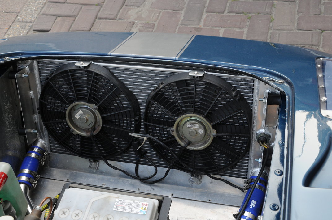

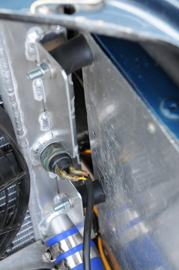

Being concerned by this forum thread back in January, I had a look at mine and apparently it was also a Docking and ......... unfortunately leaking coolant.
The sticker on the radiator told me it was made in april 2010, not even a year old.
I contacted Mel Johnson of Docking in Silverstone and explained my problem. I e-mailed him pics of the mounting which was directly to the chassis. He told me the mounting was totally inappropriate, but as shown in the pics it was designed to be fitted like it was.
Mel offered me to fix it, so I send it to Silverstone.
I did some research and thinking how to get a better mounting, in rubbers this time. For this I needed a 3 cm clearance for the rubbers. I asked Mel to make the adjustments.
Finally he returned me a complete new radiator with the mounting adjustments as I required. The radiator and rubbers fitted right in.
I must say, great service; new radiator with custom adjustments as I requested.

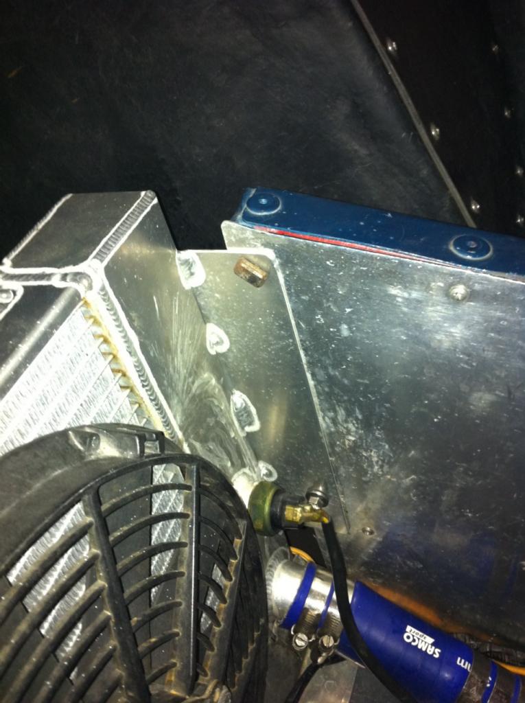

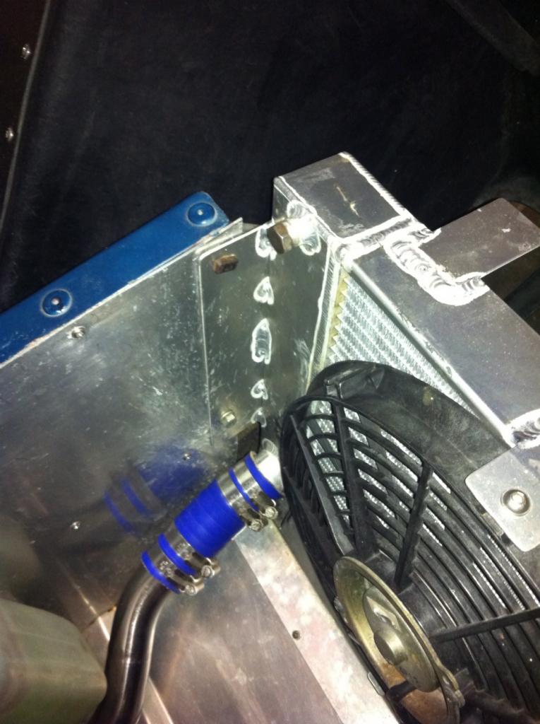

Just found that my set up, completely hanging the radiator in rubber bushes, did not hold.
After quite some investigation for my slowly lowering coolant levels, I finally found out that the radiator is wheeping from both sides. :-(
Any tips or advice here will be welcome!
Mike Pass
Hi Doc,
The best thing to do I think would be to take some clear pics of your radiator install and contact Docking to see what they say about the issues you are having with your radiator in relation to your install.
Maybe put the pics on here so people have see how it is installed on your car.
Malcolm
