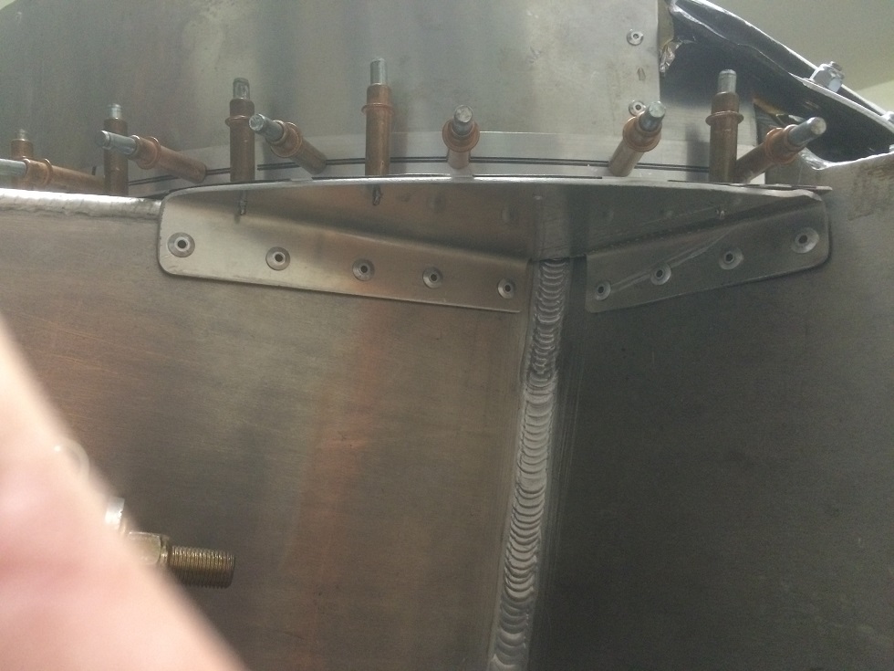

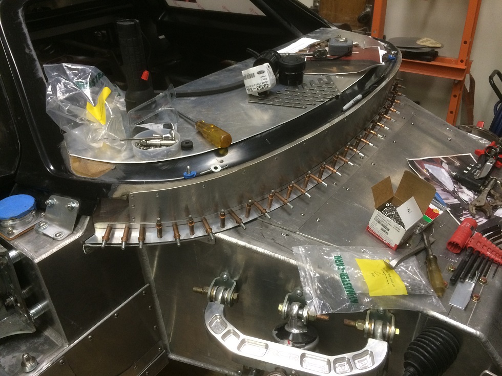

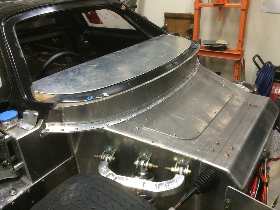

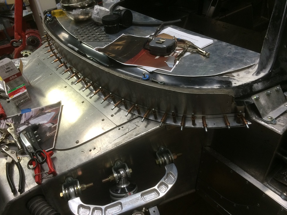

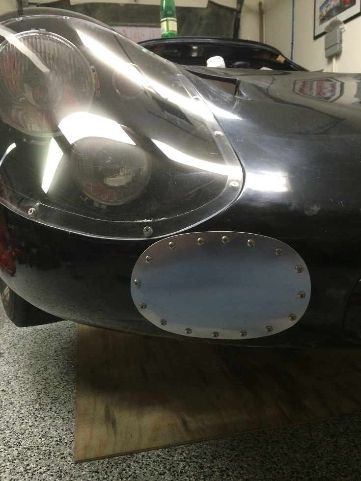

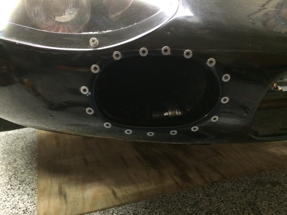

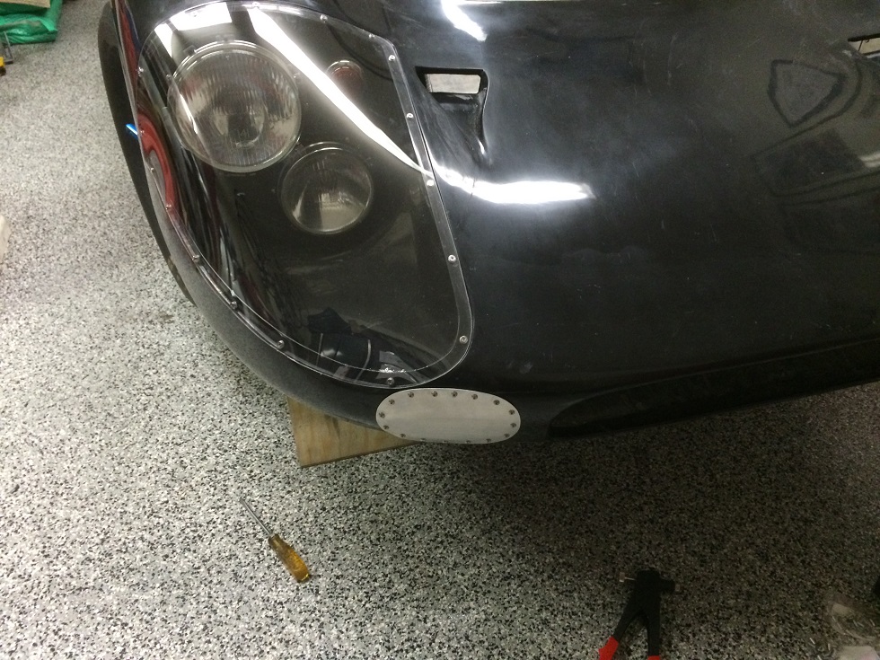

Over the holiday I got some time to work on the Mk IV. I installed the front air intake covers, see attached pictures and made the front spider hold down. The aluminum angle had to be bent to the shape of the front spider nose which was a task. I learned all about a stretcher and how hard it is to make this piece without pulling the aluminum apart by going too fast. Slow process and it only took me four pieces of angle before I got one that would work. Because the the spider is not supported on the corners by the chassis I made some simple aluminum supports, see pictures.

Nice job with the stretcher Don.. I can confirm that they can be a bugger to master... Not sure that anyone really does master them though....

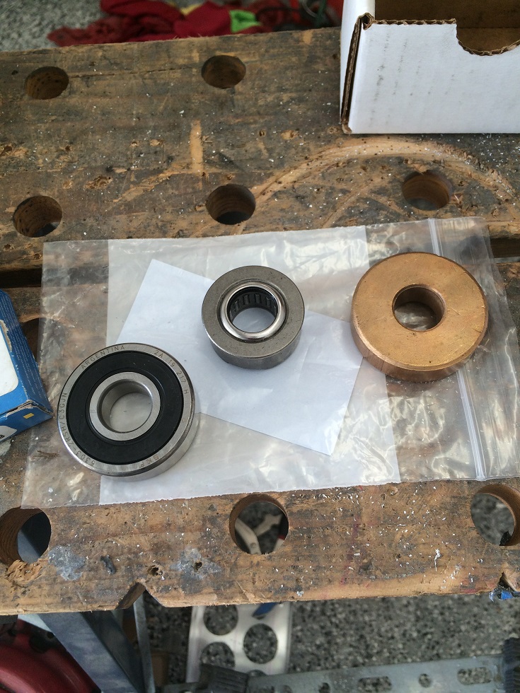

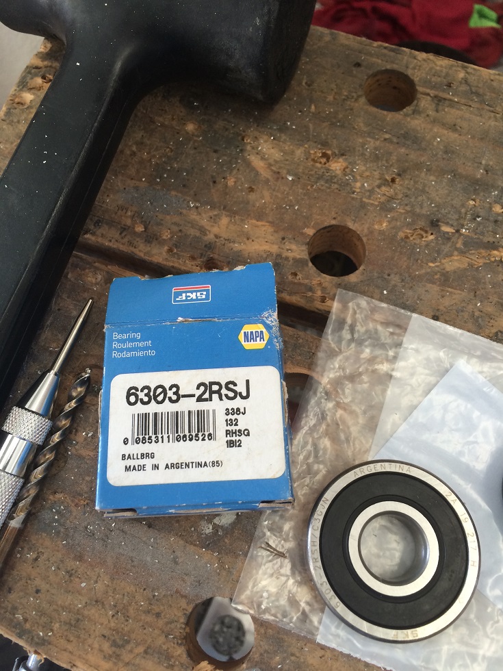

After doing some research on the best pilot bearing for the Ford FE I came up with the following.
It really comes down to three options, a solid brass like bushing, nettle bearing or a sealed roller bearing. The bushing is simple but not sealed from the clutch dust and I found a number of bad stories that they don't last long. Granted most of the bad stories were from drag racers but they had some good points why not to use it. The nettle bearing is the same one most small block Ford guys use but its outside diameter is smaller than the FE requires so this option would require me to make an adapter sleeve to fit the crank shaft and bearing. It also is not sealed from the clutch dust. The last option I found was a sealed roller bearing like used in the front of alternators. My thought was although the bearing is not doing anything when the transmission is in gear and the clutch out, it is working hard setting at a stop sign while in gear and between gears.
I decided to use the sealed bearing and have included pictures of the options and the part number of the bearing I used. I'm writing all this in the hope this may help someone like me in the future and just to document what I did so I can come back to this if I ever need to replace the bearing.

Hi Don,
Bronze input shaft / pilot bushings have been around since the stone ages and are still in service on many cars and trucks. I can count on two fingers, the number that I have seen gone totally bad. One went terribly wrong and seized to the input shaft and was an absolute bugger to get apart. That said, it had never been lubricated with heavy axle grease as it should have been to begin with.
Centrifugal force being what it is, I have found very little clutch dust in the pilot bearing areas - even on cars and trucks with 100k miles or more on them.
One area that I think gets very little attention is in the indexing of the bellhousing on the engine blocks.
IE, is the transmission input shaft sharing a perfect centerline with the crankshaft?
A bushing will be far more tolerant of a misalignment than will be a bearing in my opinion..
D. Nye
Randy, I agree with you on the importance of indexing the bell housing. Something normally not worried about when working with original parts however there is not many original parts on these special cars. I will be checking the the alignment before placing it in the car.

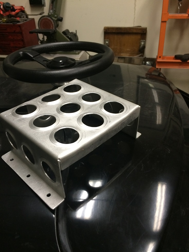

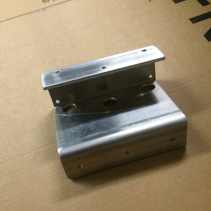

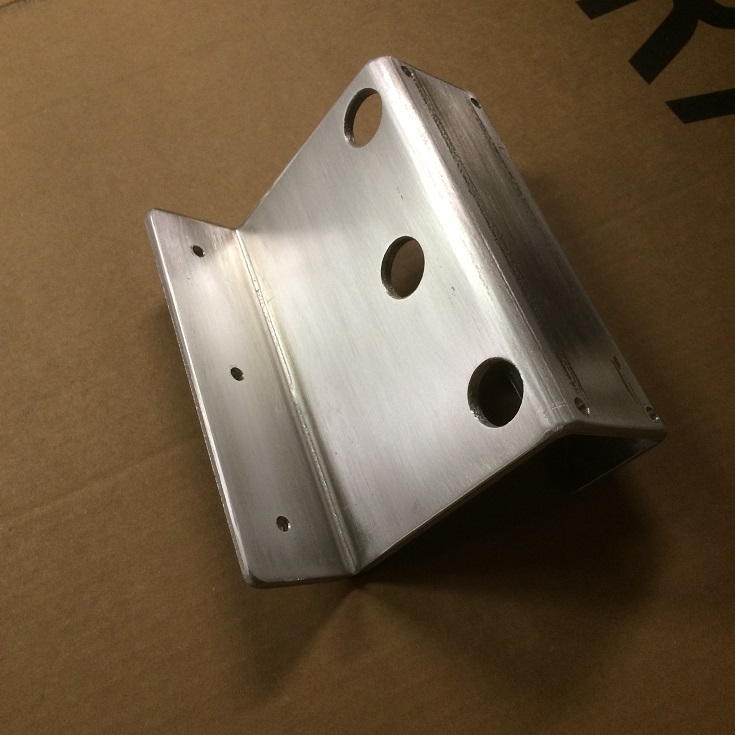

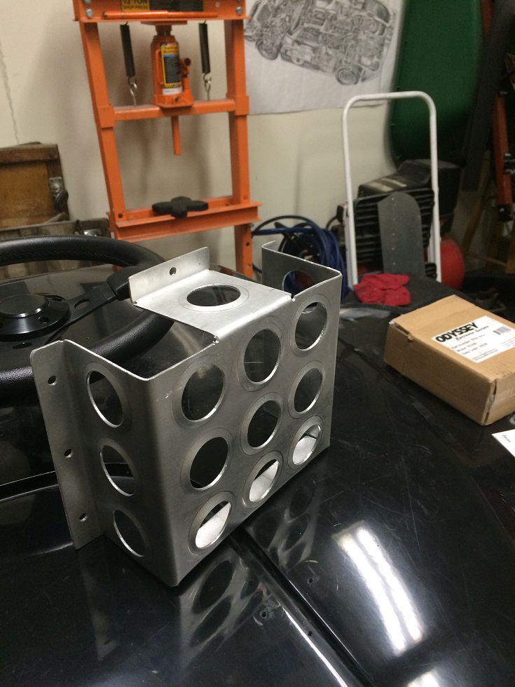

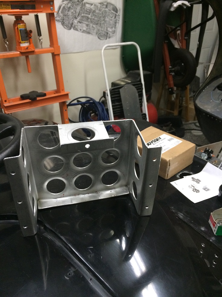

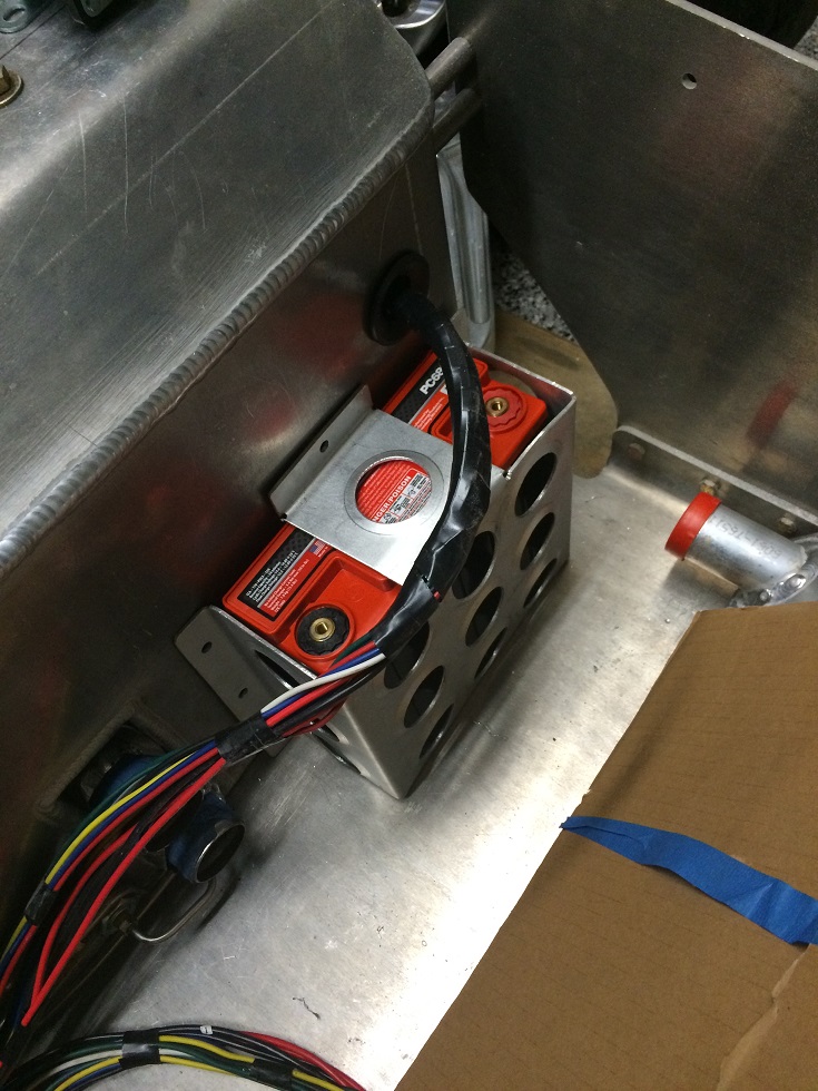

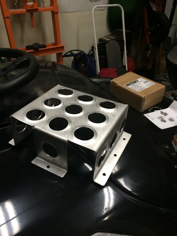

Got my racing battery and decided to make a battery box to save $100. Turned out to be something special and follows the theme of lots of holes. Made out of 1/8” aluminum for strength and fits like a glove to hold it in place. Battery weight is 15 LBs so I want to mount it up front behind the radiator and air deflector. I ordered all the radiator hoses and looking at brake cooling ductwork that all needs to fit in this small space with the battery, starter solenoid, brake and clutch fluid reservoirs, heater hoses, wiring etc. A lot going on in this part of the car.
Enjoy the pictures,

Hi Don, sorry for the late post but really nice job on fitting the headlight covers. The MKIV covers are some of my favorite pieces to make.
Love the battery box.
When I see that kind of attention to something like that - it tells me how you really feel about that car.
It's like your Valentine to the car . . .
Very nice work Don... I've not yet decided which battery to put in mine, but that looks like a nice tight and tidy package...
D. Nye
Mark, Thanks I'll make a note you make these covers in case I need a replacement.
Yes Ray I truly love the car. I wanted to make a copy of J7 when I started this project but technology has made some big steps forward so a smaller battery is the way to go.
Randy, I will let you know if this battery works well with this FE at 10 to 1 compression. Over sized starter cable should help.
Don

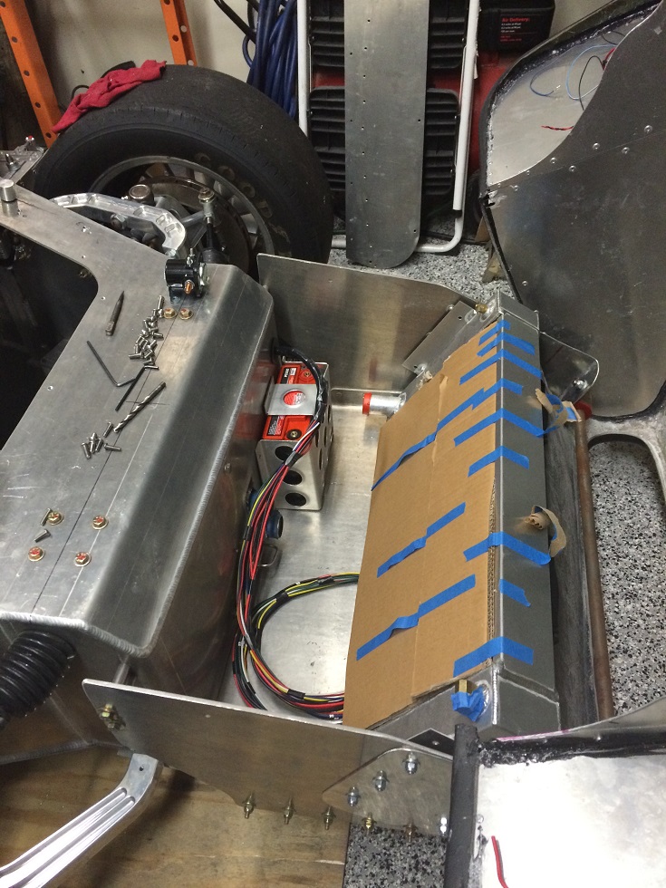

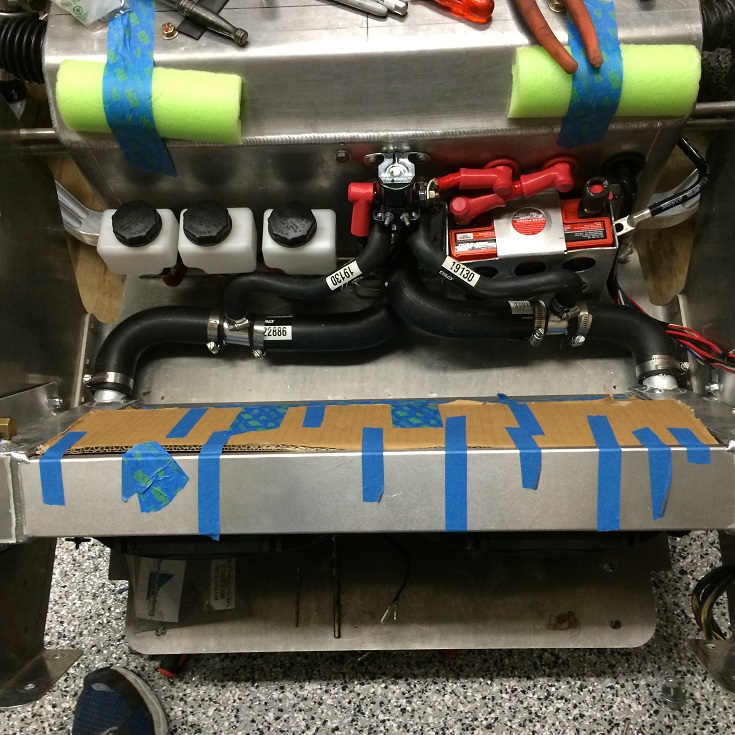

Over the last few weeks since my post I have continued to work on small details on the car. Pictures are always good and help understand what has changed.
The front area behind the radiator is almost finished with all the stuff needed in this area. It’s a tight fit under the front air scoop but I have gotten it all in there. During this process I removed the front clam shell to make it easier to work on. When reinstalling I noticed I had originally installed the front body shell to high making the front air opening not lining up with the bottom of the car. After reinstalling and adjusting it was clear I’m going to have problems with speed bumps, this car is low!
What I have done is use 1/0 wire running back to the starter from the front mounted starter solenoid and 4 gauge back for the alternator, both over sized but bigger is better in Texas right? AC/heater has been installed and removed while some of the dash is being painted, final wiring and AC hoses routed. My only remaining task inside the car is to mount the seats to verify everything fits together. Other things that have been completed are, pedals and master cylinders installed, AC defroster wholes cut, battery cut-off switch installed and shifter installed. I will try and take some pictures this weekend to share.

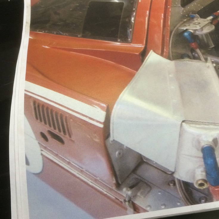

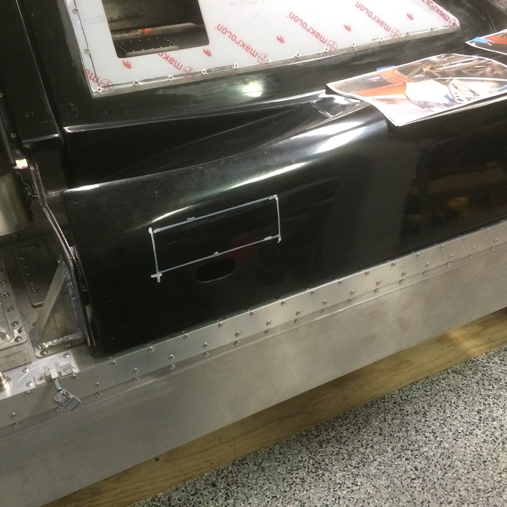

There are many body differences between the J cars prepared by Shelby and Holman Moody and my body molds must have been taken from a Shelby car. The air vents on the top of the spider is an example and because I want my car to look like J7 before the 1967 race the vents have been removed and body filler has been started. The reason I said “before the race” is there are lots of changes that were done when the car was rebuilt after the 1967 crash. I’m not putting the rebuild down, the car just had little changes made. The J7 car is a great example of the race cars built and the present car setting in Colorado is something special and that’s why I’m trying to copy it. On HM cars the air vents were on the doors so the location has been marked, see attached picture. My present problem is finding someone to make me eight two inch louvers on two 8” by 3” straight aluminum sheets. Anyone know someone that has a 2” louver die which could make me some louvers?

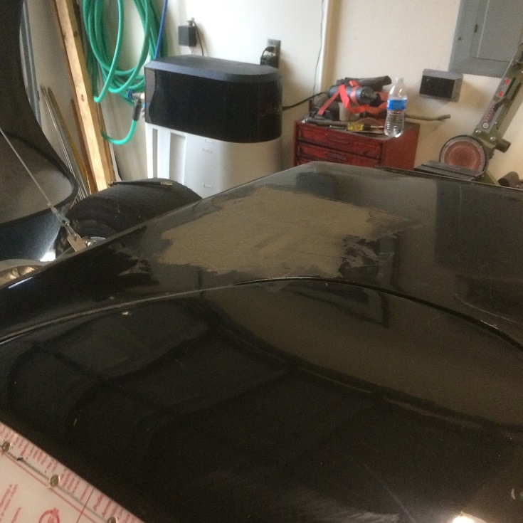

My sanding blocks arrived and I have started the body work this week. My Cobra’s body work was all done by a professional and cost big dollars, I would like to do some of this work this time around. Learning new skills.

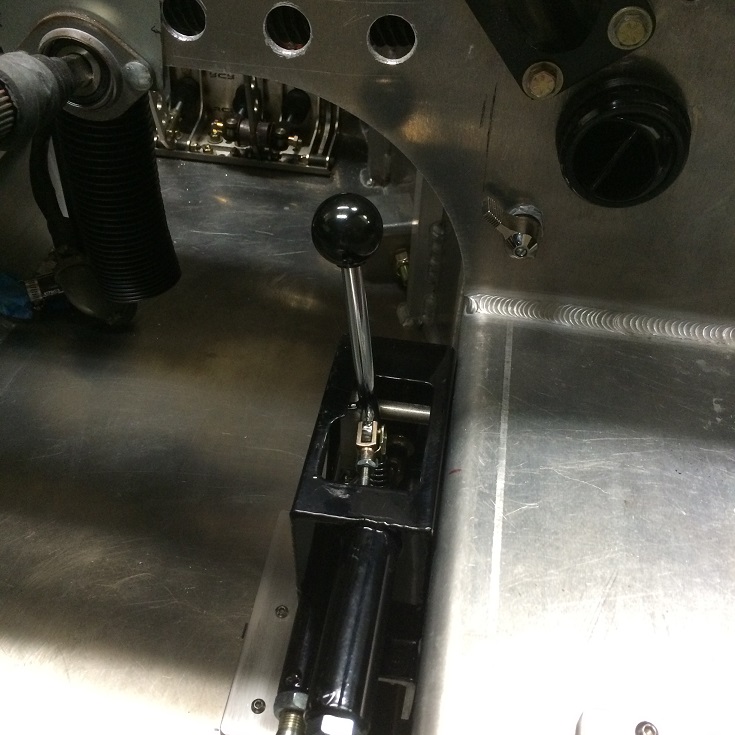

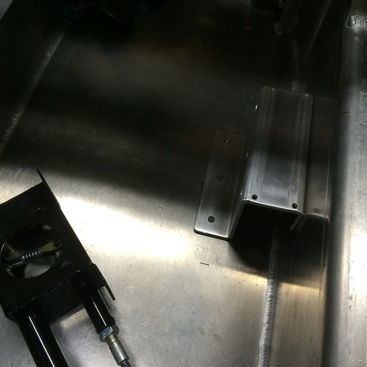

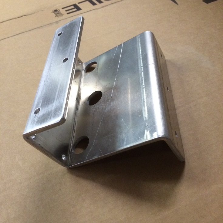

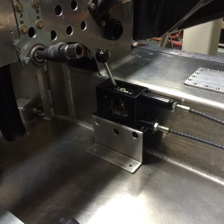

Made the shifter support, made from ¼” aluminum plate as can be seen in the pictures. Bolted through the floor and side pod making a very solid support for the shifter. Only one problem.
The seat RCR provided is 17” wide and with the shifter support installed I only have 16 ½” of space, bummer. So off to the internet to find a seat that is no more than 16 ½” wide. If your butt is wider than 15” you’re not going to fit in the driver’s seat however the passenger seat is 17” wide. By the way I measured before I ordered the seat.
The driver seat arrived and now is installed. Working on the passenger seat now.

That reminded me of a funny situation I had to deal with on my previous project. My wife required a 2" wider seat (passenger side) than I needed, so I purchased that width just for her. It was a poor decision on my part to share that information with her :lipsrsealed: . It was well enough that she didn't know they were different widths. :furious:
