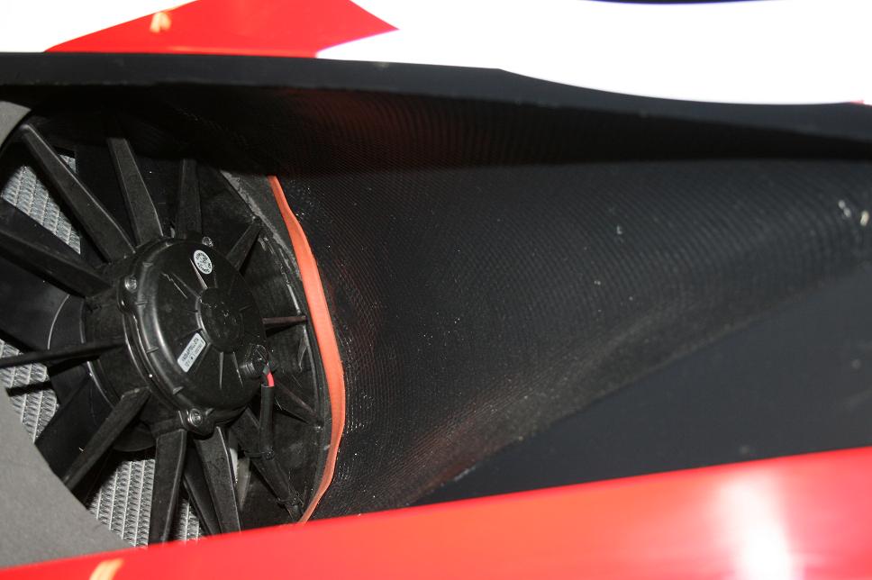

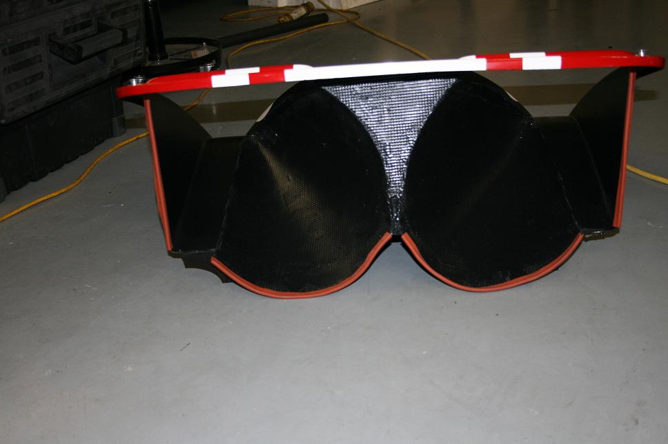

By way of comparison, here's the business end of an original GT40 Mk 1 road car nose piece.
The cutout is for the oil cooler. Note that great consideration was given to airflow, unlike the standard piece from Superformance (and several other replicas) which gets the external visuals right, but is grossly lacking in science underneath. Jack's solution is a great attempt at defeating that engineering stupidity, but I think that managing airflow at speed is more important than developing tunnel-shaped openings for fan efficiency.
Arguably the later-style Mk 1 nose with its single, much larger scoop is probably much more effective. But I definitely like the aesthetics of the two-nostril nose better, and for our purposes it's certainly good enough....
Dennis made some mods to mine by removing the center section. I think it came out looking great and the car runs cool. I'll snap a pic if you're interested.
Jack Houpe
My reason was to get the hot air of the foot well and it does a good job at that. It was done to spare expense of purchasing a better piece as Mike Drew has posted and have it repainted. Someday.....
This is the main motivation, although I have to believe that venting out the top rather than dealing with the turbulence under the front clam would be beneficial.

If you wish to see less hot air in the footwells, then you need to reduce under front clip air pressure. This can also be achievd by letting some air into the wheel arch area as well as playing with the nostril panels..
GTRene/Jack,
SPF is not the only one.............. the majority of them do not make a full dropped twin nostril panel. I have two that are half-depth, and one that I got fom Jay Cushman that is full depth. It is actually oversize so that you can trim it properly for your radiator/fan combination. It looks almost identical to the pic posted by Mike Drew.
If you look closely at the replicas you will see that the sides of the nostril panel on the top are thicker/wider than the originals. This puts the ducts more inboard. Personally I like the look of the original style panels more. The deep twin nostril panel is also a two-piece part glassed together, and costs more because of it. It would make a lot of sense to make them oversize depth and length-wise for ease of custom fitment, but if they are only concerned about parts for their own cars why bother........
The single nostril panels are different as well. Only a few companies produce the panel with a straight lip across the top seen on the original cars (MK1). Regards, Scott
