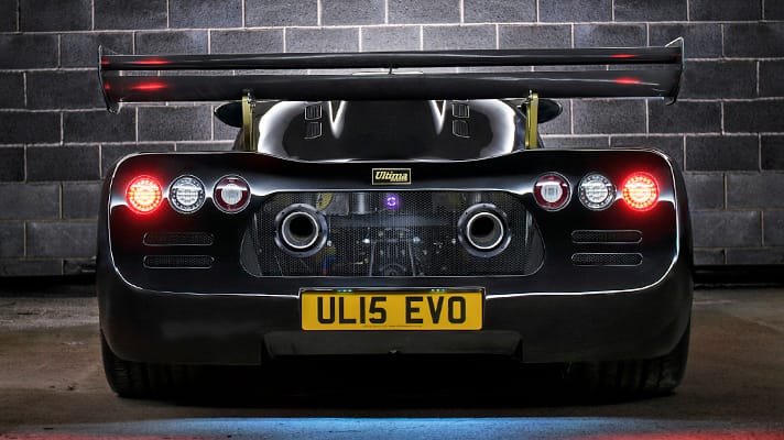

The UK based Ultima GTR has 720 hp and uses a Porsche G50. However it uses wide 19" and 20" wheels. It holds some world records for 0 -100-0. It is also unofficially the fastest car round the Top Gear track
Some transmission chat here from the Ultima forum that may be of interest.

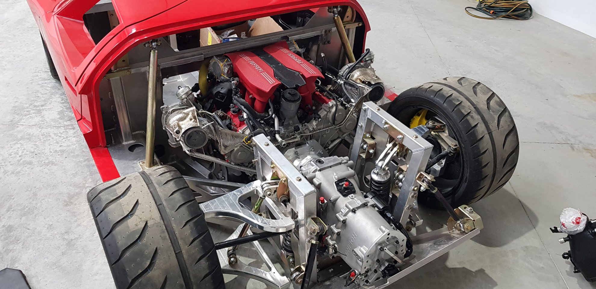

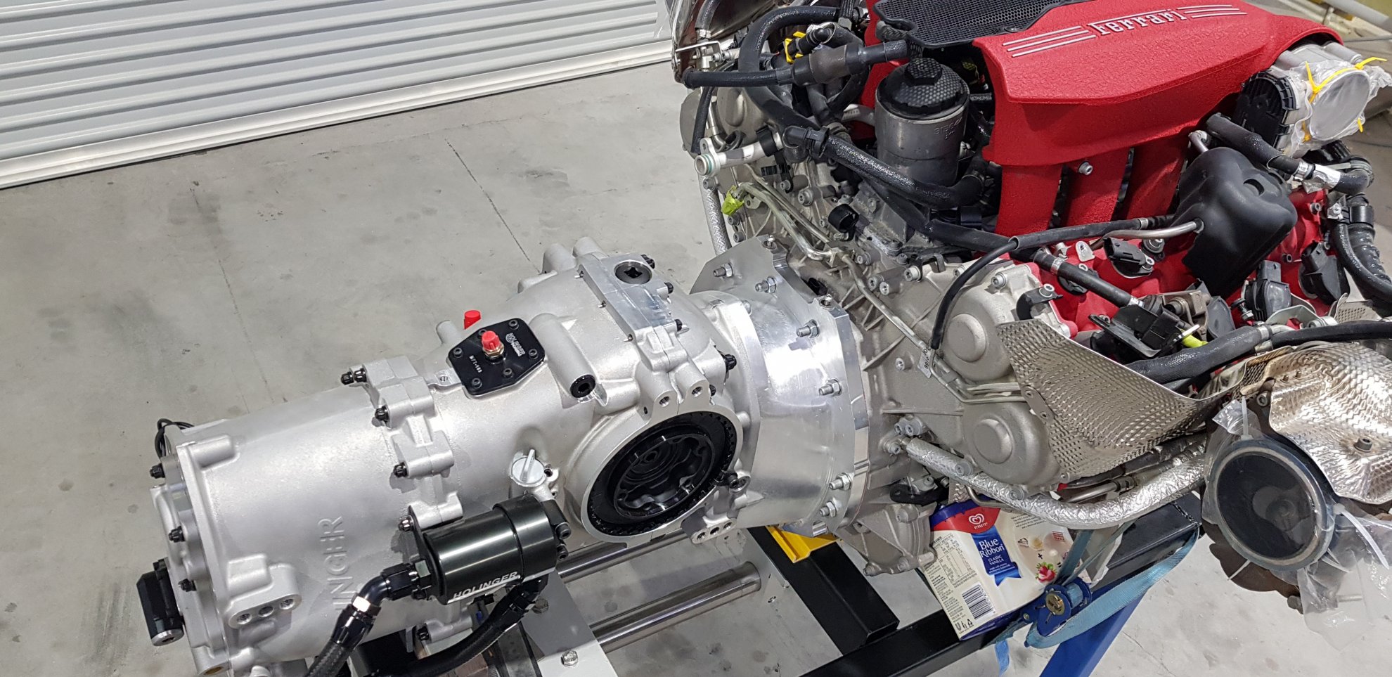

Or more is more......
