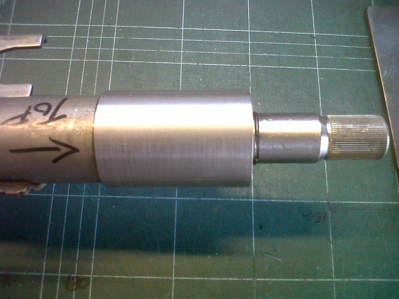

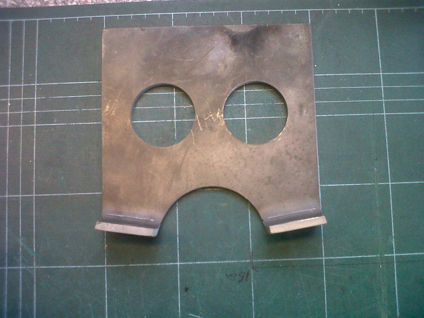

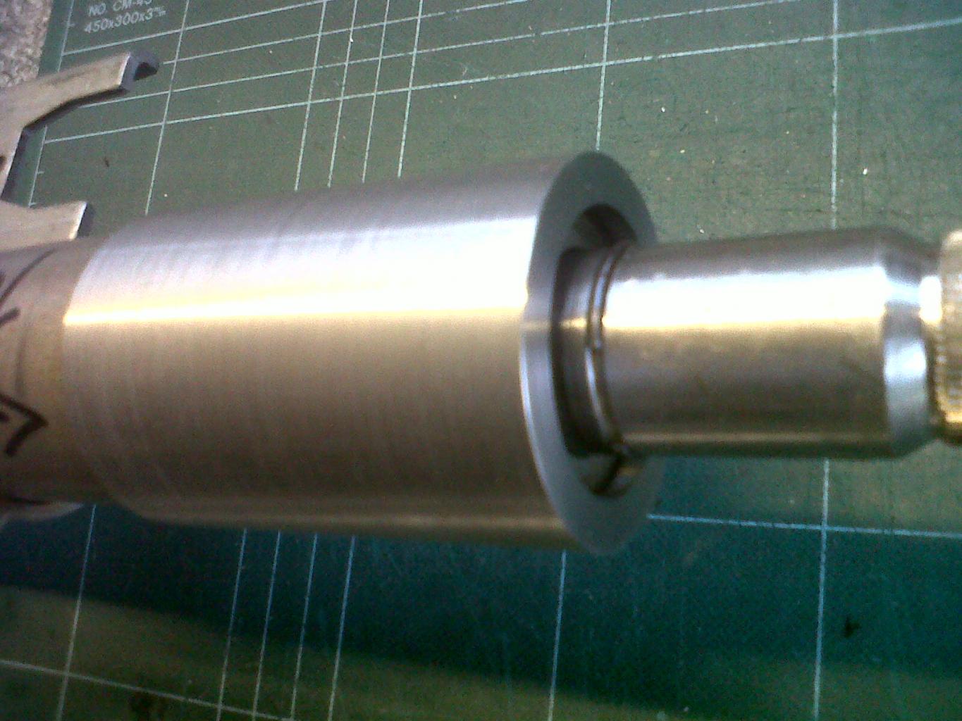

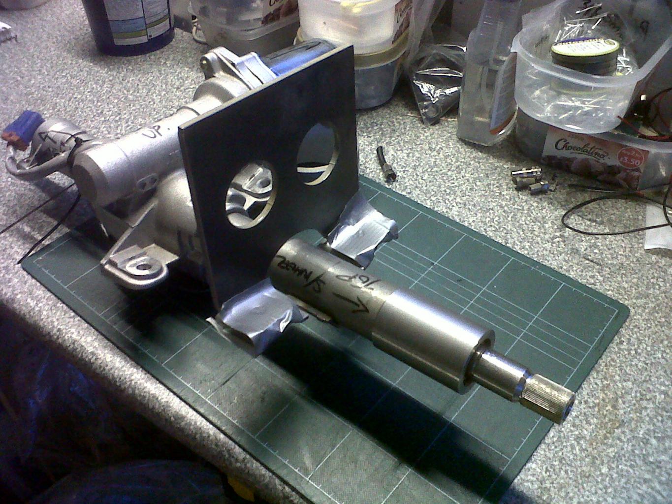

Got the corsa C steering column back from the workshop, I had got them to make a bracket which will be welded to the chassis just behind the dash, as this bracket is functional, I kept the design very simple, it is quite a beast, 5mm steel, my worry now is, can I weld it to the chassis without blowing away the box section?
I show some pix of it simply taped to the column. I also got them to turn a collar for the top column bearing. When I got the column I removed the plastic and alloy casting from the top which had the steering lock, so needed to replace it with a simpler one. I may use another collar which fits over over this to allow me to attach an indicator stalk. My priority now is to get the bracket on the car so I can design the lower brackets and set the angles etc...
