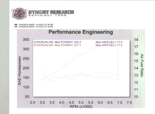

Just finished tuning my car on a chasis dyno. We maxed out at 332hp at about 7000 RPM. It tested on the engine dyno at 460 ie about a 28% loss. Interestingly we used a carb set up(demon) for the engine dyno because my builder didn't have an engine dyno harness to run the Motec computer and fuel injectors. Perhaps some of the loss is due to the fuel injection instead of the drive train. Never the less the car is a hoot to drive. I had 318 chassis tested hp in my Cobra but would frequently spin the rear tires. With the GT40 it all hooks up and goes like a bat out of hell! /ubbthreads/images/graemlins/cool.gif
An Audi 5n016. But it's not a fair comparison since we used a different carb/fuel injection set up.
