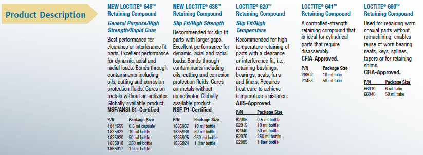

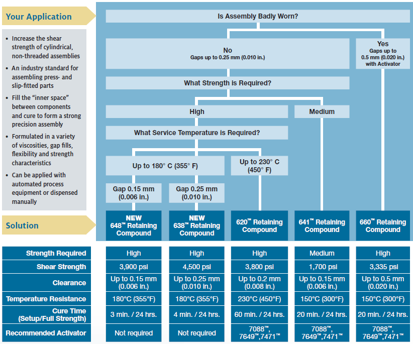

Thanks @Twosheds
I agree, I also felt a bit suspicious about this but I was told it is a common solution....but a bit hesitant. Front wheel bearings carries quite some load. I'll give it a try and see how it turns out, so ordered a 638...
