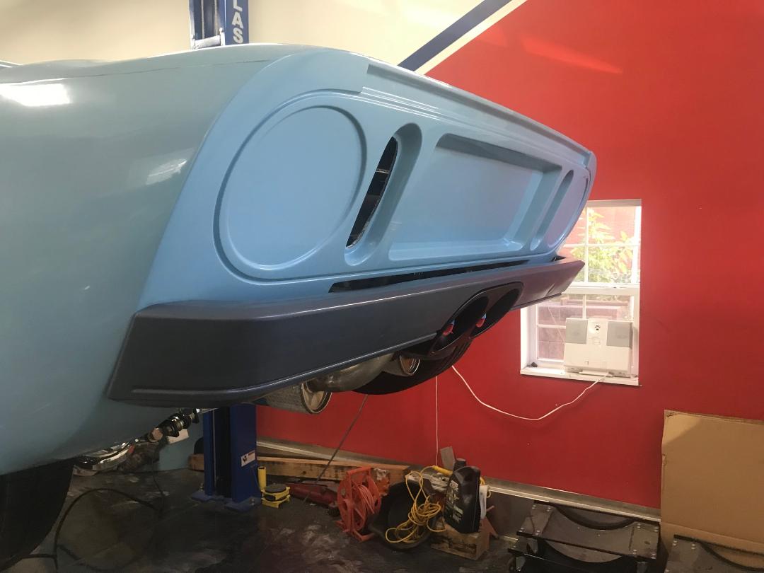

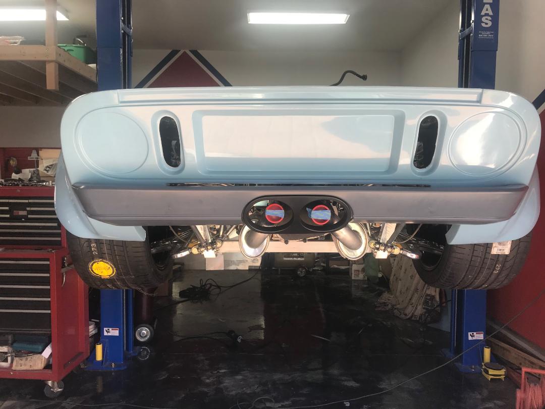

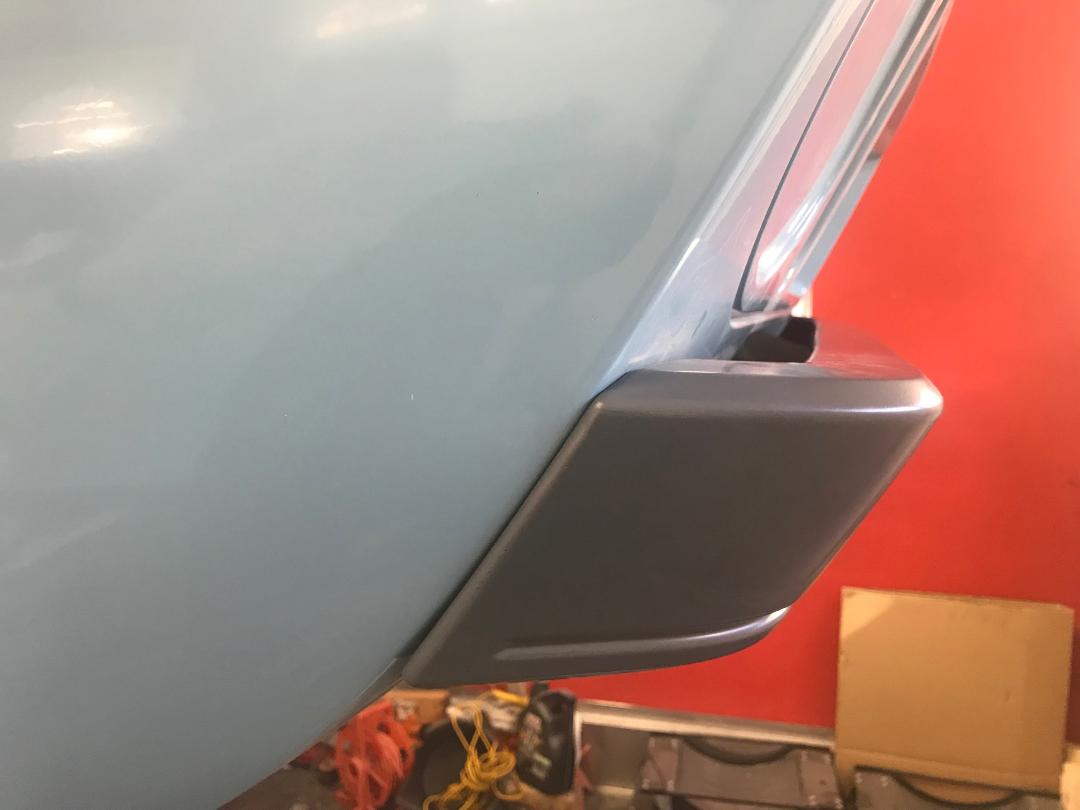

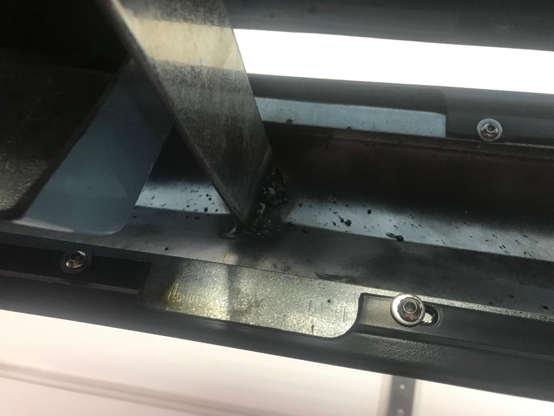

Ok the rear bumper is fitted and mounted I fabricated a galvanized support frame to mount the rear bumper so now it's on to the Heat and AC system

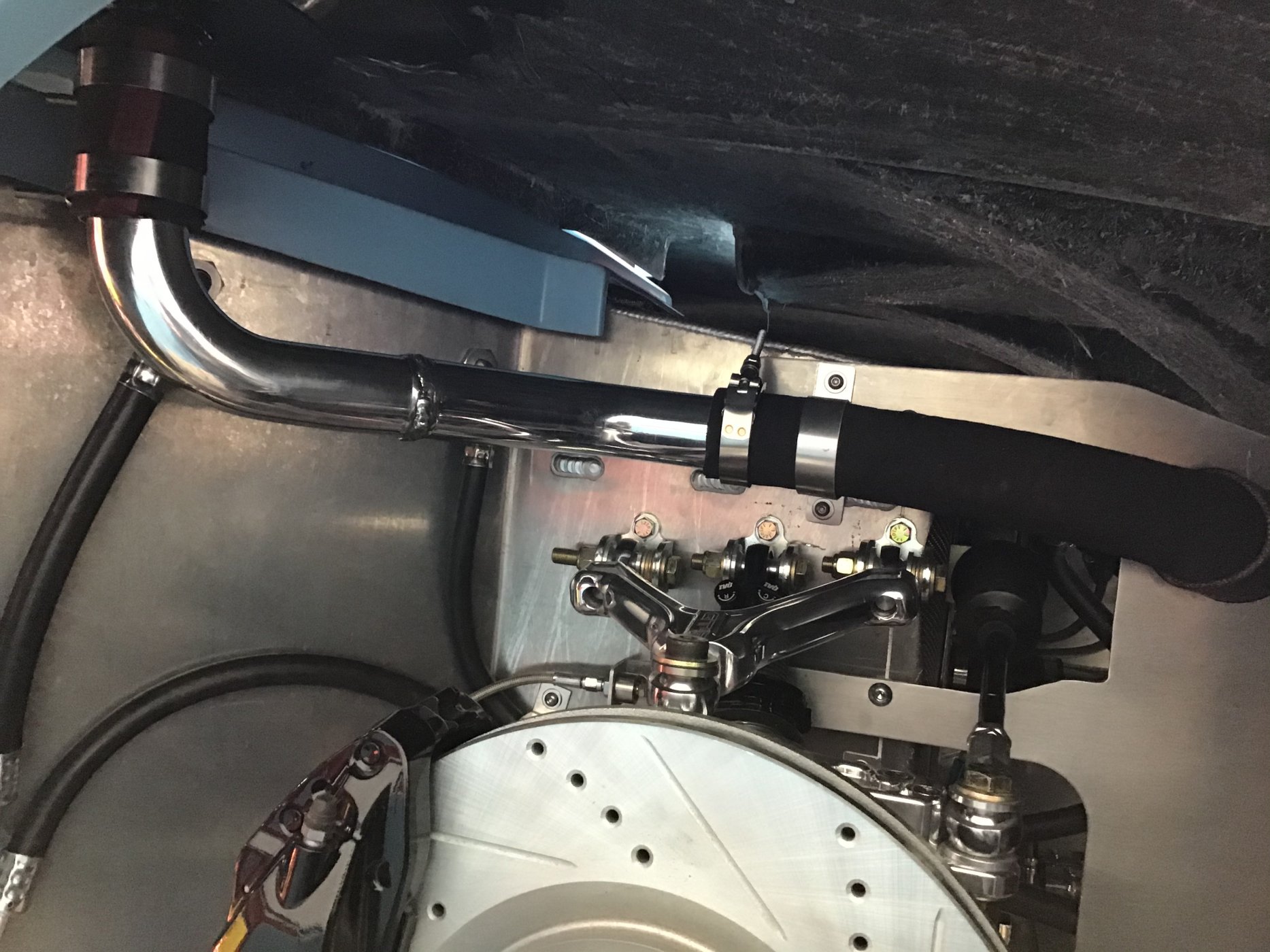

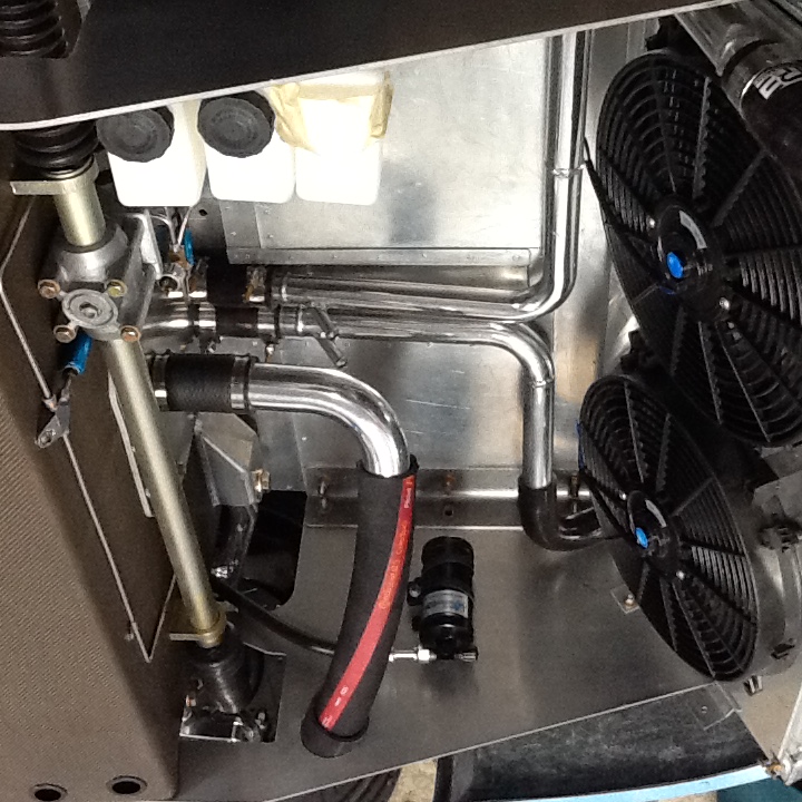

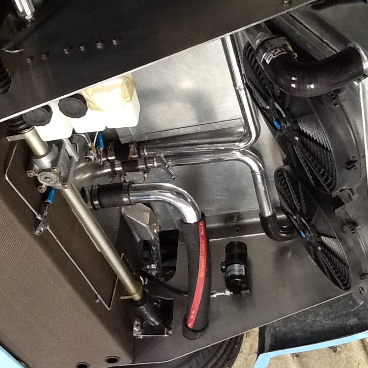

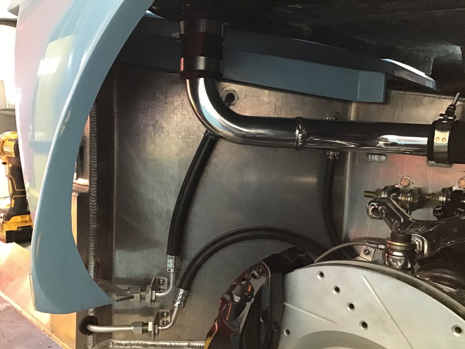

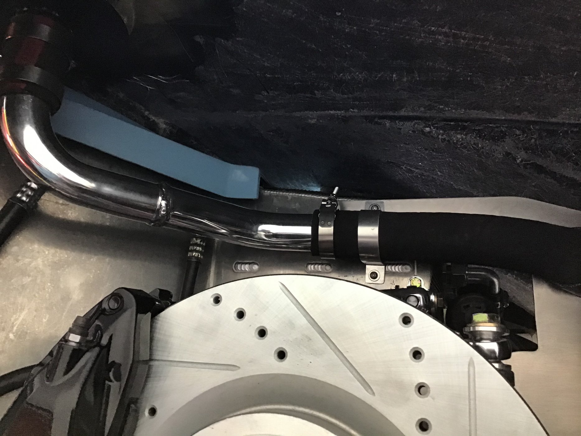

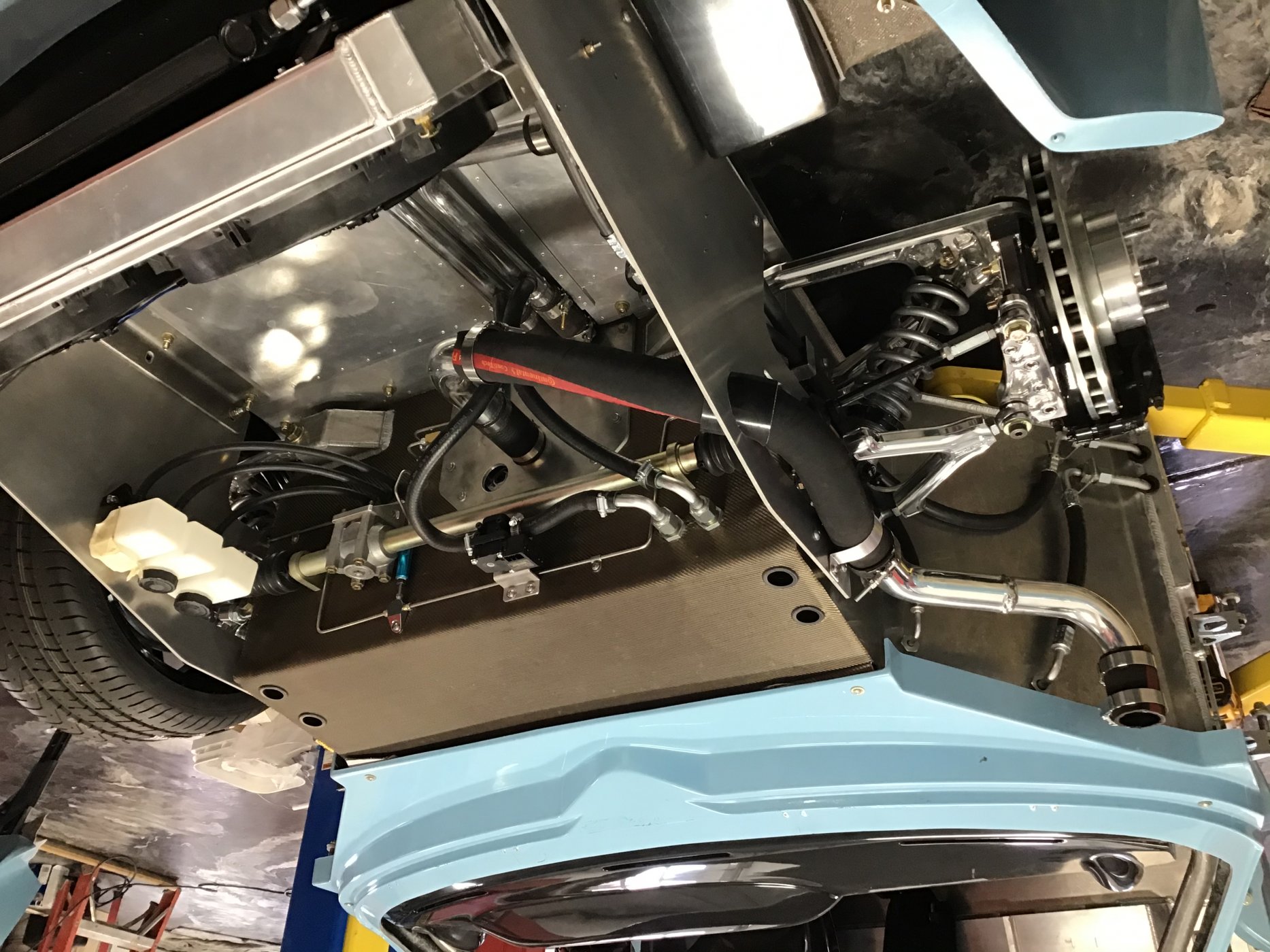

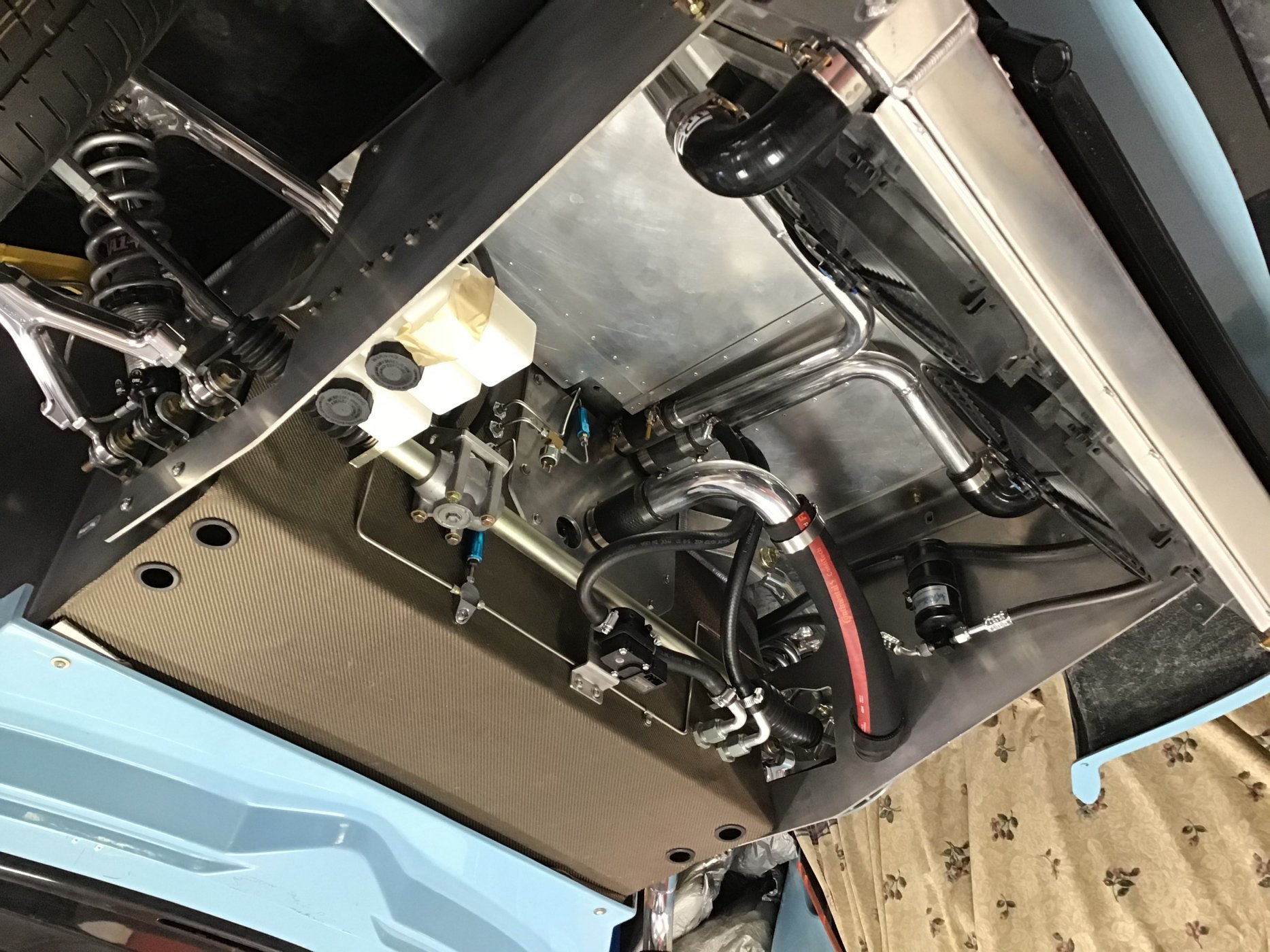

Finally got my coolant tubes welded and back in place just need to order a few more clamps I also started mounting the Ac system and running the lines starting to gain a little headway

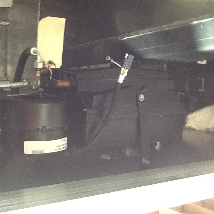

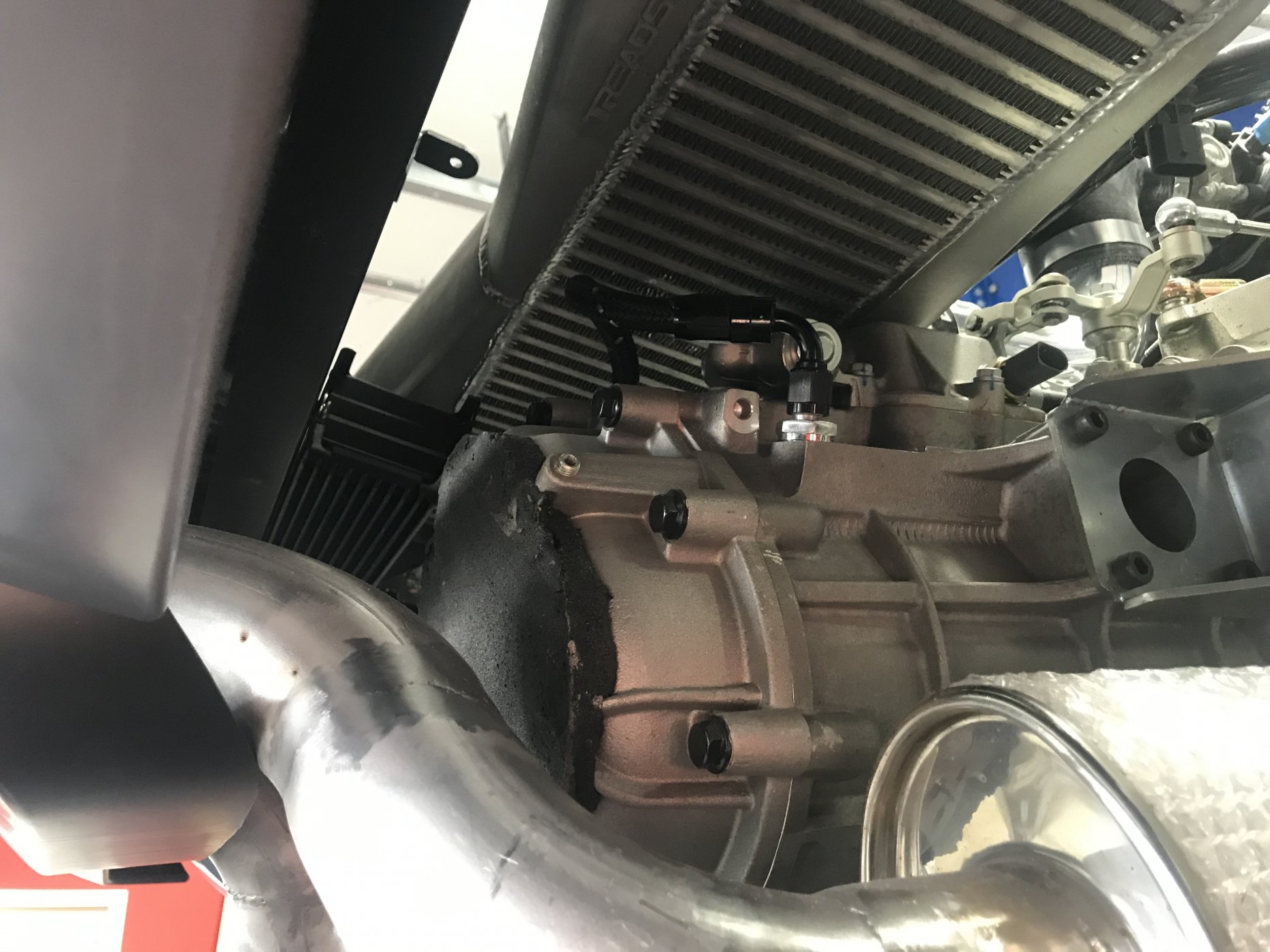

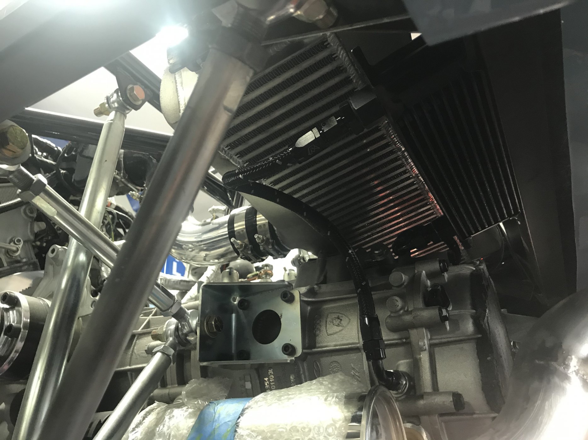

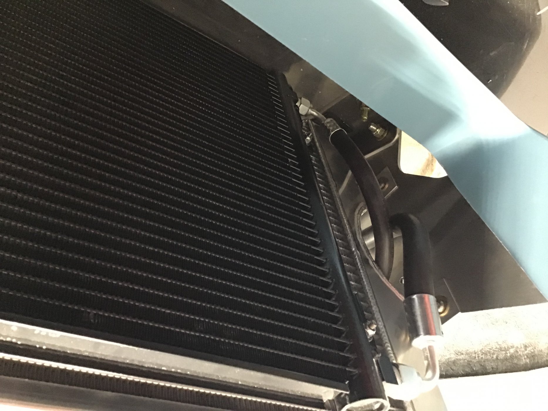

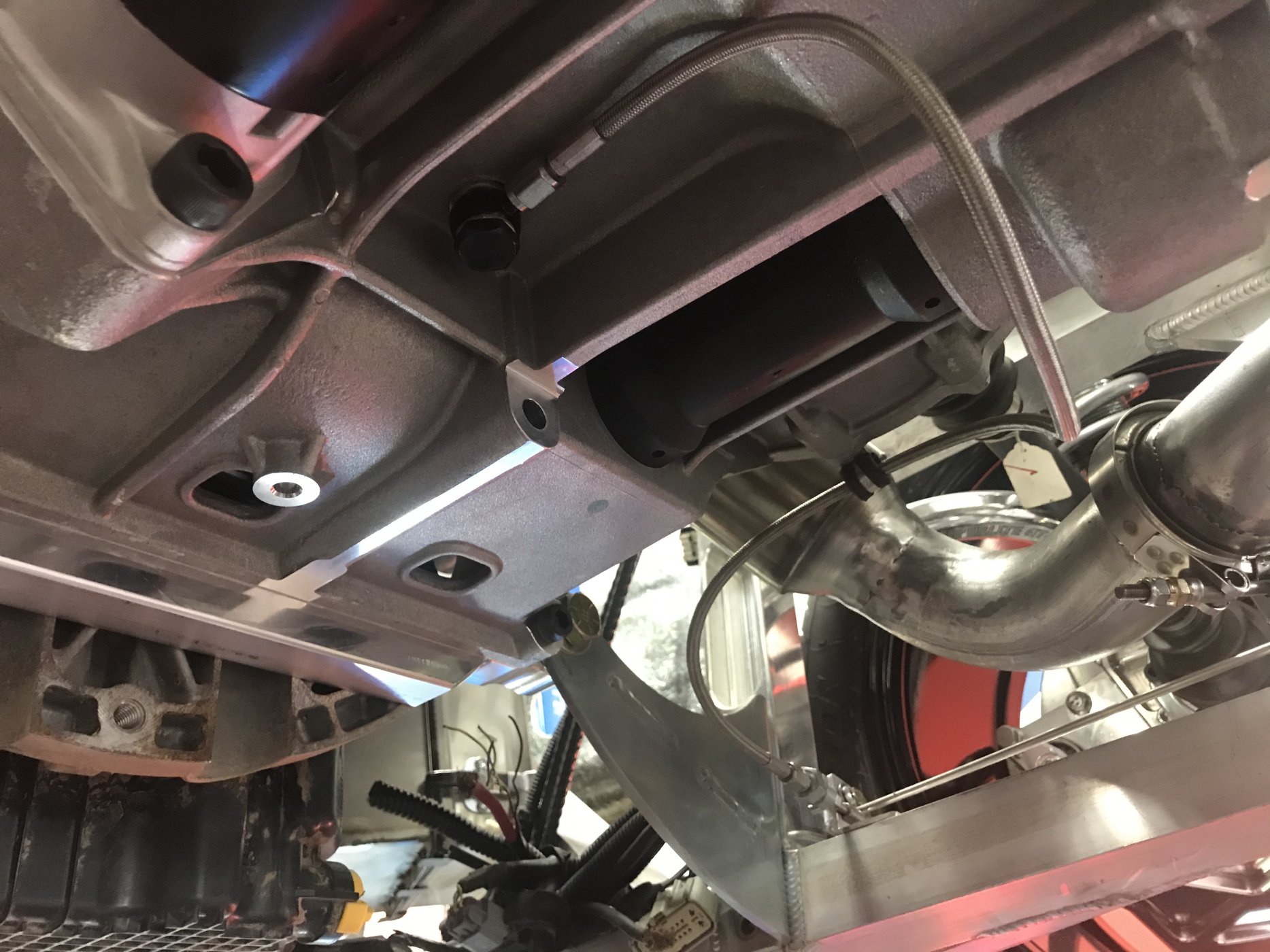

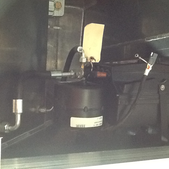

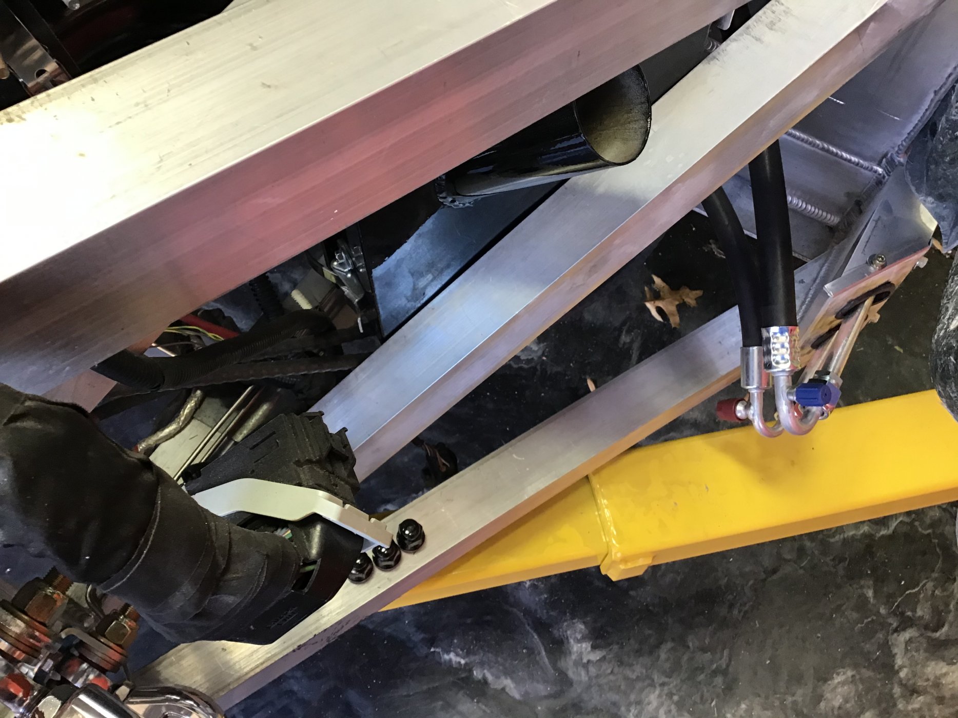

I was able to get in the garage today so I mounted my trans cooler and ran the lines and also completed my clutch line to the trans also working on completing the AC Lines

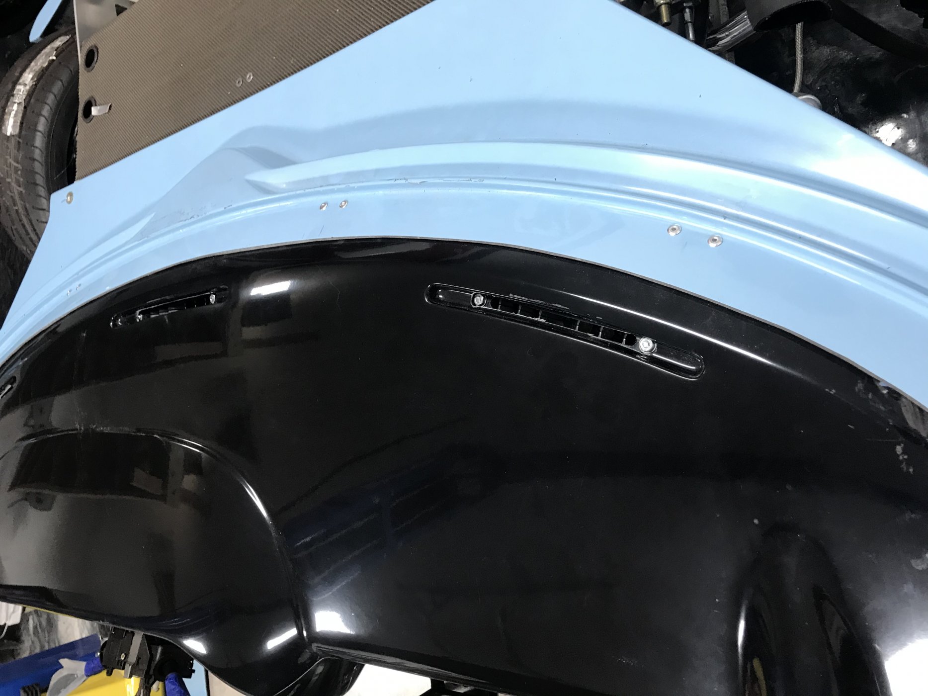

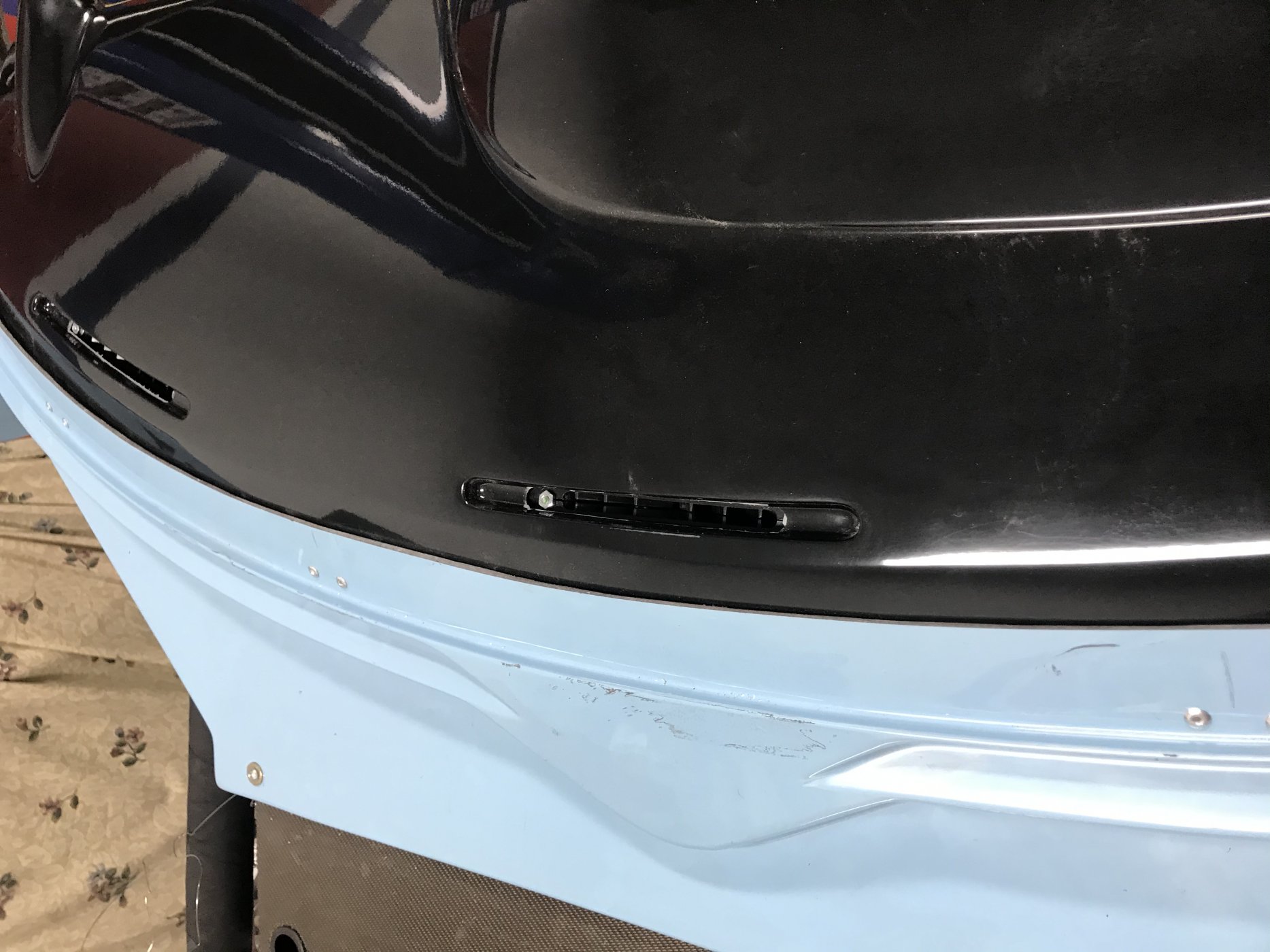

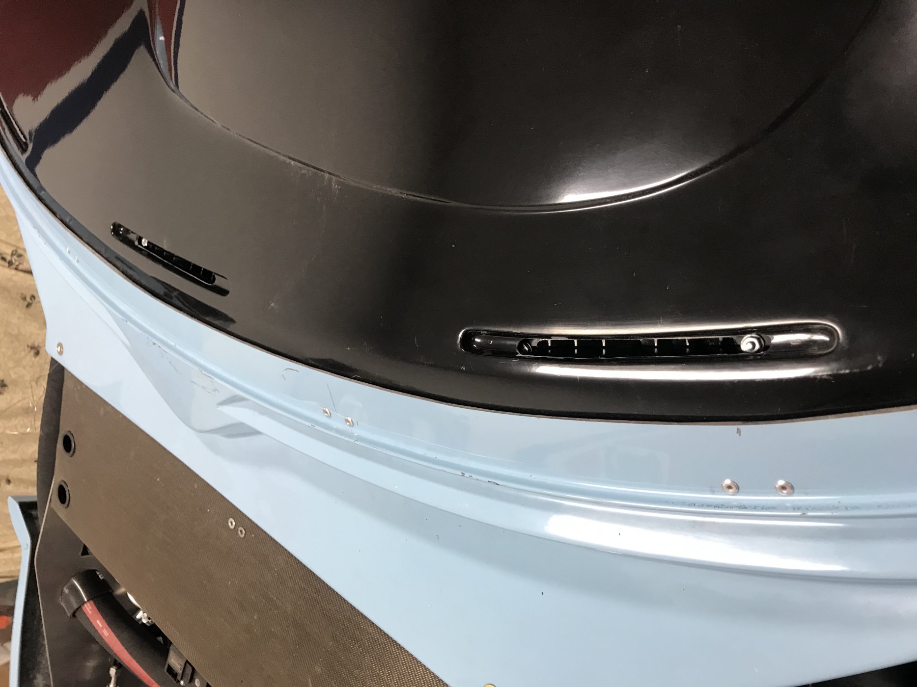

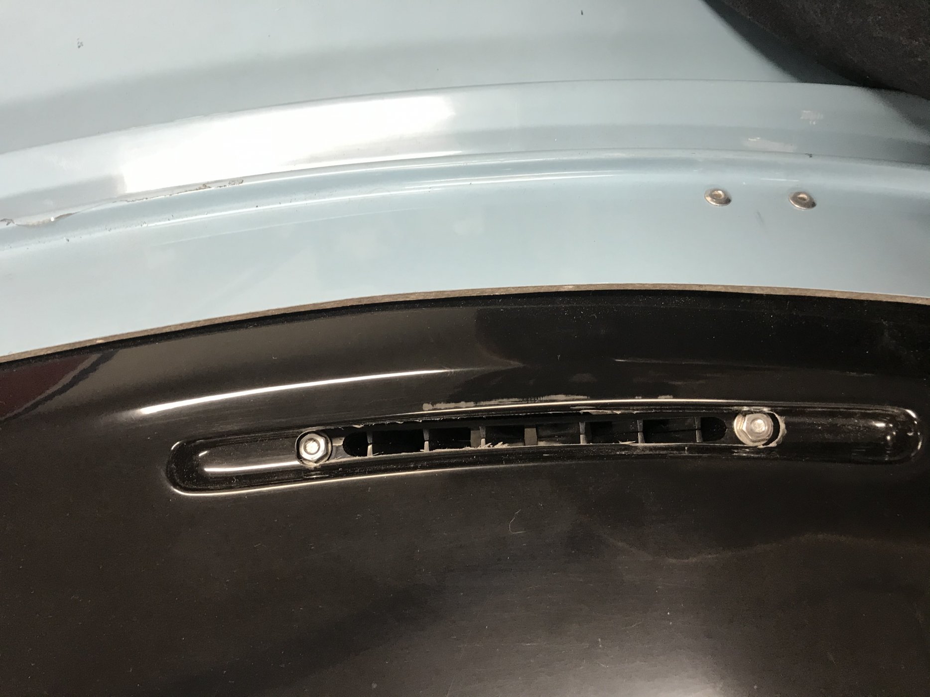

Installed the defroster vents today and will finish with machined alum defroster vents on top of the dash

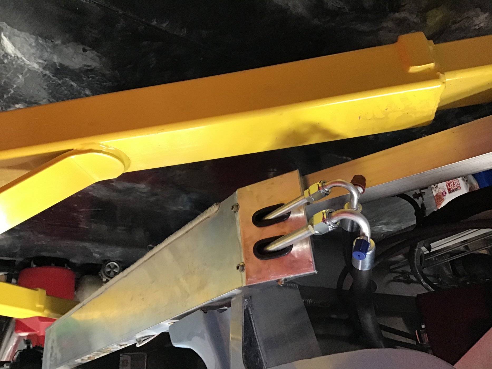

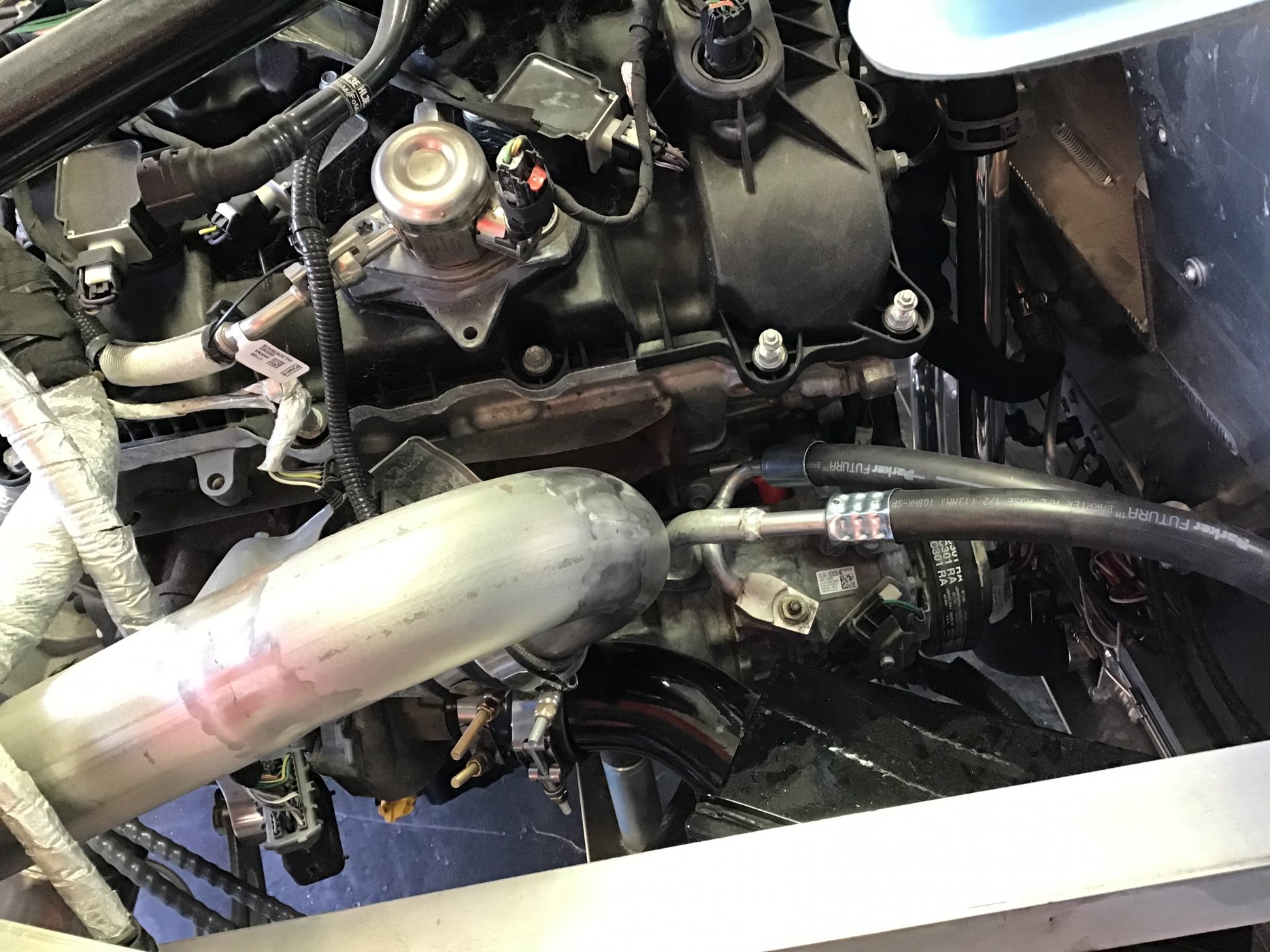

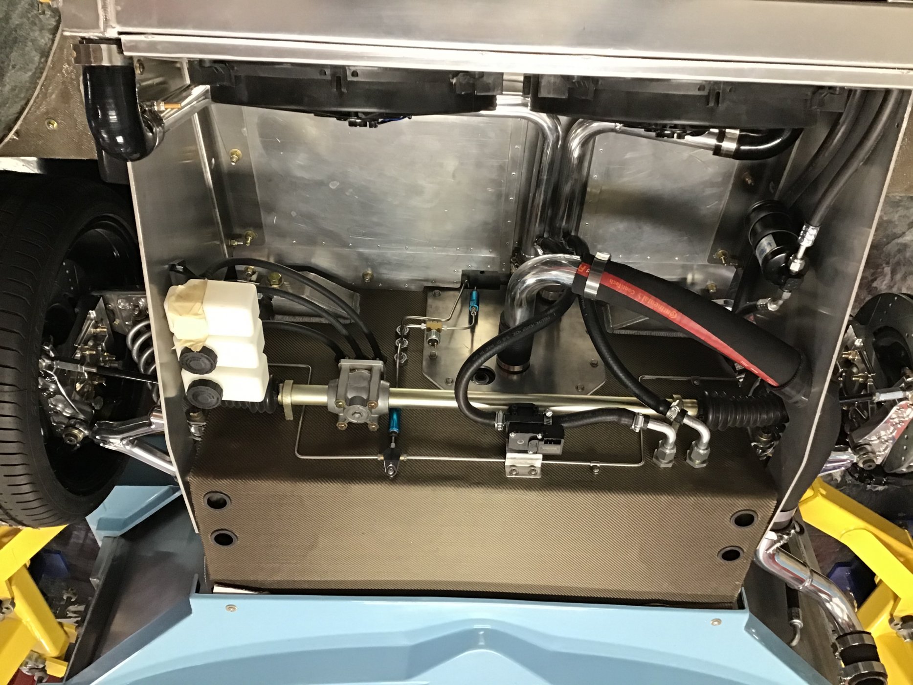

Spent today running my AC lines thru the frame and to the compressor and condenser tomorrow I will finish crimping all the lines and that will put the Heating and Cooling System 90 % complete

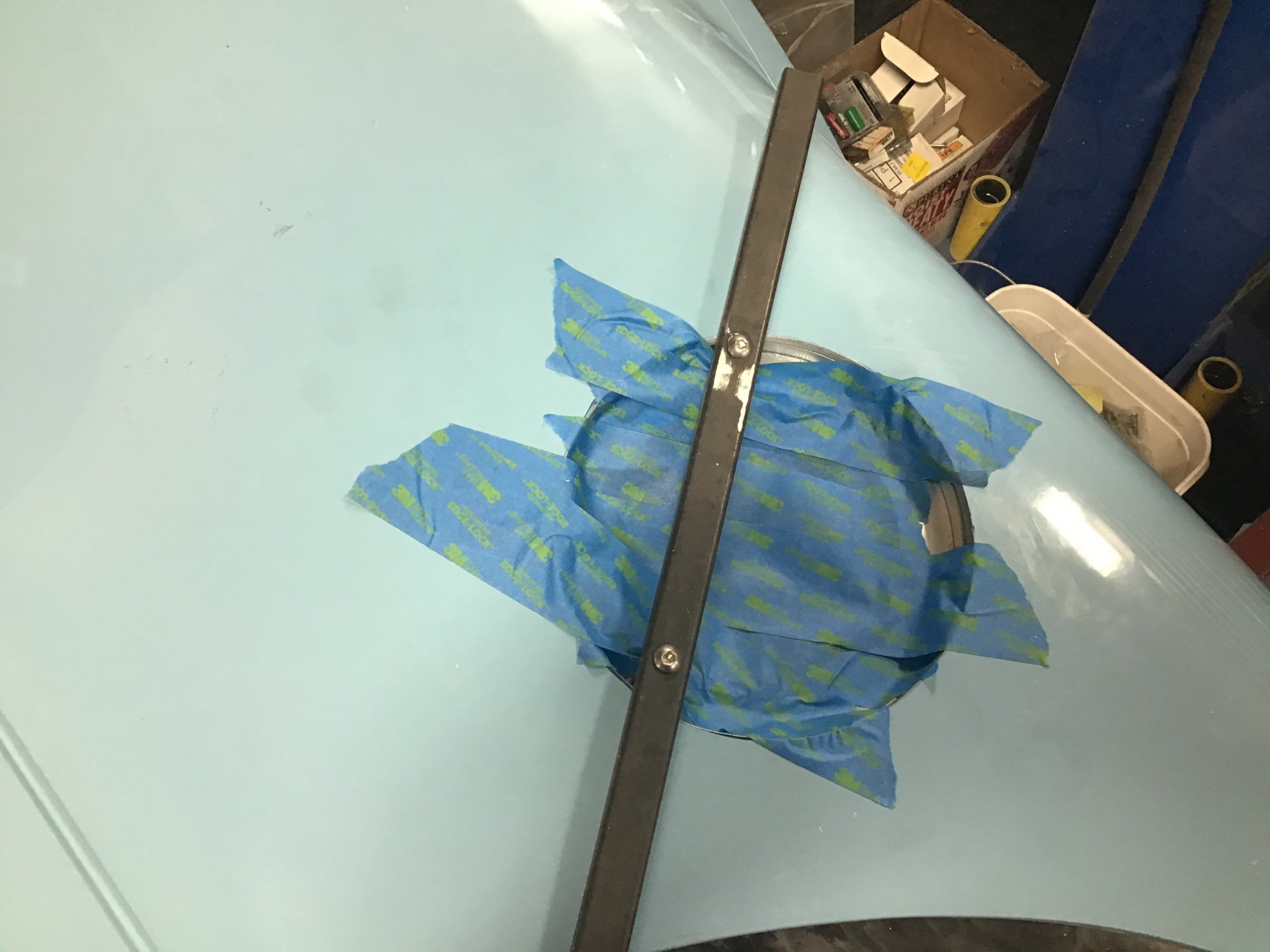

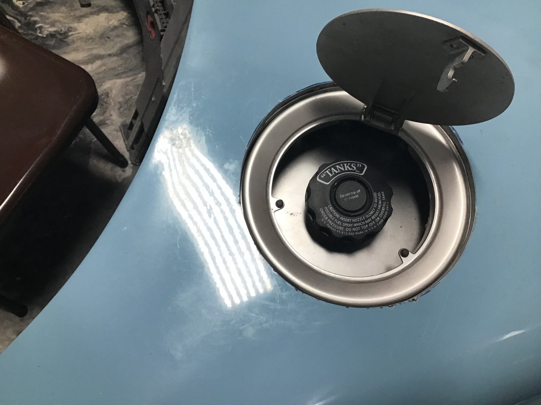

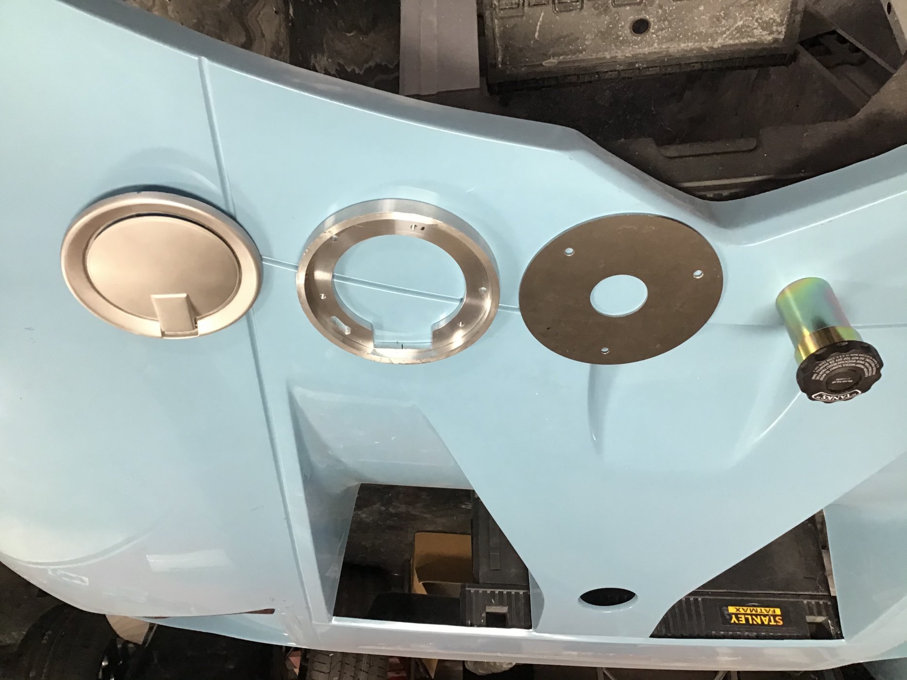

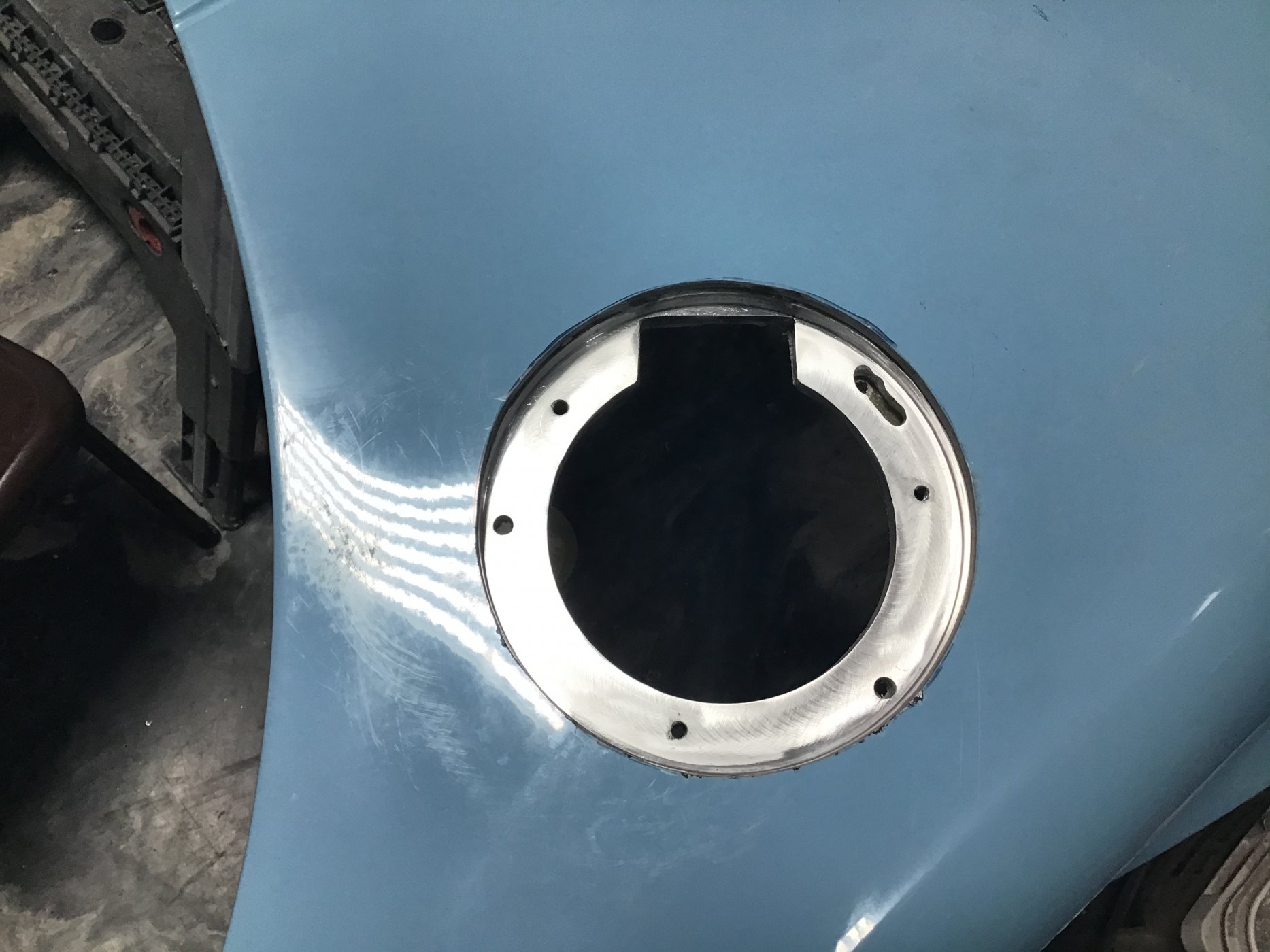

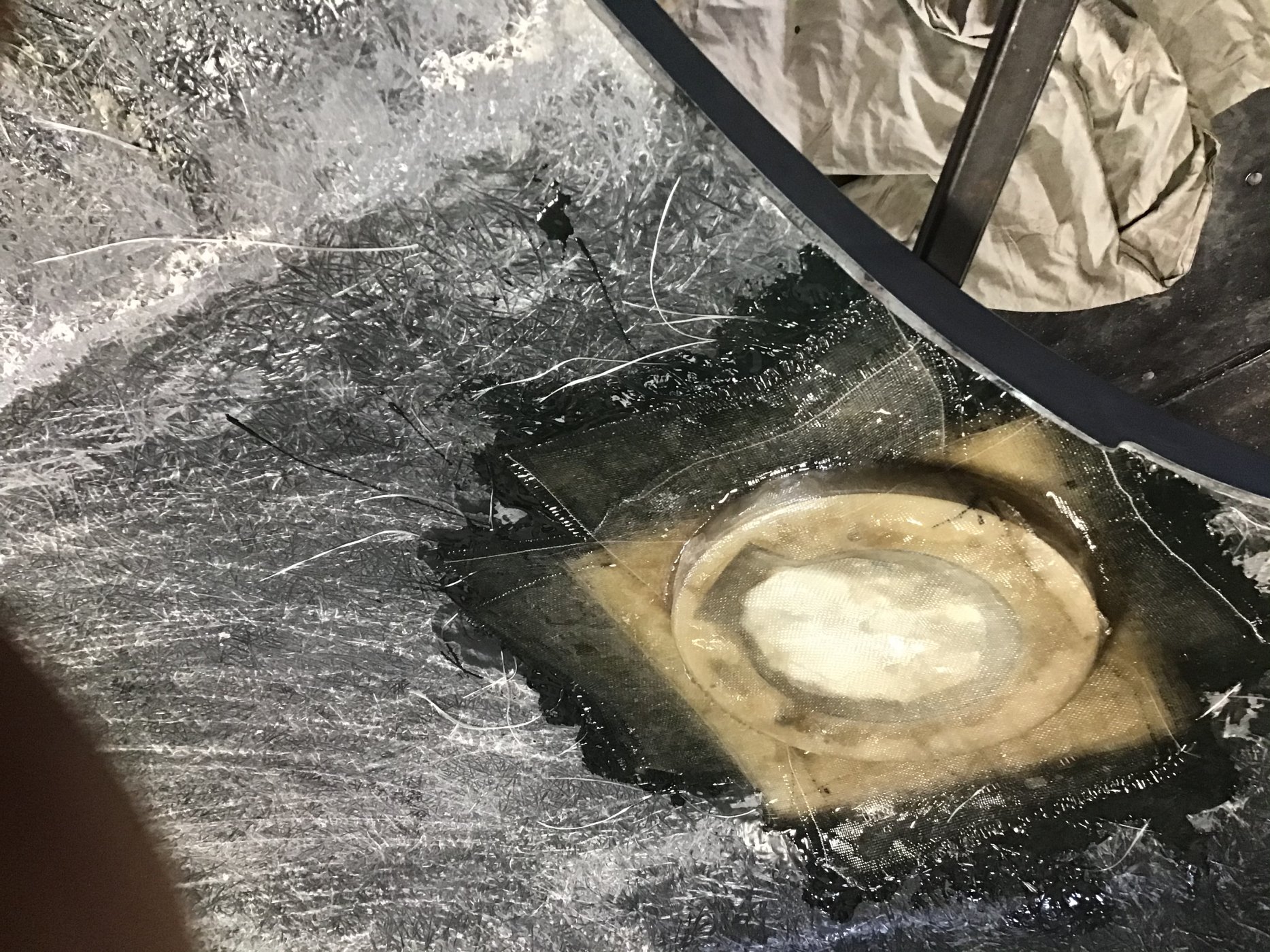

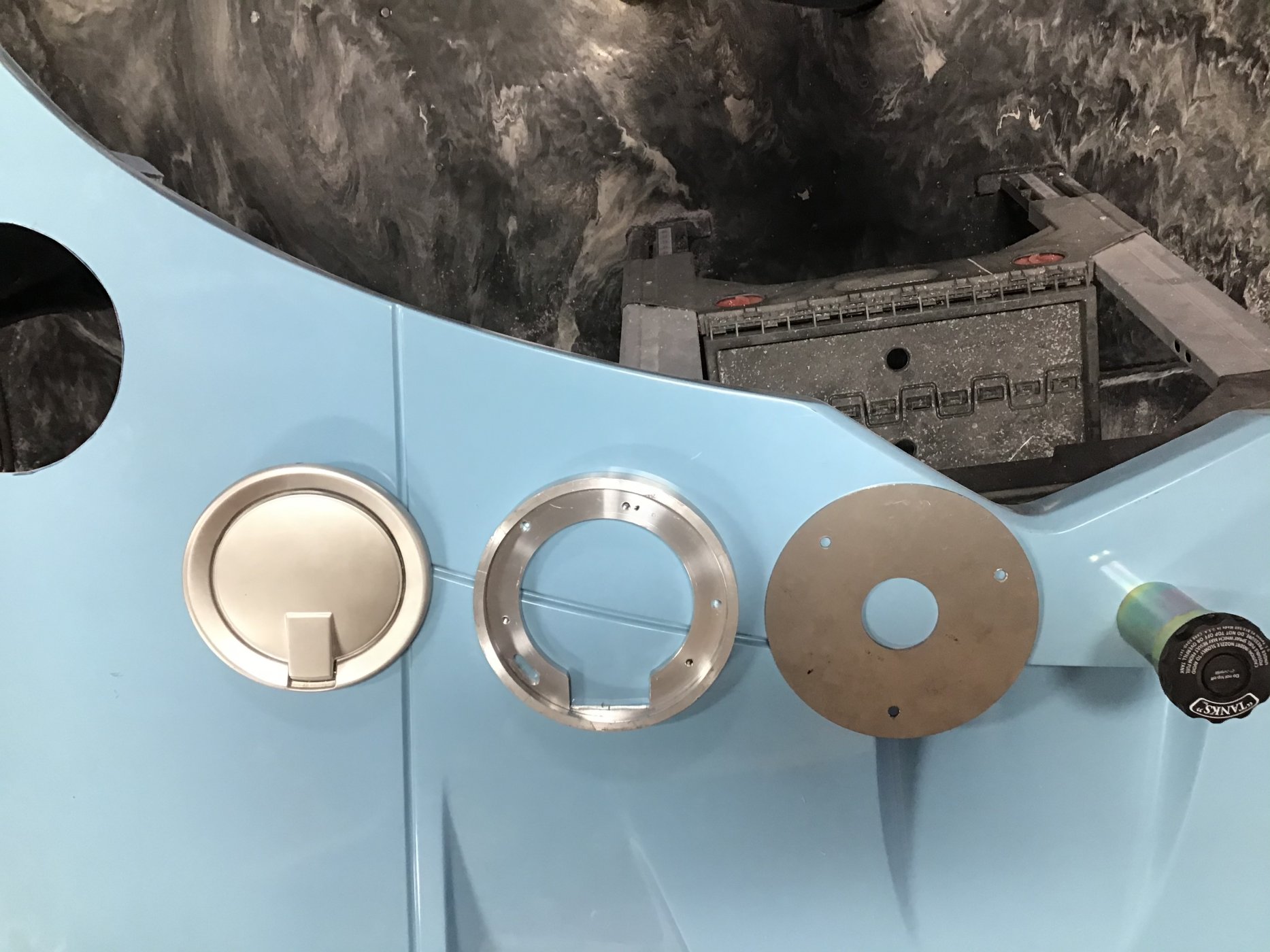

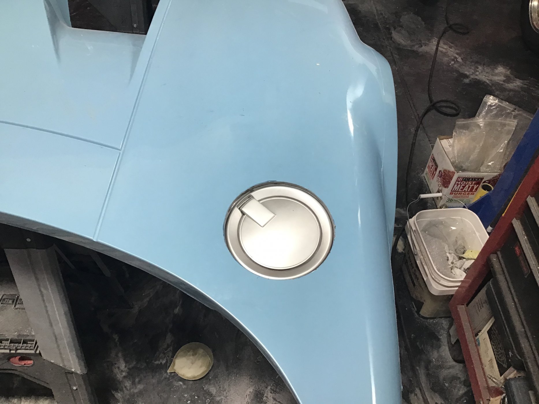

Here is the start of the gas fill install, I started with a factory gas fill door machined an alum mounting ring along with a 1/8 steel plate for the gas neck. I fiberglassed in the alum mounting ring this morning so once dry I will finish the install

Gas filler almost complete just need to reset the front end back on the car and tie it in

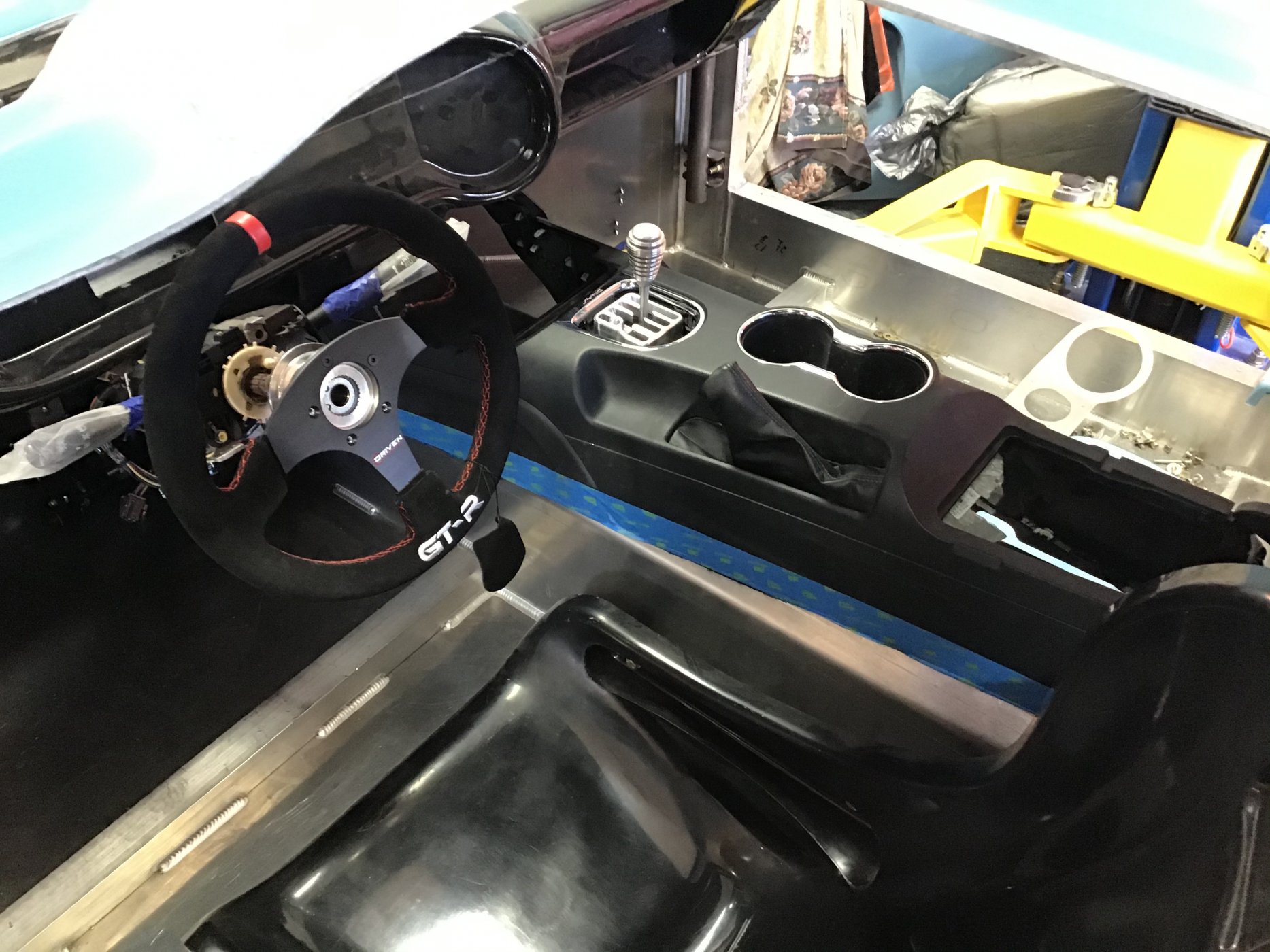

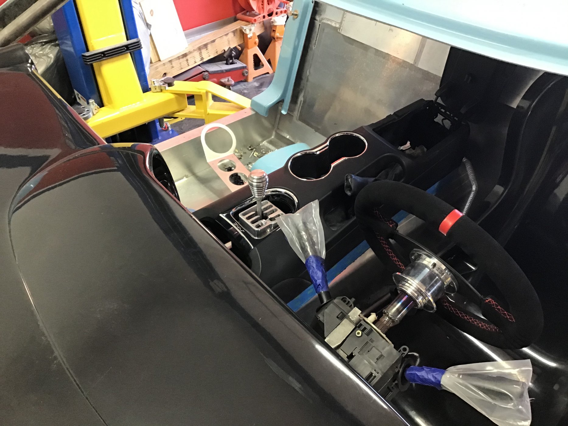

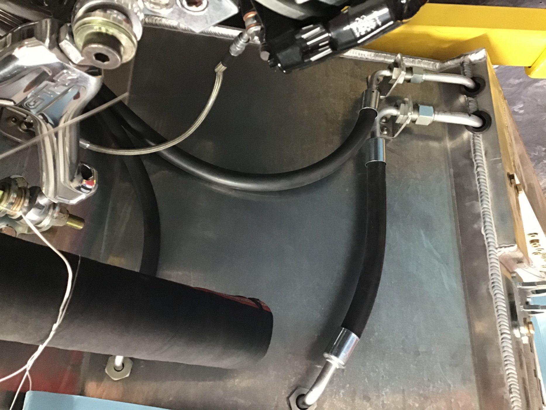

Ok so the gas fill is almost done just need a 2inch 45 degree elbow the ac is almost complete one more piece of # 8 line and we are done I made my own connections to the stock AC compressor I also started to just see if I could adapt a 2016 Mustang Center Console to the car I need to play with it for a while but I think it will work nicely

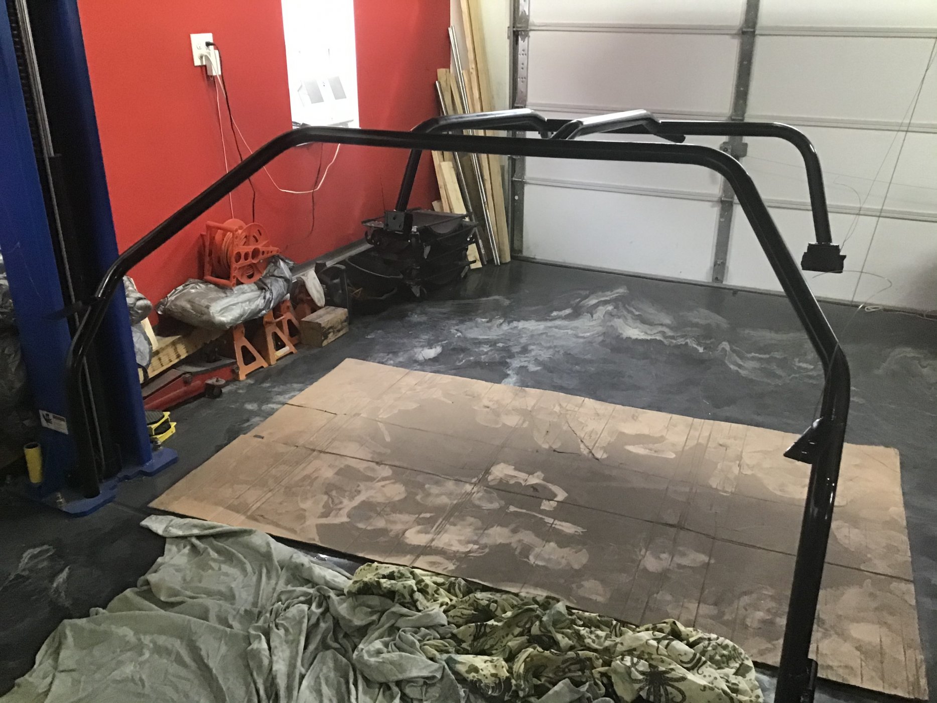

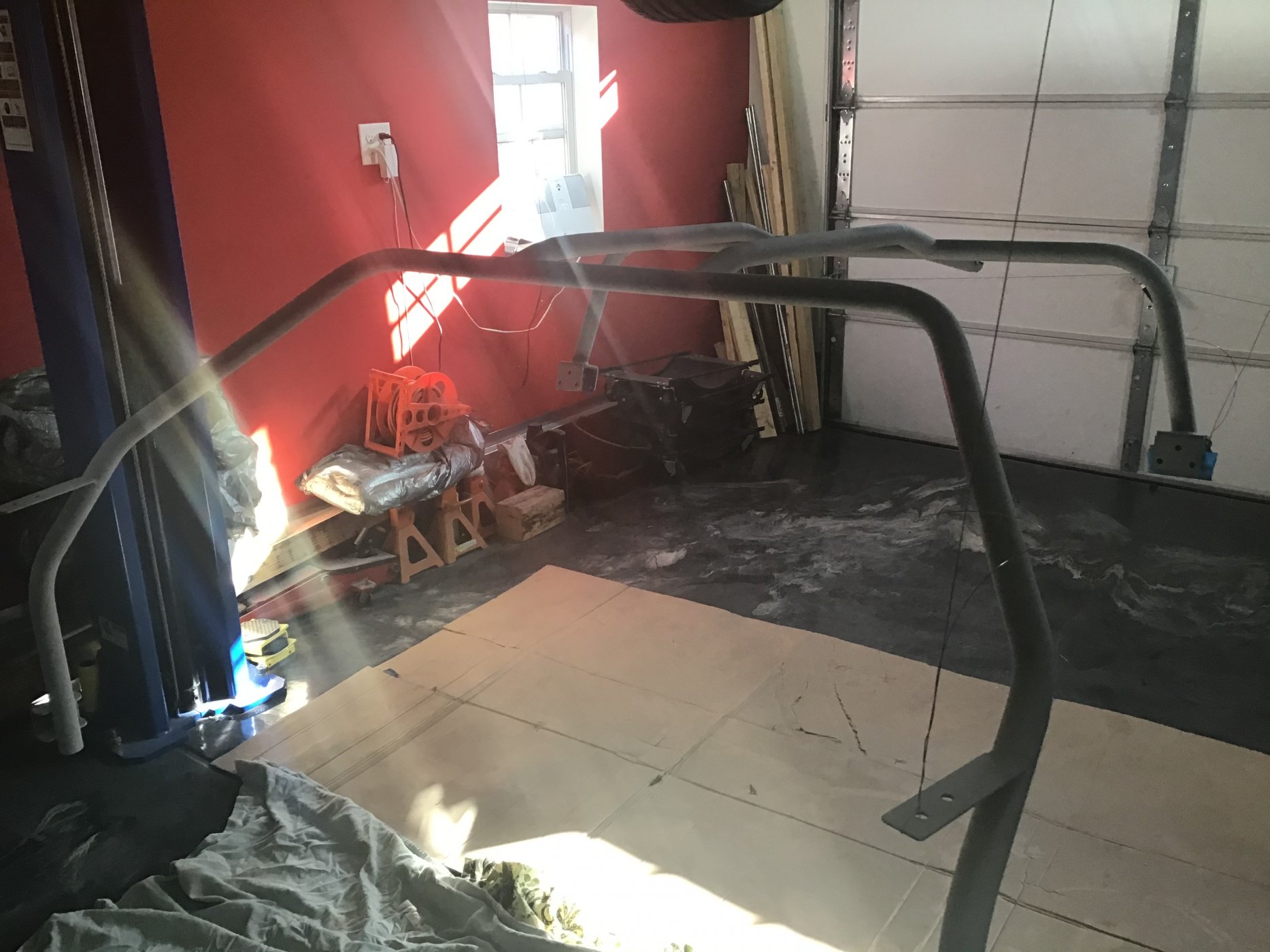

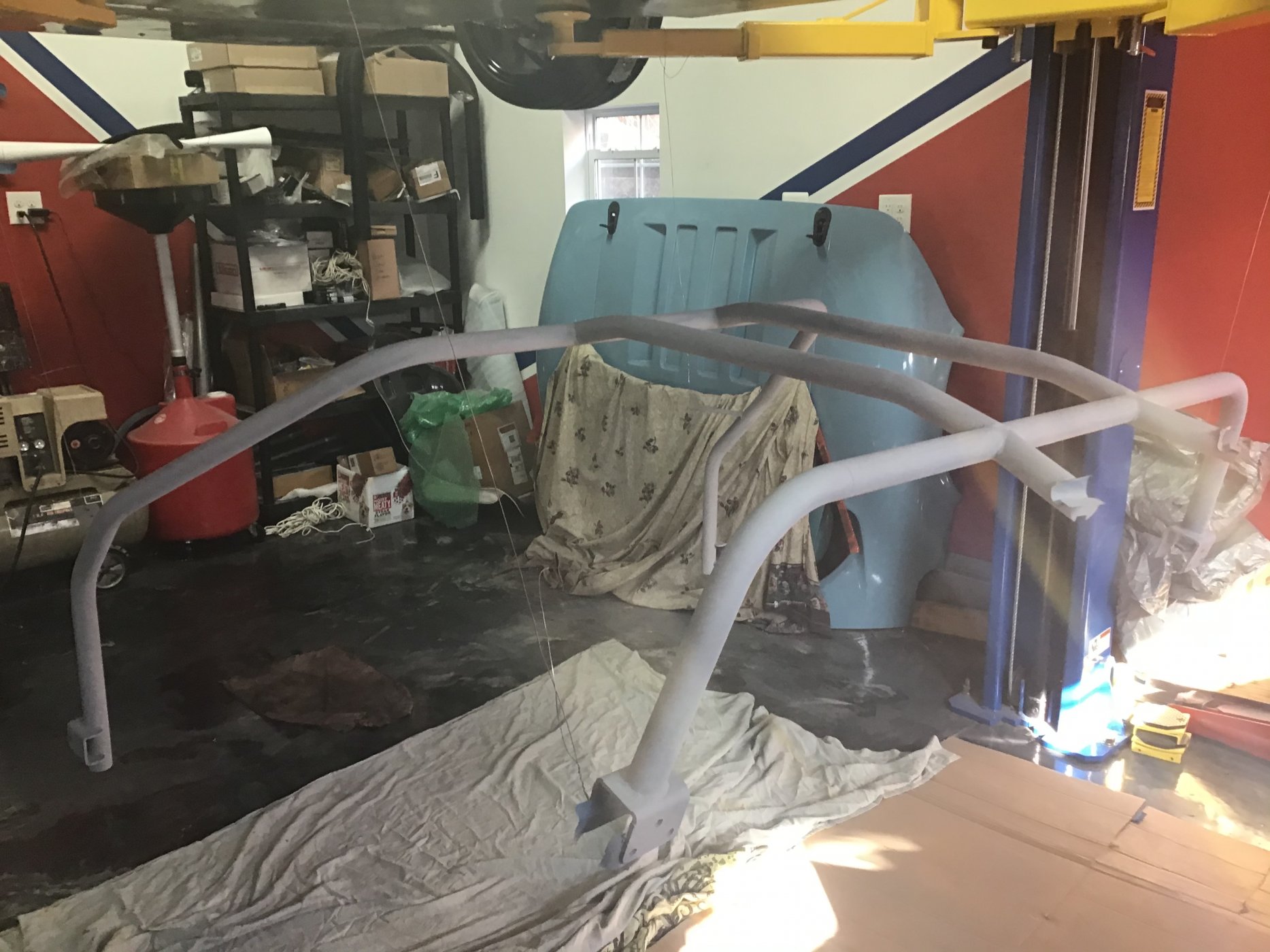

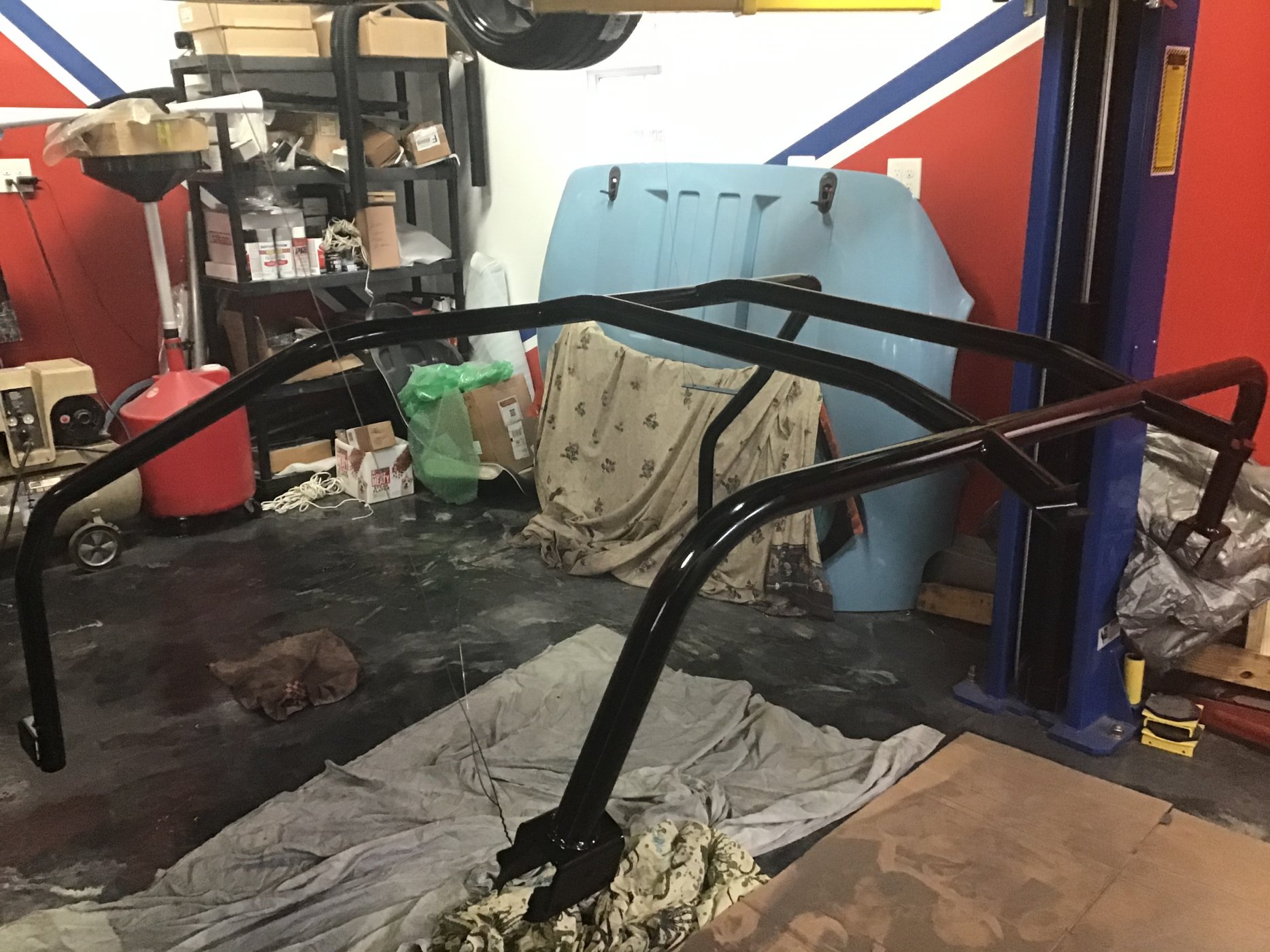

Ok so this weekends mission was the roll bar and cleaning priming and repositioning to get it to fit better to the front aprons. Once the paint is dry we will reinstall
