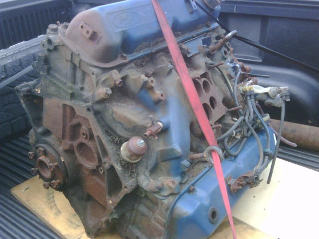

Today I picked up my 460 engine core. Price - free, just take it away. Actually found many 460s that were free. The only hindrance was the distance to go get some of them.
