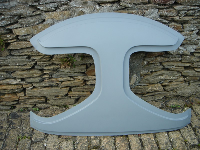

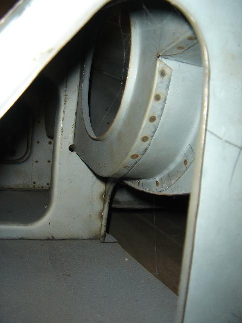

Here is the compound curve and some views of stamped parts....to do it right requires huge investment in dies for all the parts. Some parts can be fabricated 'by hand' with panel beaters tools etc but requires skill to do. I'm about to start assembling the roof and bulkhead for my car (I have most of the pieces) and one thing people don't consider is the order of assembly is crucial as is the need for custom spot welding arms.

That is interesting to see Doc. Where have you acquired the roof pressing from. I have heard of another local gent (in Victoria Australia) who has procured one as well. I think his came out of the USA but I haven't been able to confirm this yet.
