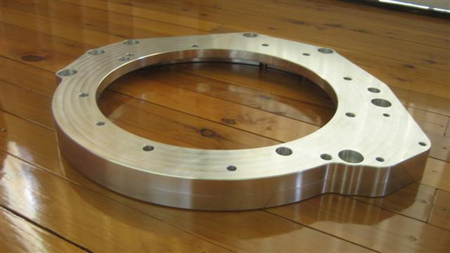

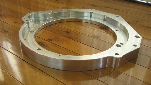

We're working towards a universal adapter kit for Audi and Boxter trans axles to suit Ford, Chev Ls and maybe Lexus.
The kit will include enough stuff to bolt up and go
Would like some feed back of interest;)
See :- Ford Mod. to O1E adapter plate

Chris,
That's wonderful - will be very popular I'm sure. I'm wondering if you're speaking of a single adaptor plate to handle multiple applications (Audi/Boxster to Ford/Chevy/Lexus) or several different plates tailored to each application? A single plate to handle many applications would be a phenomenal feat of engineering IMHO and highly desirable.
Personally, I know I'm interested in exploring the use of a boxster transaxle for a modest output 302 derivative as G50s and ZFs are so hard to come by presently. I'm certainly no expert but I would think the Boxster transaxle could reliably take a little more torque than the old Audi 5000/016. With a reasonably priced adaptor plate on the market I would guess the Boxster transaxle might become pretty commonly used as these are plentiful boxes at sub $2,500 prices.
So, thanks for taking up the initiative here - will be exciting to see your progress.
Interesting. I assume it's a modular setup? (I'm not referring to the oversized, overweight, underpowered, insufficiently reliable OHC engines from Ford.) That is, sets of trans bellhousing adapters and engine block adapters with a common means of fastening one to the other? Very slick.
How is the 01E-to-SBF adapter kit coming?

Thanks Cliff,--Mark, the pic is for the OHC modular motor-- the SBF will be similar except for the starter position. We can make to order any combination from the data we have .(better start saving )--we will hold stock if a popular combination is required.

We're in the middle of a LS1 to Audi 016 :sad: trans adapter kit incorporating the LS1 flex plate and starter (similarly to the pic above) custom flywheel and a modified toyota clutch.
I have an adaptor kit for the LS1 to 016 ready to go. I use the stock flexplate and starter location. I will be working on one for the Boxster and Cayman transaxles if anyone is interested. PM me for details.

Well, there's been pretty well bugger all feedback on this subject,which tells me that its not worth holding stock. However with the data we have, we can do adaptions as "one offs" for those in need.
