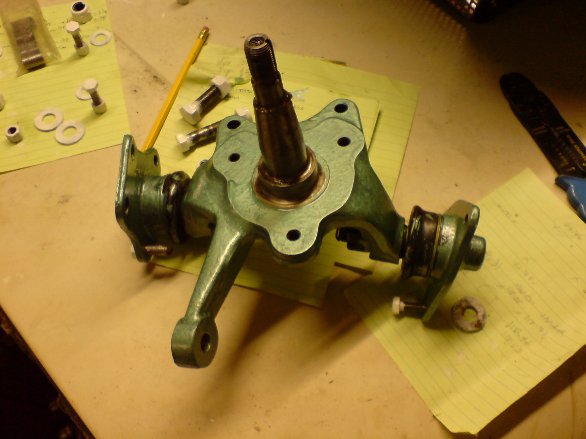

Hi David, I have the same uprights and your description matches my experience. I'm not sure if you just left out the shoulder wrenching effort required to do a 3 point turn. The other thing I've noticed is that on track on sweeping high speed corners it gets quite heavy again. If you have all those it's the overall geometry rather than the setup, but all the advice already given by Mike Neil and Howard too. I would love to fit a different solution that corrects these faults. I would take advice on it, but there seem to be 3 fundamental issues 1 A large scrub radius / low King Pin Inclination 2 A small Ackerman effect 3 Little camber gain. Possibly the only setup change that might help would be to increase negative camber which I can't as mine isn't adjustable. Mine is a DAX40 but does use the GTD parts as far as I can see.

They look like the Ford TD and TC Cortina uprights, or at least very similar.
TC TD MK3 CORTINA GENUINE FORD NOS L/H FRONT WHEEL SPINDLE | eBay
if so these are quite commonly used in a number of other kit/component cars. As I understand it, the wheel bearings are a common size and it is possible to attach different hubs, with either the same or different PCD's. One of the local clubman builders here where I am, the late Graham Lewis, being the genius machinist, engineer and gentleman that he was, went down the path of making new replacement hubs, that not only significantly reduced the weight but also got the scrub radius down to practically zero. He went to a single sided sliding caliper to reduce the distance between the disc face and the back of the wheel spokes, located a suitable rotor that he could mount up to clear the lot and then machined up an alloy hub that moved the stud face as far inwards as he could get them.
he also went to the trouble of calculating and measuring the KPI by mounting the spindle up in a live center on the lathe via the axle and then using the tool post and the graduations on the lathe worked out the coordinates for the ball joints. Think it was a very respectable 4° KPI. I wish he was still here today so I could bounce ideas off him.
RIP TDC.... aka Graham Lewis.
David (B) and Ryan, the uprights I''m using on mine are from a Cortina and look identical to the photo shown. When I was originally sourcing mine many years ago (from a Dutch breakers yard) I was keen to know the KPI (or rather SAI ). I made up a jig and turned down a long steel rod to fit snugly through the upper and lower ball joint holes. I measured an angle of 6.1 degs. More recently, I took my car to an alignment shop and they measured a value of 6.0 degrees. I have seen a KPI /SAI angle of 4 deg quoted previously for the Cortina upright in other forums, so am sure that is also correct. This leads me to wonder if there were perhaps small differences between UK and German/Belgium manufactured Cortinas. Can't remember for sure but it was LHD and maybe made in Ghent. If that is the case, the higher KPI/SAI could lead to reduced scrub radius and low speed steering weight - although 2 degrees won't have that much effect. My scrub radius is about 90mm. I also recently increased my front-end castor from about 2.5 degrees to 5 deg which improved the steering self-centering.
Trevor, im in Australia, so it might be something that Ford Australia made up. I haven’t had a set at my disposal for a while so can’t remember. I seem to recall that the ball joint tapers were at different angles, so adjusting the height of the ball joint also altered the KPI. Not that it’s possible with standard Ford ball joints, but if you went to a rod end or rose joint on the top with spacers you could certainly raise the pick up and decrease the SIA.
