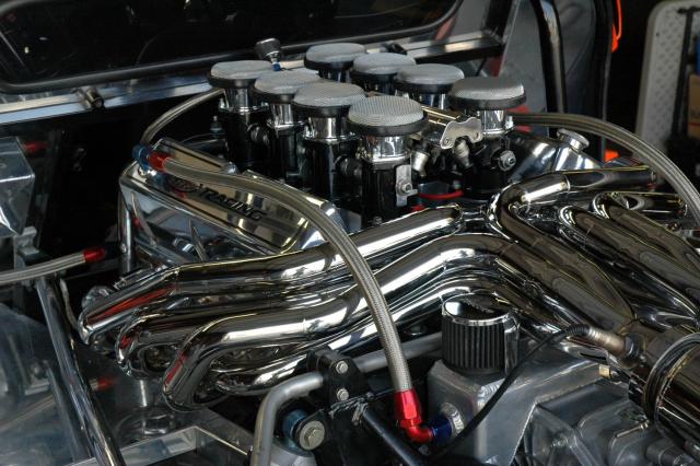

I have a TWM throttle body fuel injection system on my Keith Craft 408 in a Kirkham FIA Hybrid that I am very happy with. PM me your email address and I'll be happy to provide info and part numbers.
Allen Nicholas
Tim Kay
TWM :thumbsup:

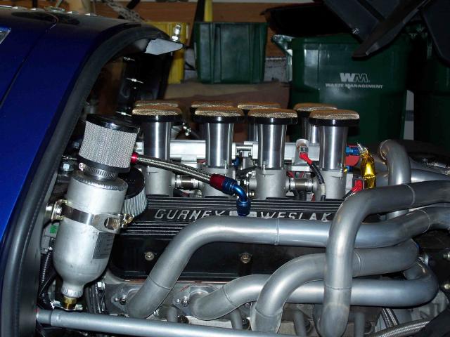

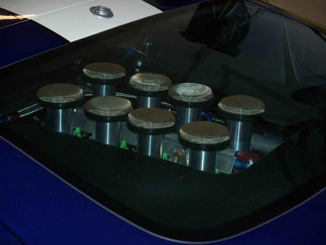

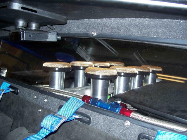

Here are some photos of the EFI stacks on my SPF P/2192. It has a Keith Craft 427W with TWM EFI and special tall velocity stacks topped with Bill's Max Flow s/s velocity stack filters.
After much hunting and experimenting, these are the best stack filters I've found. They are a three-part sandwich of metal filter material that, if memory serves, filter down to three microns.
The first photo shows the engine with Bill's standard s/s filters, which I really like. Then having seen some great photos of a Lotus F1 with gold/bronze colored filter screens, I asked the owner, Bill, to make me up a set which you can see in the other photos. They're also available in black screen material and in sizes that fit most any velocity stack - including Webers, etc. Bill is a delight to work with, and is currently supplying screens to TWM and other manufacturers. Bills-B-Racing: (586) 883.0942

You'll want to check with Bill, but I seem to recall that they're around $20 each, or $160 for a set of eight, plus shipping. I think I paid $189 for the gold set. Of all the different filters we've tried on the dyno, Bill's had the least impact on HP by far. And they're great looking, always the first item people comment on in the engine compartment.
