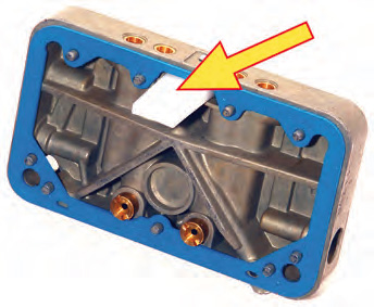

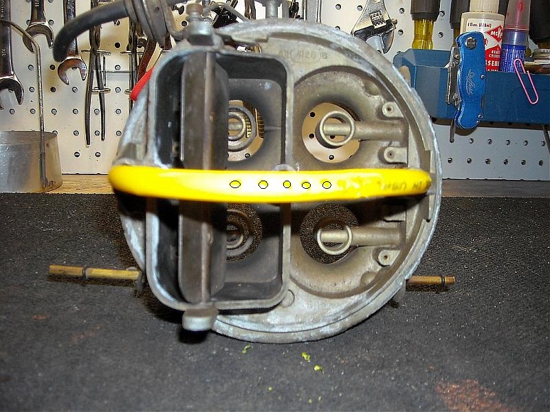

In the situation you describe I would suggest you need/should have the Holley bowl vent extension 'whistles' to prevent fuel being forced up the bowl vent tubes and dumping in 'this case' rear barrels creating an excess rich condition that kills the engine at idle RPM. They can be fitted to both front/rear metering blocks.The Holley parts may not fit your carb if its got side hung float bowls without modified or aftermart floats. Pics of Holley vent extension and a pic of a DIY extension tube that is simply pushed into or over the factory vents above the barrels, trying that to check if it cures your issue for a start, but be aware it might cause some other problems under acceleration/cruise conditions.

I've ordered the Holley Fuel Bowl Vent Baffle, part 26-89 and the Float Kit with Main Jet Extensions, part 116-10. The extension tube has also been mentioned by Roush. I'll report the results.
