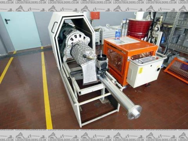

I am reading your forum from some time and decided to ask you a question that is not concerning exactly GT40 but as I see you have a lot of information for mid engine cars. I am considering to build a mid engine 4wd kit car. I choosed the gallardo transmission and bmw v10 engine. Did anyone know how the transmission could be operated? Thank you in advance.
Best regards,
Peter
contact the guys that built the V10 ultima and redesigned the OEM trans to a trans axel setup. I posted lnks to them before so search my previous posts.
why would you exchange the VAG V10 for the BMW V10?
by the time you have had everything sorted and up and running, a KMS tuned VAG V10 would have been cheaper.
KMS have build an (or at least co-build) ultima can-am V10 with lambo stuff. they might be able to provide some information on the transmission?
ps for that money you could probably also put a sequential Cima gearfox transmission behind the BMW engine, much nicer combo.
grtz Thomas
Thank you for the responds. I am looking for 4wd transaxle thats why I am looking to gallardos transmission. If anyone knows other supplier for 4wd transaxles it would be very nice.

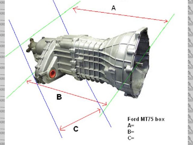

I have seen a ford sierra cosworth 4x4 box use in a midengine cofiguration. also Miller extreme Vehicles did that with their dakar 4x4. they just mount the complete drivetrain back to front, and then flip the axle's over to get the car to drive forward.
ofcourse a complete big guns 4x4 transfercase is not easy to fit, but the various boxes with internal transfercases are quite narrow. and much the same as the gallardo layout. it just depends on how you want to arrange the diff set up on the rear axle.
I suppose a MT75 box + twin cossie LSD's should be able to cope with some power.
grtz Thomas
the question that I would have with flipping an existing gear box is how to deal with the torque split 60f/ 40r would be a handfull, unless you used a stg gearbox and a divorced x-fer case
